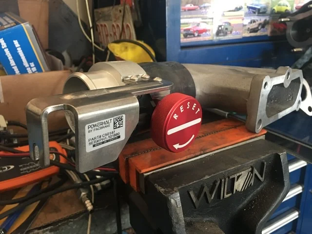

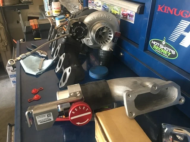

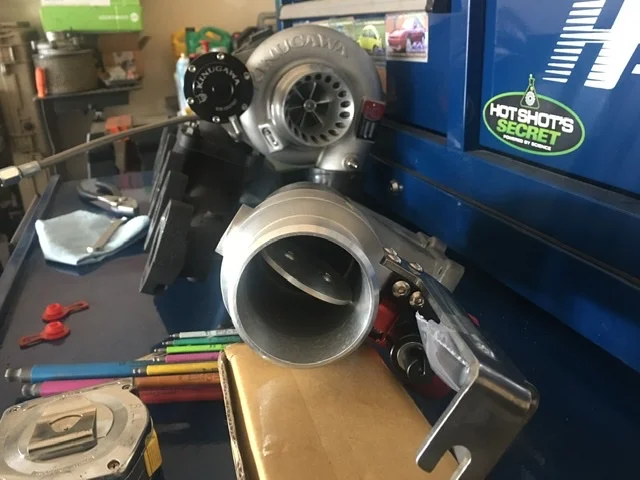

I’m excited my shut-off valve came in.
2.5” was the right size for me to adapt to my intercooler pipes.
I'm glad I spent the money to get the right parts to do this. quality is top-notch from PacBrake and also the valve is way thicker and it seals much better than the idea I had using a universal throttle body. I can close the valve and do a boost leak test from the turbo inlet. I found some boost leaks so new clamps are in order :)
