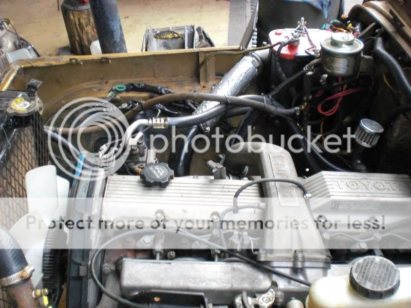

Got my 1HD-T/H55 into my 64 FJ40 this past week. Here are some pics. Last pic is the sweet cross member mount he rigged up. My fabricator is a certified welder for that welds for the Marine corps on tanks and amtracks. he does great work.
install
wow that looks great, wait till you drive it, hitting 3rd will make you smile! with 4.11 gearing first is a granny gear, you can use it but just as easy to start out in 2nd
my x member is set down a little lower than yours but it looks like it is fitting nicely
does the rad clear the fan or will you move it? I have an electric fan but seeing yours it looks like plenty of room so maybe you are a little further back

My fabricator had the radiator shroud installed to make sure it would clear. he thought the x-member was too weak so he added some plates on both sides the strengthen it. There is definitely a serious height difference in the transfer case output and the rear axle. Need to figure out where to get a drive shaft that short and that steep.
DDLT
I reused the original 40 trottle cable and mounted a FJ 40 radiator instead of my BJ rad.No cooling problems anymore like i used to have with my 3B Turbo Intercooler with the diesel radiator.
