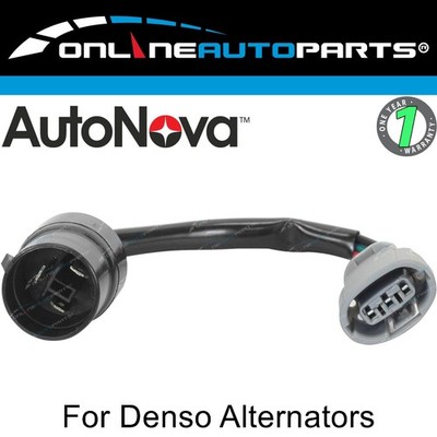

There are adapters available to adapt between the old and new plugs, or source connectors and make your own.
One example
One example
I didn't want the adapter because I wanted to repin my old one with new plastic.
I found the connector elsewhere today after some more digging. I knew I should've dug more before I posted. Always happens.

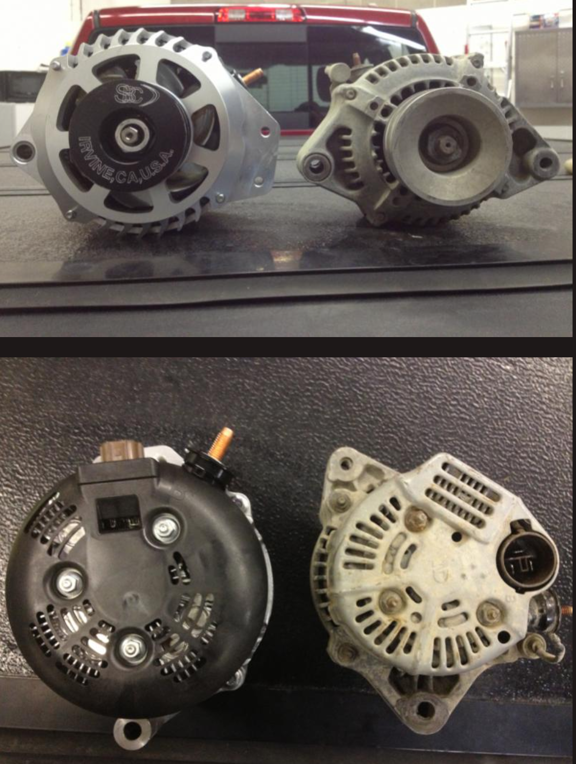

I swapped in a 1991 Tercel alternator 80A a while ago then I went with M2k.inc for an upgraded alternator
when switching to the 1991 alternator the regulator is different and you have to swap your old pulley over.
here is pics of the tercel alternator
and link to my upgraded m2kinc alternator
I have a 100 amp. The tercel is a smaller body. It doesn't fit.
