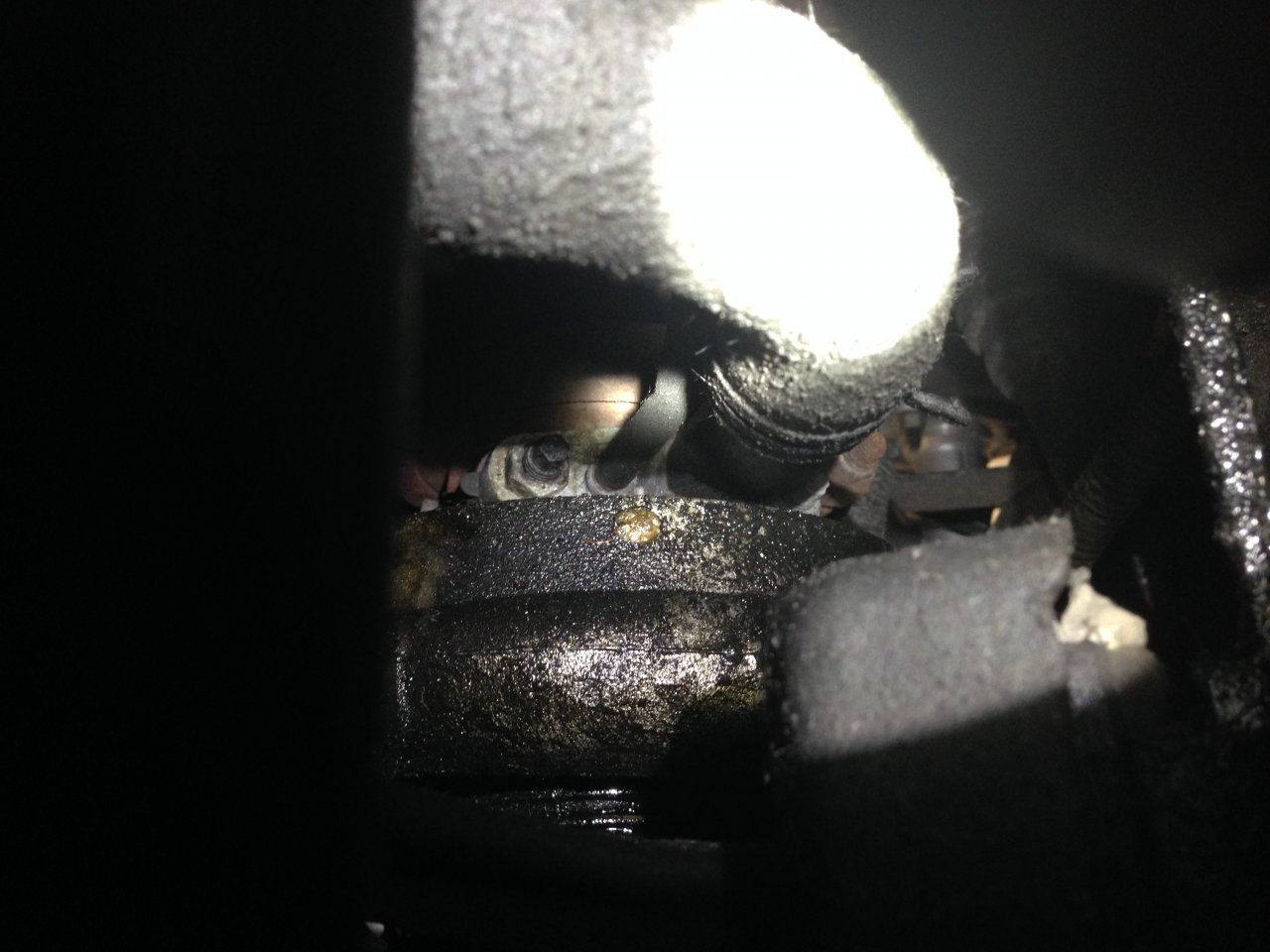

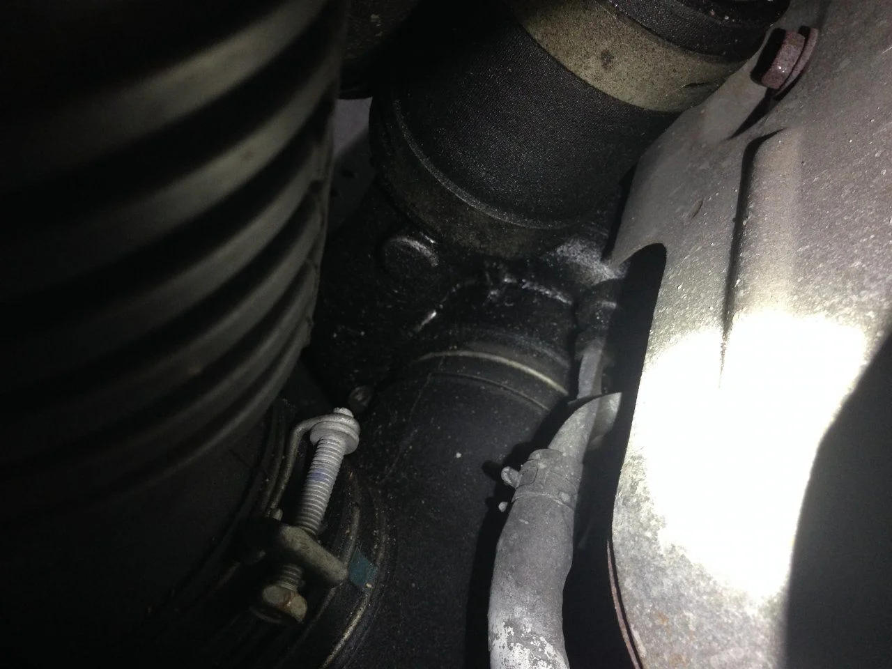

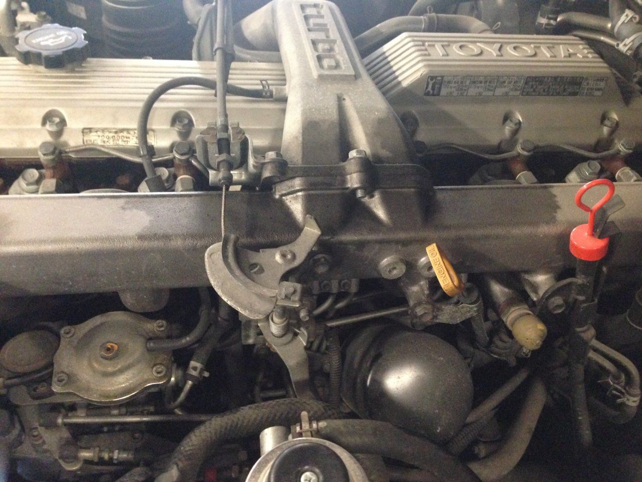

This truck has had a slow oil leak since I got it home last August, didn't appear to be an issue before the long trip home from Vancouver, as the shop I had do some work on it didn't observe anything when they were doing some maintenance on it for me before the trip. I've been very slow to get around to diagnosing this, and just lived with the slow drip on my garage floor till now.
I had convinced myself it was the oil feed/return hardlines off the center section, as it's apparently a common issue on these trucks. I got under the truck today to have a closer look, and it appears that area is bone dry, along with the hot side, but the compressor side is coated in oil. There's really nothing above the turbo that could be a source that I can see, so I'm now thinking it's my actual turbo that's leaking. Pics 1 & 2 are from under the truck, of the oil feed/return hardline, and the compressor housing respectively, and #3 is from above of the compressor section.

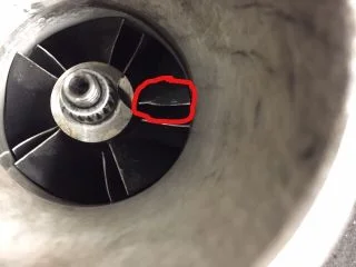

Recently, I've also got some oil staining around the intake manifold/crossover pipe junction, which I fear supports my theory that the turbo is letting oil past. Pic #4 is of the oil on the intake manifold, there appears to be some oil under the manifold on the intake side of the engine as well.
So, what am I looking at here exactly? What has failed, and what do I need to do to fix it? Seal in the turbo? Rebuild/new turbo?
it looks like you will have plenty oil in your intake .. take a look inside of your cross over pipe ..
how bad it's the oil consumption ?
Had this problem, oil caked on the comp housing... It picked up just about everything under the sun.
Added catch can. Replaced bands that tighten the rubber connector between turbo and crossover and it's been fine ever since
Oil consumption has not been an issue, I check it often but rarely need to add anything. I don't have a boost gauge yet but power feels fine so the turbo is still working other than this oil issue.
A catchcan would intercept oil going from the valve cover to the neck off the air box, correct? So it would prevent oil from getting into the turbo fresh air inlet, through the compressor side, and into the crossover pipe/intake manifold? I could just pull the airbox elbow and if there's oil pre-turbo that would confirm my causation?

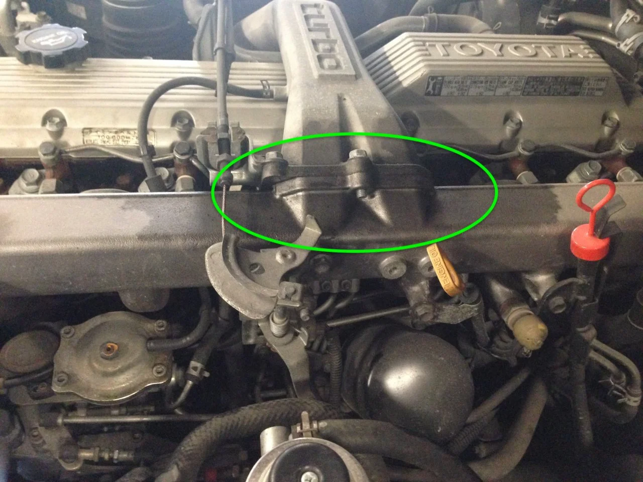

I can help on the last picture, I had this leak exactly the same.
you need 1 gasket part 1711517010 GASKET, INTAKE MANIFOLD HOLE COVER
Is really easy to change just unbolt 3 bolts, clean that area until shiny and place the gasket
When you remove the bolts you can make space and move a bit just enough to change it you dont need to remove anything else.
Been 1 year without that leak.
For the rest of your pictures I can't tell what it is.

That oil leaking there is an accumulation of oil in the intake from the pcv system. Not a failed gasket. Until you do something to correct that situation the leak will return.
There is no oil that can get there through any other means.
There was not any gasket when I removed it only RTV, probably from a previous owner.
