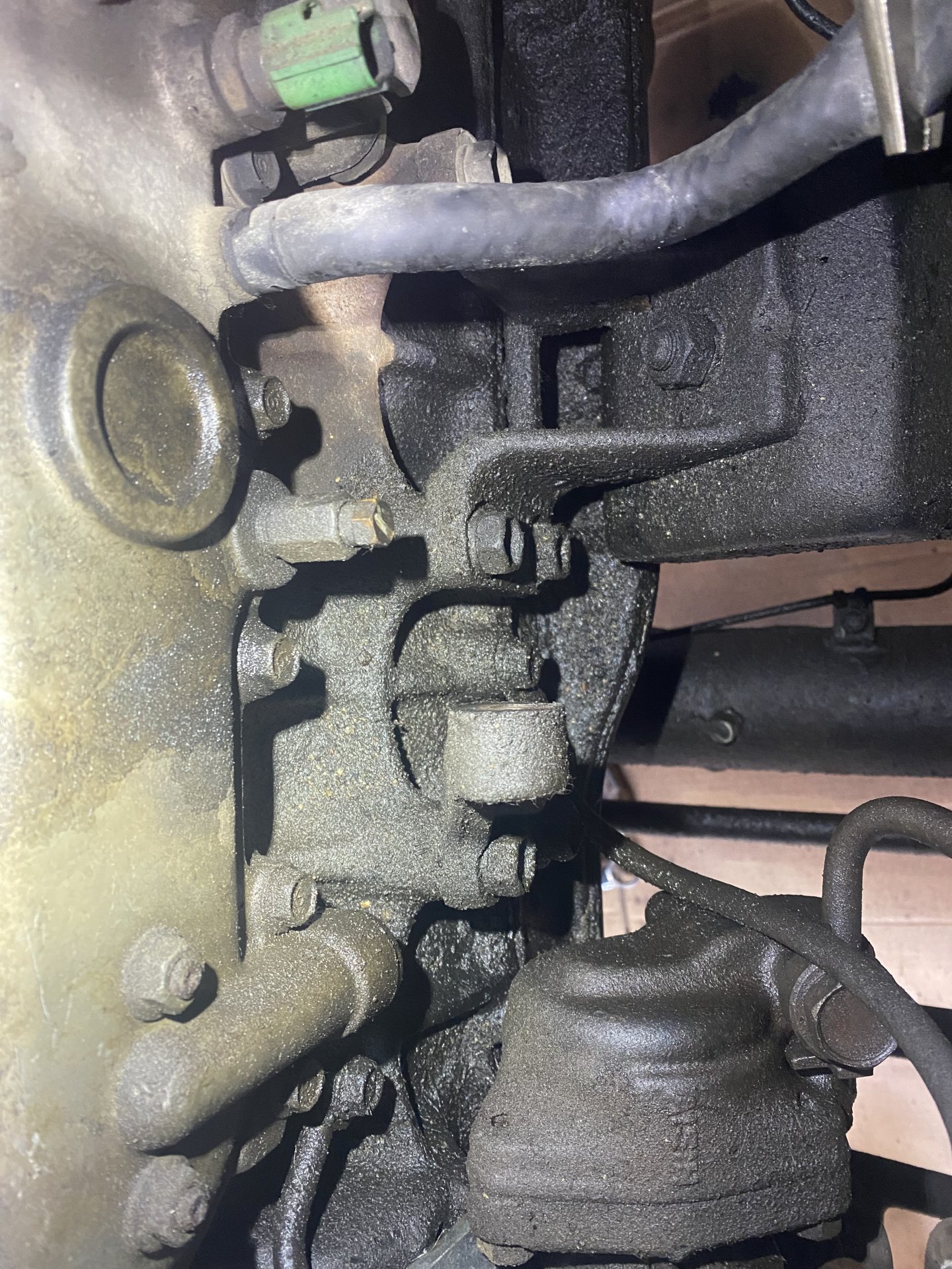

as this is an oil leak thread can anyone help me identify where mine might be leaking from? i’ve been chasing a leak too and can’t find quite where it’s from. this is the side of my engine with my injection pump off. it’s dry midway down the oil cooler. is there a seal in the housing around the timing gears that can leak? no oil in the coolant so i don’t believe it’s a leaky oil cooler and there’s no coolant leaking around the cooler either.
or is this a leaky oil pan that oil is being blown up a little? i’m pretty sure the streak of oil down the center of the oil cooler is from messy pouring while filling the oil after an oil change. 🙄
so i degreased the bottom of my engine and pressure washed it to see if i can find where my oil leak is coming from. it seems to be between the block and the part that holds the crank and bearings in place (i don’t know what it’s called). the oil pan bolts to the bottoms of it but that is sealed. what does it take to take that off and reseal it?
are you sure it's not your turbo oil pipe? there is also an upgraded reinforced part to go in its place.

turbo pipe leak
That's the girdle. Big job to reseal as it forms the lower half of the main cap. If i was doing it I'd pull the engine, and then you're on a slippery slope starting with big end bearings and ending with a full rebuild.
If you do it theres an o-ring seal thing between the block and the girdle that will need changing.
BEB already done a couple years ago. i wondered if this was going to be a rabbit hole. this may mean i pull this truck off the road for a while so i can do it right. it’ll be time for a full rebuild if i pull the engine. have a little more blow by than i like and i’m at about 600000km.
yeah, sorry i meant main bearings not BEBs but that would be a logical thing to change while you're in there. There's no gasket its just sealed with RTV, I've seen a couple weep for a while from that join. 1 ended up with a full rebuild (500k plus engine) and the other spun a main bearing before it was dealt with (just coincidence).
At the very least you could pull it and do rear main, reseal the timing case and do the seals in that too including the crank seal. Obvious, but would be a good time to do timing belt, water pump too.
Managing scope creep is the hard bit though. Do you pull the head and have it gone through and do the gasket? Snowballs from there!
