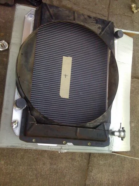

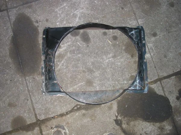

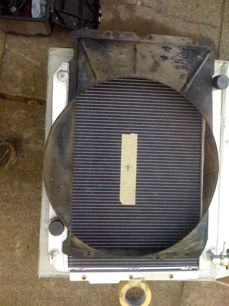

Some fan shroud hacking. Turns out the stock 60 shroud fan location is vertically correct if you flip the shroud upside down. Then you need to cut off the left and right side and patch it together to fit the radiator.
Pics in order. The unmodified shroud flipped over and centered where it should be, the long side of another shroud cut off and placed where it will mate with the main section, the completed shroud with both sides patched in. After it was patched together I added more metal in the "hoop" around the fan to get the majority of the fan blade depth to be covered about 50% by the shroud. Works well but to be honest its not the prettiest piece. The only finished and installed view is in the video.
