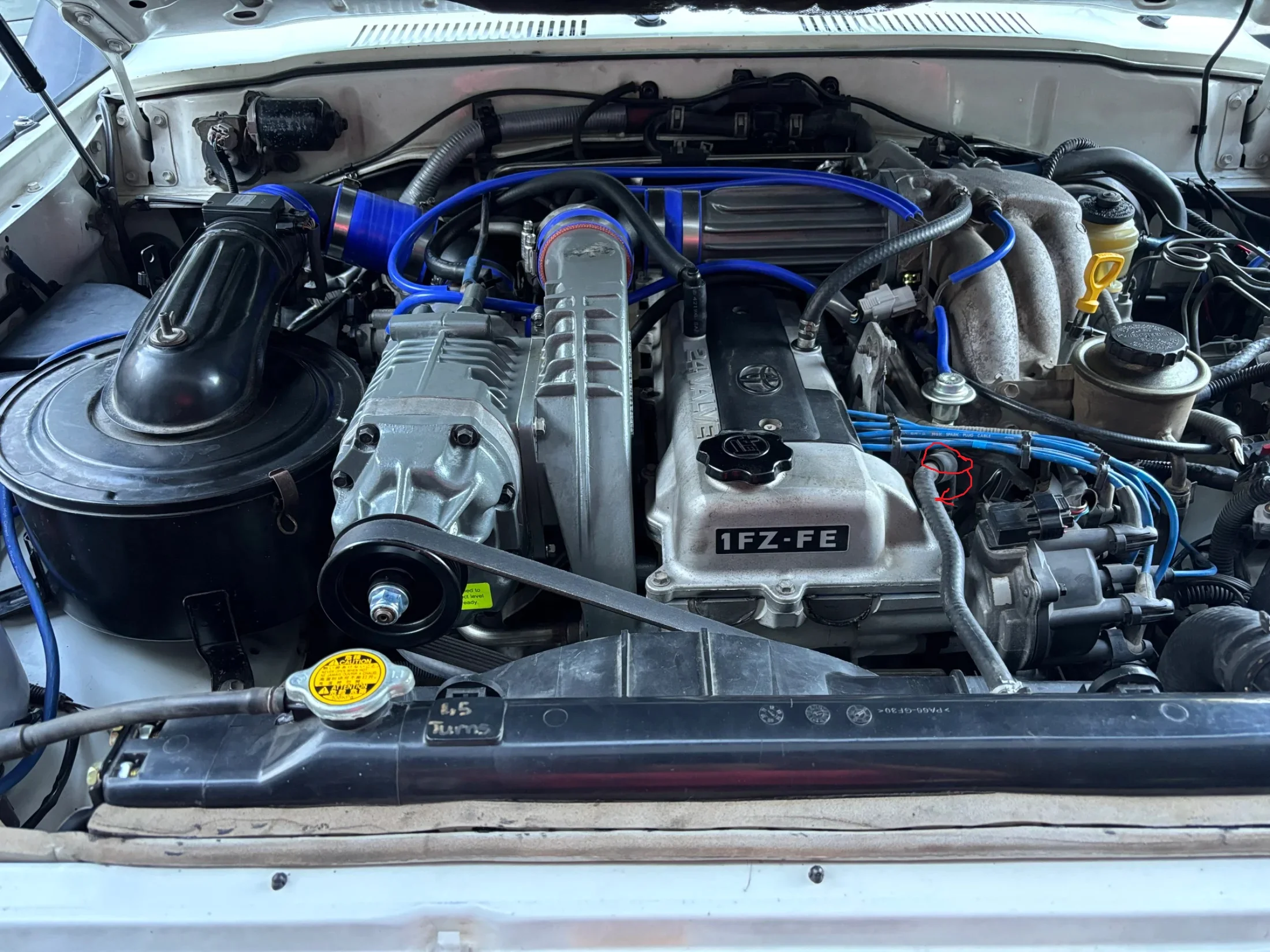

First start. 20 minutes at 2000 rpm for cam break-in.😃 Tried to load a video, but that didn’t work.
It’s alive! Took a maiden voyage down to the gas station to put some premium in it.

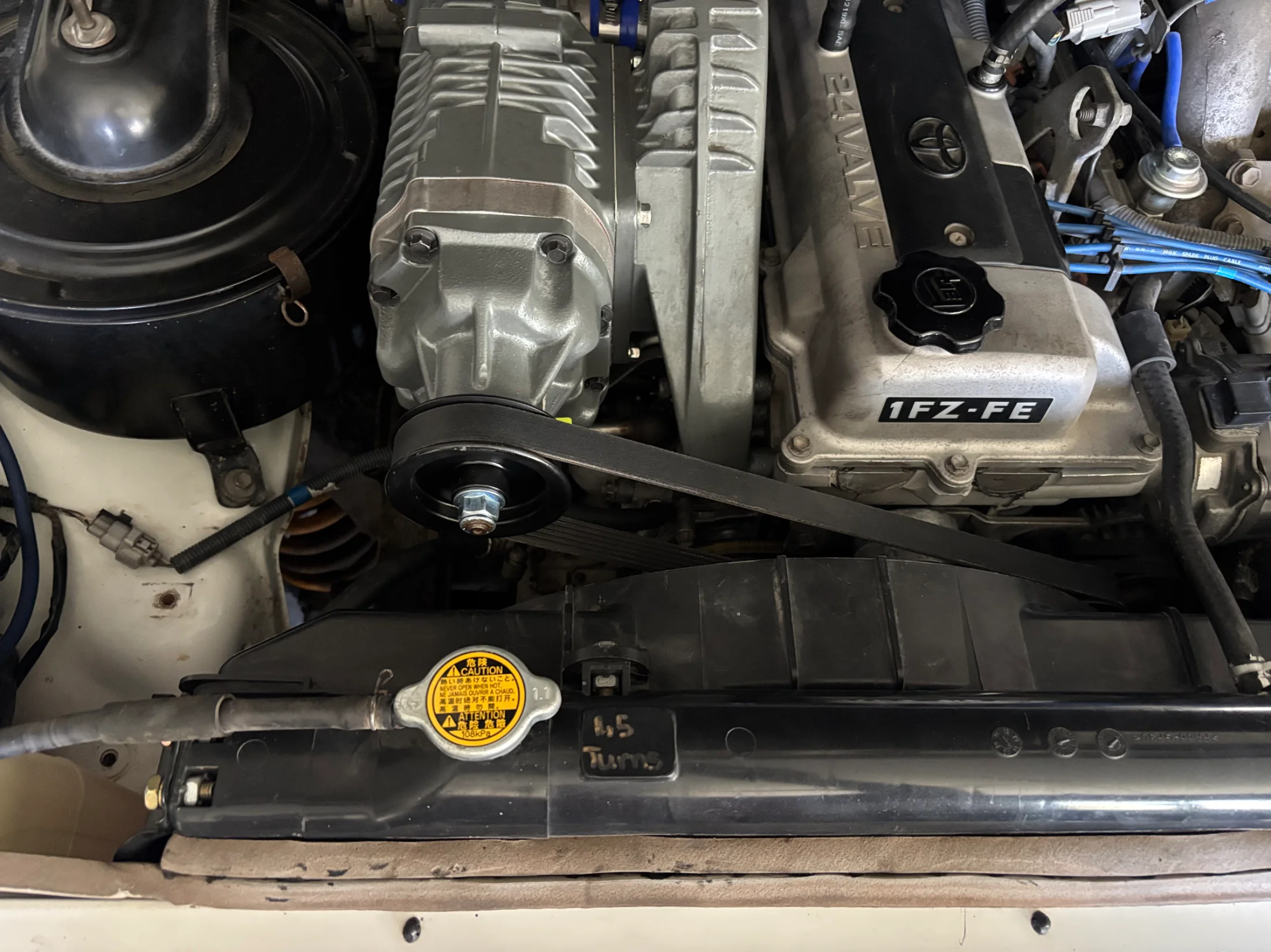

My OCD requires you to move the rubber sleeve a little bit towards the radiator.
Thank you.
cheers,
george.
Was it glued originally?
Don't know, may just be a friction fit. I just know that it normally rests against the flat part of the valve cover to protect the hose from potentially rubbing. See if it sits in place when you move it.
I'm sure Cdan or Beno can provide exact specifications of how it is retained on the hose and the force (in Newtons) that is required for it to slip/move :rofl:
cheers,
george.
Fixed.
