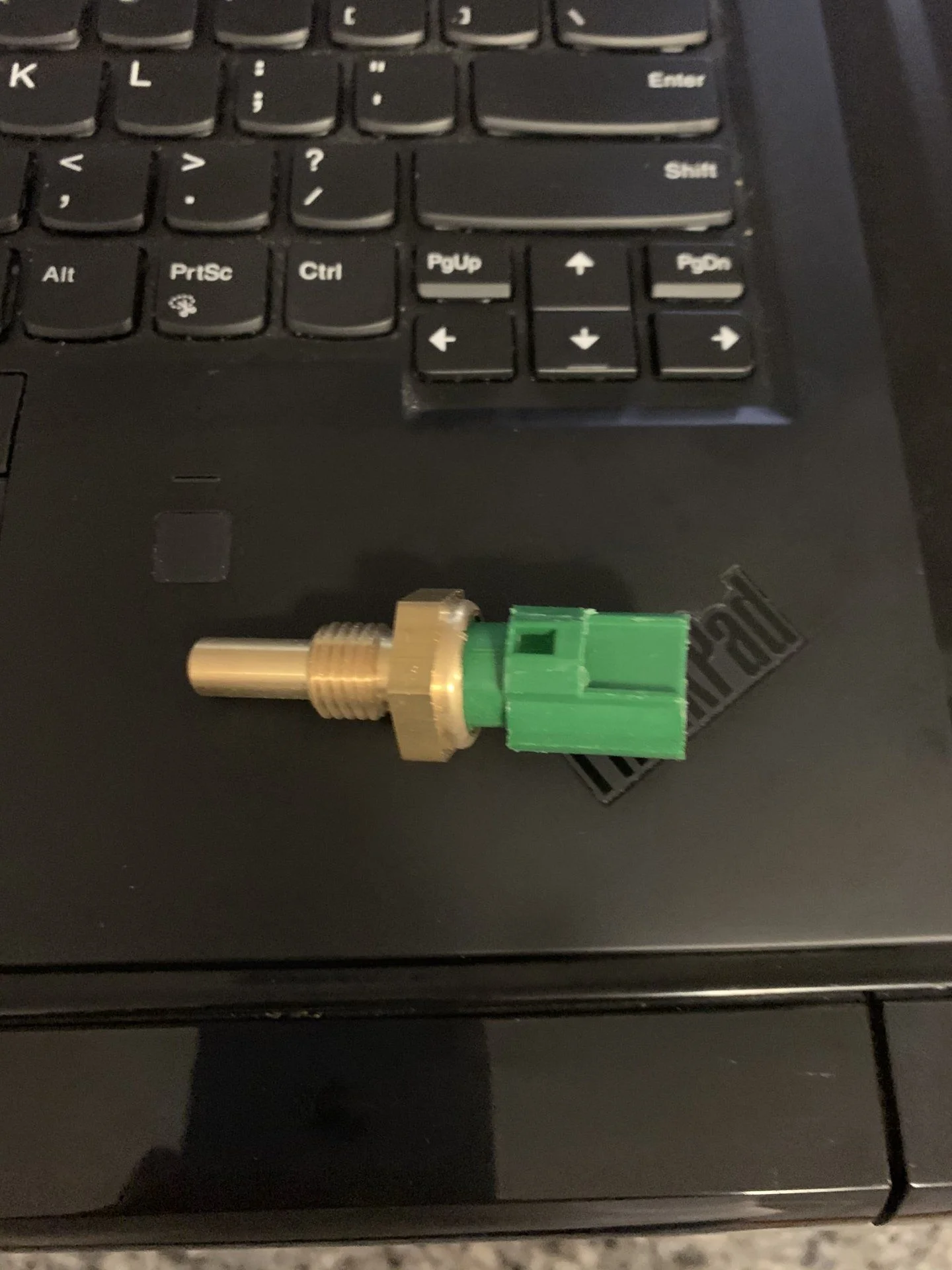

Is #18 the location for the temp sensor? Part # SU4007.
What you have pictured is the Coolant Temperature Sensor, it is located right next to the Coolant Temperature 'sender' (#18).
The Sensor has a green top (as pictured above) the Sender is Gray. The Sensor connector has two wires, the sender one.

@flintknapper Thank you. The thing has changed color over 20 years. Hopefully comes out without messing up the harness.
That harness should come off OK, it's the one next to it (Gauge Sending Unit) that gets brittle and breaks.
