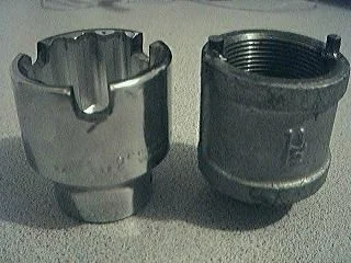

I wouldn't mind seeing a picture of that bad boy, as I can't quite visualize what you're saying with the three slot thing.

Taken with my webcam. The one on the left is for the FF rear axle in the 80 Series, and the one on the right is for a 2nd gen. 4Runner. I made the 4Runner one first, and hadn't thought to make it out of a socket to begin with- it has a nut welded on the bottom, which you put a socket on, and then a torque wrench- not very efficient. Cost less- made with a plumbing fitting, nut, round stock and a small piece of plate, but quite labor intensive with all the welding and grinding. The socket was much easier, and could be made in the same fashion as the other with nubs instead of slots if you wished, although that would require either welding or a lot of grinding.
Socket is a 2" twelve point.
-Spike
Ahh... nice work. I see now. So you're actually cupping the screw heads on the special lock nut, instead of a pronged version that inserts into the holes of the lock nut? Haven't thought of it that way.
:beer:
Rookie2
IIRC they weren't 'screws', but I think you've got the idea. I never figured out what they were exactly, did I miss some adjustable thingamajig? There were the standard phillips lock screws, removed via impact screwdriver. Once the lock screws were out, the locknut came off by hand. Never having seen the SST or an FSM I assumed that the nubs on the locknut were meant to interface the SST.

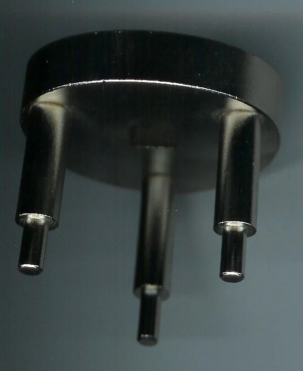

Here is a real one.
This is a "real" real one. this is a Japanese tool. The current factory SST's are made in the US and are a black oxide finish.

Same purpose as the 2 pins on your plumbing coupler.
Not the nubs on the tool, the nubs on the locknut.
-Spike
