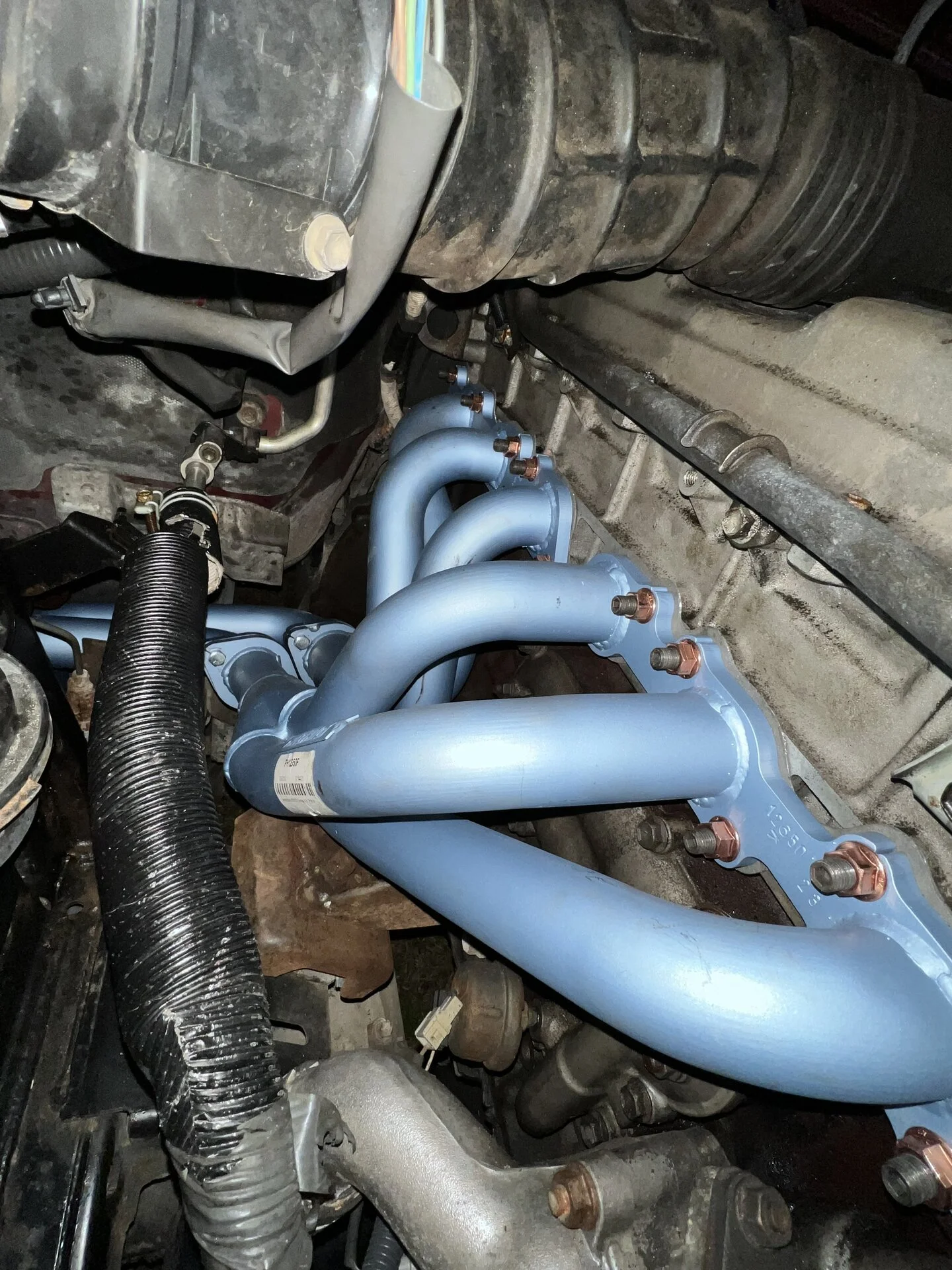

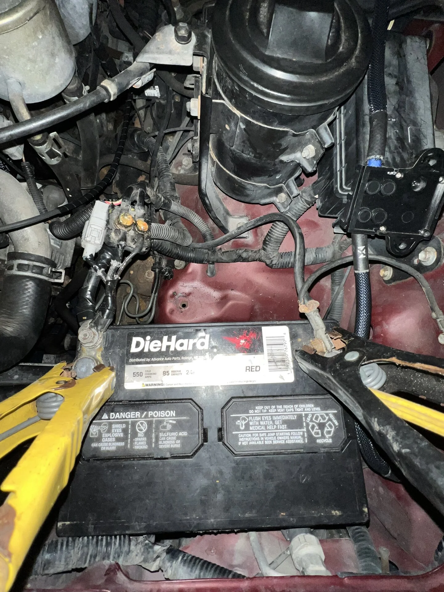

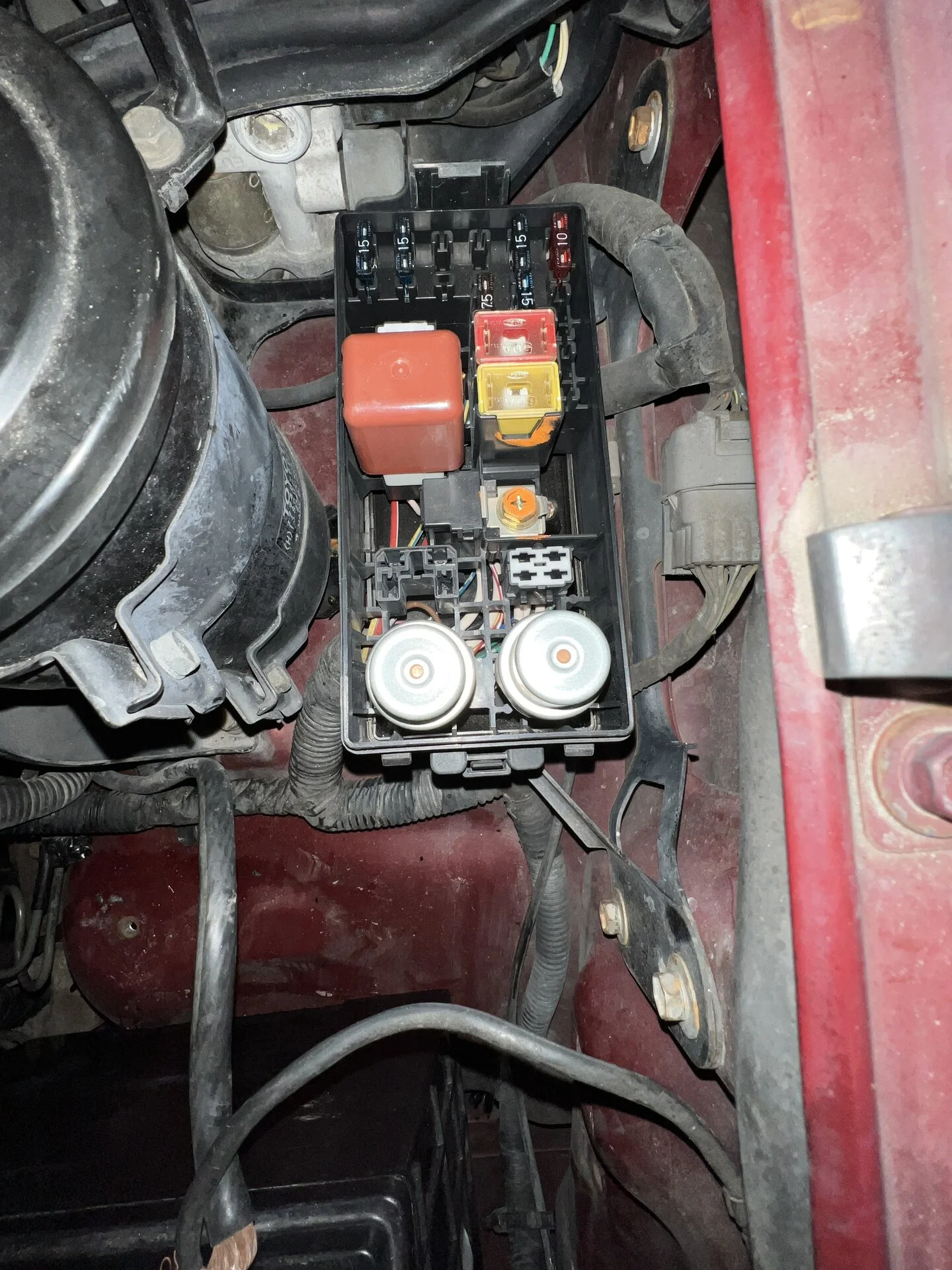

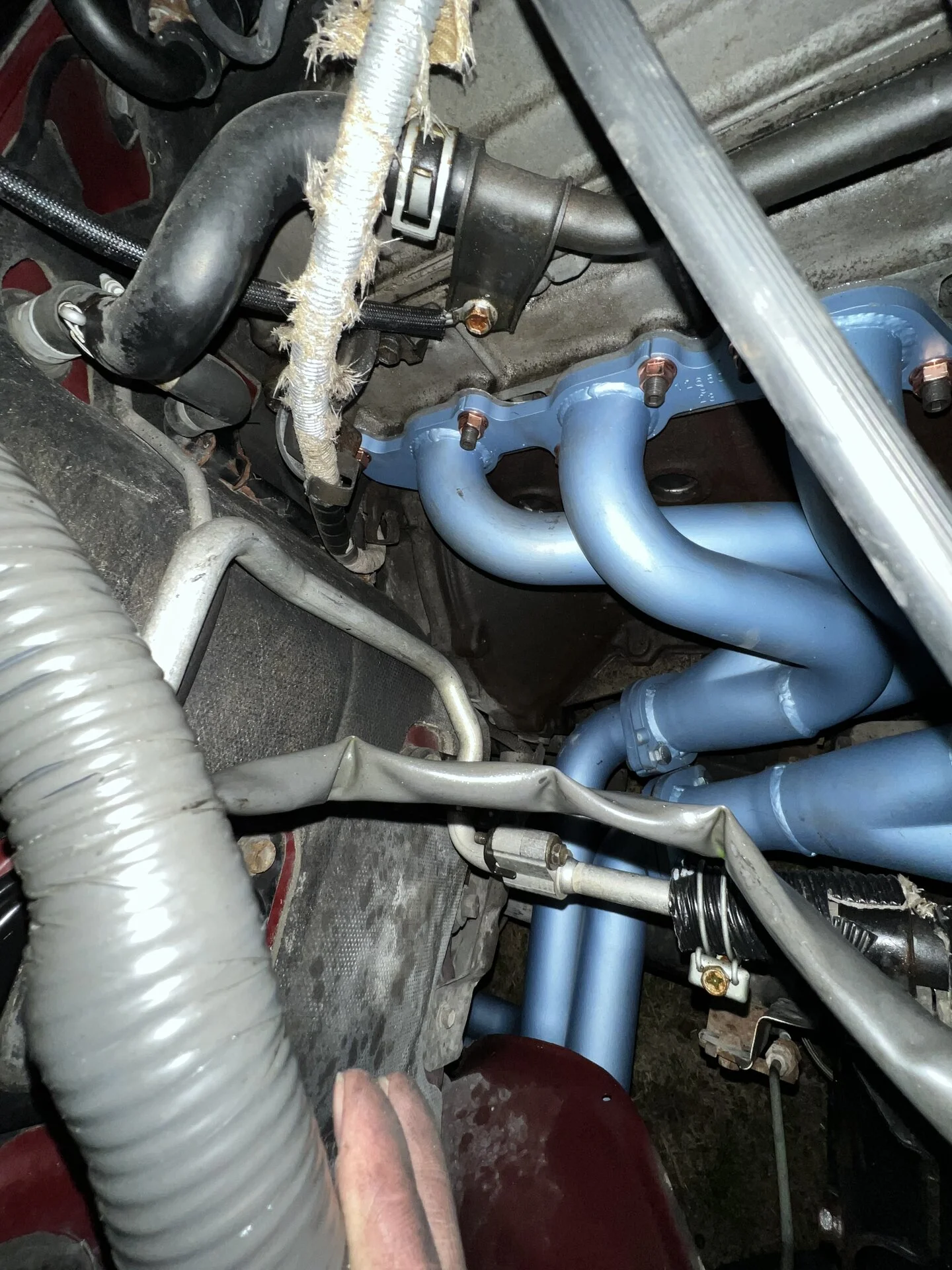

Just some background info in case it helps. 1997 1fzfe 80 series 315k miles. Recently installed a new exhaust system which blocked off the EGR port. Ran fine for 3 min after the exhaust install then died and never started again. The motor turns over and it starts for about a half a second and it shuts off. I have checked a couple of things: alternator, fuel pump relay, battery. I ordered a fuseable link to see if that does anything. Here are some pictures and once i figure out how to post a video I will post one of it trying to start. If anyone could guide me in a better direction or help me with some troubleshooting I would really appreciate it :)
My first suspicion is that you have disconnected/broken the connection to the MAF meter. The ECM does not get the signal telling it that air is flowing into the engine, so it assumes the engine is not running and does not energize the fuel pump. The engine will start because of the start override for the fuel pump. As soon as you release the key from the start position, that override is canceled and the engine dies.
Check and make sure you have not dislodged the plug at the MAF. I have seen it happen a couple of times, including driving down the backroads when the retaining clip was not properly engaged. Make sure you have not damaged the harness that runs from the firewall(ish) to the MAF. I believe that the harness in your pic, right beside the exhaust, with the grey sheath over is it.
Check and make sure you have not dislodged the plug at the MAF. I have seen it hapen a couple of times., including driving down the backroads when the retaining clip was not properly engaged. Make sure you have not damaged the harness that runs from the firewall(ish) to the MAF. I believe that the harness in your pic, right beside the exhaust, with the grey sheath over is it.
