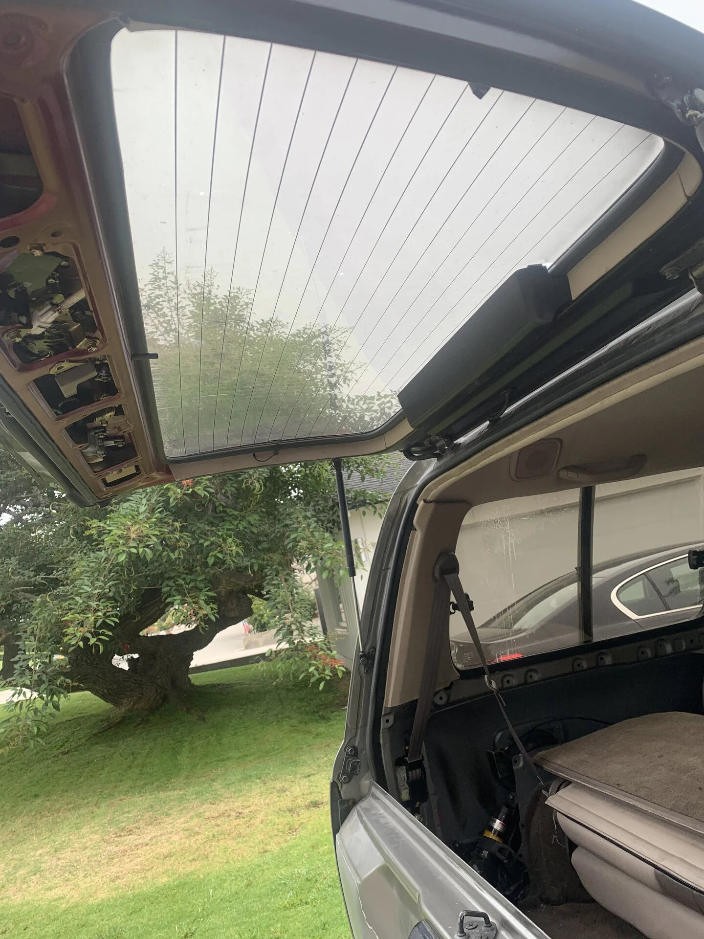

Thanks for the reply. And yes some clarification is needed and pictures speak volumes. Looking to remove the upper brake light and all trim from around the glass of the tailgate(lift gate) in the picture to repaint. Thanks again
For the third brake light, push in the center of the pins (look like plastic rivets) and pull the whole retainer out. Then the cover pops off. The small trim panels around the glass seem to have an adhesive on them, and I left them in place and masked them.

Thanks Jason for the clue of the pins. And yes the trim seems glued and maybe under the glass. I’ll check further when I pull the glass. Thanks again.

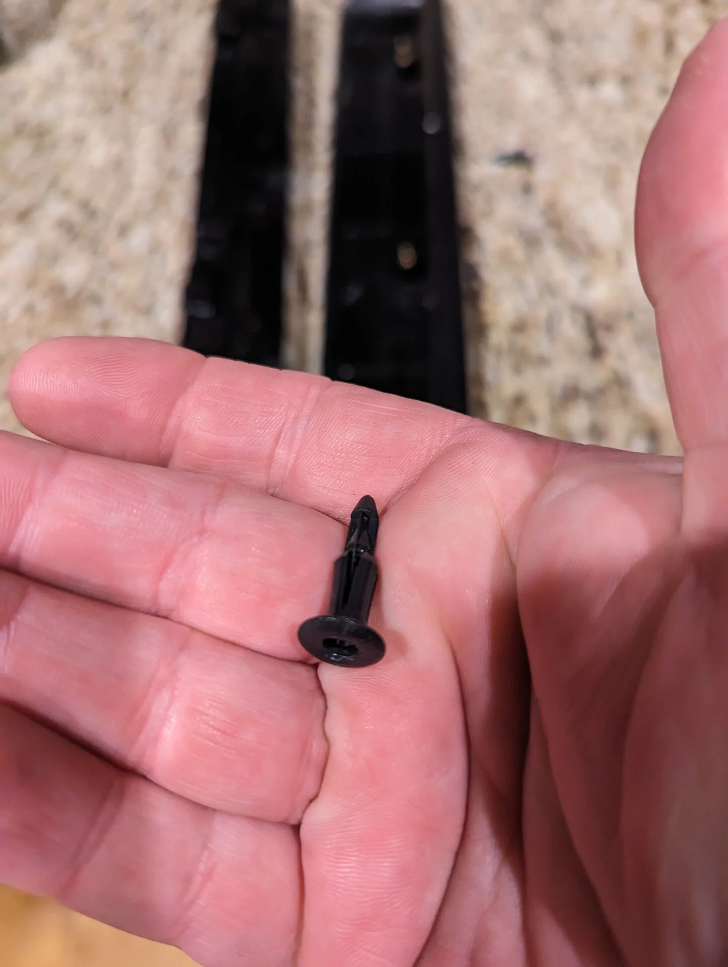

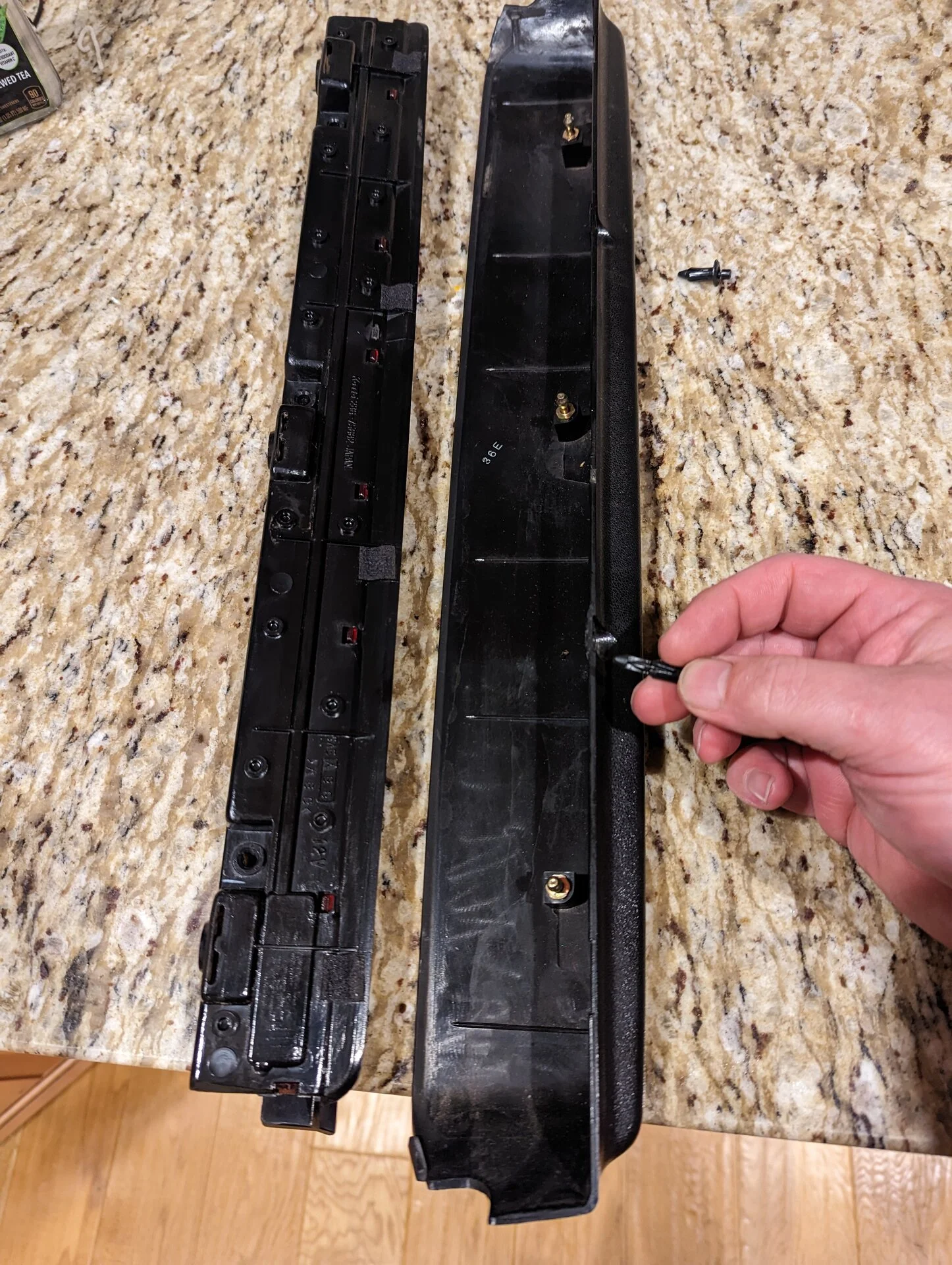

Since I have these just sitting here....
Gold pins insert in to holes in bottom of third brake light, two push pin rivets in from the back.
Pin pushed in to remove in this pic. Push back up to re-install.
Jason

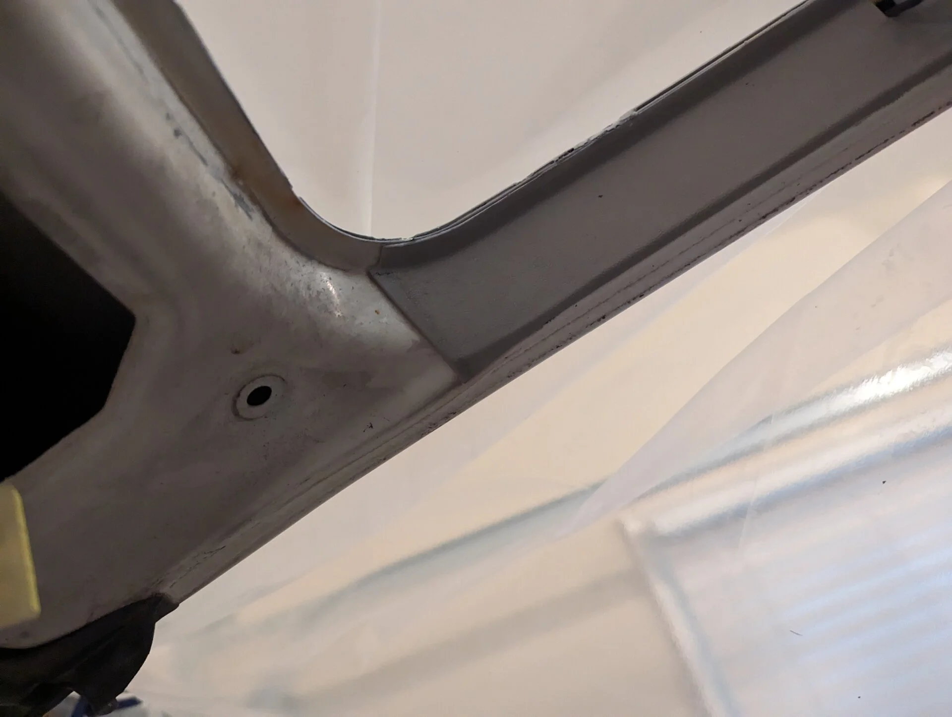

The trim 90's up with the pinch weld goes under the rubber....
And I have some cleaning to do.
Jason
OK Jason. I got the light off and all of the brackets, electrical, etc. I was also able to gently pull away all of the trim. I used a trim removal tool, and gently worked my way down releasing the double face adhesive, tape, whatever. It was kind of slow going, but it all came off without breaking. Thanks for all of the advice. You gave me the greenlight!
