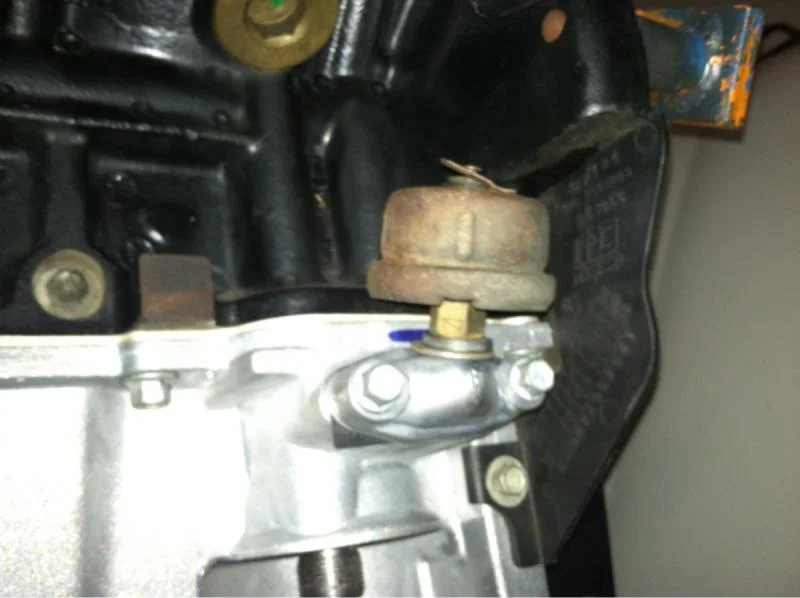

Little more work done today. Motor mounts cut out and frame cleaned ready for the new drivetrain. Did some wiring work and place the oil sender in the pan.

Do you still use Ditry Dingo ?

Block off comes on trucks and cars with out the oil cooler. I don't have a part # but a super common part at any dealer. When I mount the motor mounts I will snap some pics and they are yes still Dirty Dingo's. Anything we do in life we learn new avenues and means to make something easier and faster. The main point I never lose though is staying meticulous and run the same pace to achieve top notch work. Man up and send me your cruiser and let's do an LS3 with a 6speeder :D !!!!!!

I think I reused the block off plate that came on the truck pan my motor was equipped with. It's a simple swap over to the f body pan.
One think I love about these motors - every single gasket is assembled dry. No sealer is used. They are all metal bonded and formed to be a perfect fit and hold their shape. The pan swap is a 10 minute job including the swap over to the f body oil pickup and windage tray. The sealing technology is light years ahead of the 1fz.
