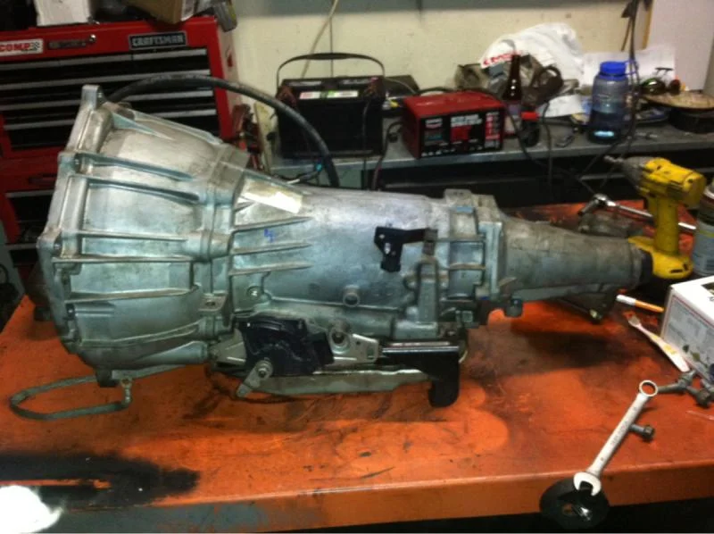

Adapter is on the transmission and ready for the tcase. 1FZ and auto is coming out tomorrow of the Lexus. 6.0L and transmission to follow.
