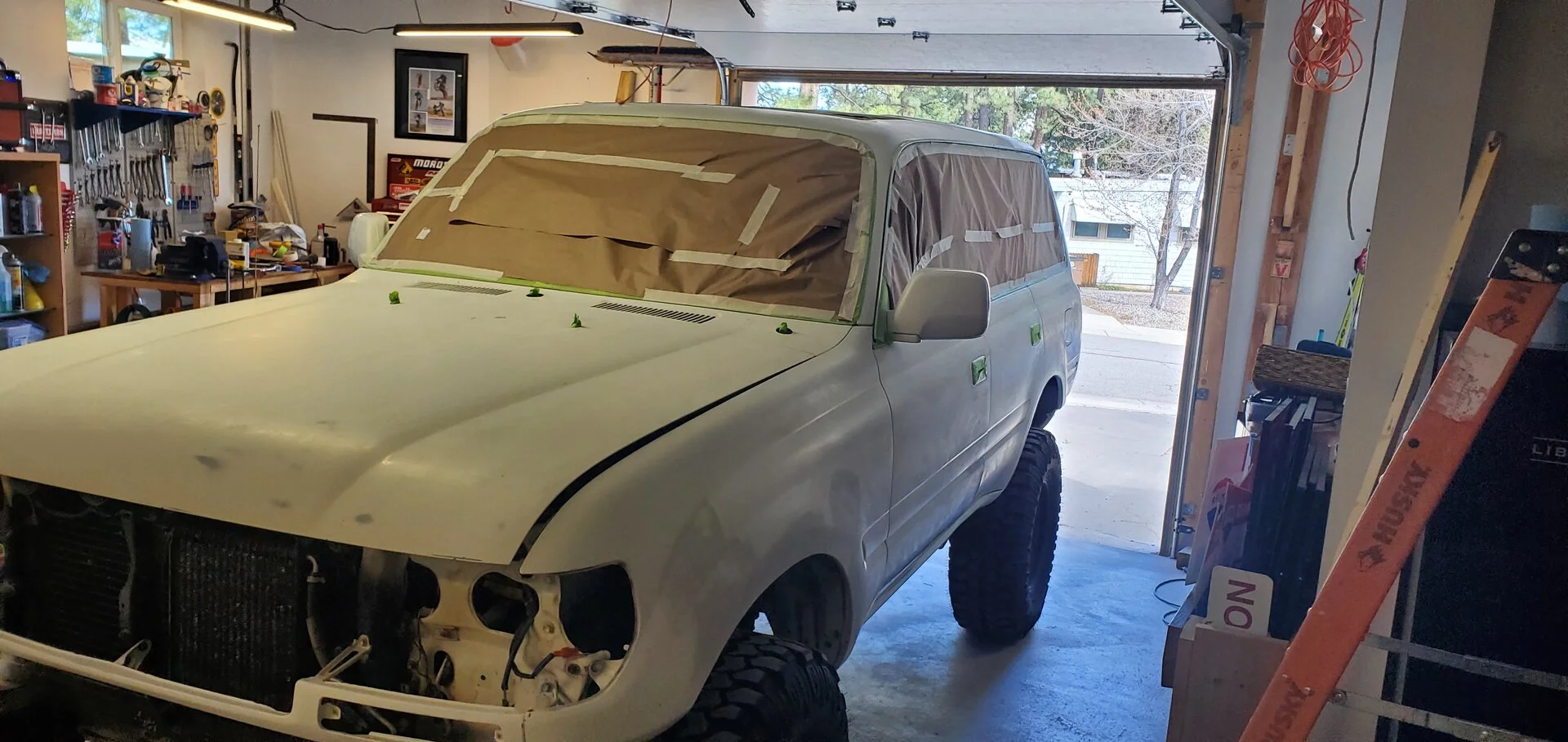

Not banged up too bad. Clear is peeling a bunch. I could repaint it, but I'd just scratch the bejeebus out of it on the first trip. I know there are some who won't approve of the monstaliner choice. But, I like the way it looks, and it is durable.
Monstaliner is low maintenance and I'm sure not having to worry about your paint whilst out exploring is worth the peace of mind. Added protection is a plus too. White monstaliner appears understated when applied, which I like. Are you staying with white or going another direction?
Staying with white.

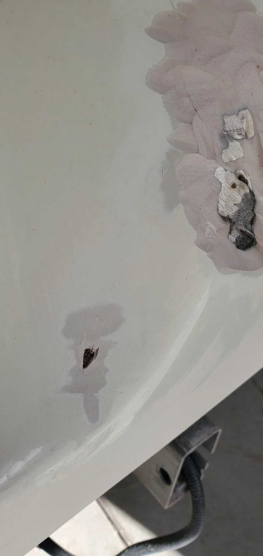

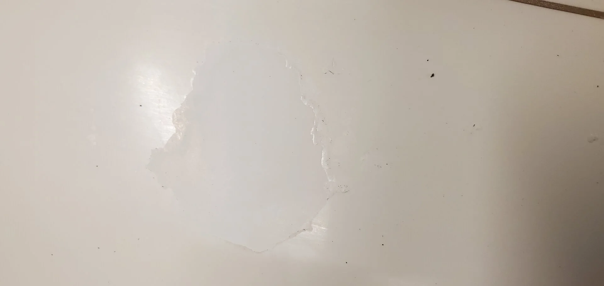

I did consider raptor, but heard good things about Monstaliner, so giving that a try. Mine definitely has clear. Here is a pic of one of the numerous spots.

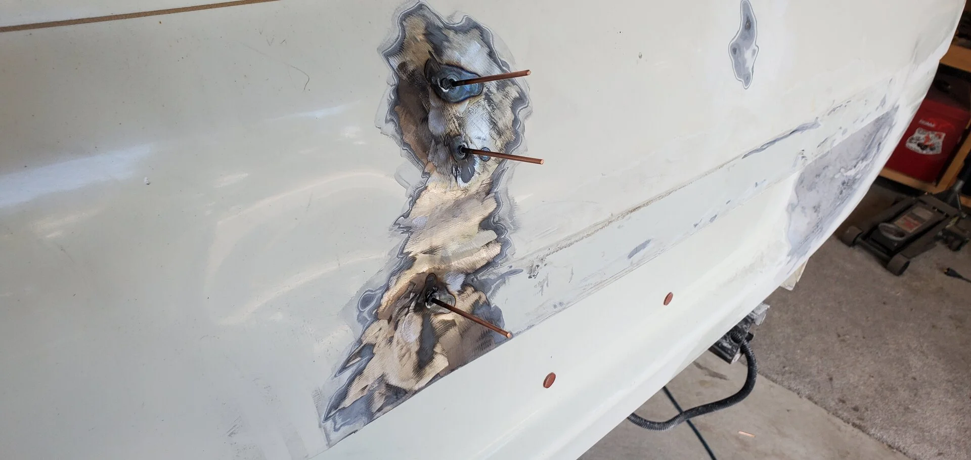

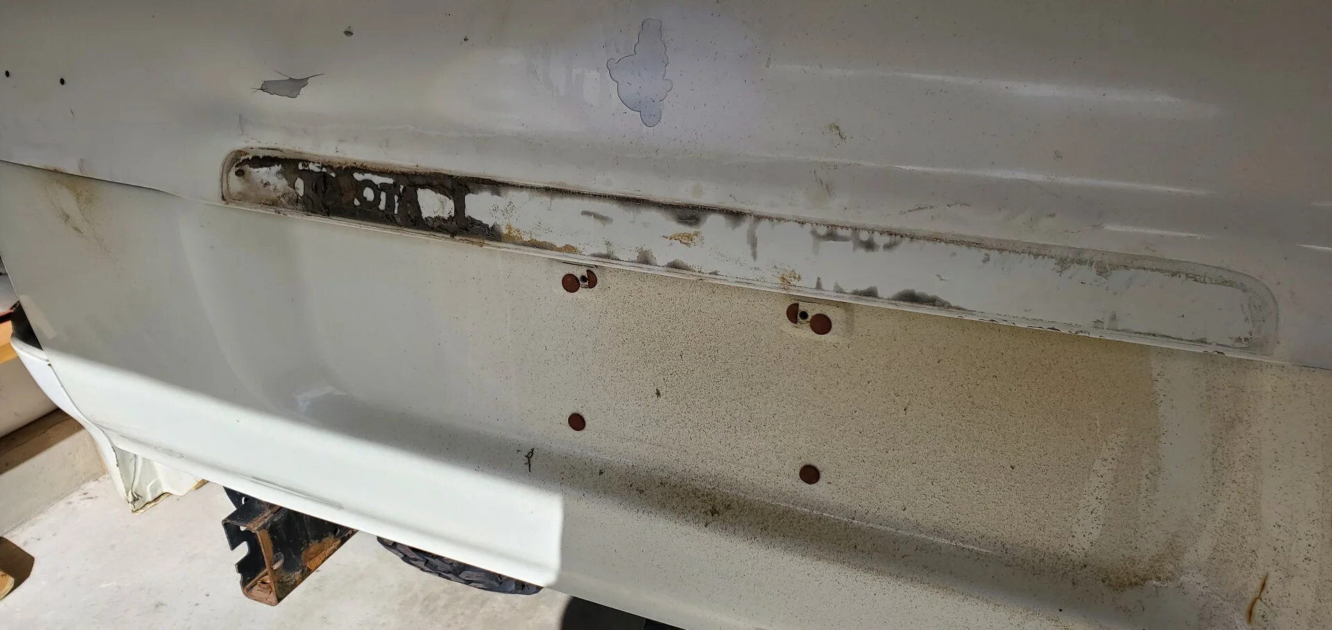

I had some dents that I am working on smoothing, and I noticed an area on the tailgate that had some cracking. Turns out is was a previous repair with a significant amount of bondo. So, I removed the old bondo and will work on that area also.
I also got a rubber eraser wheel for removing adhesive. Works pretty well.

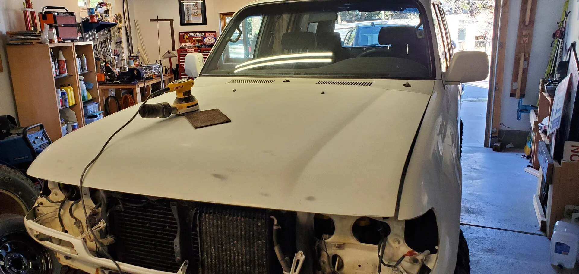

Is this their stock "white" color? How did you apply it? How many gallons did it take? Do you have any insight for getting the Monstaliner in those tight spots (rain gutters, etcetera)? It looks great! Weighing my options as my truck needs a paint job.
@Atomic City
Yes, it is the white color. I rolled it on. I took a bit under 2 gallons. However, I didn't do the door jambs or anything that you can see when you open doors/liftgate/etc. I imagine if you did all of that, you'd use every bit of 2 gallons.
I didn't apply it in the rain gutter, as I didn't want it to interfere with my roof rack installation in any way. The only spot I really had trouble with was under the rear view mirrors. You can dab it on with a brush and they supply a small sponge that you can sort of texture it with, but it is still difficult. If I were to do it again, I'd remove the rear view mirros. I taped off the door handles, mirrors, washer sprayers, liftgate lock, and removed other things. Some apply it to their door handles and mirrors, but I am going to black those out in the near future, so I decided not to.
Buy several extra rollers - they degrade fairly quickly.
Application is pretty straightforward. The most time-consuming thing is the prep work. They have it in the instructions, but make sure you are working in an area with great lighting. The only spot I'm not super pumped about is a couple of areas on my hood, where I couldn't see quite well enough due to poor lighting. You can sort of see roller marks in two spots there. I could have easily addressed those had I seen them. But, overall I am super happy with the outcome.
