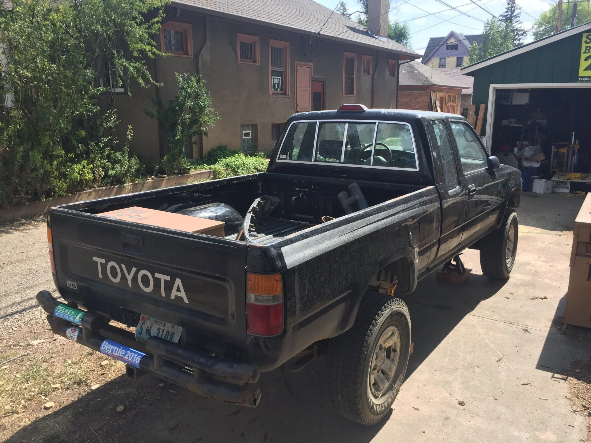

I have an old and busted Toyota pickup, paid off, but old and busted.
Not for long.
Fall Plan:
1) Yank motor.

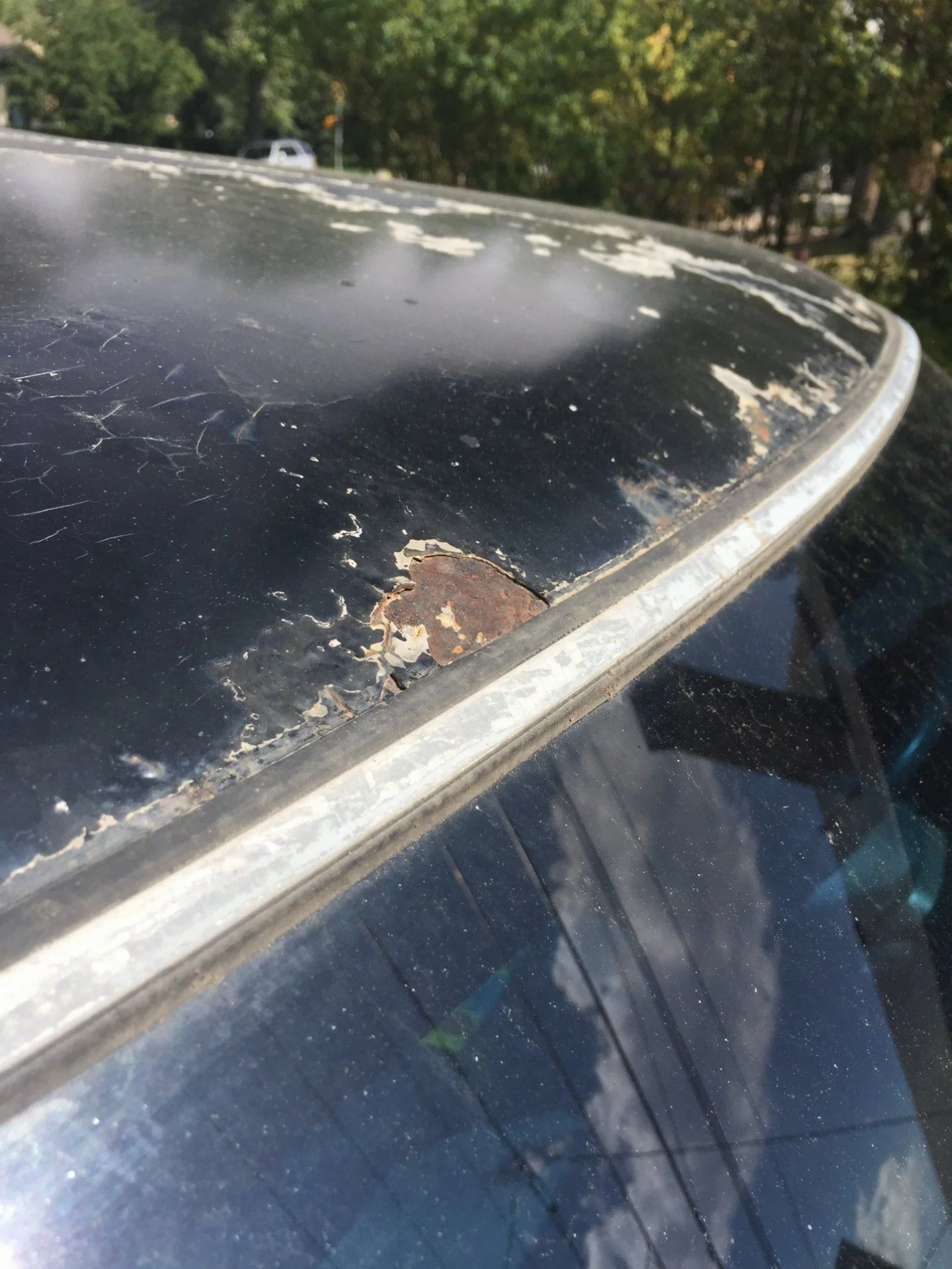

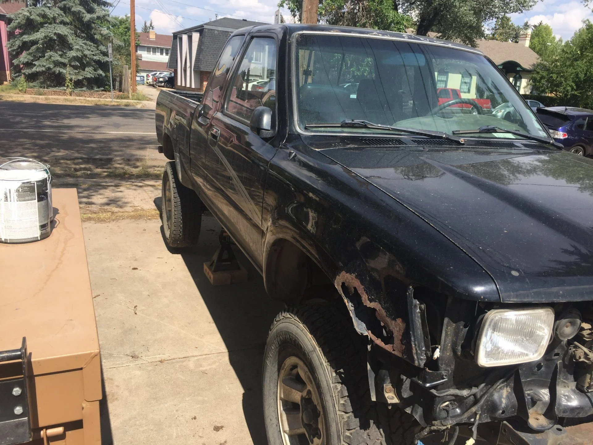

2) Tow to body shop for patches on roof.
3) Order new fenders.
4) Pull bed.
5) Design / build / install a hydraulic dumper lift.
6) Install stake-side flatbed.
7A) Send 3VZE to shop in Front Range or Denver for rebuild.
7B) Order rebuild / parts for a 5VZ-FE from 'Off Road Solutions'.
Winter Plan:
Hibernate.
Spring Plan:
Install new fenders.
Sandblast and paint (silver).
Install all the junk that gets finished up / arrives over the winter.
Install Old Man Emu suspension.
...More later

Am planning on welding up new bumpers or buying Warn bumpers. The Smittybilts are totally rusted out.

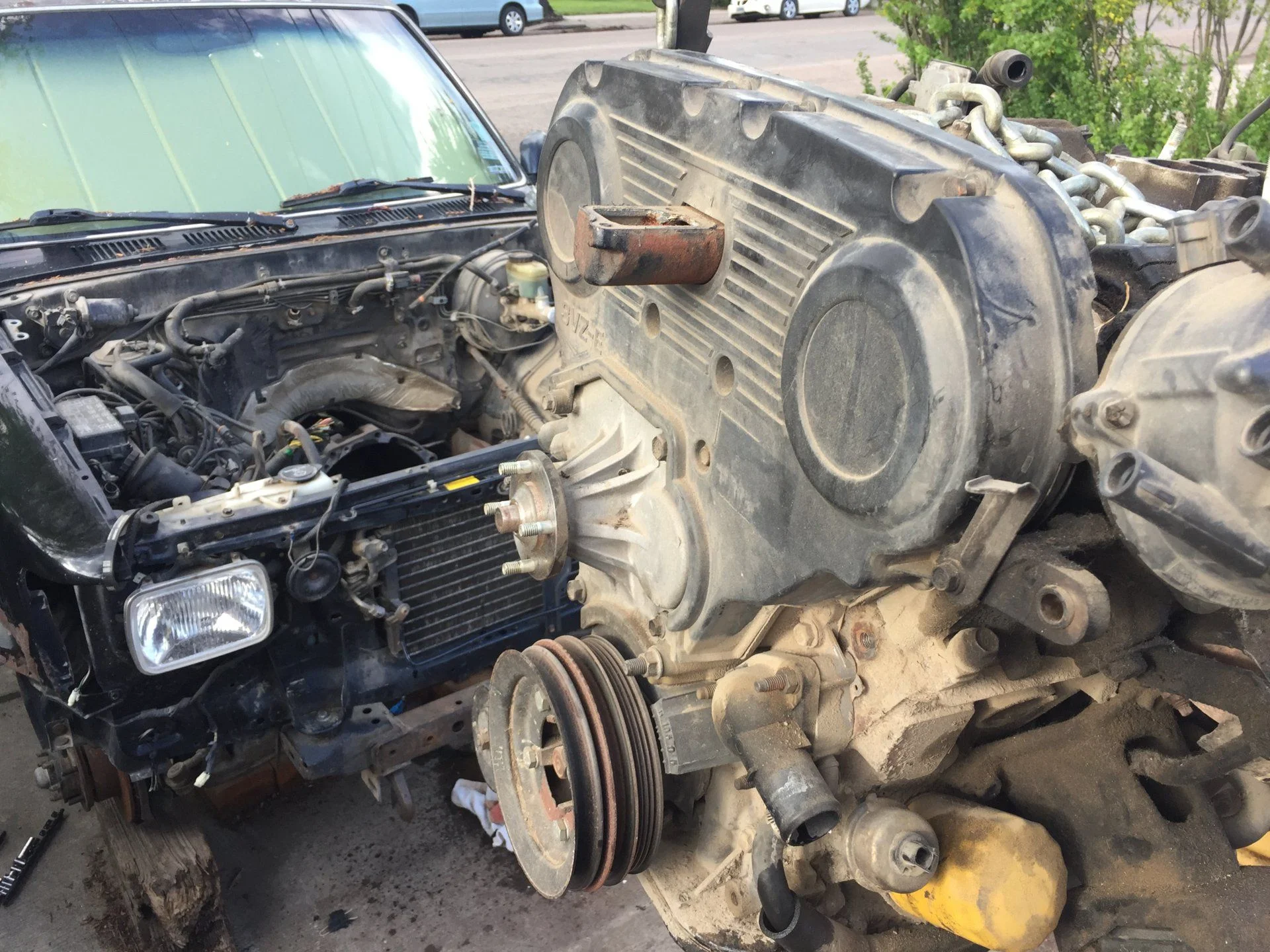

Never pulled a motor before.
Some of these bastards are tricky!
Passenger side motor mounts must have been installed by a team of japanese wizards or something.
I believe a few of the bellhousing bolts are hexed... or possibly rusted.
(You know you like the pun.)
What’s the trick on the shifter boots??
Power steering pump is captive due to pulley? Do I need a gear puller?
I thought I had it off before for the timing belt. Don’t recall the proceedure.
Okay. So, if it isn't clear by now, this is my first time yanking a motor on my lonesome.
I'm pulling the motor and transmission out as separate units on the advice of a friend who worked in a local engine repair shop for years. Said it was the easiest way to get them out.
But I'm starting to think it will be very difficult or impossible to put in a new transmission (from below) and motor (from above) and get them to mate up *in* the truck.
I think it will be much more conducive to success (and happiness; less wailing and gnashing of teeth and busted knuckles) to mate the transmission and motor on the bench (or stand or whatever), and put them in as a unit.
What do you guys think?
Am I off base in thinking that it will be easier to get a solid seal on the bench? Is it worth the hassle of putting them in as a unit?
The FSM reads as showing how to pull them out and install them as a unit; so it can't be that bad, right?
I would never pull them together. You will be surprised how high you'll have to lift everything to get them out as a unit, and you'll have to cut out the radiator core support. How will you get them apart? You can't put the engine on a stand with the tranny attached.
Why are you even removing the tranny?

I just got done rebuilding my father's 91 toyota over the course of January. Just pull out the engine by itself, just make sure you support the front of the transmission with ratchet strap to keep from dangling there.

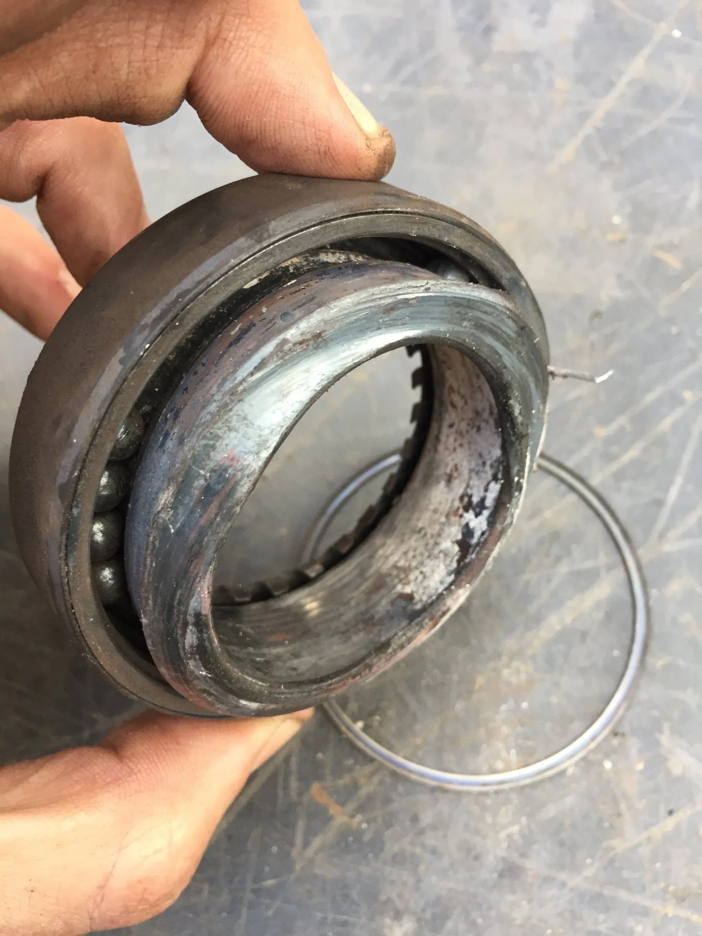

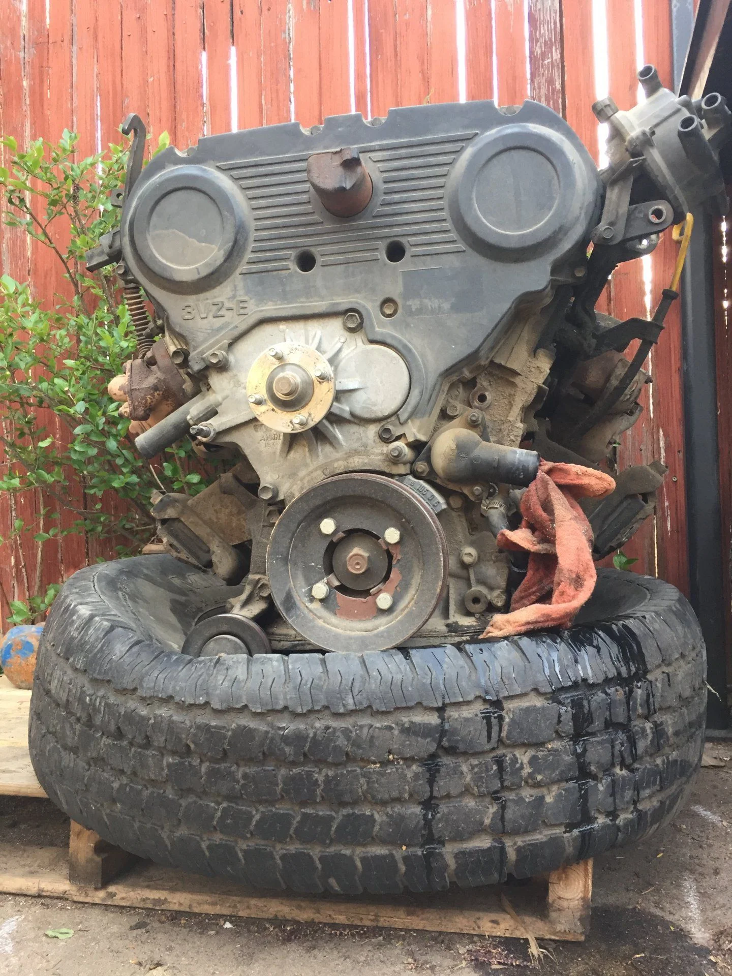

I got the damn 3.0 out!
The throwput bearing exploded... so there’s that issue.
Next on the way out will be the transmission, transfer case, etc.
Now to find a donor OM617.
