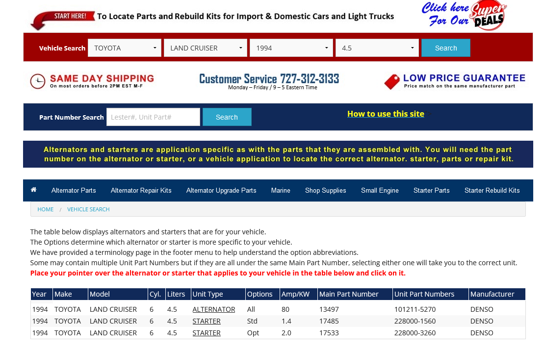

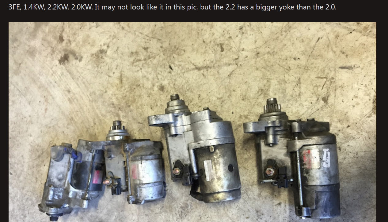

You have to select the vehicle, then the starter size: 1.4kW or 2.0 kW
with a nod to @arcteryx: (Post #1); ignore the 3FE; you most likely have the 2.0, but you need to be certain - the parts aren't the same
Here's the number you want:

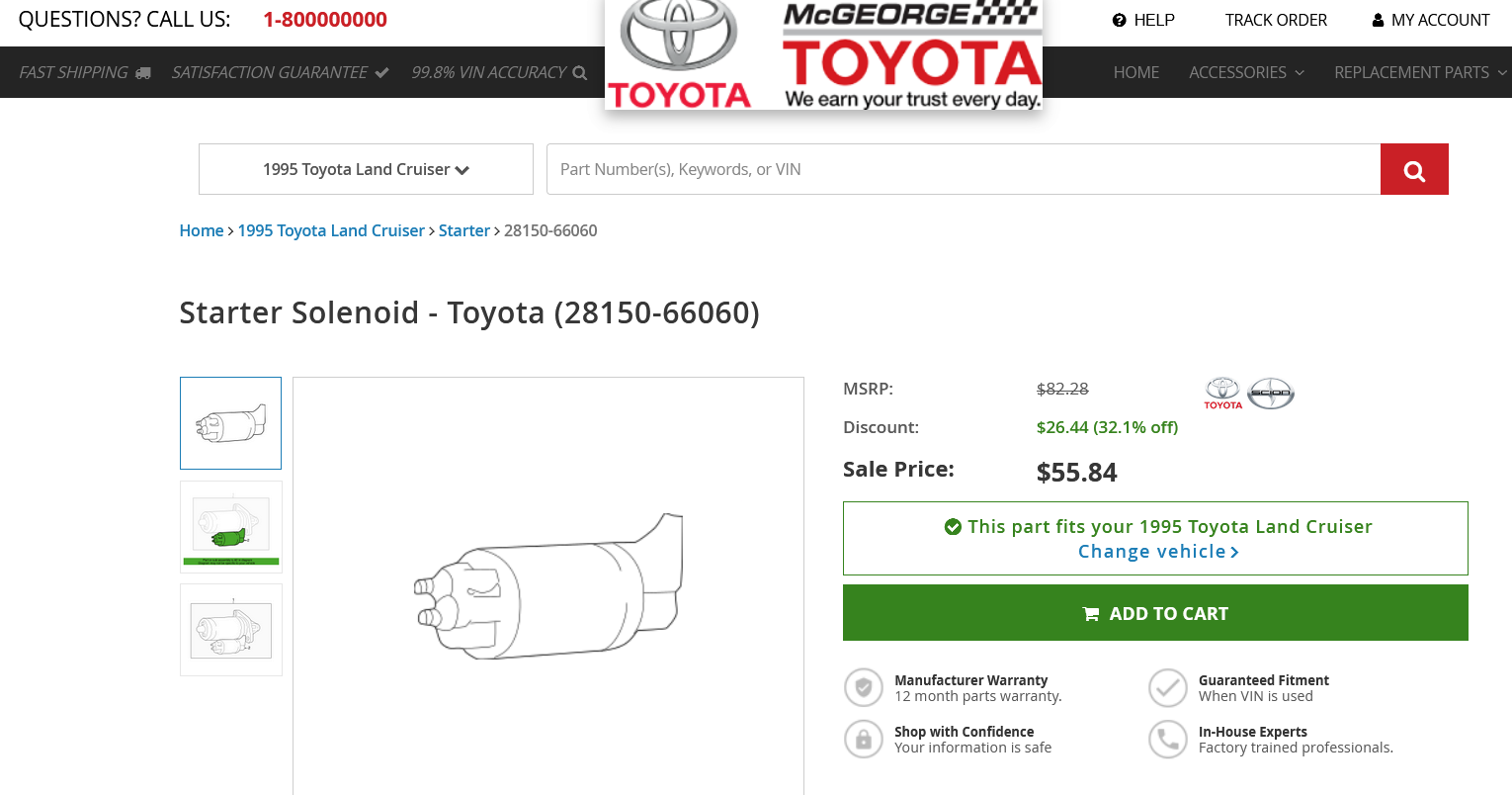

or, you can buy the solenoid rebuilt, from Toyota (McGeorge has a 30% off sale on now):
Thank you. I went into the site and called the place. Starters are in stock, the rebuild kit isn't. How do I know if I need the 1.4 or 2.0 Kwh starter?
The contacts aren't "bad" per se; their grasp just exceeds their reach. They have to be replaced. So, based on McGeorge's ridiculously low prices, I'd just buy a new solenoid. Keep the old one though; it can be rebuilt and used again. LMK if you replace it and don't want the old one.
The picture was perfect. Mine is the 2.0. Thanks for all the help on this thread so far.
