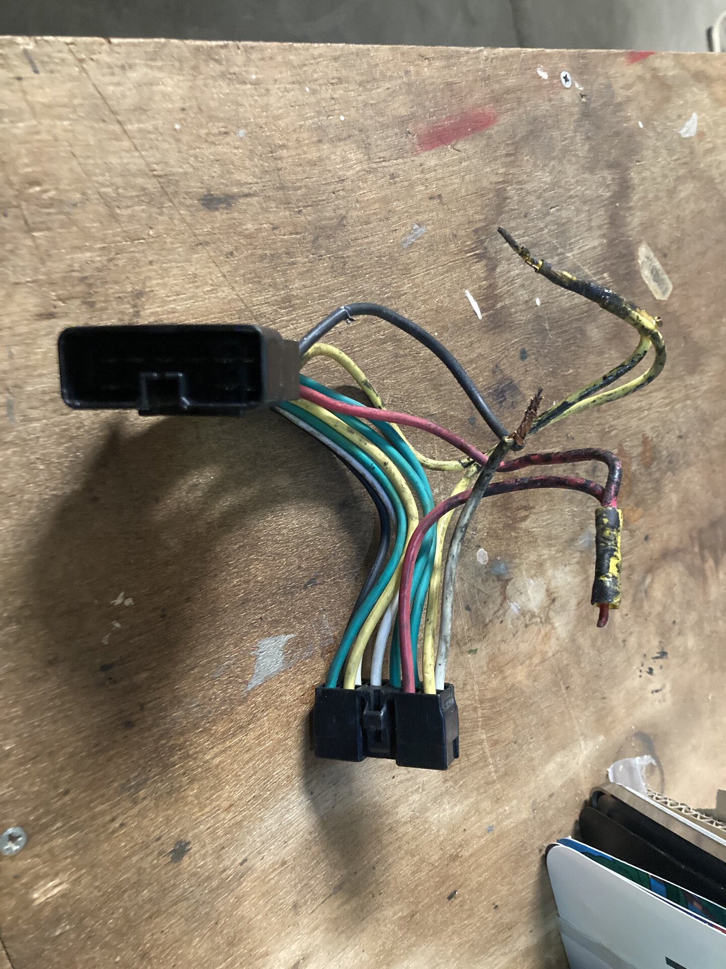

Also check your truck for remnant alarm wiring. Mine did the same, usually when warm. Traced it down to a hack wiring job by the PO on non-toyota alarm removal under the dash, near the ignition switch. I removed this in-line alarm system jumper and problem disappeared.

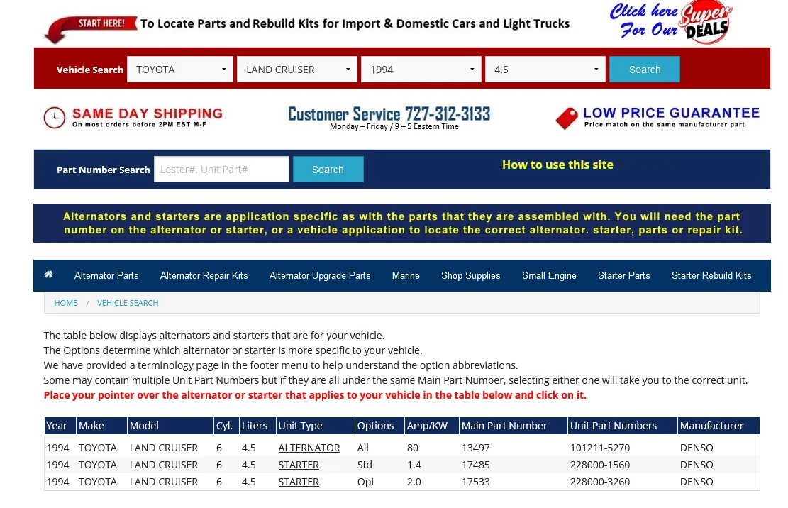

You have to select the vehicle, then the starter size: 1.4kW or 2.0 kW

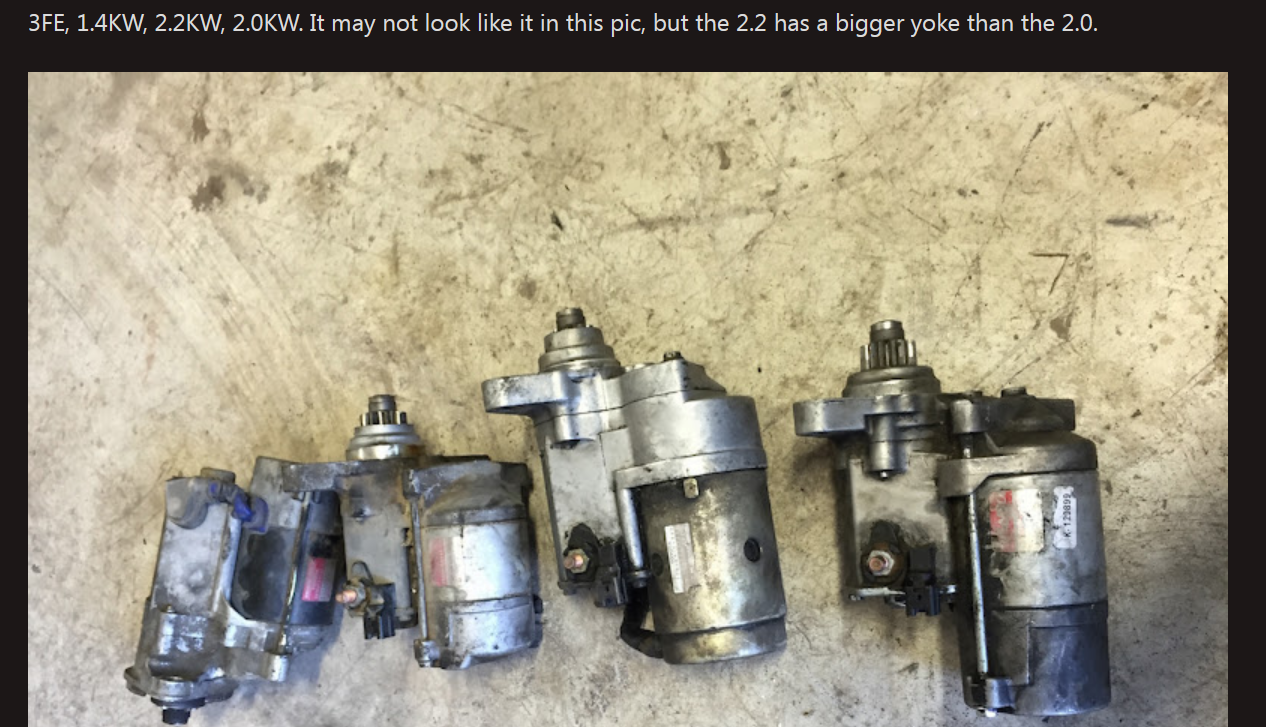

with a nod to @arcteryx: (Post #1); ignore the 3FE; you most likely have the 2.0, but you need to be certain - the parts aren't the same
Here's the number you want:

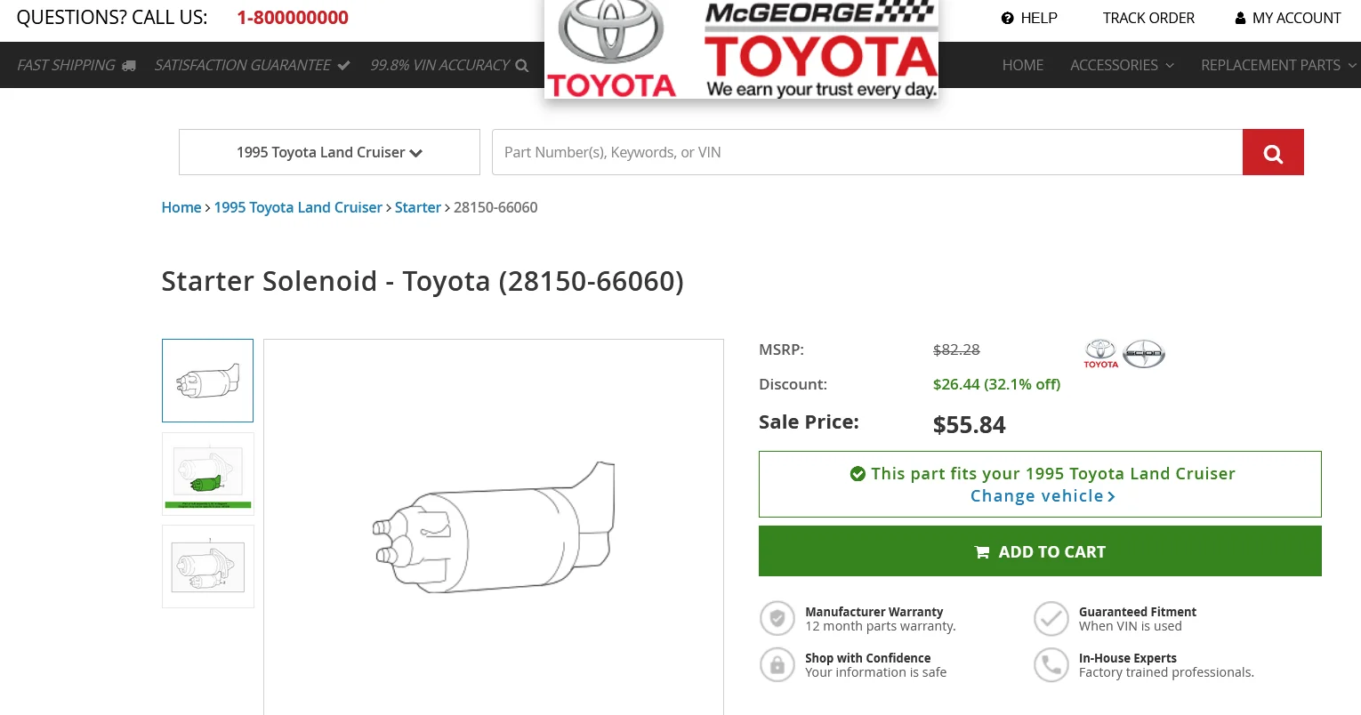

or, you can buy the solenoid rebuilt, from Toyota (McGeorge has a 30% off sale on now):
Interesting you state this because I suspected this as the first problem. The alarm arms and disarms, but only locks the doors, doesn't unlock them. I thought this may have been causing the issue so I stopped arming the alarm for awhile and just use the old school key to unlock. The problem went away, but then appeared again yesterday, so I suspect this isn't the issue. But I will check.
