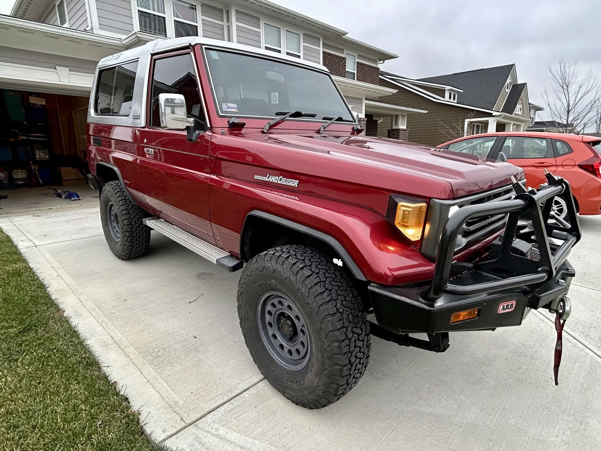

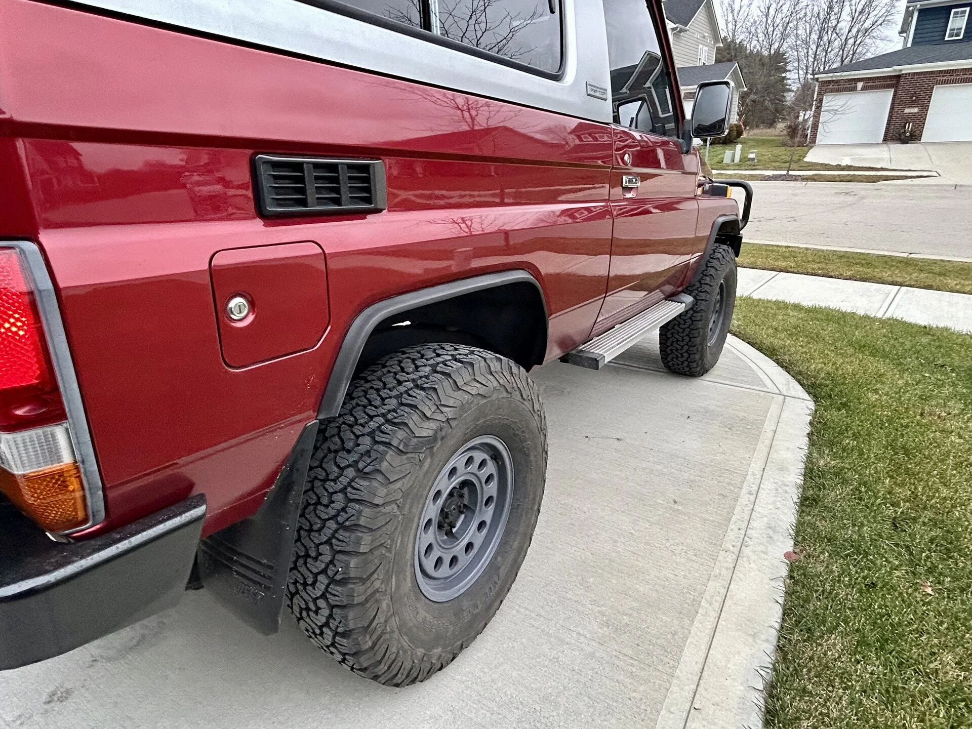

Since my wheels stick further out now I pulled the trigger on the 1 inch EZ flares. I gotta admit…. It looks hella good. I keep staring at my Cruiser more and more now.

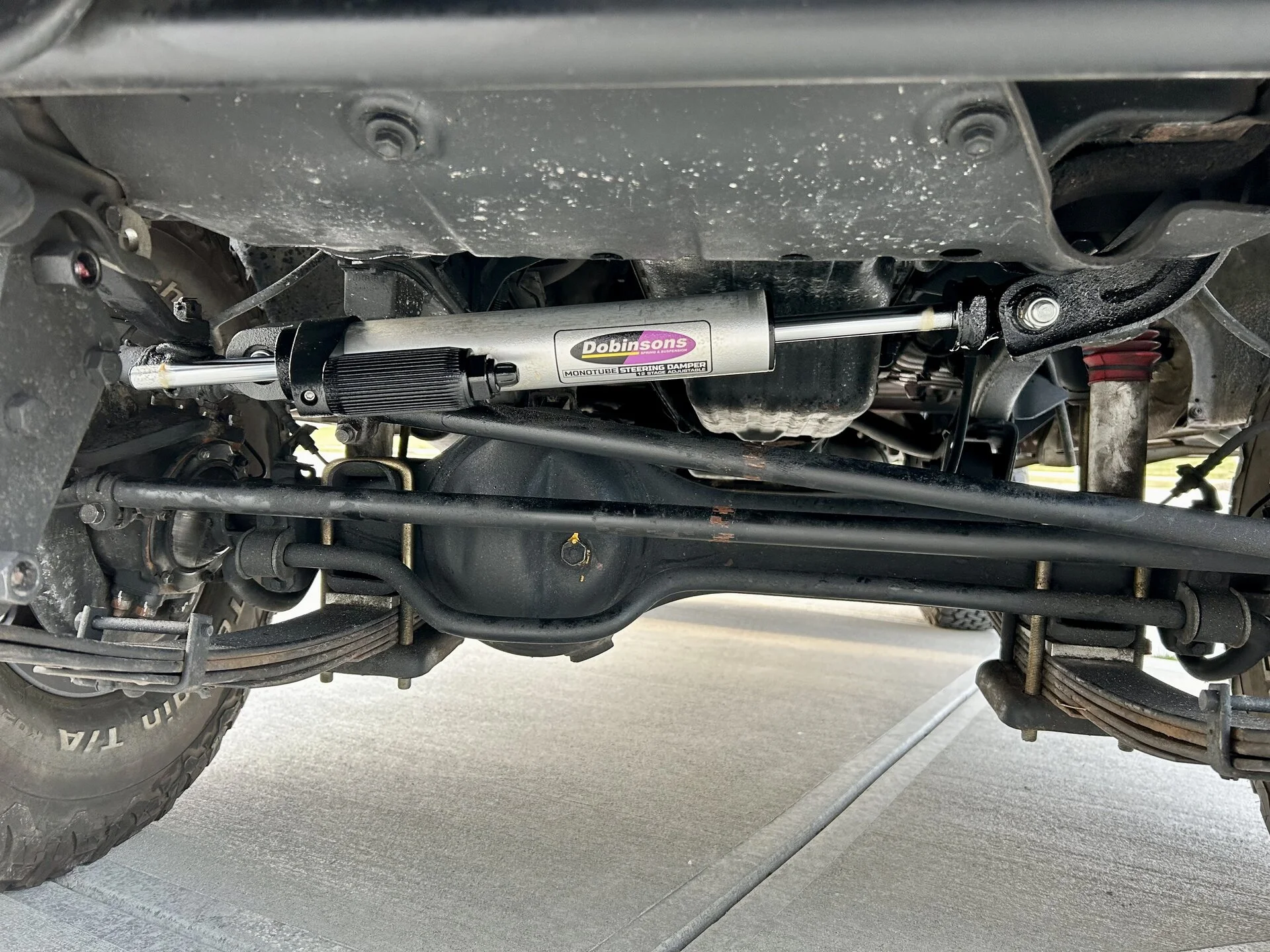

I installed a Dobinsons steering damper today. I really enjoy the feel of this over the OME one I had.
