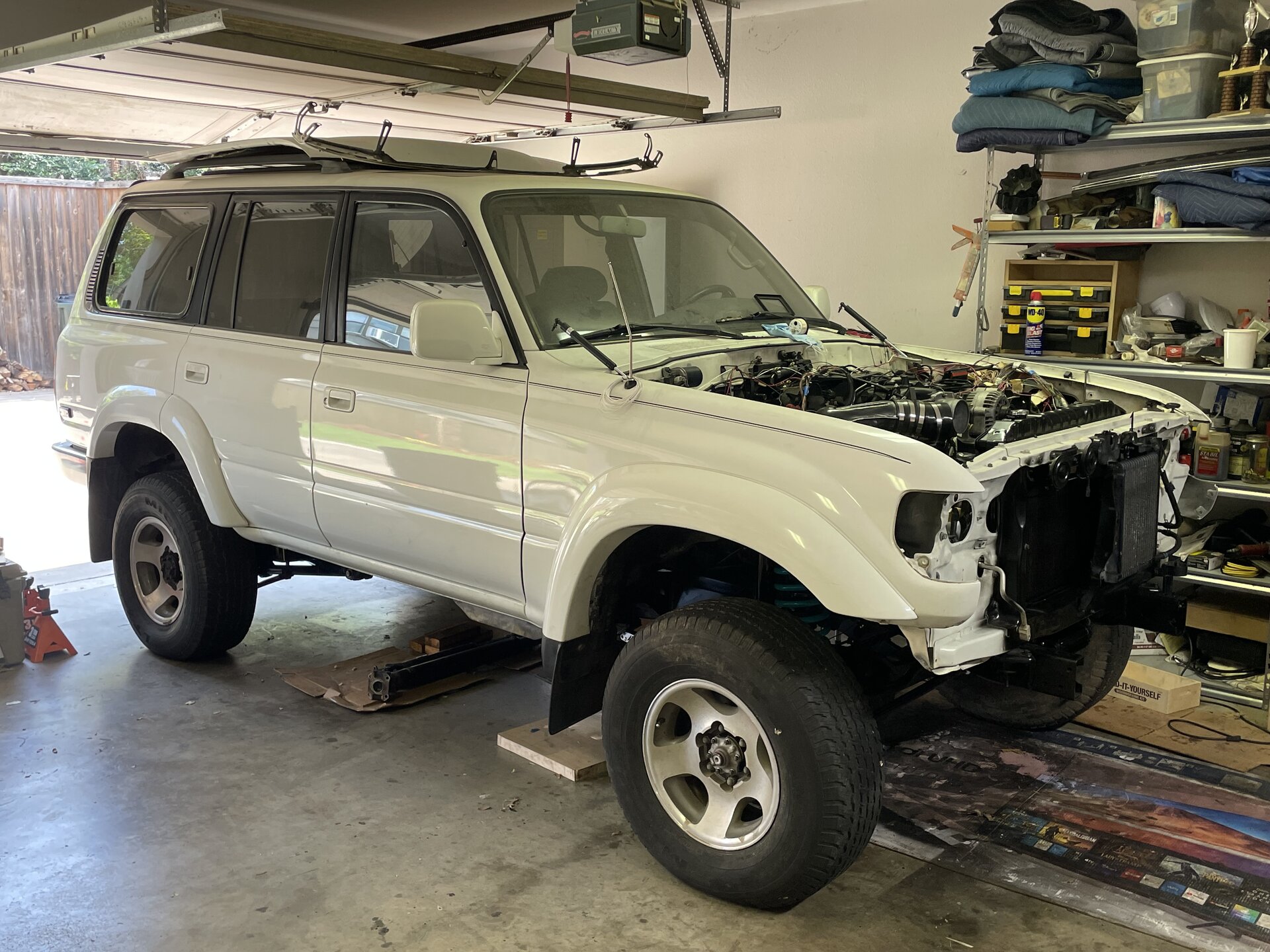

She’s on the ground after about 3 months!! She’s leaning pretty good to the passenger side (RH). Right front tire is pretty flat I hope that’s the issue! I definitely put the springs on Lh/RH per the stickers. I hope you don’t have to reverse that for US models from Dobinsons!!
I know front rIght needs a dust cap! Getting it today. That’s a 3 inch lift. I have an ARB bumper (no winch). Plan on a rear bumper and gear in the back. Right now, it’s empty of fuel, third row is installed and factory spare is underneath.

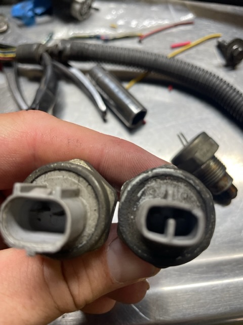

Can anyone help me identify the proper naming convention and purpose of the 3 position switches on the t- case. I have one fwd and two in the rear in a V. The one on the passenger side in the back is the same as the one fwd. The drives side rear has a different connection. I’m sure
Just so you can’t mix up the connectors. I replaced the two that were the same, with some after market ones. And one of the connectors. I need to replace the odd one and its connector.

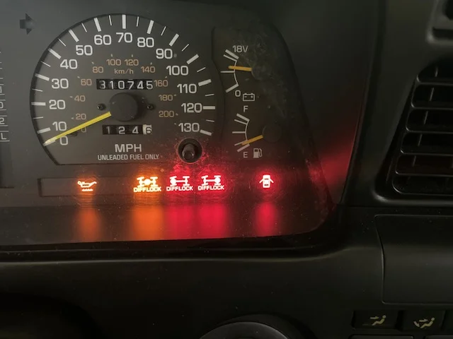

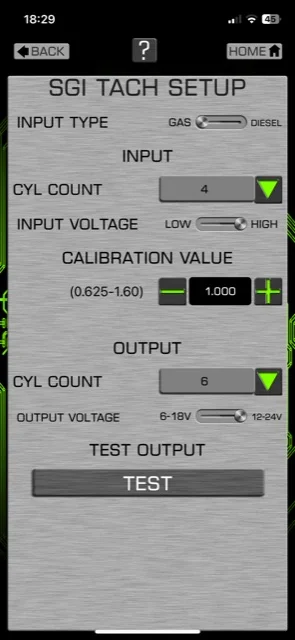

Houston we have lift off!! All gauges are good!! No to do the center diff pin 7 mod while I got the dash all open. I had to do the bypass resistor trick to get my tach to work. Let me know if you need any more help with yours.

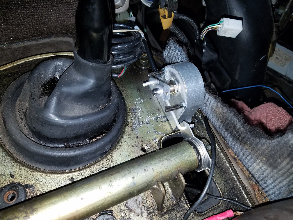

Here is mine. I had not plugged the rectangular hole from the old shifter yet in this pic. I just removed the nut on the shaft and installed the dd arm. Later I used a better piece of linkage for the dd. For the trailblazer cable I just used a nut and bolt to attach it to the shifter lever.
Interesting. I was just looking at putting this on the driverside. No way I can get it under the rig with exhaust on. Crazy tight under there.
I can't use that spot because of a ABS module. ABS seems to be working the greats the brakes actually feel great after my rebuild. very responsive.

I just ordered these myself. 5 in total. 3 for the T-case, and one for each e-locker. $14.95 each from Amazon
I think the odd t-case one I got from Toyota and it was 3x the cost of the others.
