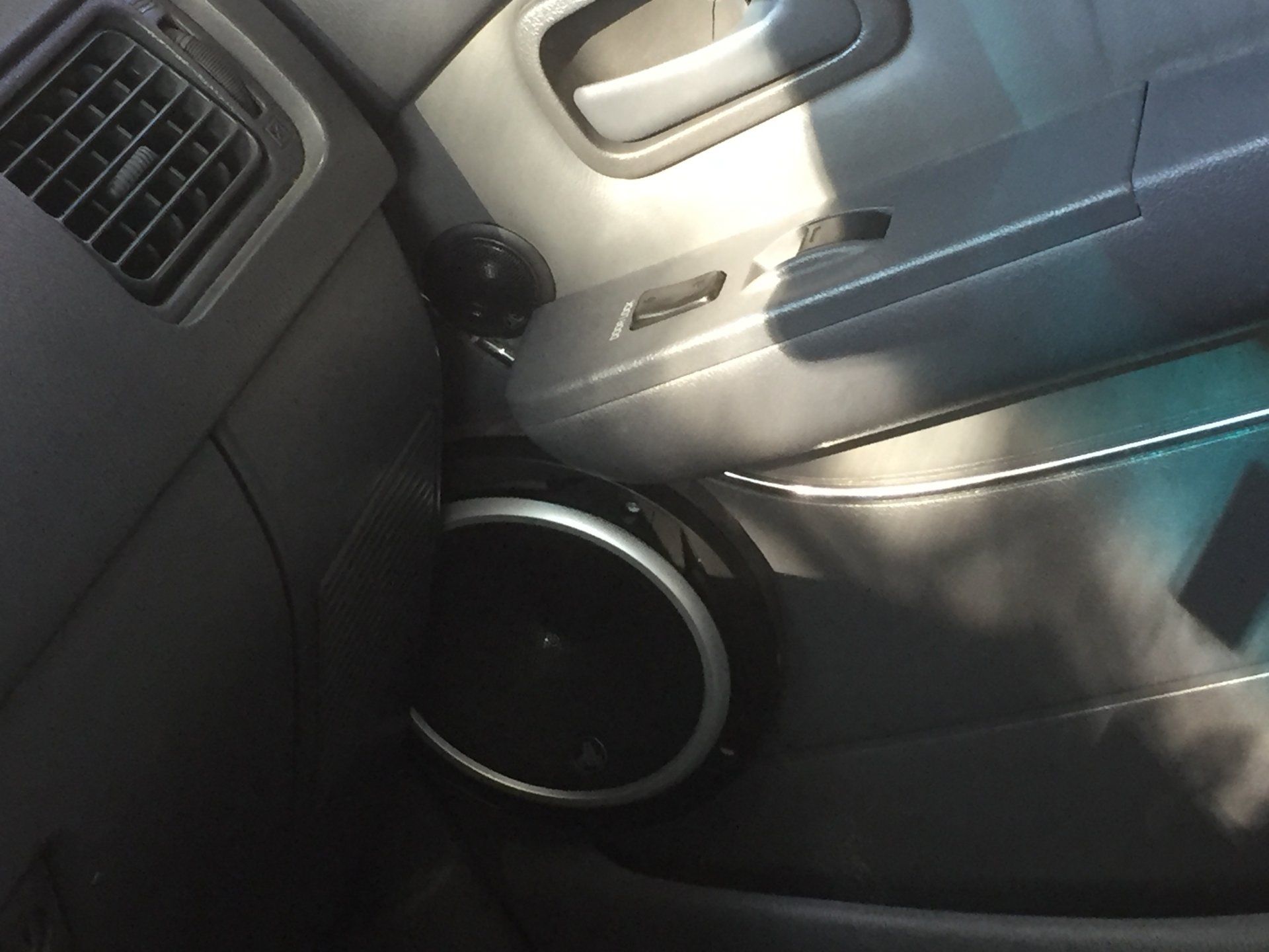

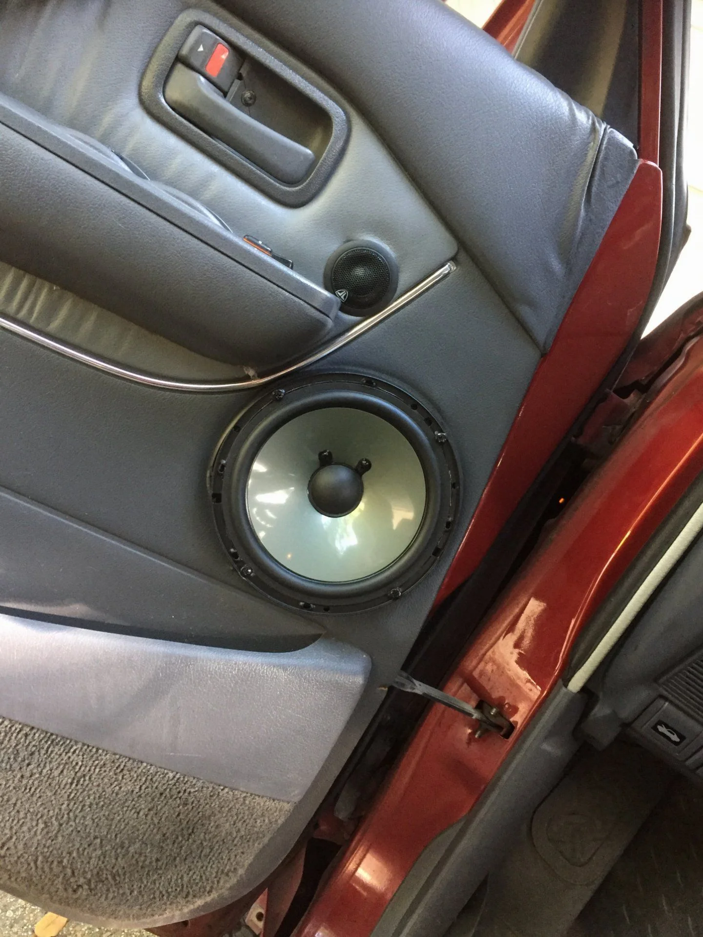

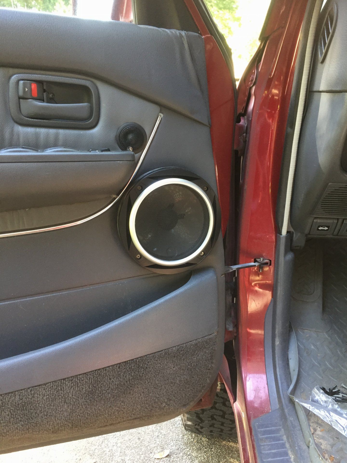

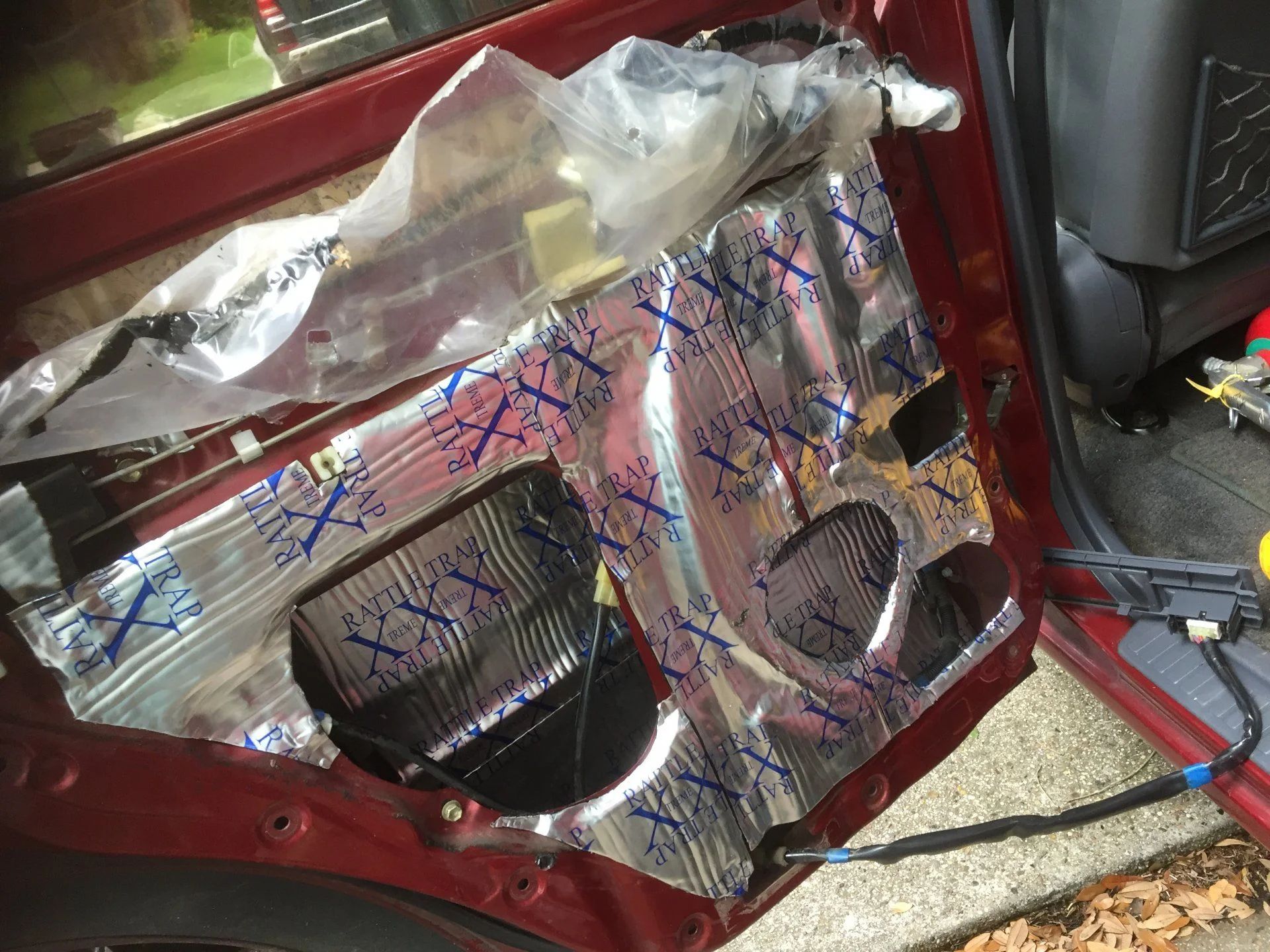

I just finished mine. 6.5 with 2.5" back spacing will fit with a 1/2" mdf spacer. I did have to cut the door panel for the magnet to slide through. Going to end up wrapping the spacers to match the door.. but here are some pictures..
