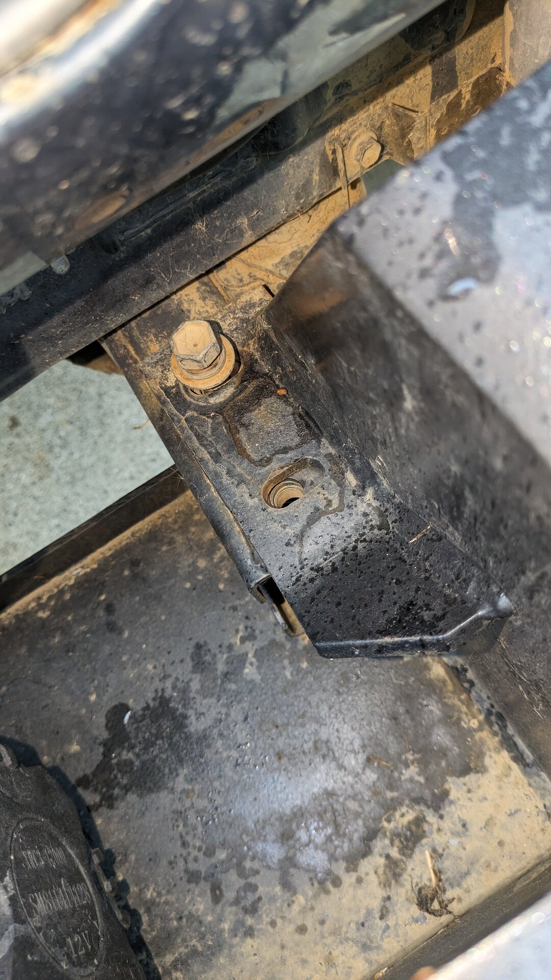

On the front of my frame are 4 threaded bolt holes on each side - 2 above and 2 below - this is where the bumper mounts.
The 2 on the bottom and the 1 on the top closer to the engine bay are the same thread and pitch. However, the top threaded bolt hole away from the bay is larger - Any idea what the bolt thread/pitch is?
Thanks in advance.

The smaller of the threaded bolt holes are already 12mm - that's why it threw me a bit.
As long as I've had this truck, these bolts have not been present.
Got a picture
The bolts are all the same
There are three on the bottom two on the top each side.
Unless someone changed them 😜 Drilled them out and retapped them.
12mm x 1.25
12mm x 1.25Y
I'm thinking that's what happened.... And you're correct - 3 on the bottom - I just don't use the ones furthest in
