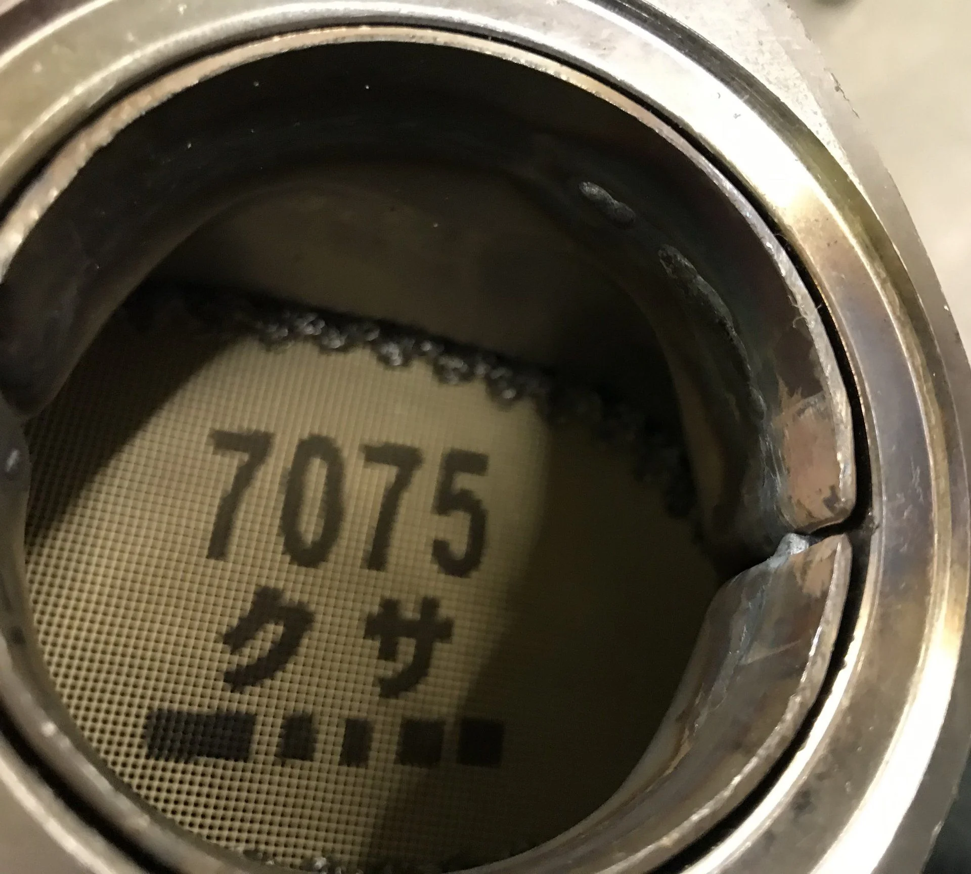

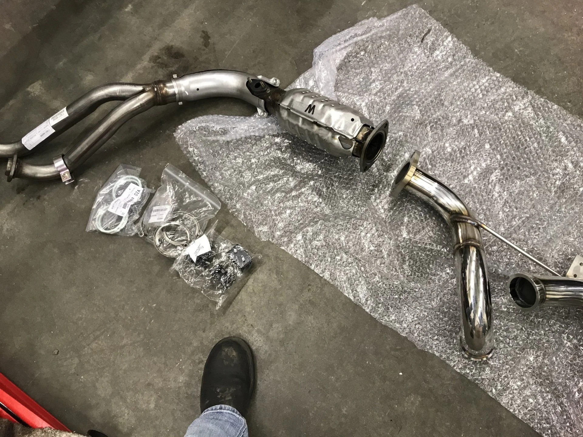

Can't believe I did it but today I ordered a new OEM Y-pipe and forward cat. :oops:
It is stupid expensive even with my discount but I simply can not put this crappy Magnaflow in with Otramms cat back and my new engine. I built the engine for 20yrs so why not finish it off with an exhaust system worthy of that as well!? This is the last thing for my engine and then I can get on to real upgrades and mods on the Cruiser. Sliders and belly skid will be first.

Got my girl in the shop so I can install the exhaust.
I don’t think I have had a free bay since I pulled it out in September. This holiday weekend is about my truck, and beers! 😂

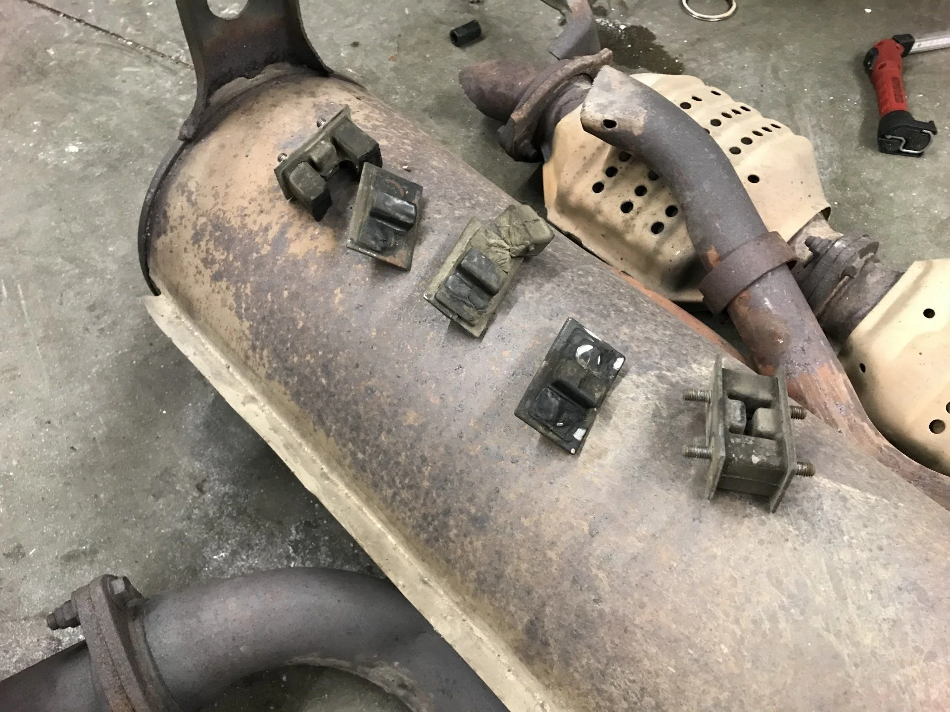

Easy to get out...
Seems all but one of my hangers was wasted, I already knew this more or less.

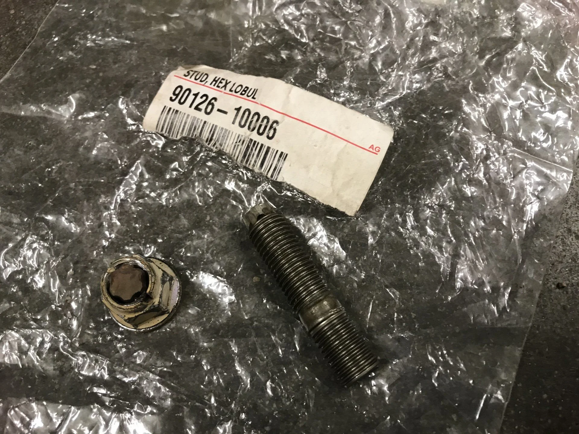

Unfortunately one of the studs on my manifold dump decided to let go. Fortunately I have a spare in my stash.
A little heat + this and no probs to get the stud out.
In hindsight I should have changed all four of those on the bench before install but they looked fine so I ran them. 🤷🏼‍♂️

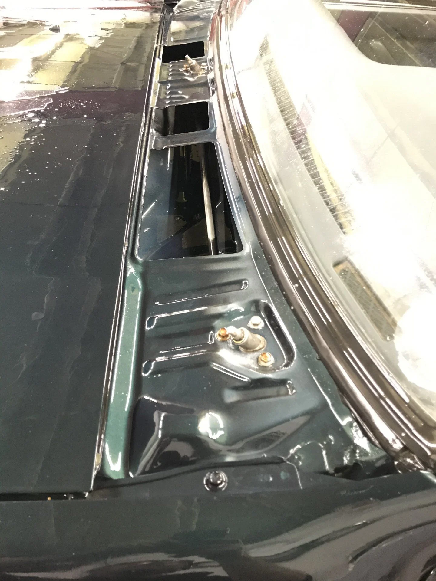

Ha! I was just saying how I think I need to take the cowl off for that very reason.
Any special considerations while doing it? I figure just pop and go, but what do I know...
