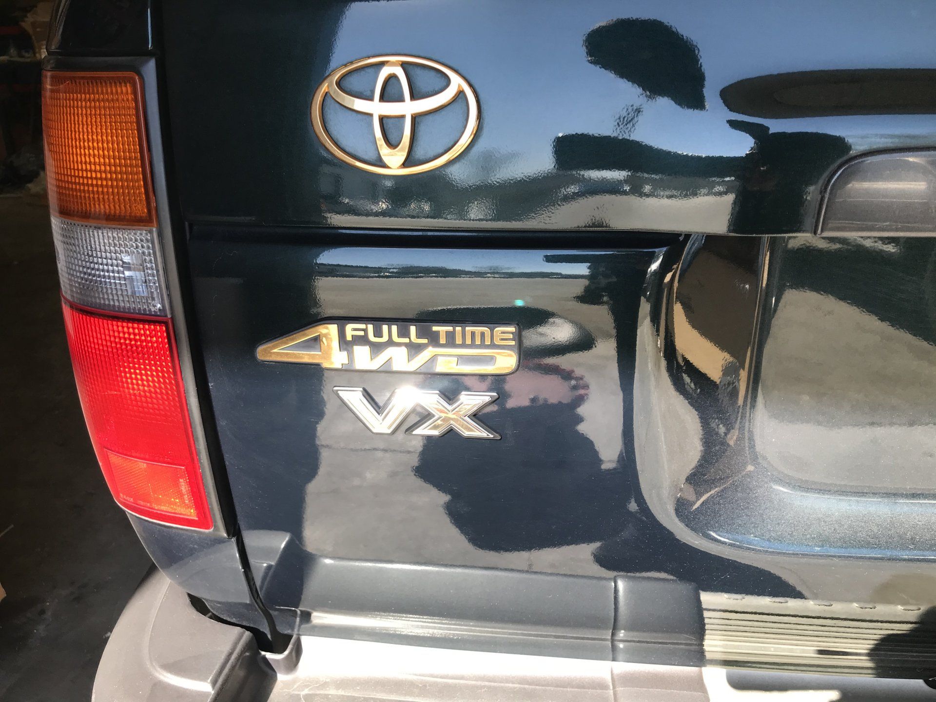

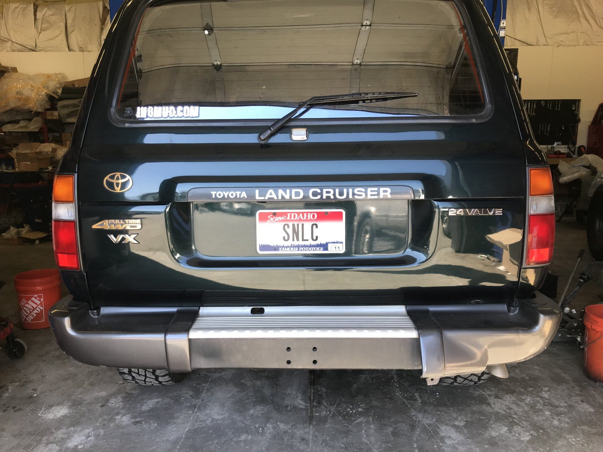

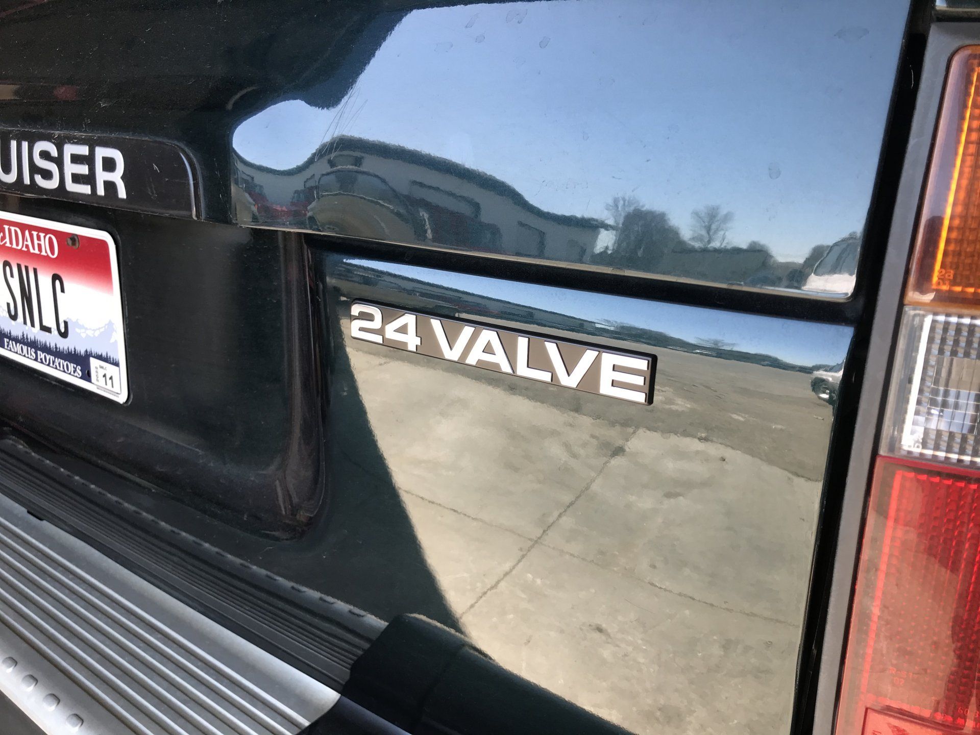

Put some cheesy OEM emblems on my Cruiser this morning. 🤗
Yes I know RHS of bumper is trashed, last wheeling trip carnage. Don’t care that much because I will be upgrading at some point.

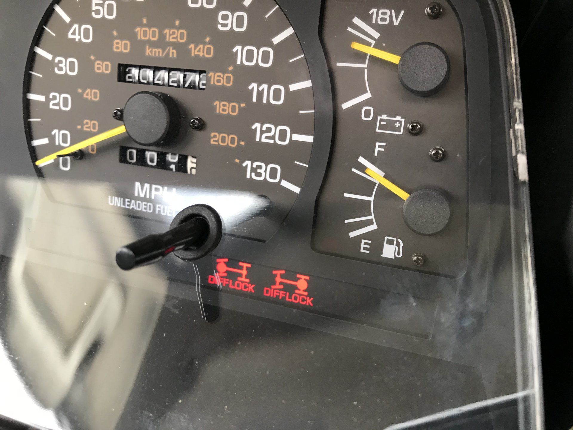

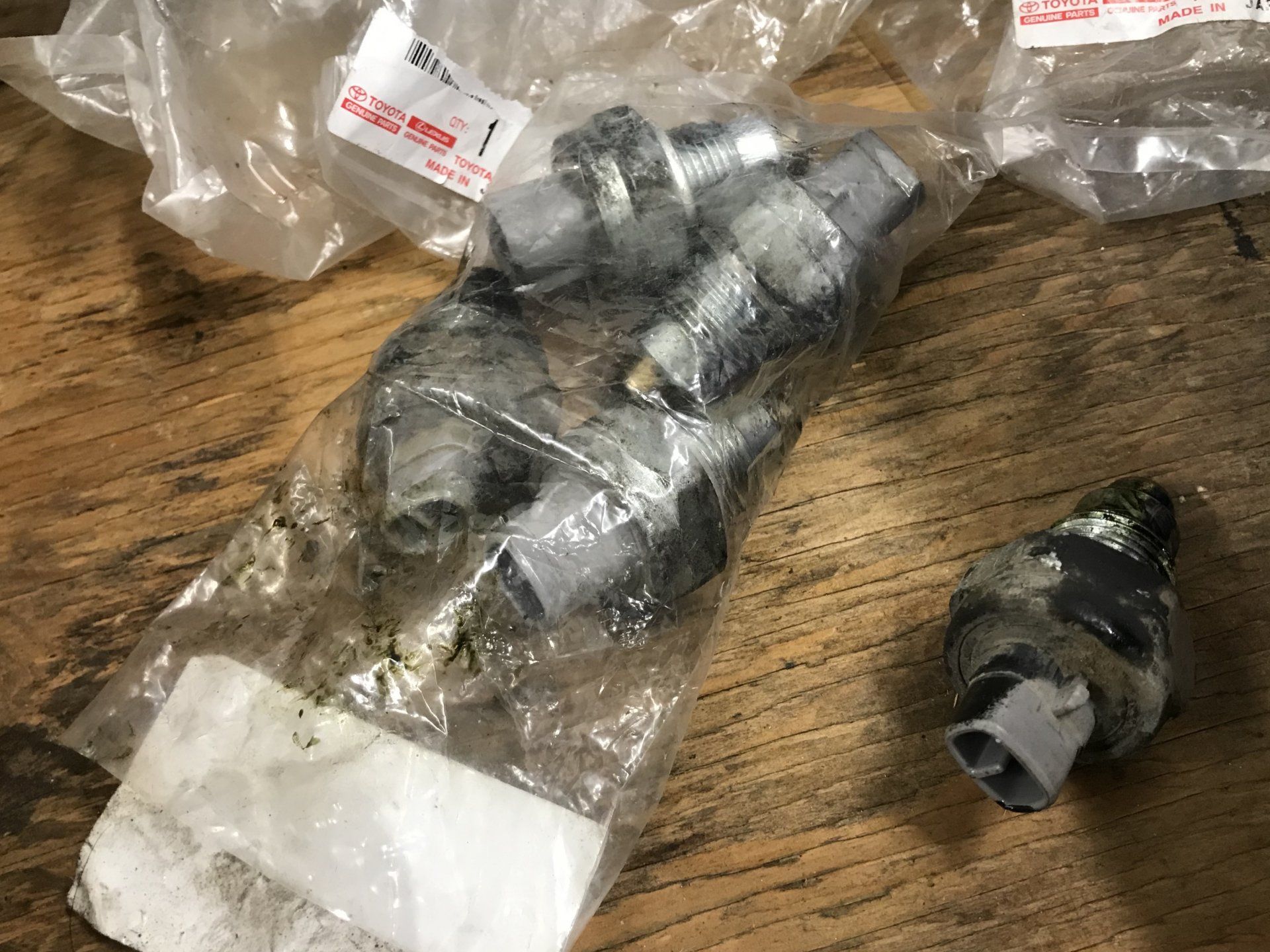

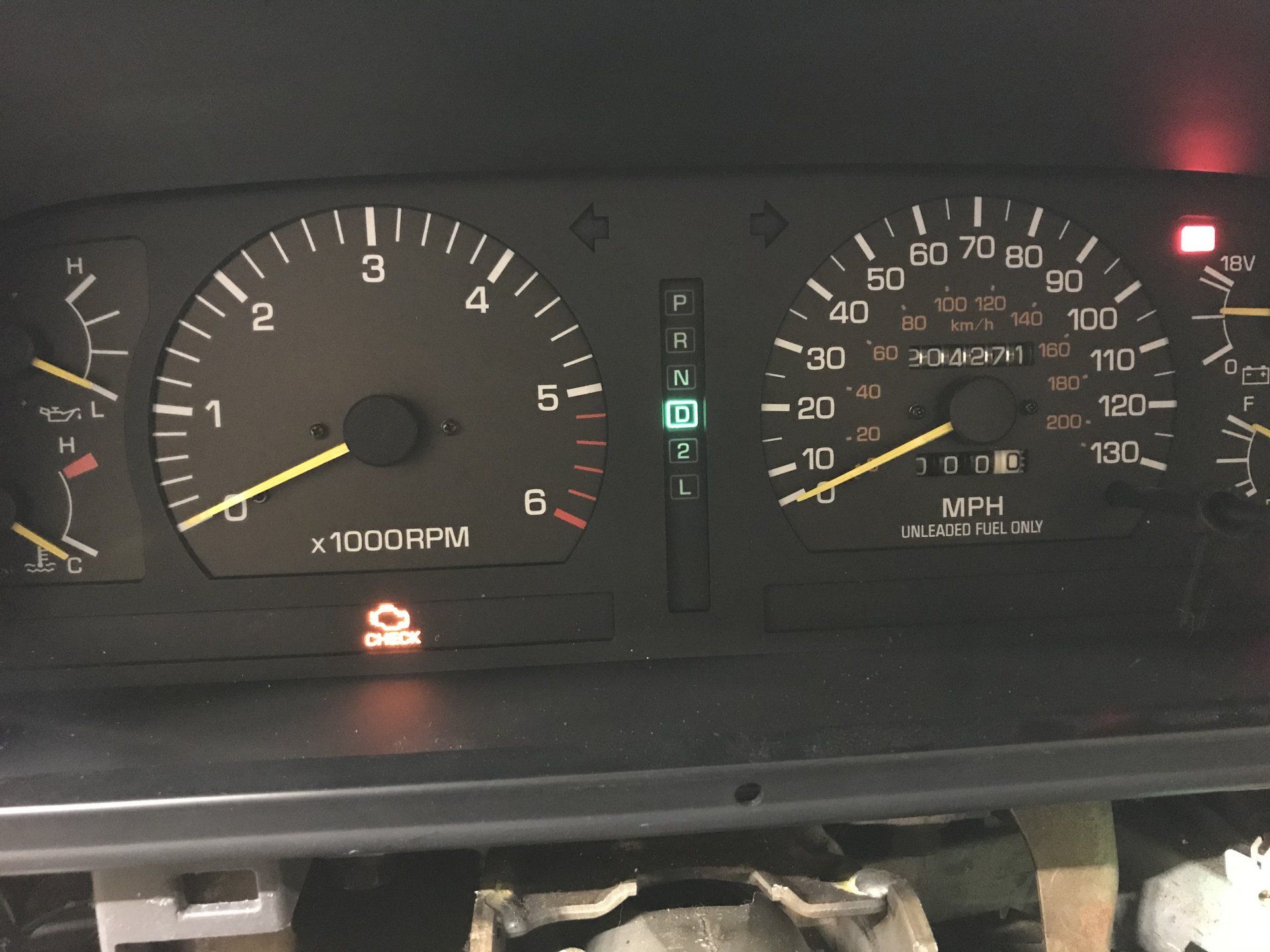

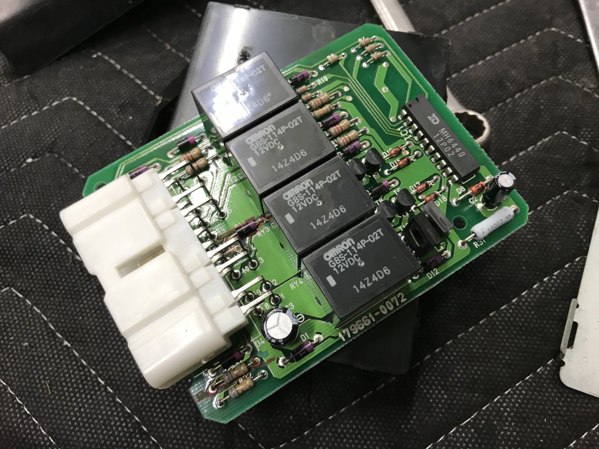

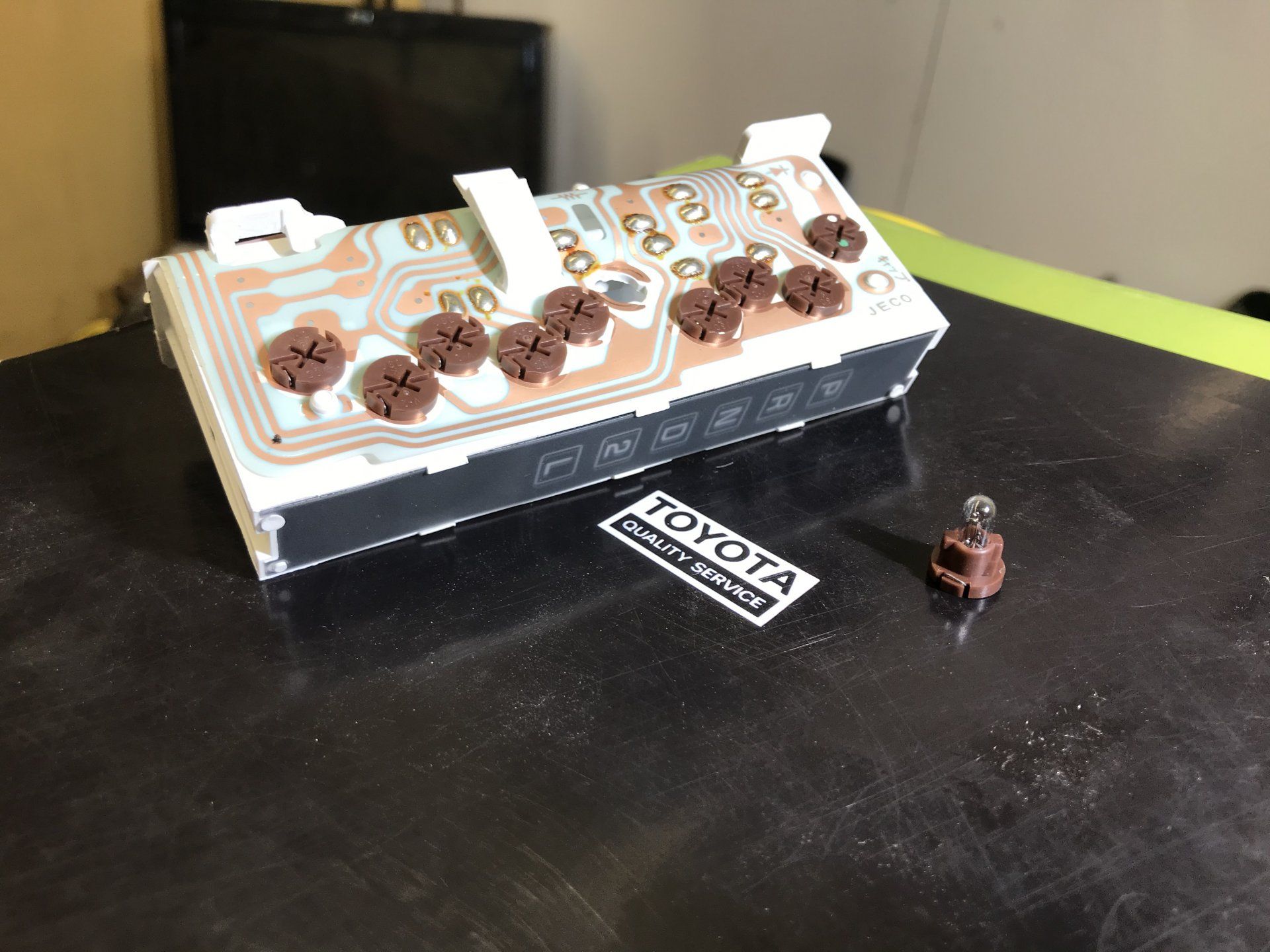

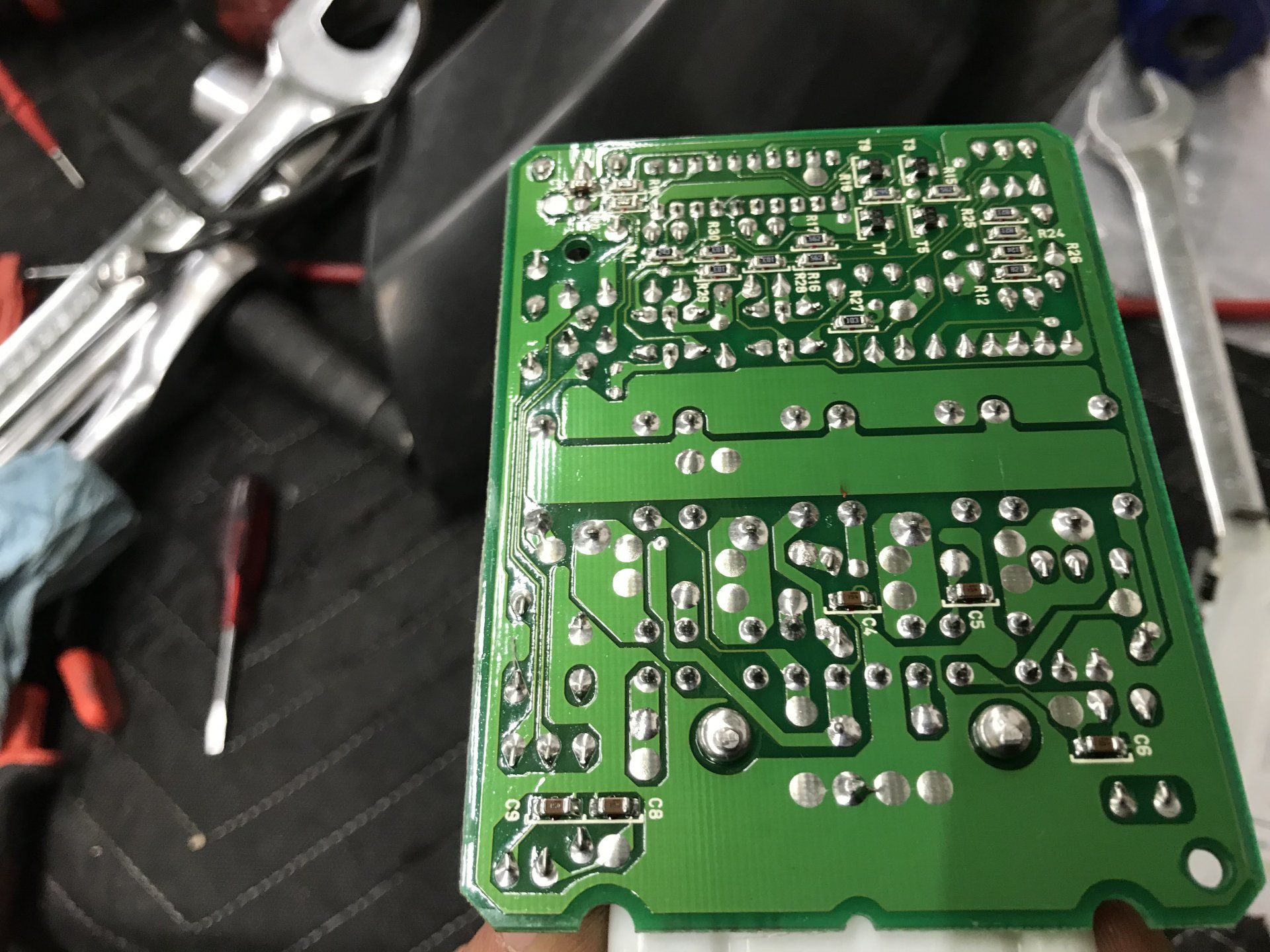

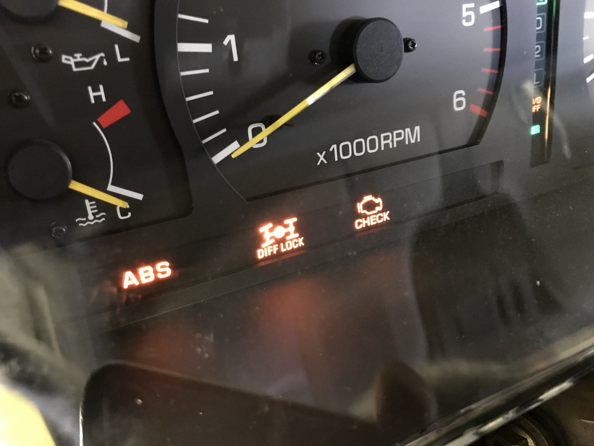

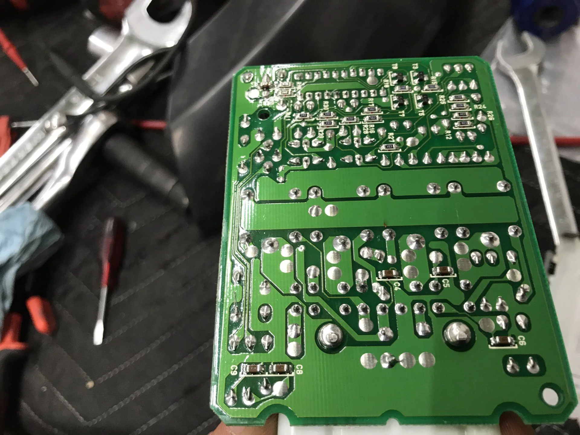

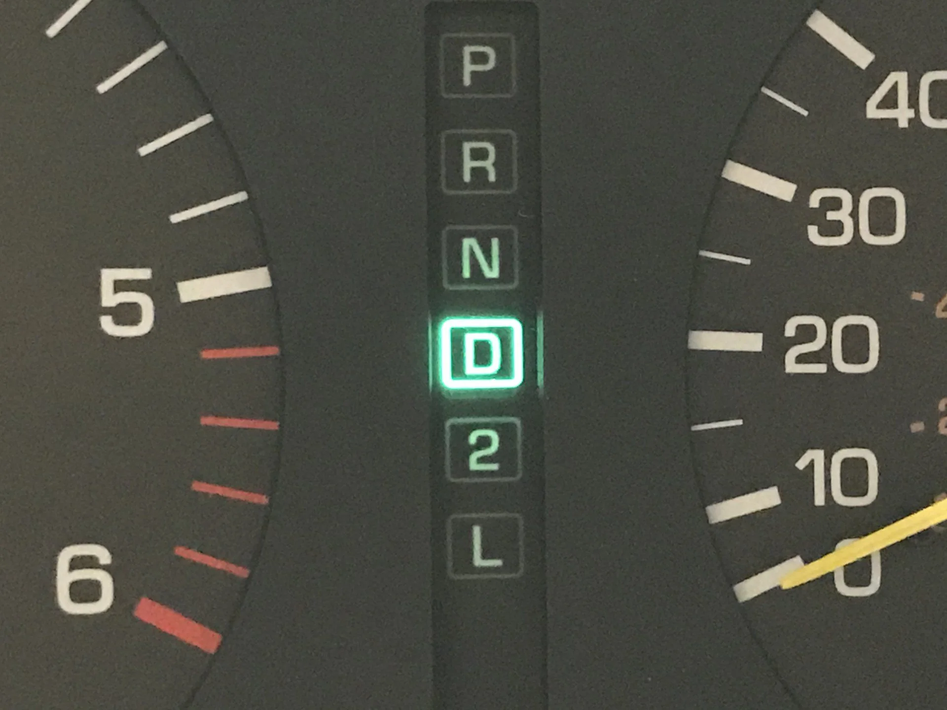

Diff locks. So since I put the Cruiser on the road last September the CDL/ABS lights has never comes on in the cluster. My F/R diff locks don’t engage but the CDL does, just no indicators on the dash. Any ways, today I checked the 4wd ECU, as you can see it looks brand new. I also changed all five switches because they have been in my stash for awhile. I tested 4WD ECU and Trans ECU. No luck, looks like it may be in the wiring harness. I even went as far as to try other 4wd & trans ECUs with no change in the issue. My D light was out so I figured why not fix that and verify that the CDL light is good at the same time, which it is. I jumpered the CDL plug and got no dash indicators as well, bleh! 😝

All diff locks fixed and working well.
Stoked! Turned out to be a busted wire near the CDL switch.

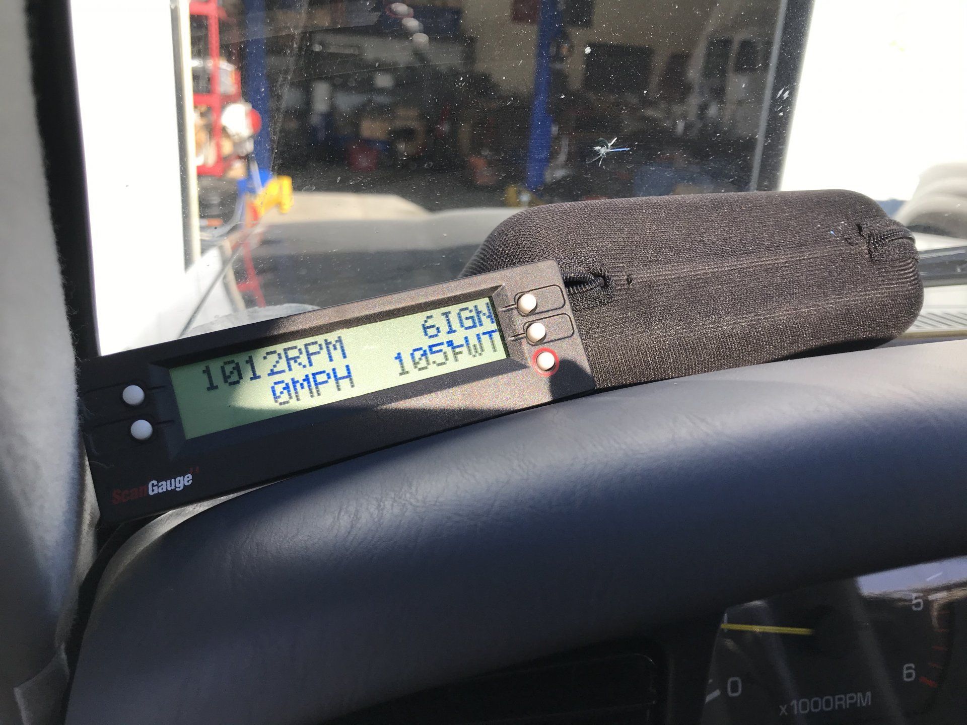

Routed my Scangauge wire through my dash while I had it apart. Still need to make a mount but at least for now I don’t have the wire just hanging out of the fuse panel.
View attachment 2613522View attachment 2613523View attachment 2613524
Cheers
One switch on each axel housing, one on center diff lock. Where do the other two go?

No the Scangauge is plugged into the OB2 port which I moved the port inside the dash.
