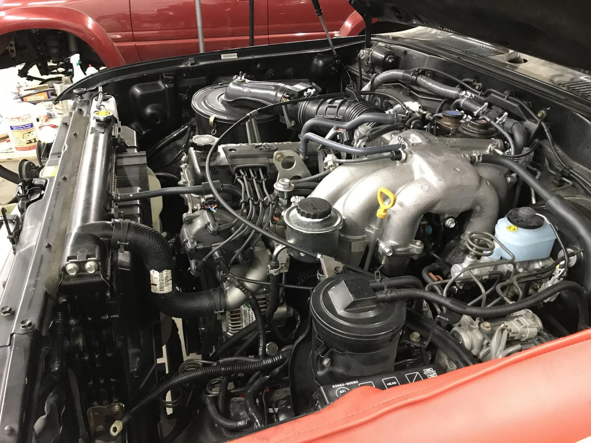

He might have just put a hex on that radiator nipple
Oh no, beat it with those hexes!
It’s a two year old radiator, I been careful with it so, all good.
Cheers
I'm sorry to hear that. It is a shame to fix something that isn't broken
:hmm:
Well, when it fails I will put a Denso back in it. Installed 5-6 though and had no issues, so 🤷🏼‍♂️

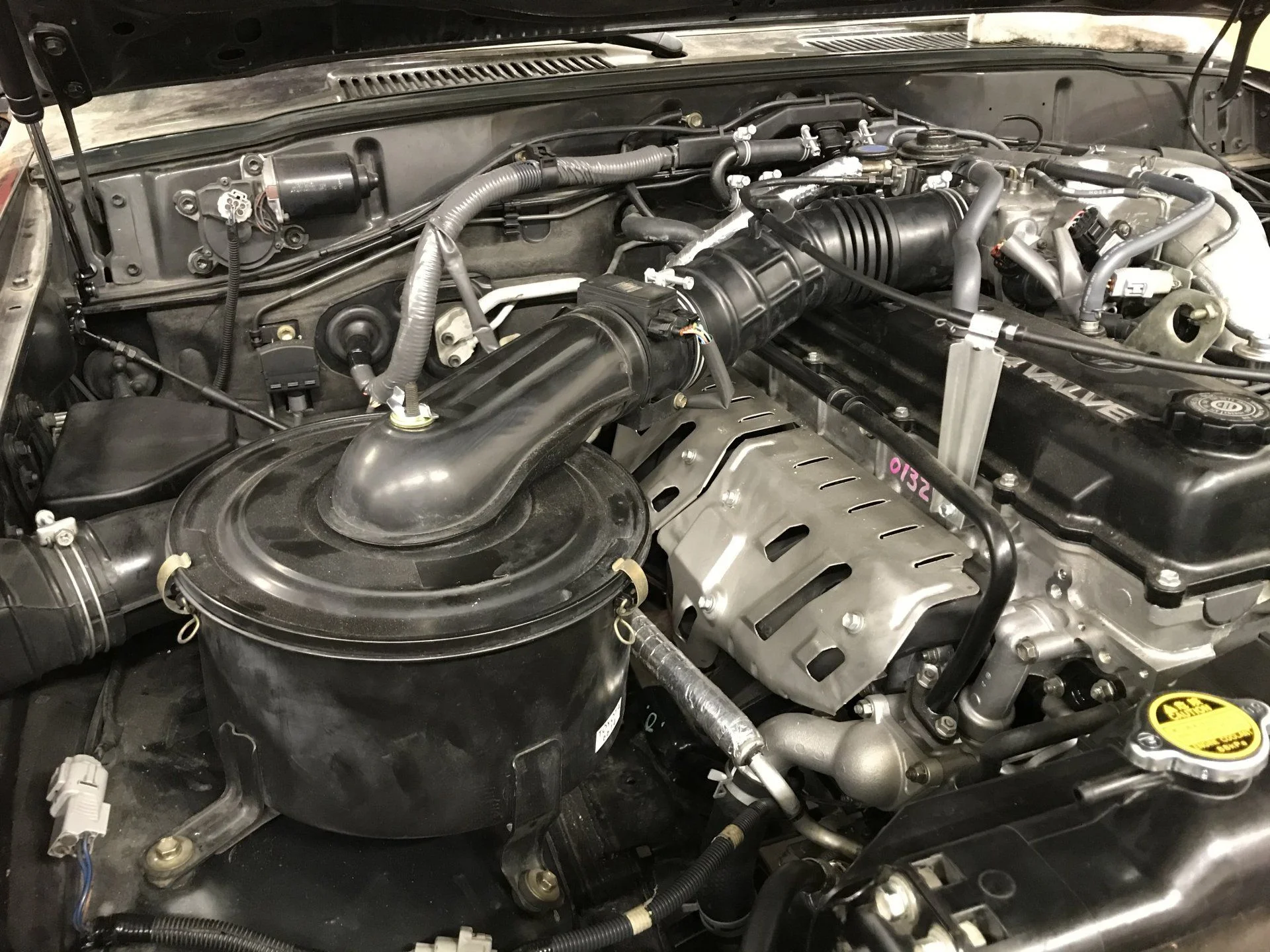

More finalizing.
Cheers
It is quarter to 9pm, I think I am calling it quits for tonight.
I will finish it tomorrow.
Cheers

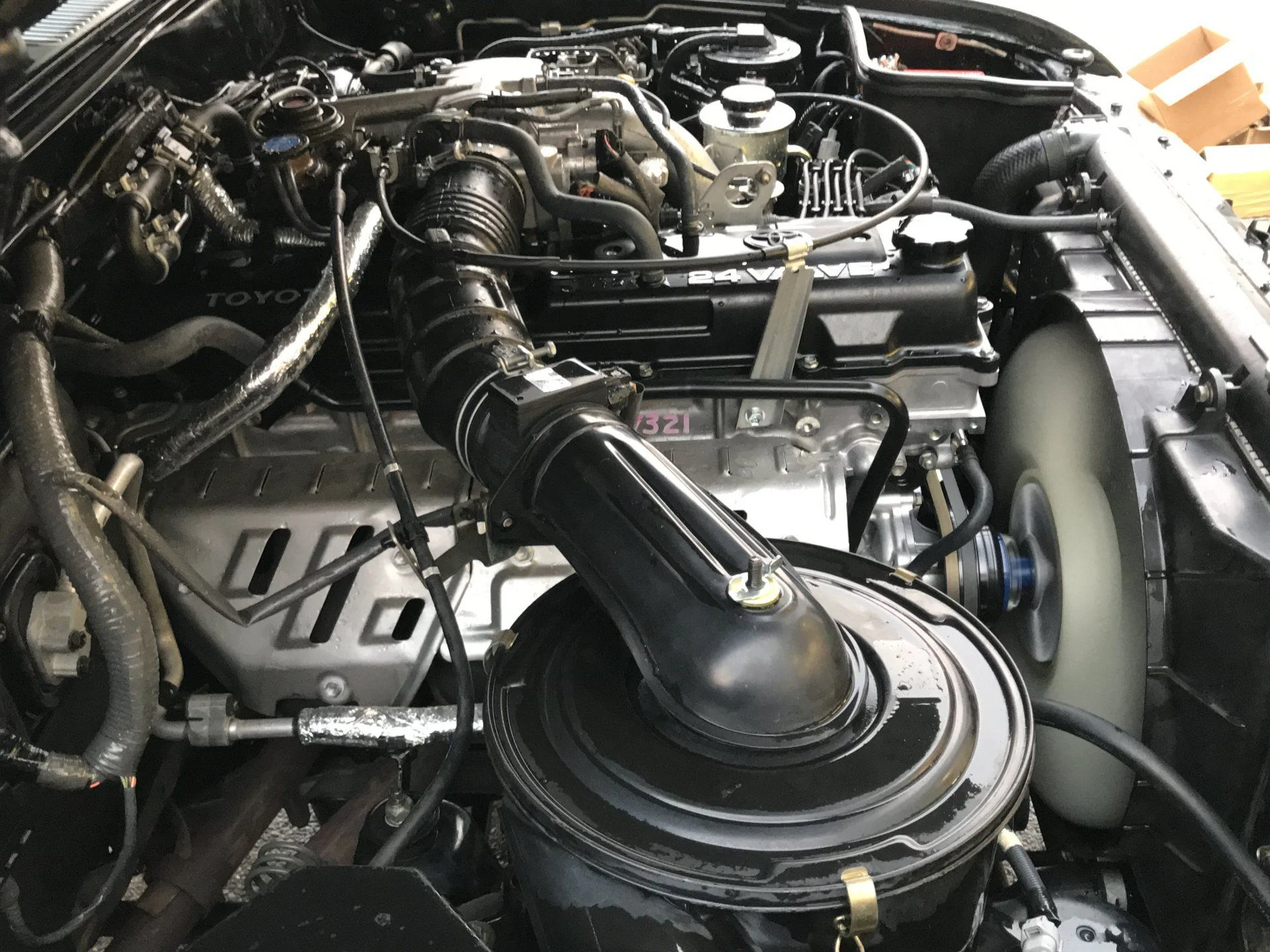

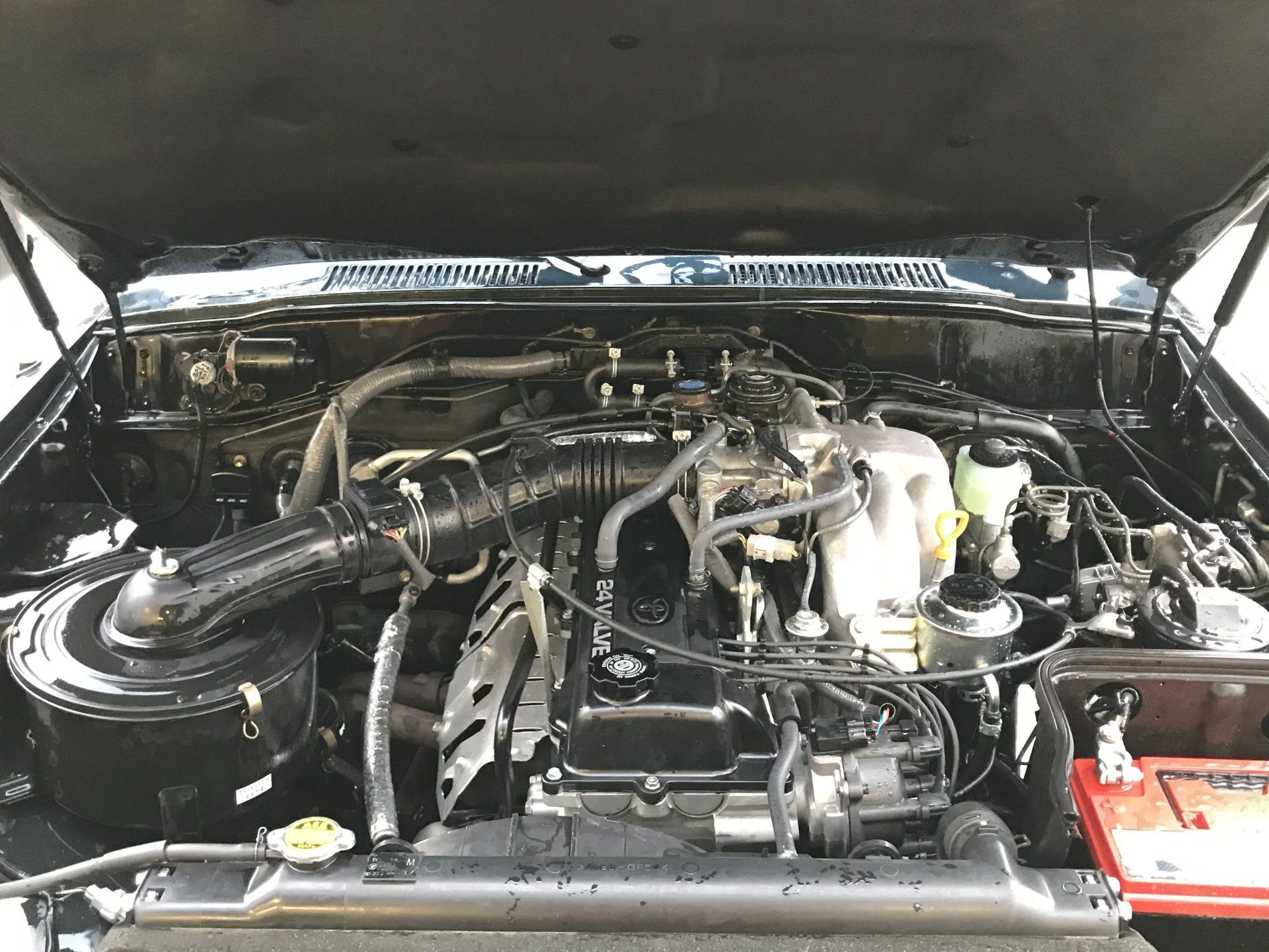

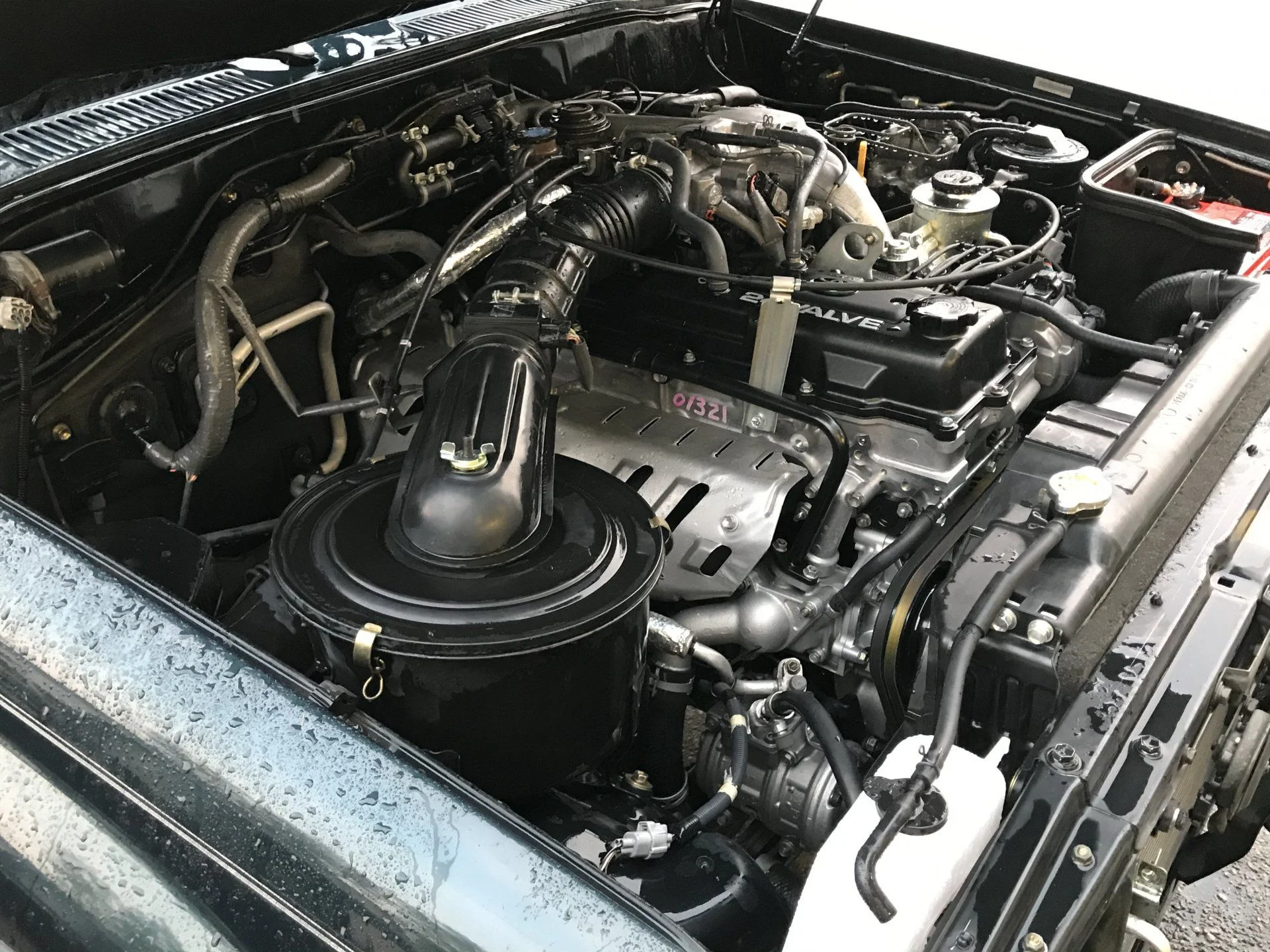

It’s running and man it purs.
Pics and video to come. Bleeding brakes and then pulling it out for a wash.

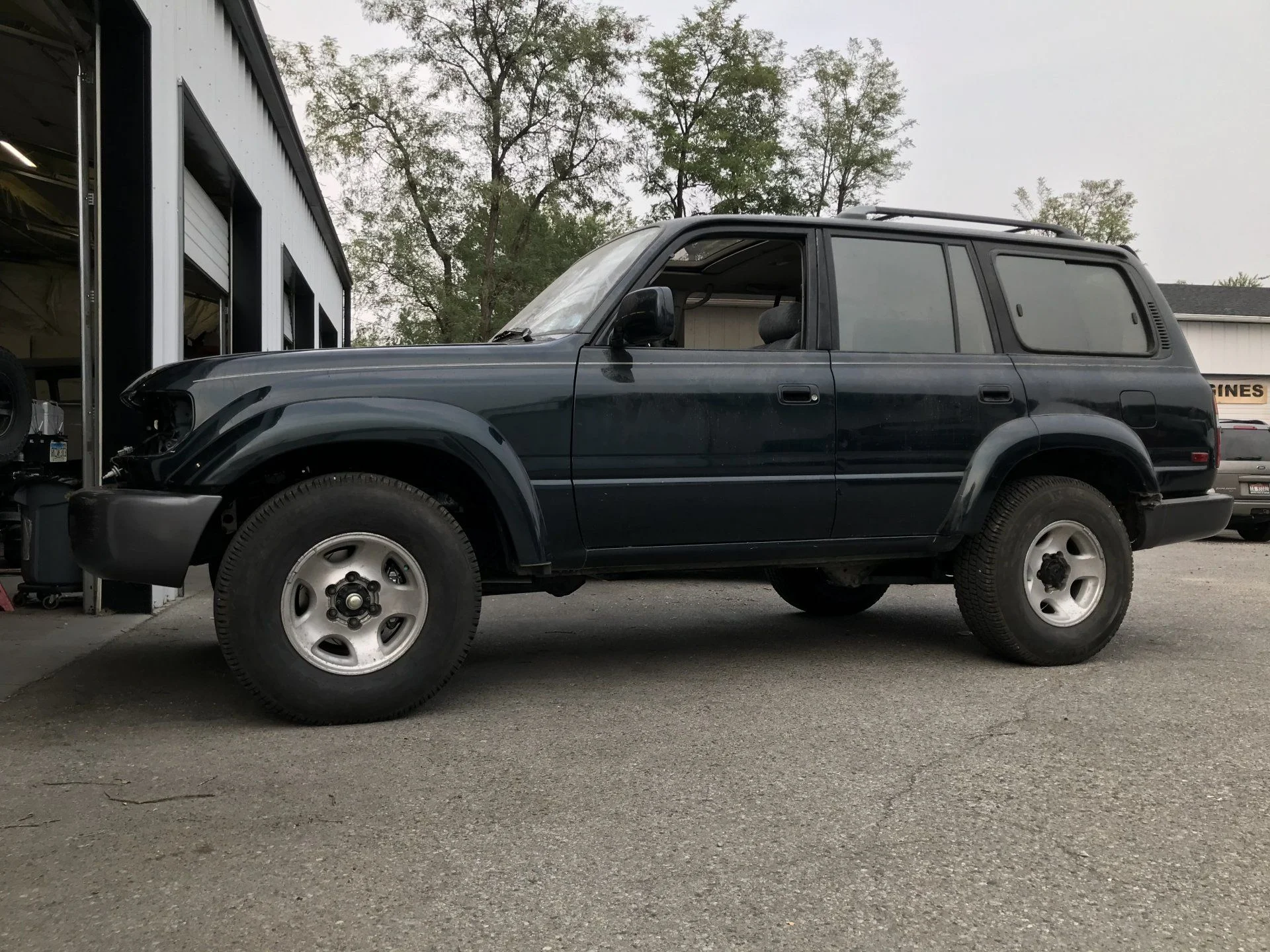

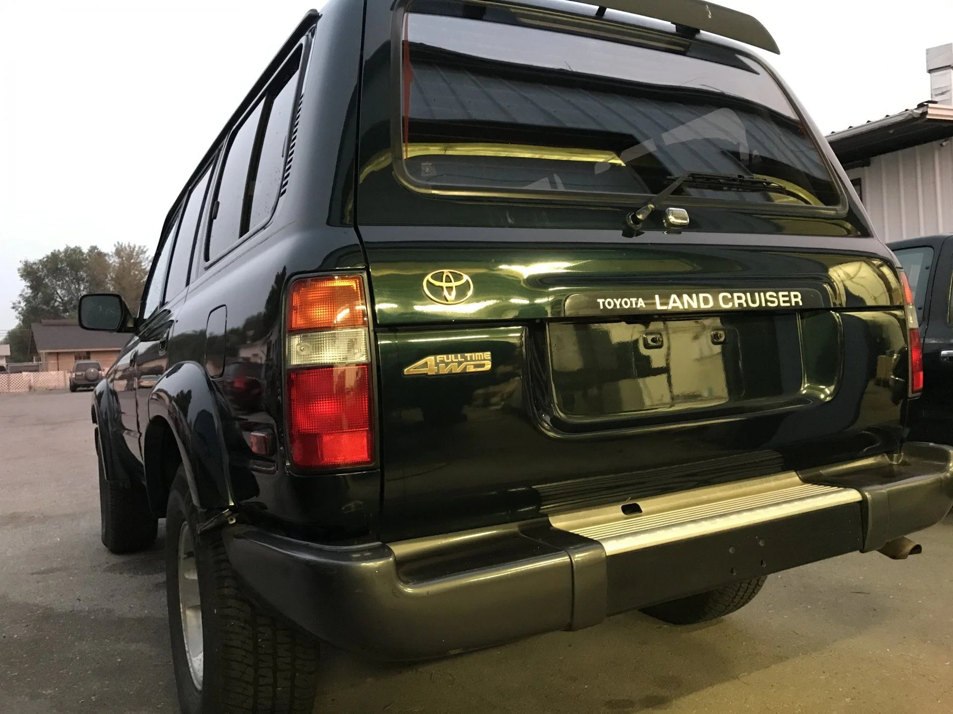

Last one.
It’s quarter to 8pm and I am still at the shop. See if I can get some of the videos uploaded tonight of it’s first start and running.
Right now I am just relaxing and having a beer while I stare at it. 😆
Cheers

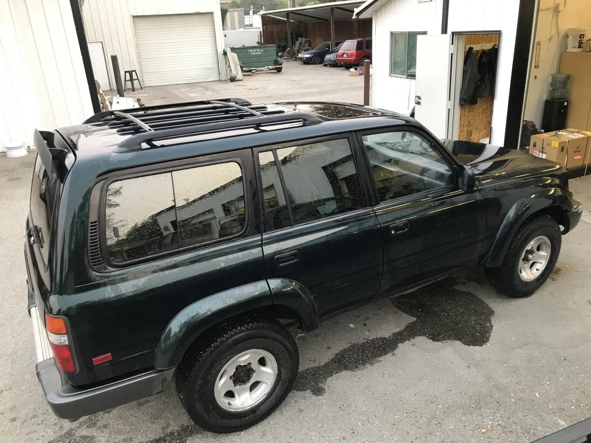

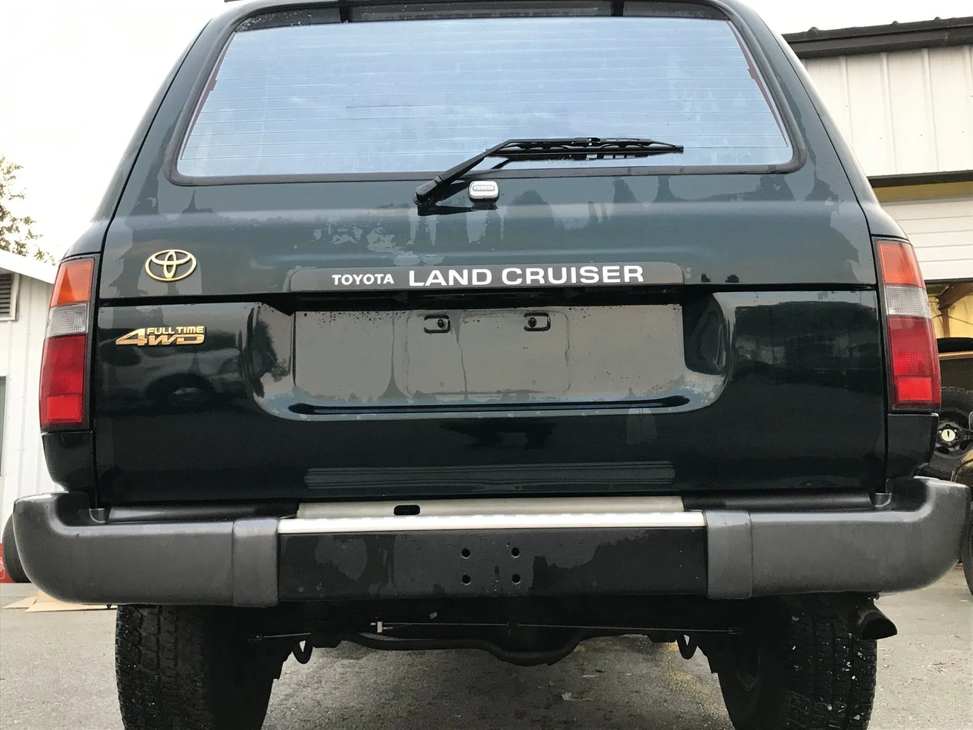

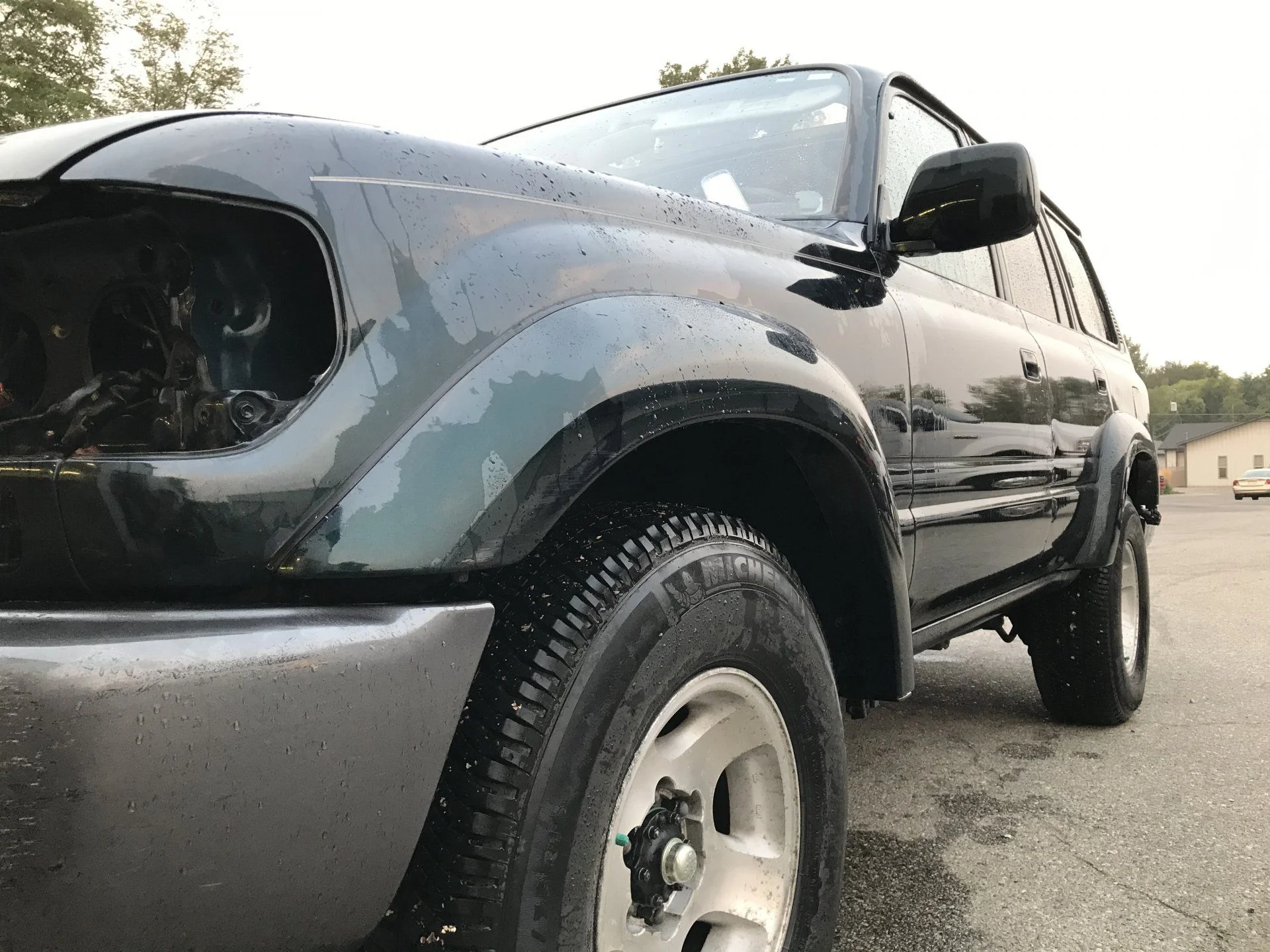

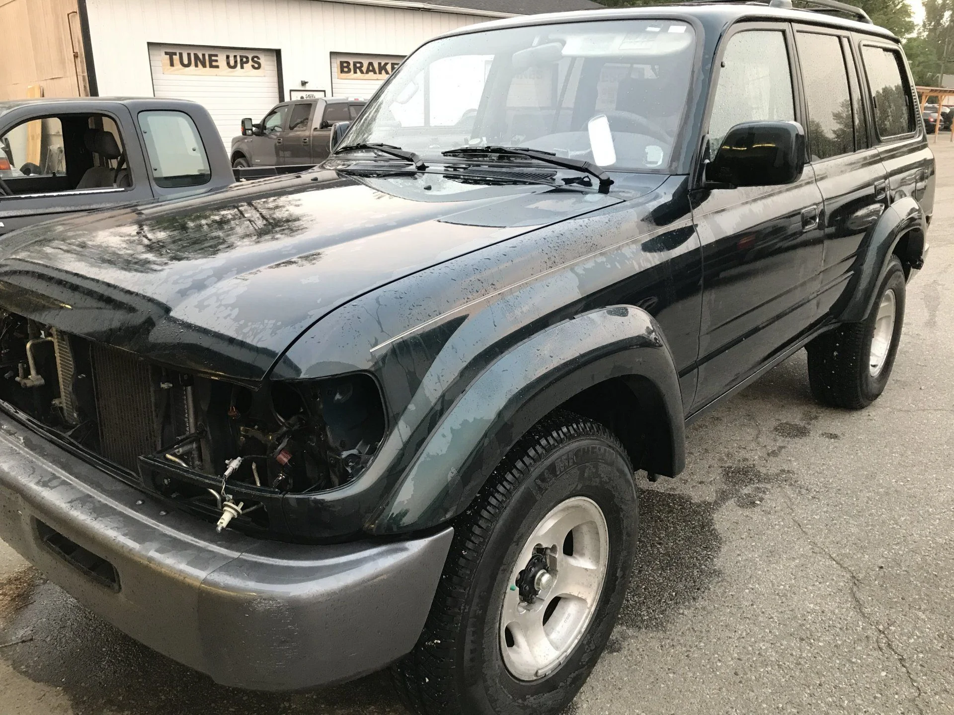

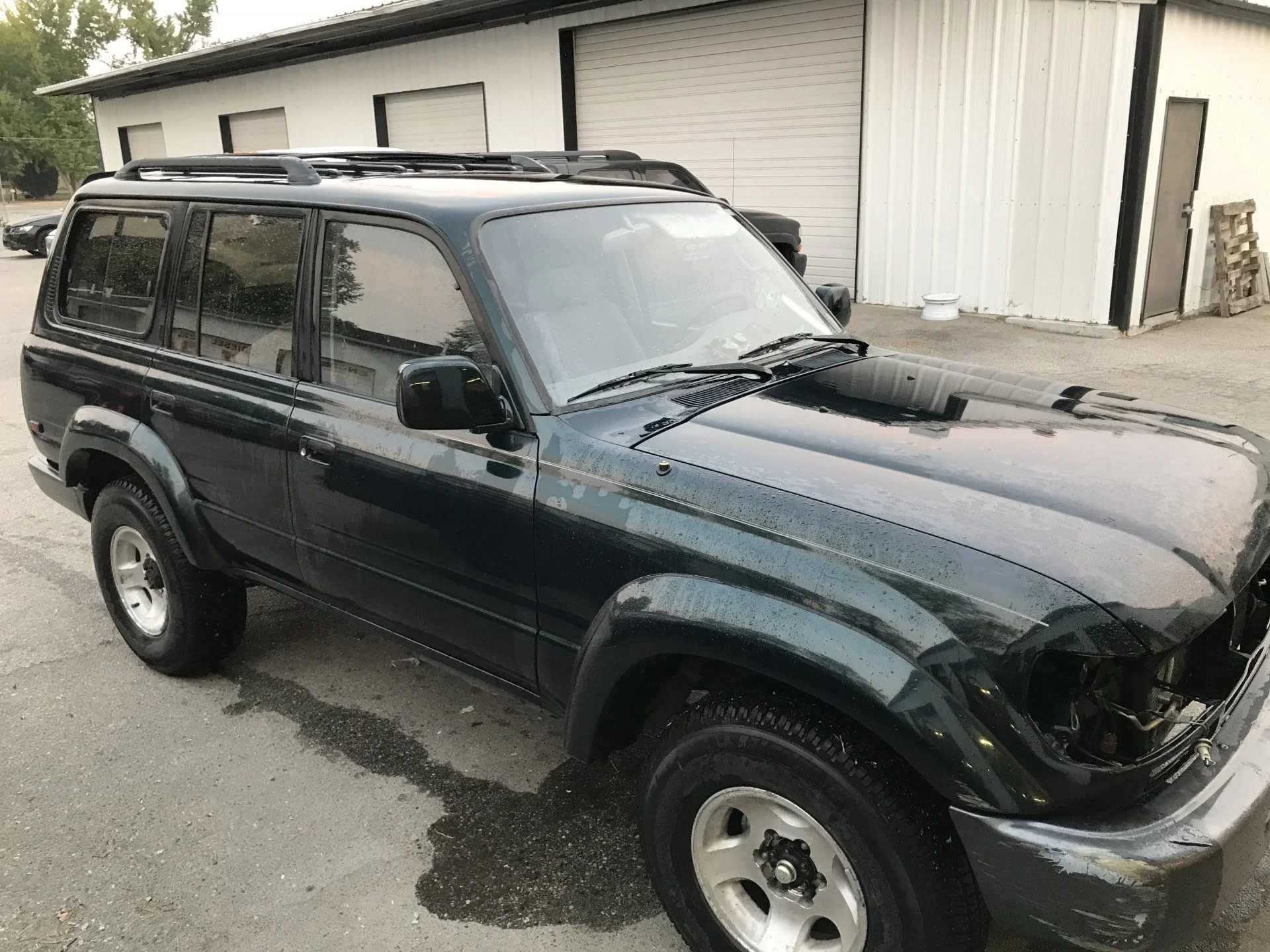

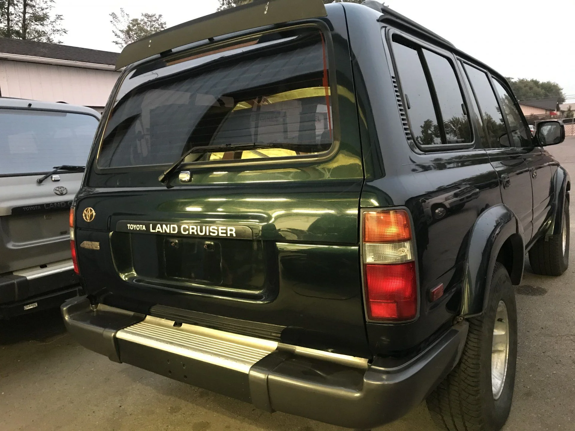

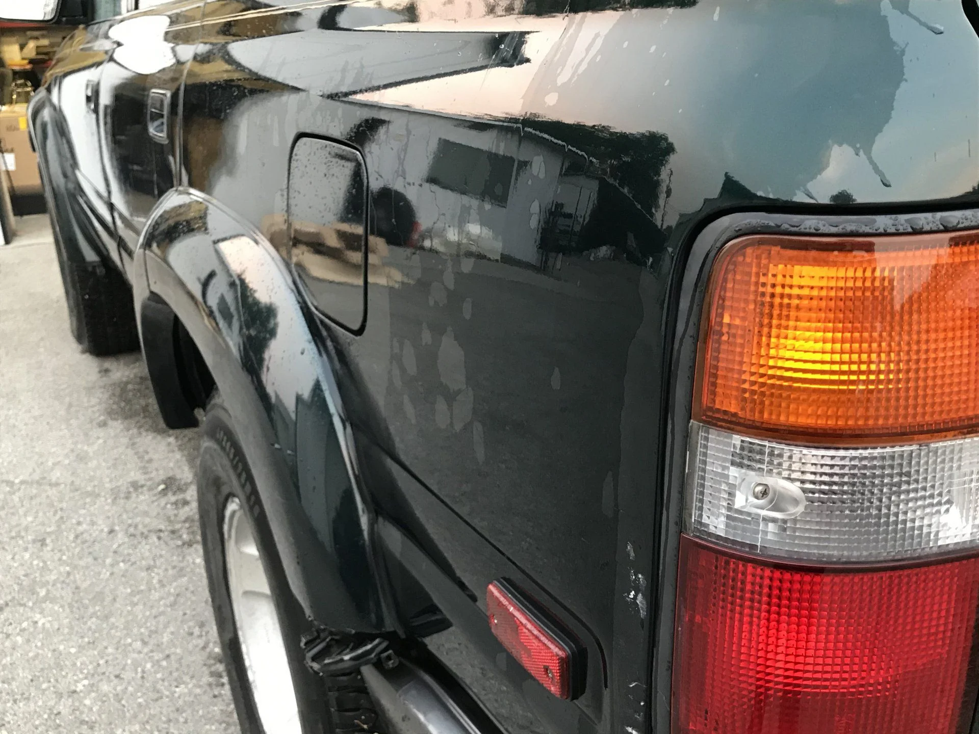

A few more because the light is just right and I am standing here gawking at it. 🤣
This is probably the nicest Cruiser I have ever owned. Some people don’t like the 6M1 and this truck has a few flaws but I love it! 😍
Cheers

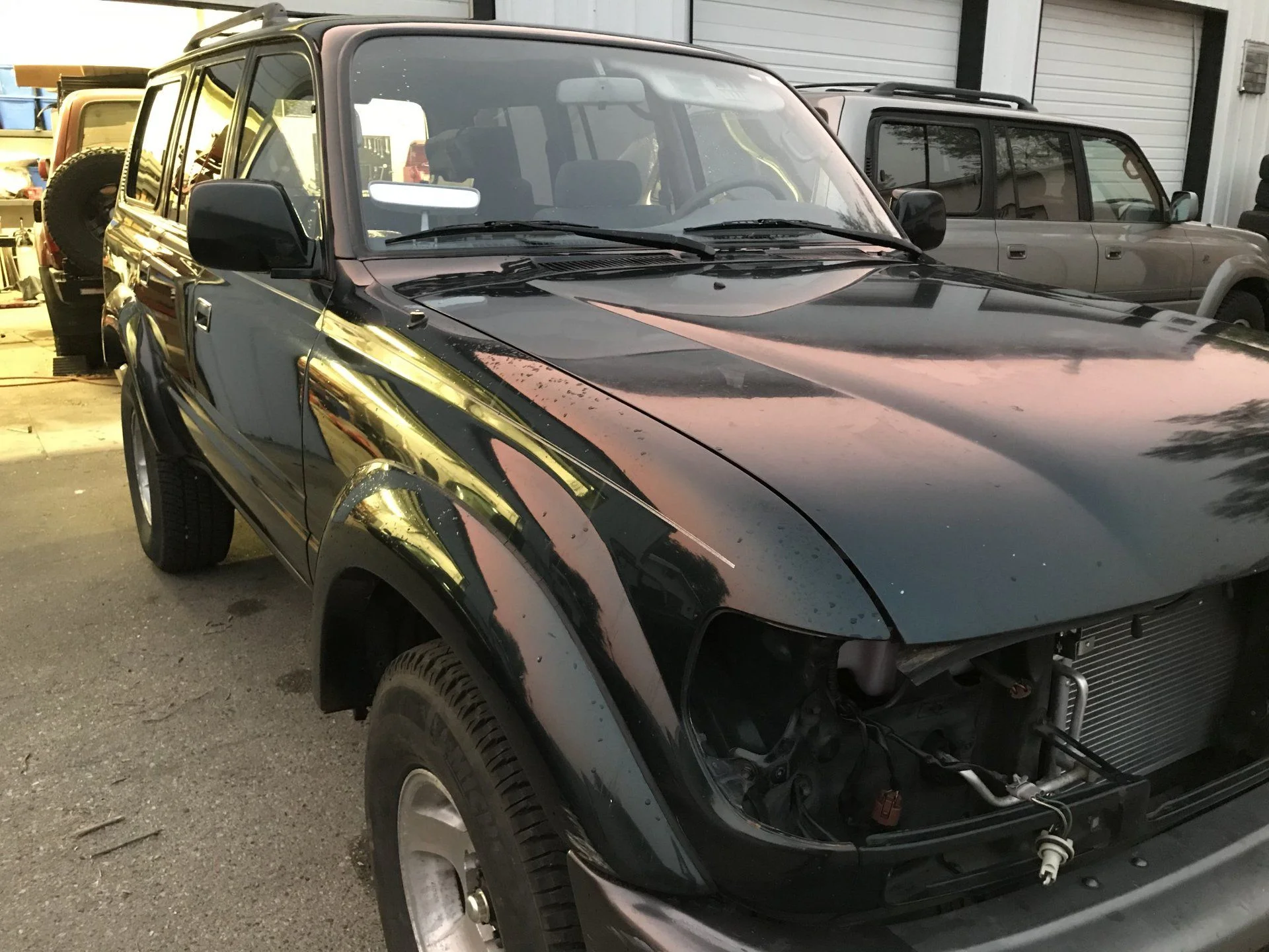

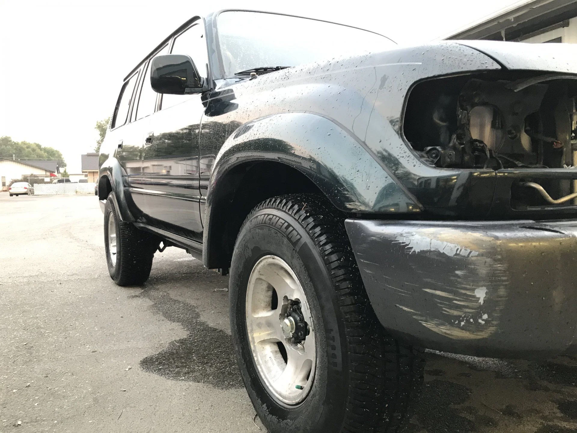

Time for some wax on, wax off action. That water is not beading up very much at all.
It’s been sitting for at least four years, so ya. 🤷🏼‍♂️

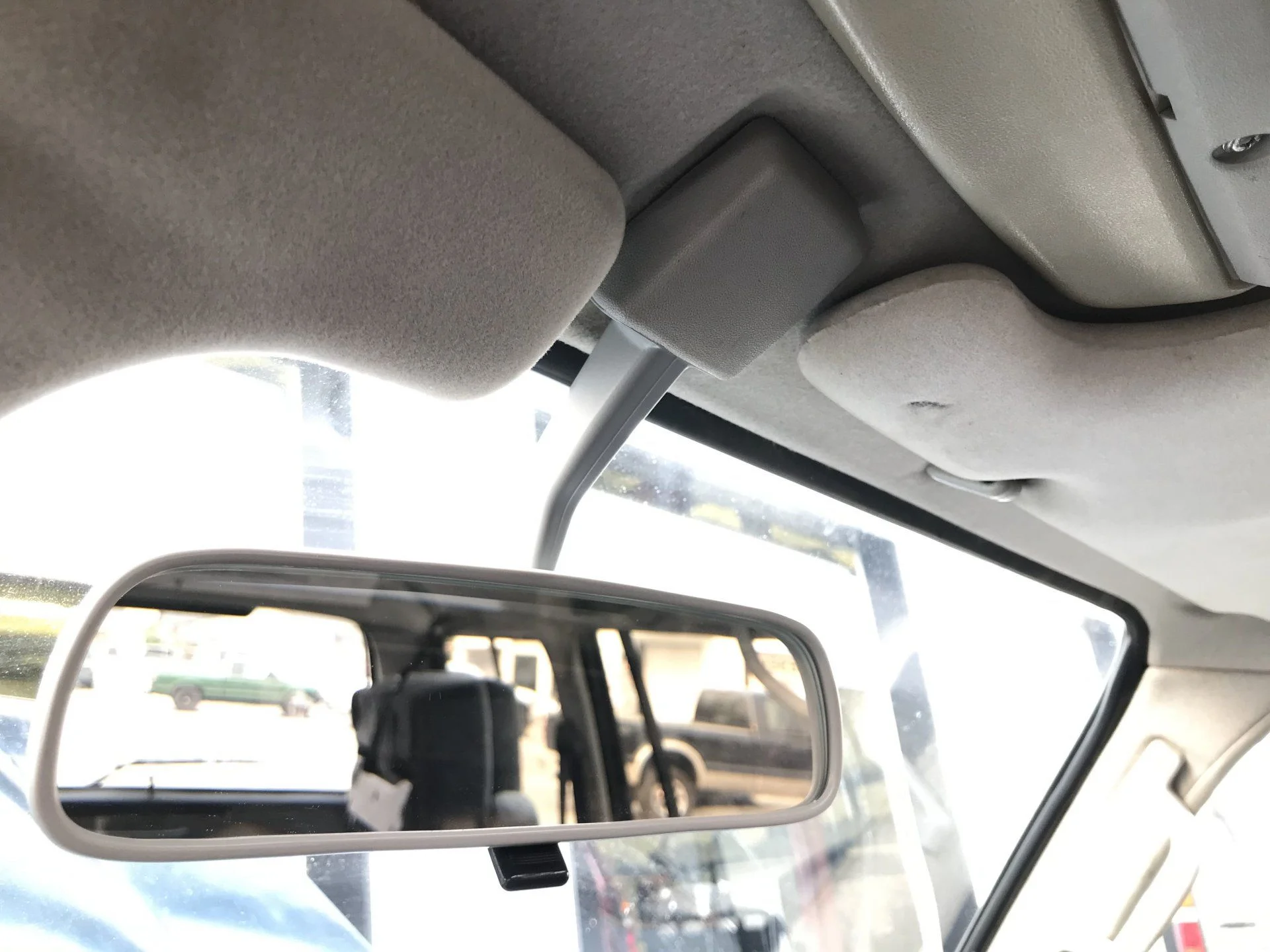

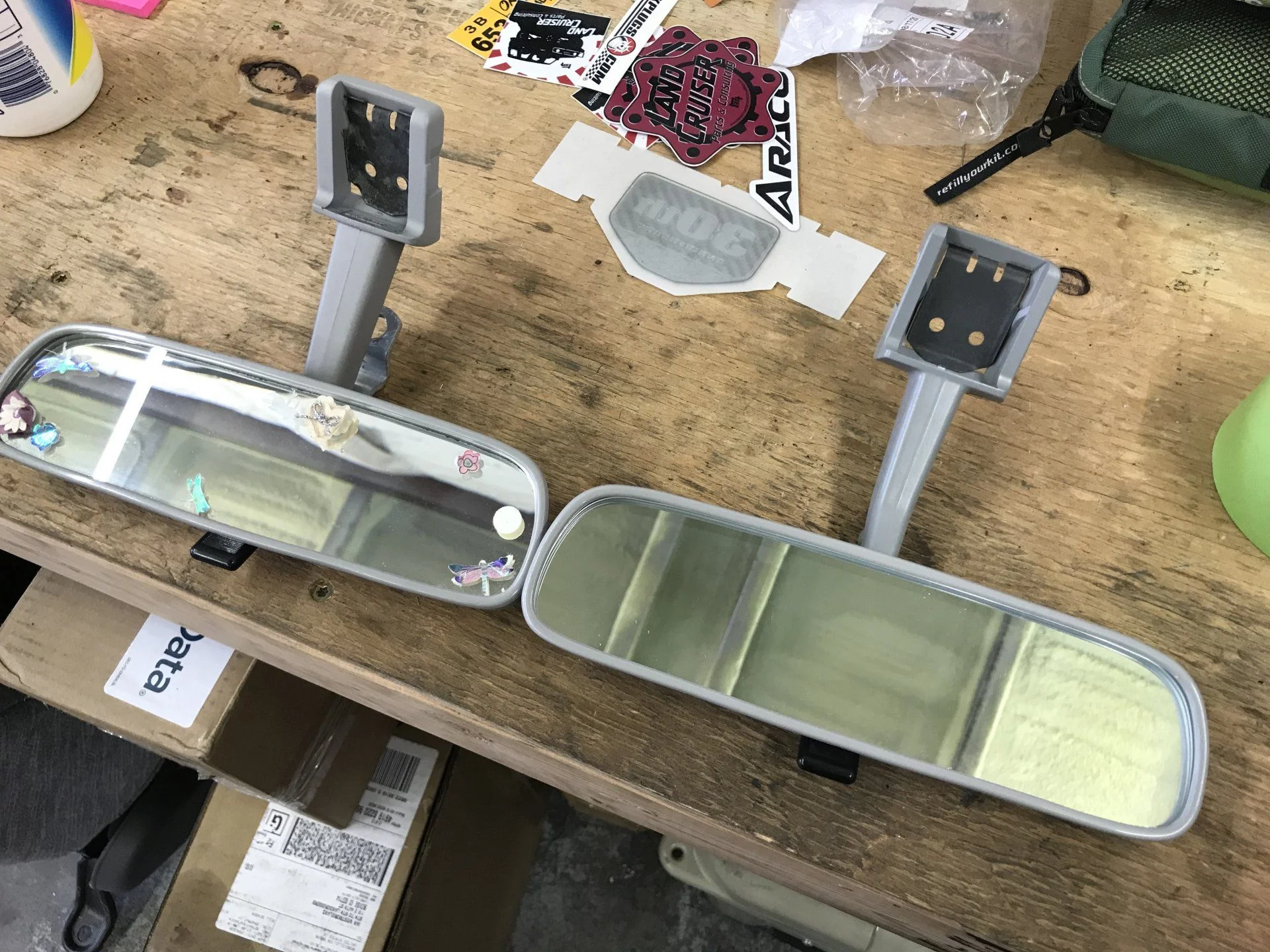

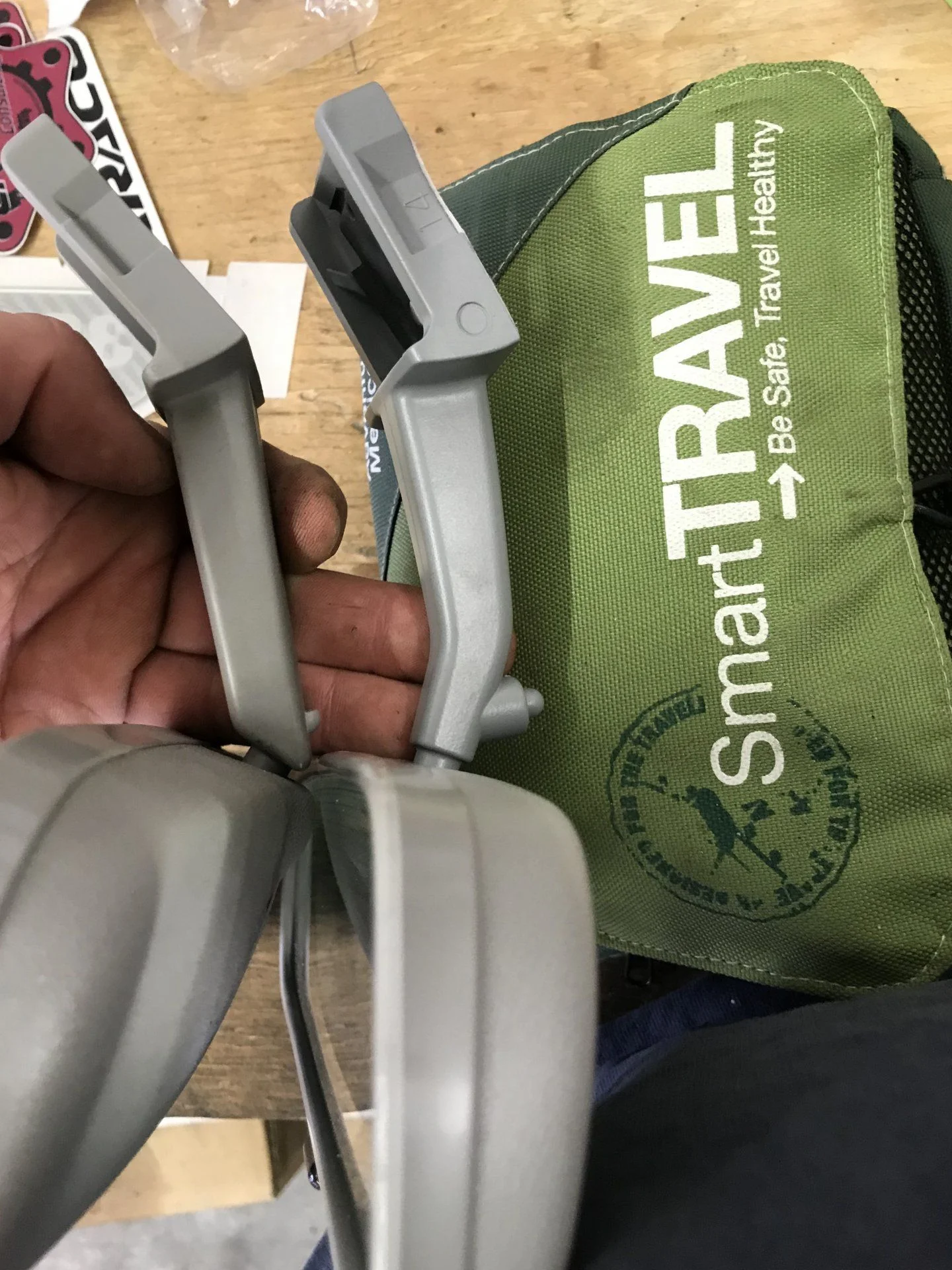

So here is a 70-series rear view mirror compared to an 80-series.
And here is the 70-series all mounted up in my truck.
I have had the 70 mirror laying around for over a year so figured why not see if it fits, it is new OEM and sure enough it fits great.
Cheers
Cheers
Then the 70 series mirror should also work in a 60 series. I'm using an 80 series mirror in my FJ60, bolts right up and the angle is good.
I don’t know availability of 60/80 because I have not tried to order one but the 70-series is readily available and not bad price wise.
Cheers
Cheers
Psh should have kept those sweet butterfly stickers lol. What’s the bump in the rear of the mirror for? Is that just part of the molding process or is there something that connects to the back?

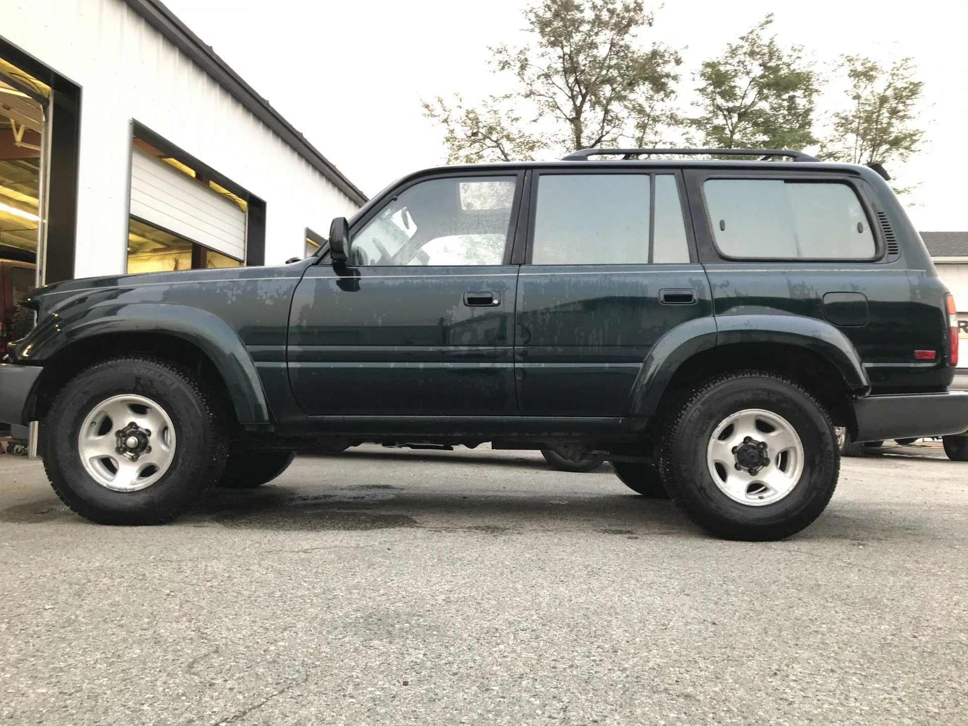

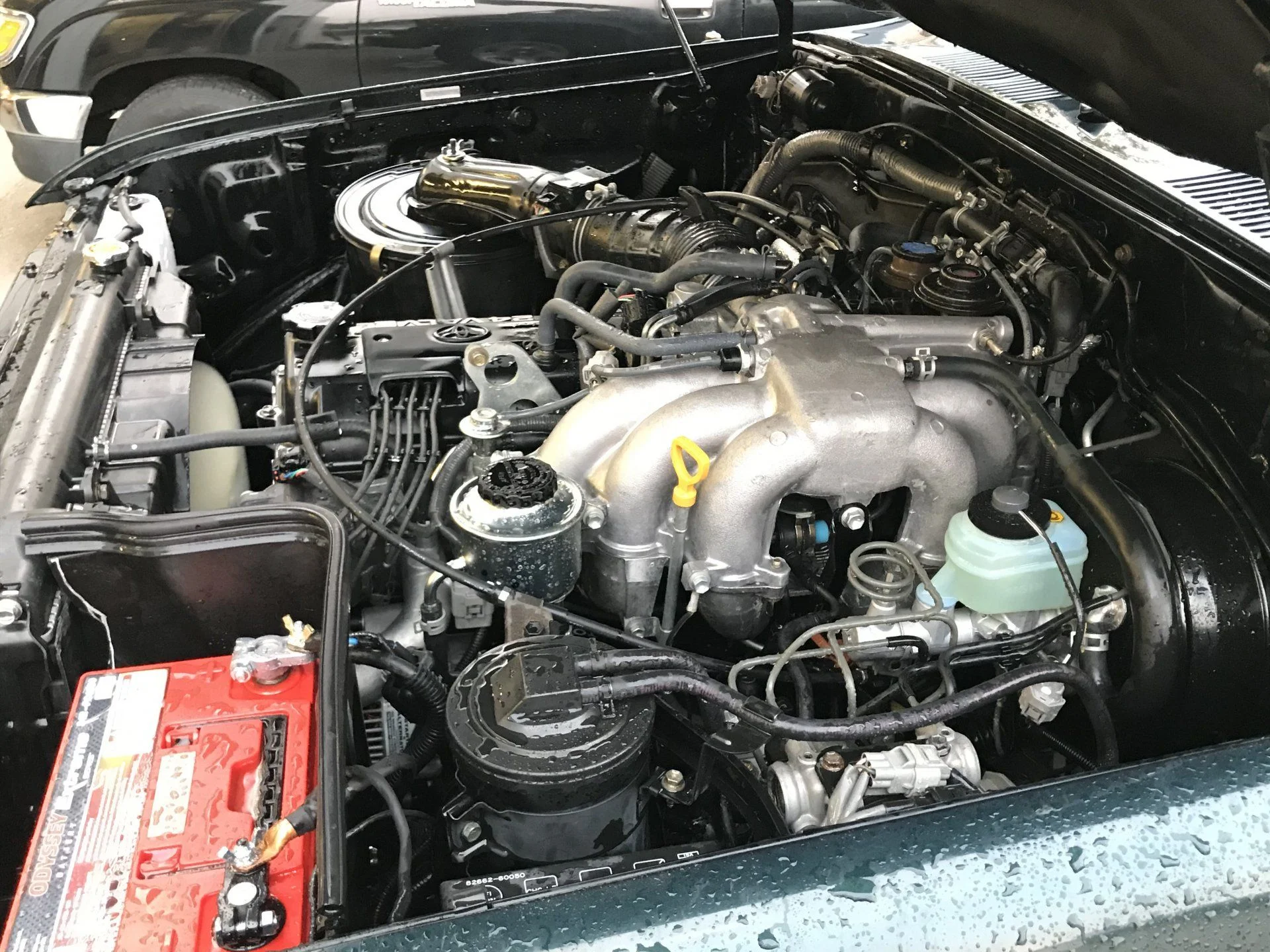

Alright, put my first 15 miles on it tonight. Ran over to a friends to show it off. Got my grill, and front lights in today too.
Transmission is no probs at all and working excellent. Engine is unbelievable, quiet, smooth and all that.
I never did really test this truck before this project started. So what doesn’t work?
-Old school JVC head unit is dead, zero music in the truck which sucks. Got to install my new head unit soon.
-Diff locks don’t want to engage, I am sure they are all gummed up, so need to pull them and rebuild/clean.
-Rear window washer not working, I am sure it is the diverter valve.
-D light doesn’t work and I am in no rush to tear the dash apart to fix it.
-Power switch for trans not working but 2nd start does. It was totally gummed up from spilled sodas so probably need a new switch.
-Need new bulbs in my front running lights. They are DOA.
-Need new bulb in my trans selector, got nothing.
-Have not tried A/C yet because it is still not charged.
-Have not tried to get ABS to engage.
-Have not tried cruise control yet.
-Got one door courtesy light not working.
That’s it, everything else has been tested and is working fine. The new steering is unbelievable, I don’t think I have ever driven a Cruiser with this nice of steering. Brakes are awesome, working excellent. T-case is no worries, smooth and quick in and out of low.
Not a single leak on the truck yet anywhere. 😆
For a 70-series there is a little rubber piece that goes from that to the windshield, I would say that is a damper of sorts.
