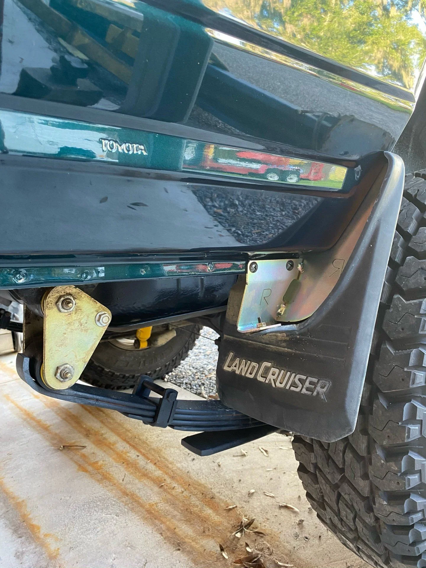

@ca18sean making some good progress this morning on the Kaymar bumper.
@divemedic Your Kaymar bumper install writeup was helpful, thanks for that! I ended up using John's original 77 mudflaps and trimming the brackets. I also used the small shims to get the bumper straight with the body lines, I know yours you said you didn't have to use them. Other than that it all bolted on beautifully. Wiring harness provided by Kaymar doesn't match up to the existing factory plug so I'm not sure how I want to approach that yet. I'd like to get the right plug for a 77 but I may de-pin the stock plug and go to a 6 pin deutsch connector. Exhaust hits the bracket a little but I think I can move the exhaust hanger over slightly to get it to clear. This truck is coming together so nicely, I love using high quality parts! Door panels and speakers coming soon.
I just tapped the factory harness and used some waterproof plugs. I may go back a redo this when I finally decide to get a camp trailer!
