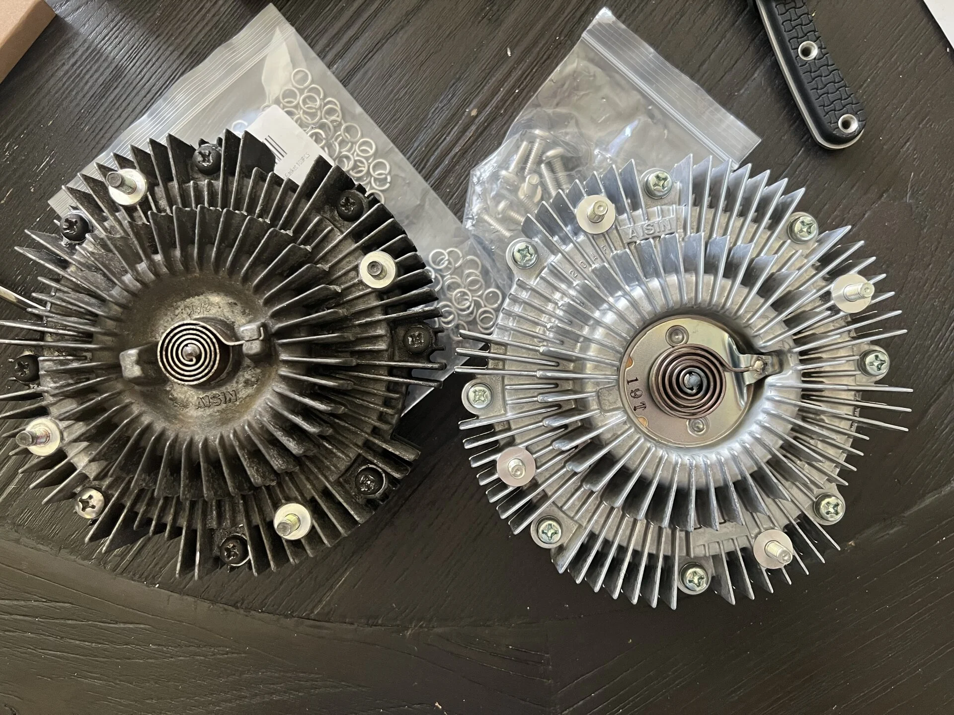

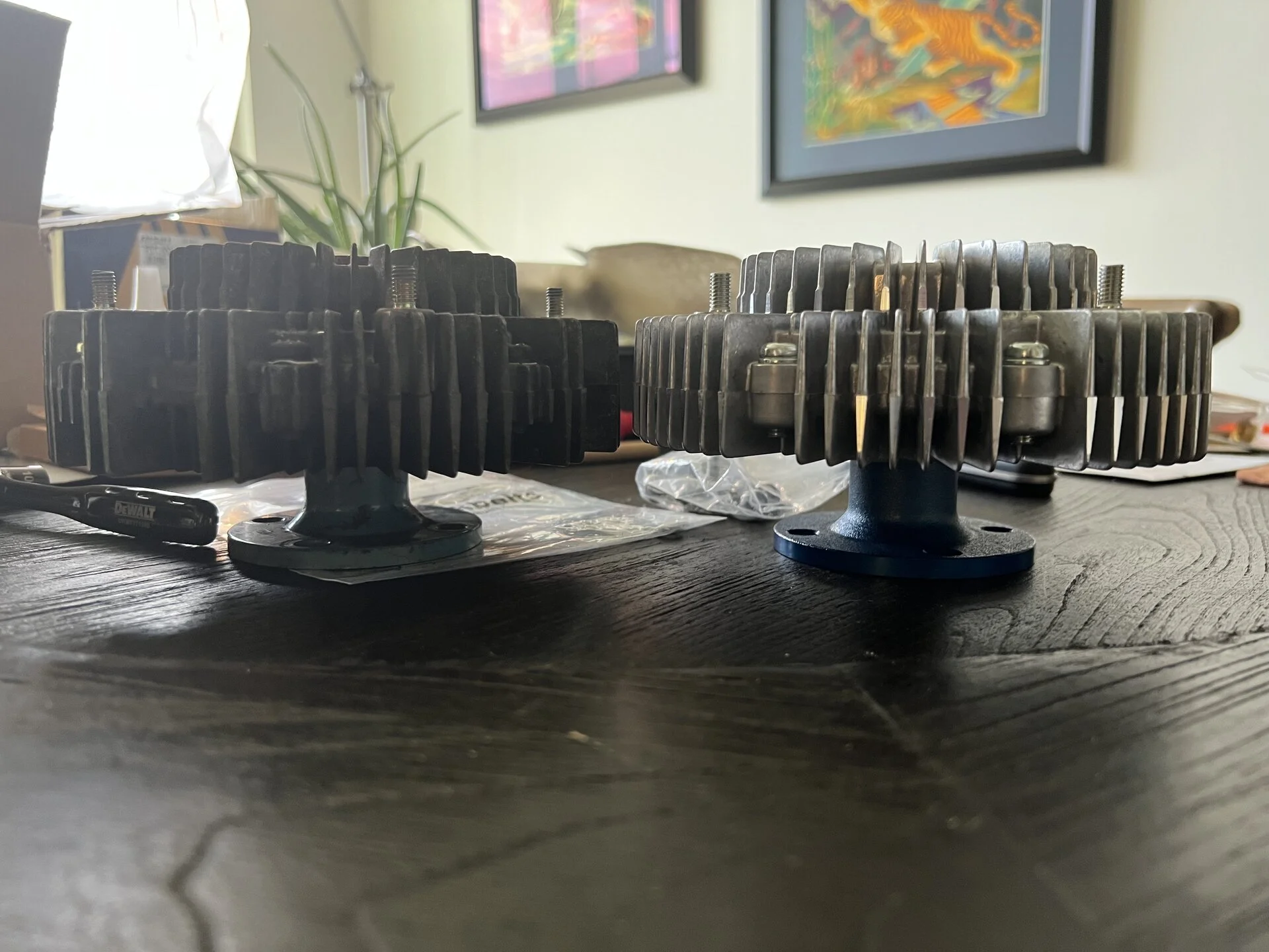

Update: I ordered AISIN FCT-004 Engine Cooling Fan... Amazon product ASIN B00829HAV8
And it seems to be the same size as what I had on there already (which I assumed was FCT-029). So if anyone is needing one for their LJ78, looks like this one will work!
