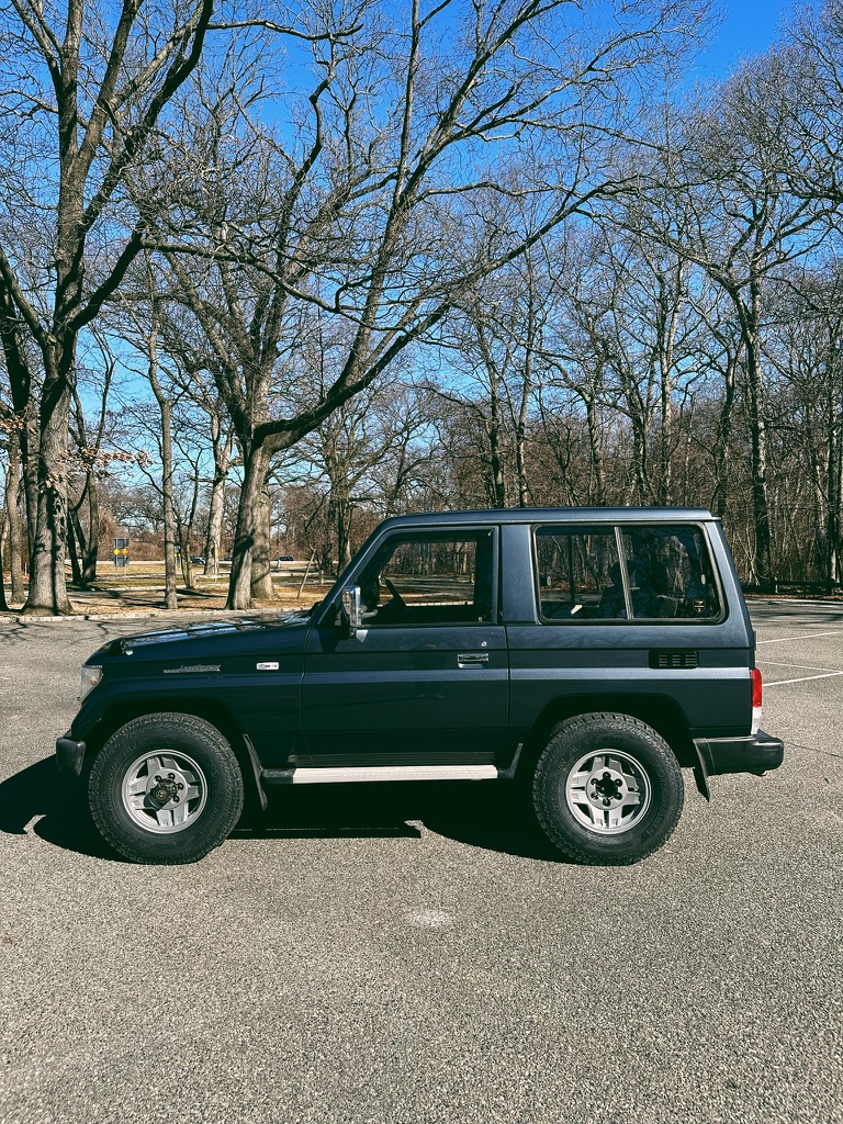

Enough of me talking, though! Here's the LJ71!
At the auction:
Picking up at Port Newark:

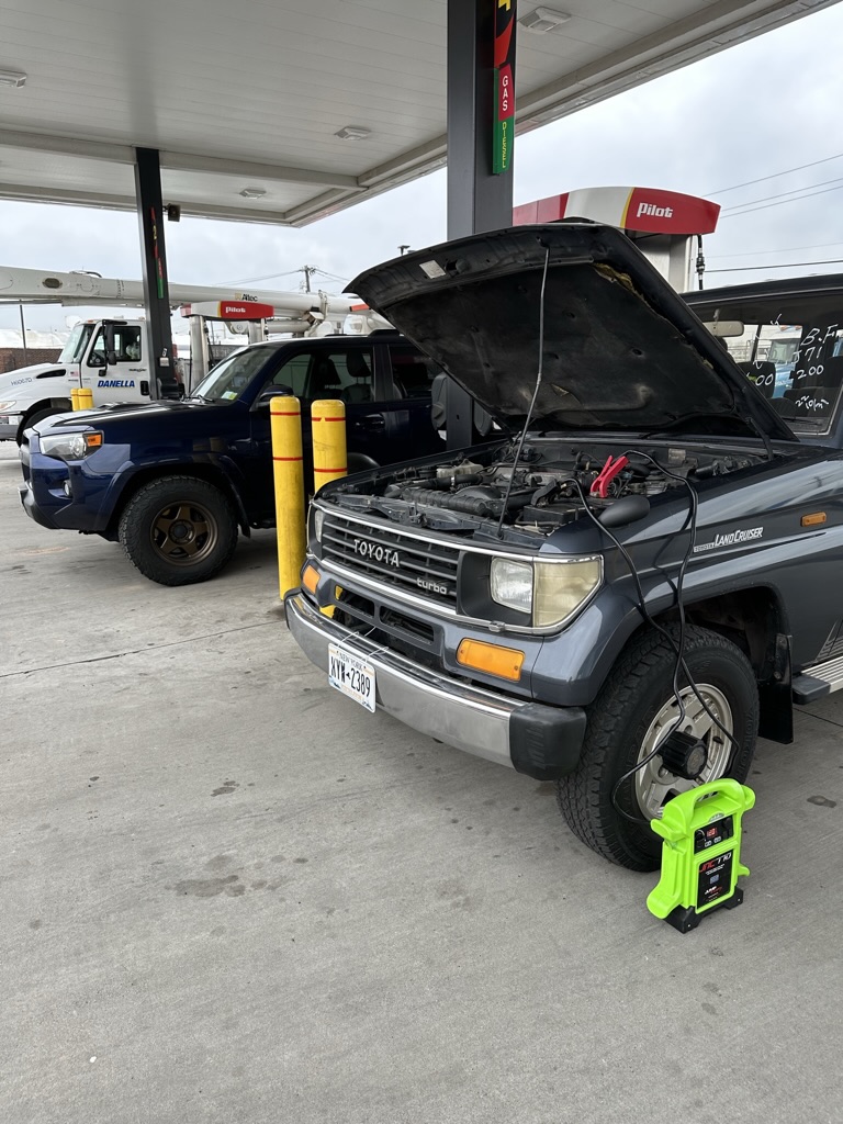

My JNC770 jump pack wasn't enough for the LJ71, so this was the situation at the port:

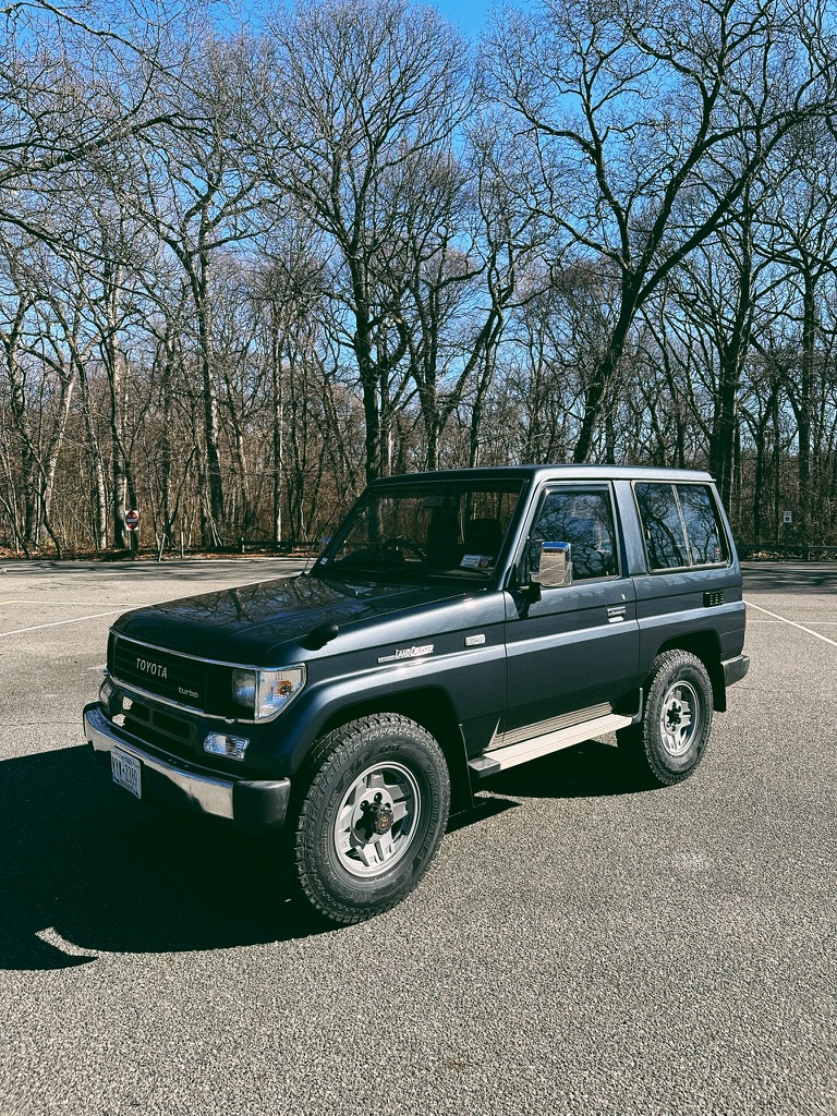

And again after refueling, next to my "support truck" that couldn't provide any support at all since I forgot jumper cables! Had to call Hagerty Roadside for a jump.
But after this, I actually drove the truck home ~50 Miles and it was a delight to drive. Everything worked, though it was clear the suspension has sagged and the shocks are past their expiration date. The tires are also in need of replacement. Thanks for getting this far! That's it for this post, more to come!

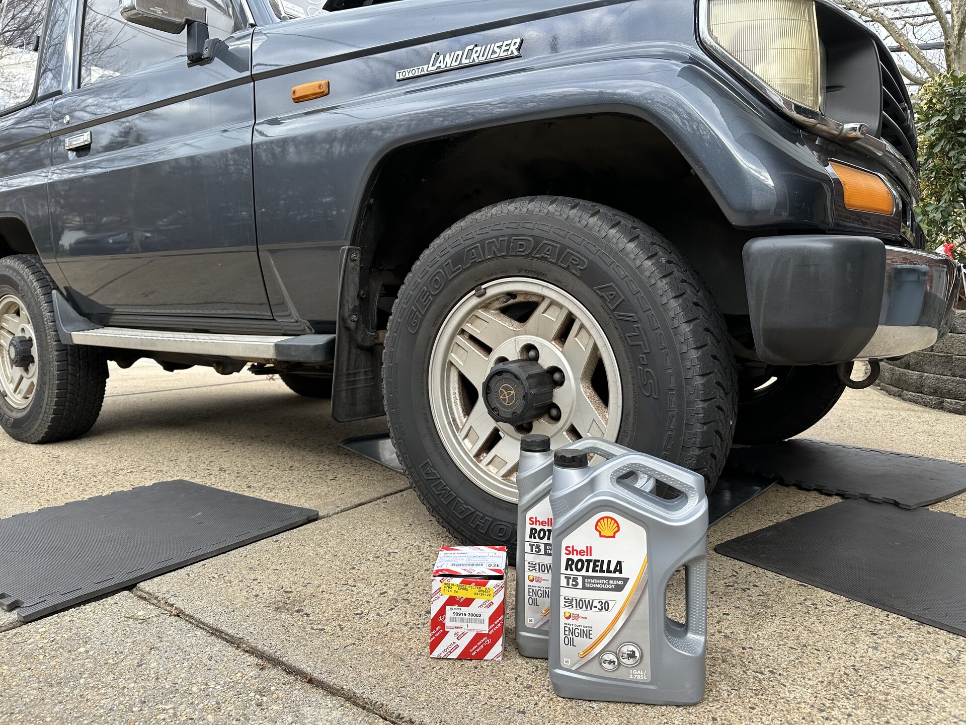

First order of business was changing the oil with Rotella T5 and an OEM filter I had in the stash from my LJ78.

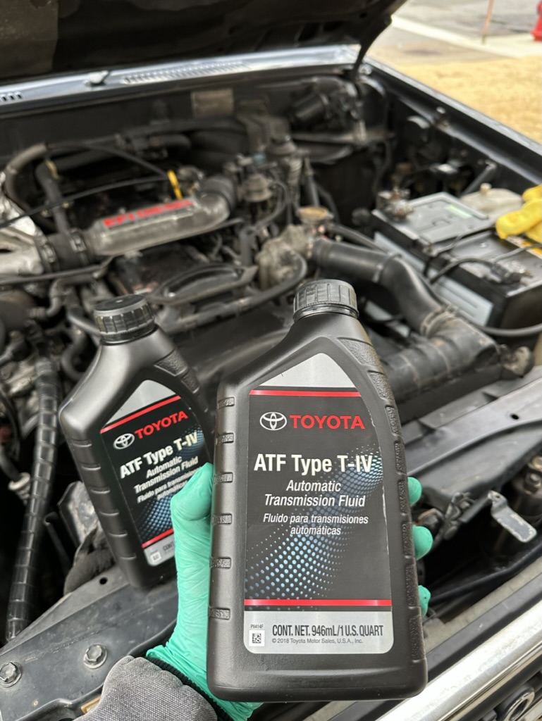

First Transmission Pan drain & fill. I have a box of this in the stash, so I plan on repeating this drain and filling process until I need to reorder, and then evaluate the fluid to see where I stand. Also topped off the coolant with Toyota Red and changed the fuel filter at the same time.

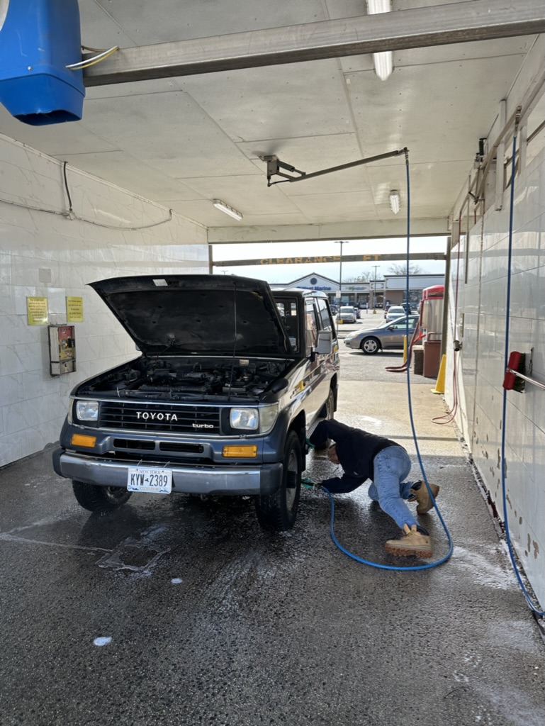

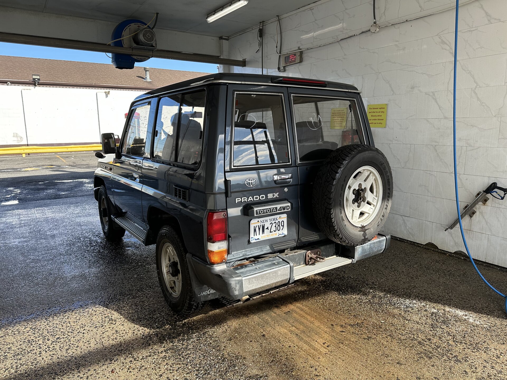

The first of many car washes - took a trip to the local coin operated wash bay so Dad could pressure wash the caked up grease at the knuckles. I think we will need a rebuild, as many of the wear items that did not perish due to mileage did so because of time. We'll keep progressively cleaning the car when we can to really get a good idea of what needs doing now and what can wait.
Paint looks good even after just spraying some water on it. I'll be ceramic coating the paint when I get the chance, and hopefully since the respray is quite new, I do not have to polish much.

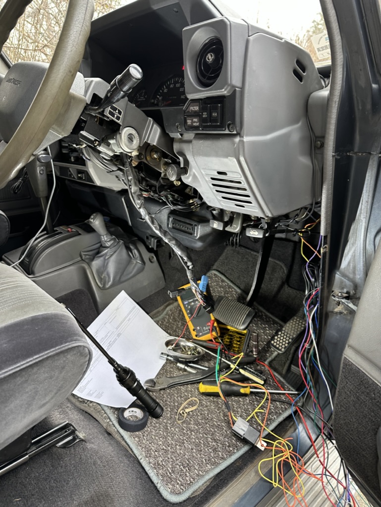

Finished up the keyless entry/alarm system today. The truck came with two sets of keys, one for the doors and the other for the ignition. I can't figure out why - it doesn't look like the steering column was ever tampered with. Perhaps the previous owner just liked having two sets of keys?
Either way, went with a Viper system since I installed a similar system on my old LJ78, and I've never really had a problem with DEI products.
For other 70 Series LJ and KZJ owners looking to install an alarm, I tapped the following:
12V Constant: Black/Red @ IGN Switch Harness, Under Dash
Starter Kill Relay: Uses Brown/Red @ IGN Switch Harness, Under Dash
Ignition Input: Black/Yellow @ IGN Switch Harness Under Dash
Door Trigger (Negative When Open): Black Wire Main Body Harness Plug @ Kick Panel
Door Lock - Lock, + Unlock Output: Red W/Black Stripe @ Connection to Door
Door - Unlock, + Lock Output: Red W/White Stripe @ Wire Harness to Door
Parking Light Flash: White Wire @ Black Plastic Connector, Steering Column
I ran wires to the siren and for a hood pin to the engine bay. Picked up some "nicer looking" hood pins on Amazon and Dad made a bracket out of some scrap metal since I preferred not to drill any unnecessary holes in the engine bay. Turned out well, and better looking than the old-style pins.

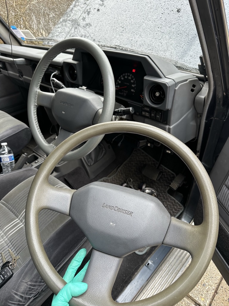

After getting the alarm buttoned up, I swapped the steering wheel for the one off my LJ78. The one that came on this truck was yellow like all of them. It's unclear what I'll end up doing with this. I might try repainting it, then wrapping it with the Amazon leather wrap, or perhaps try and source a custom wrap that covers the entire spoke.
Placed an order for a Dobinsons Stock Height Restoration Kit + Steering Damper today. The sales rep at Dobinsons said it would be a 3 month wait for the springs to arrive stateside, so I guess that will be a project saved for the Spring. Plenty of work to do in the meantime!

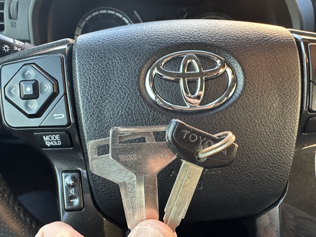

It is not uncommon for the ignition to be swapped out by itself leaving you with two sets of keys.
It takes a bit of research but you can buy complete new lock sets from Toyota that will give you one key for everything.

As for the key, I was reading up on how to "re-key" the lock cylinders. If I can get a set of Toyota wafers and figure out how to do it the right way, I'll re-key the ignition cylinder to match the outer doors.

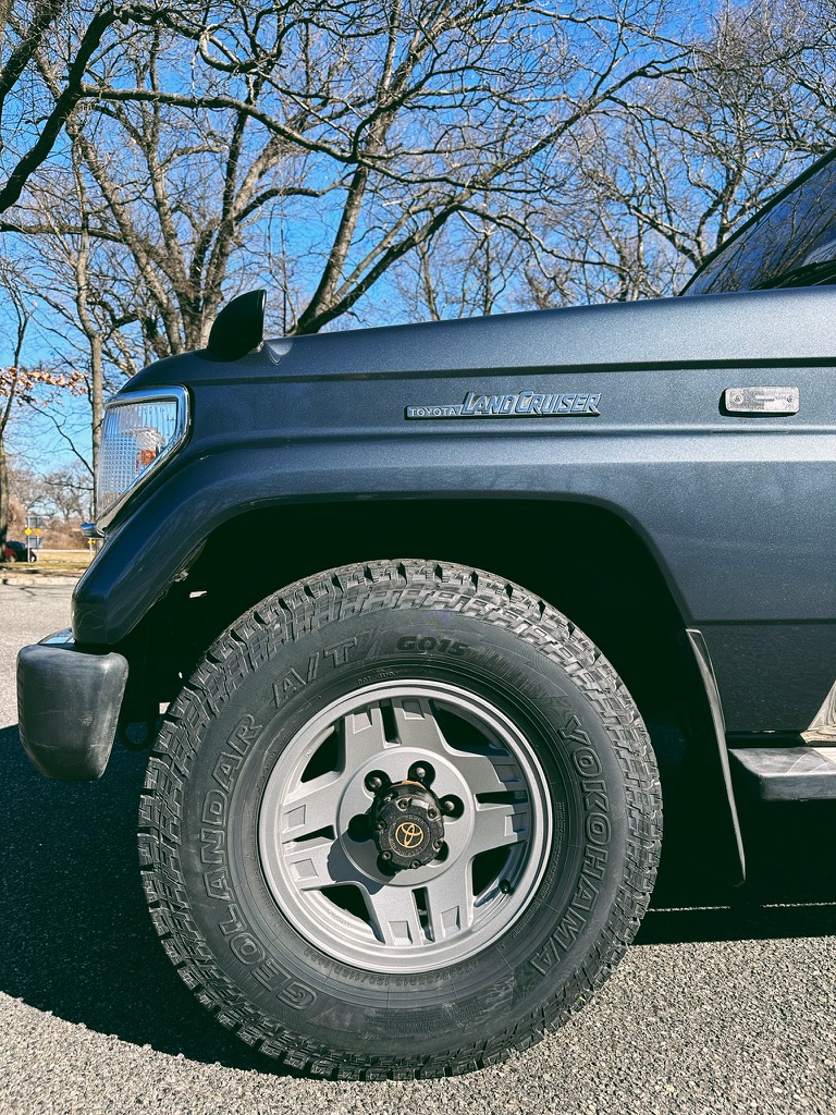

Dad liked the less aggressive tread pattern (and price) of the Yokohama Geolandar G015, so we purchased a set of those in the forum-recommended 235/85R16 sizing to have mounted and road-force balanced after the wheels are refinished. We're going with a silver that's a few shades darker than OEM to give the truck a more modern, OEM+ look.

I was able to get replacement keys cut for the door locks - the previous owner was quite the handyman and decided to label the door lock keys by cutting the plastic off and drilling a hole through them. He finished it off with a custom soldered copper wire keyring! Fixed that with some TR33 key blanks off eBay. If any owners need the OEM PN for 70-series keys (with the plastic head), it's 90999-00212.

Got the wheels back on the car, and they look great. Real happy with the slightly darker silver powder coat (Cosmic Grey) that gives it an OEM+ look. New tires are the same Geolandar A/T that came with the truck from Japan, but in 235/85R16 sizing.

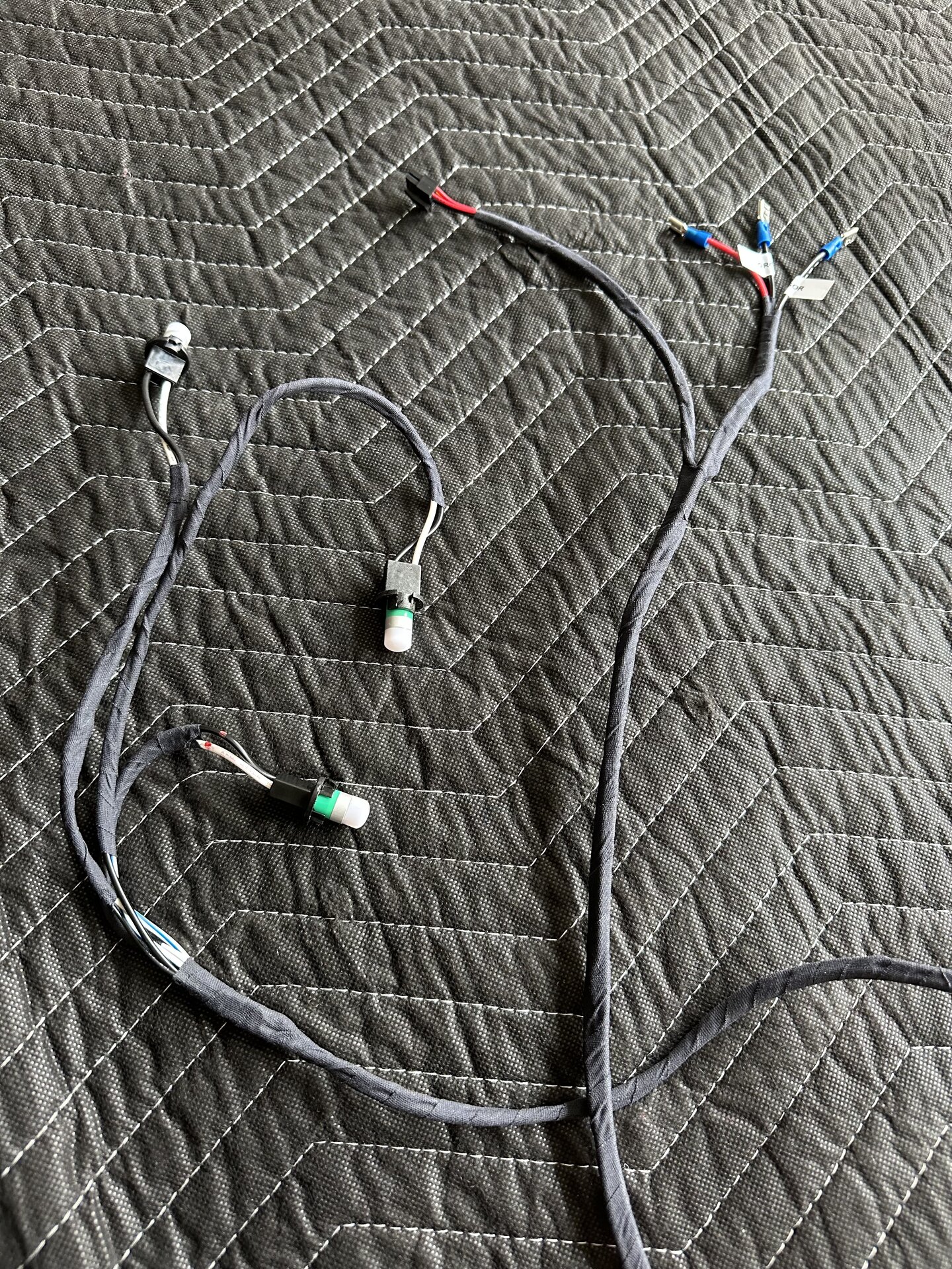

As always, I aim to make every install I do as clean as possible: custom harnesses cut to length, soldered, and fabric taped prior to final fitting. Also used add-a-fuse connectors for the lighting and power harnesses for the gauges to make for a reversible installation in the event we move these gauges elsewhere.

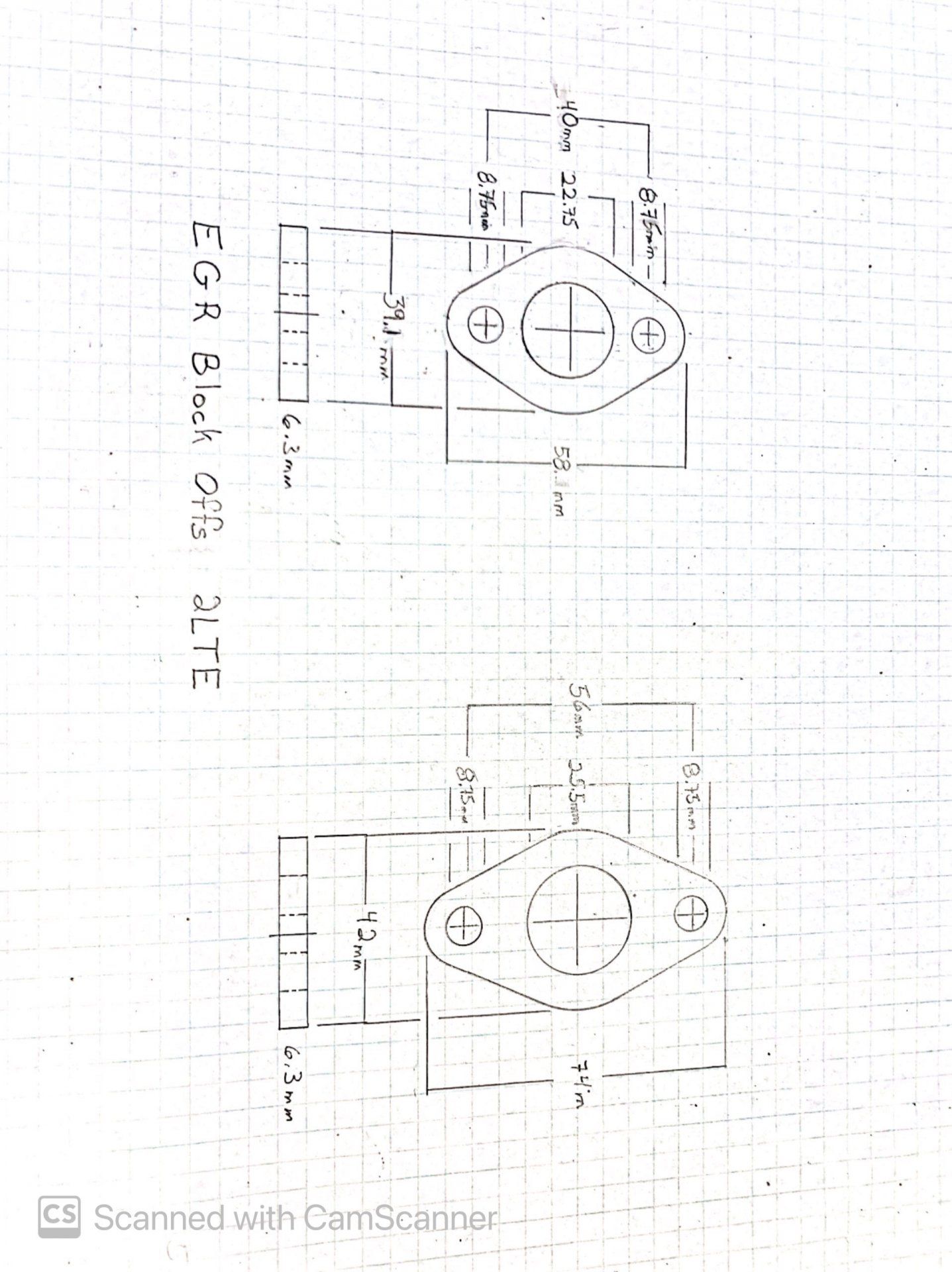

Also wanted to thank @Copydoc for this blockoff plate illustration:
726a5812-1634-4fe6-9ee4-73c431316a31-jpeg.2644046
This drawing helped us know that we had the right scrap metal on hand to make the blockoff plates, and I hope it can help other people here too!

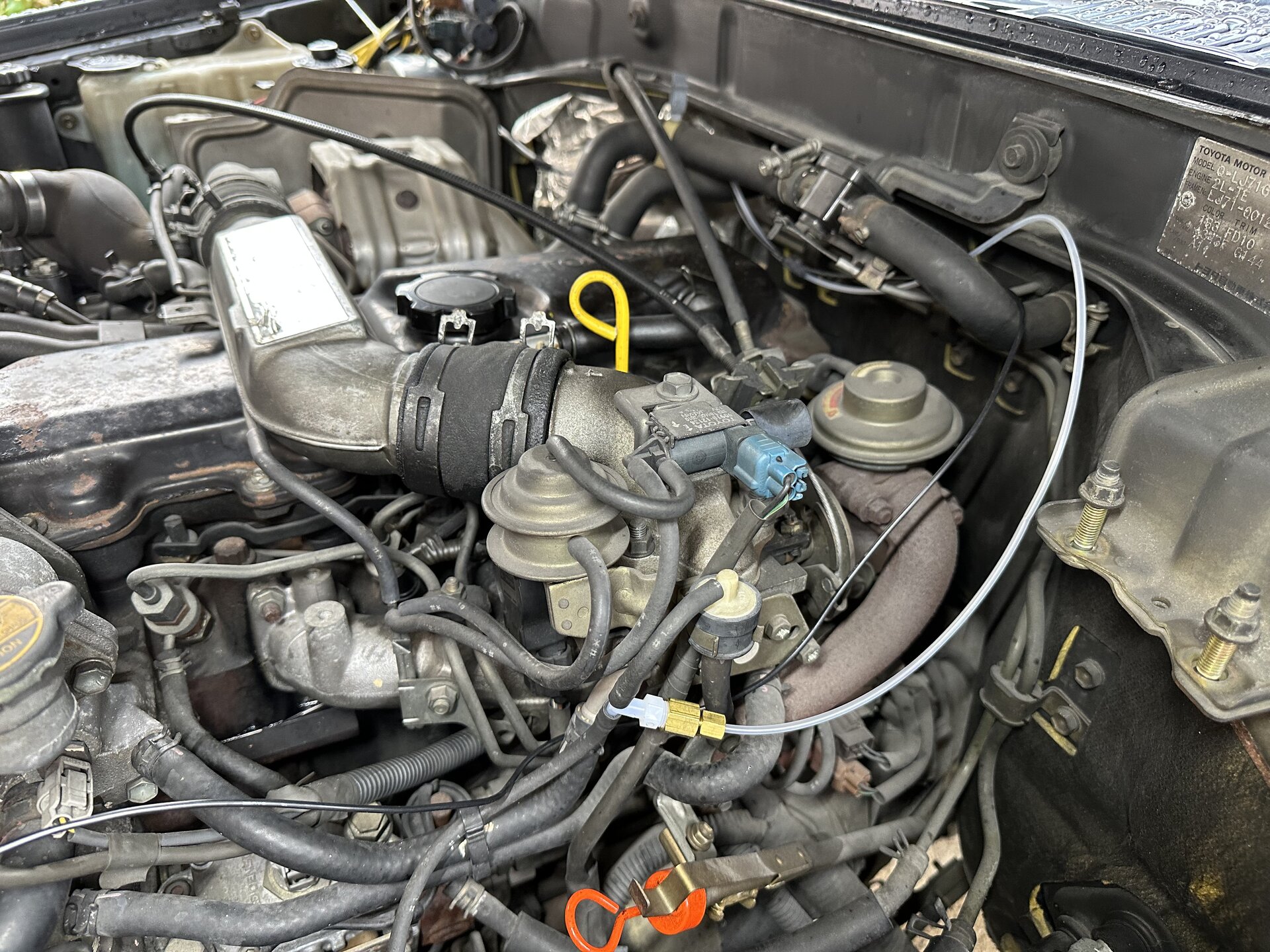

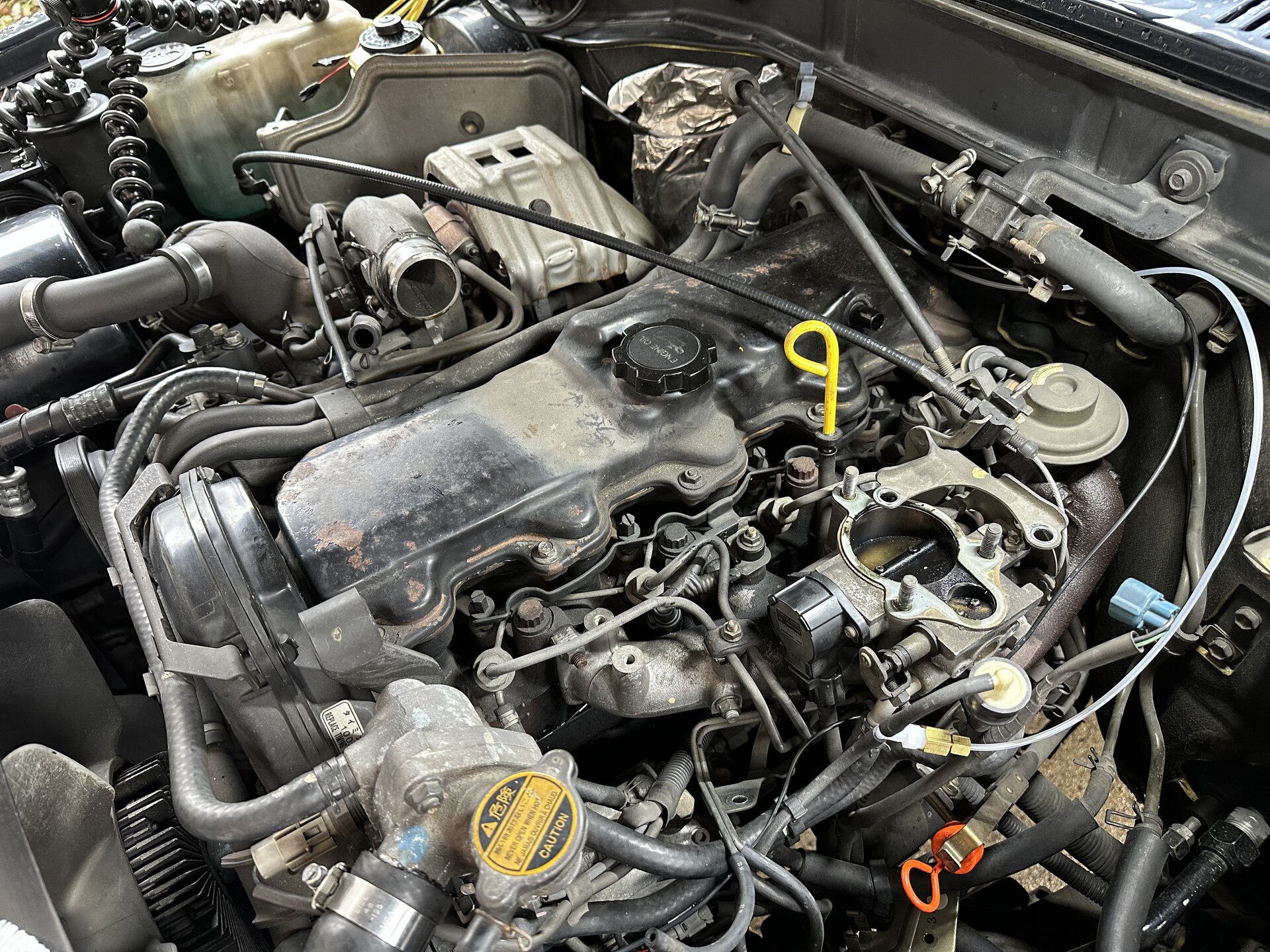

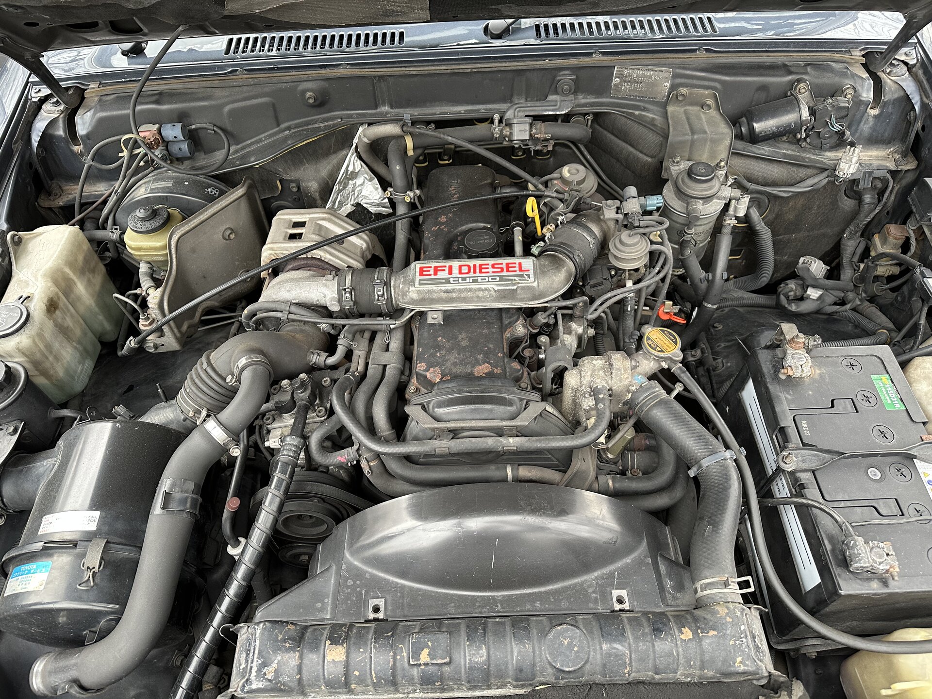

For reference, this is what the engine bay looked like before we started:
After the fuel filter was moved out of the way, we disconnected the top vacuum sensor (blue plug), forward-most "UFO" valve and bracket, and intake tube connected to the throttle body:

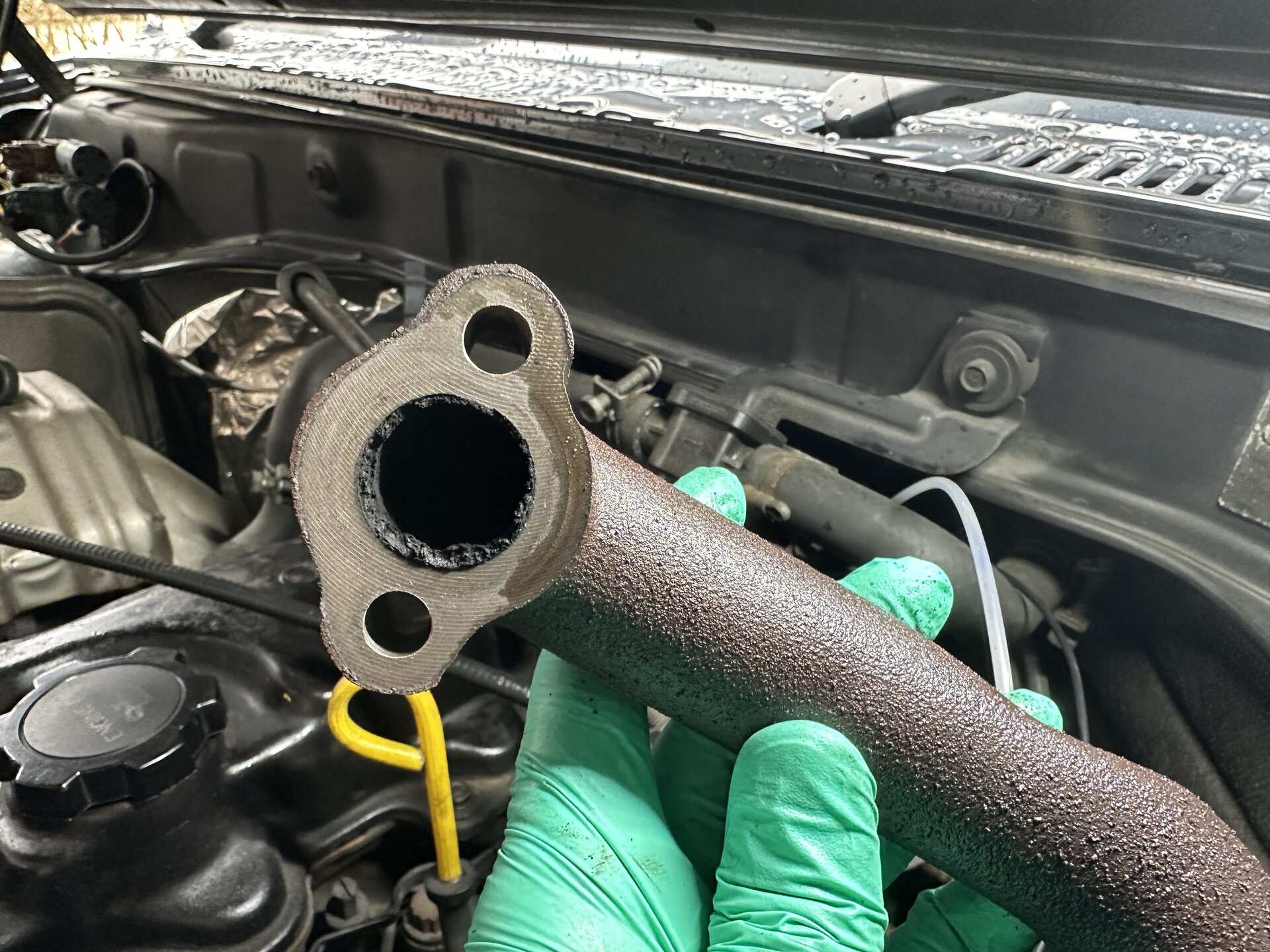

The intake portion of the EGR pipe came off without any trouble, though admittedly I did marinate the nuts in PB Blaster in anticipation of a battle. With 40K Km on the odometer, this is already more than enough gunk for my liking. Glad we decided to tackle this job sooner rather than later.
The exhaust side of the EGR came out without issue as well. I removed one nut from the top and the other from underneath. Here's what we were left with:
Dad got to work on the blanking plates by using the original gaskets removed from the system, and I got work removing the throttle body to clean it along with the parts of the engine bay exposed by our work:

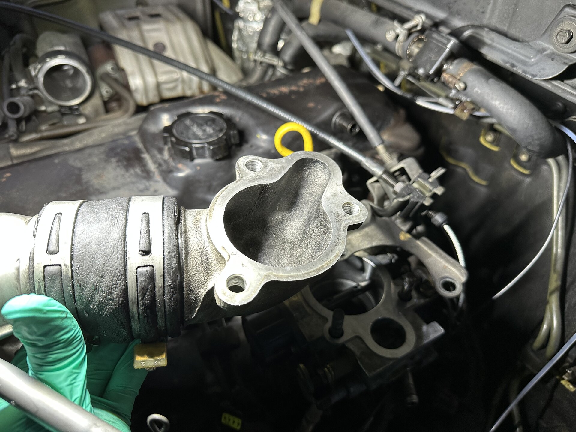

I removed both butterfly valves while the throttle body was off the car. Also to note, the screws for the large butterfly plate are pressed on the other side of the shaft and the screws are easier to strip than those used for the small valve. I used a Dremel on the ends before trying to remove them, and ended up stripping one anyway. Had to notch it out to fit up a flat screwdriver. Here's the result:
I did not have both throttle body gaskets and the original ones had crumbled during disassembly. Having failed to see this coming and order gaskets from Partsouq before starting this project, I resorted to gasket maker. Not wanting to go to the parts store to get Permatex Blue, I used some Hondabond Dad had in his toolbox. If it doesn't hold up, I'll have to spring for those OEM gaskets. For those who need it, they are part numbers 17116-54030 and 17116-54011. Not available locally in the USA.
Started the reassembly process after getting the intake pipe cleaned:
