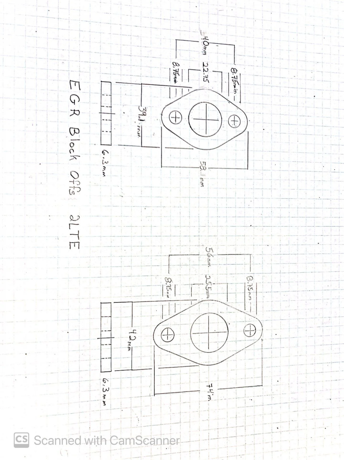

In search of dimensions or someone willing to sell plates to block off 2LTE EGR. Thanks let me know whats out there. Post pics of your rigs deleted egr if you have some. Thank you.

Just trace out your old gaskets on pieces of metal and cut/drill accordingly. I used aluminum on the intake and steel on the exhaust side.

Gotcha. I guess i will just order the gaskets as i do not have tube or gaskets.
I am sure you have resolved this by now but I thought I would post this for future size requests. The larger one is the exhaust and needs to be steel.
