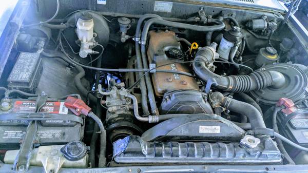

This isn’t far from you, though I’m not sure it’s worth what he’s asking. There are also 1kzte half cuts out there:
Gotta ask- did you get a chance to drive the van with the original engine before it blew up? I don’t think a lot of people in the states realize these non-turbo L engines are absolute turds. A fully loaded hiace with a slush box is going to have a hard time going 65 on flat ground I would think. The answer to your last question is probably a 1kzte. Whether it’s worthwhile or even possible to swap one into your current vehicle is another question all together. Lots of the newer gen KZ equipped hiaces popping up over here recently you might be money ahead to just trade up.

The 1KZ-T is a good idea; didn't know I could swap my pump. I can't seem to find much info, but not knowing about overhead exhaust clearance in there, or transmission fitment issues were my concerns. I love the idea of a block from overseas; I should try to get my engine out and verify the internal damage. Yes, they ruined a stout iron block, it seems. I will be the first to say I am slightly in over my head on this one, but it is what it is. =)
The KZ lump is quite similar to the 3L. It's slightly bigger and obviously houses a turbo, but overall it's quite a compact engine and came stock in many hiaces, maybe not your generation. I'd even think there's a possibility your trans may mount to the KZ bellhousing no problem. But if you're not looking to spend cash, and haven't got the fab experience or confidence, then just try and source a 3L block or complete lump.
Speak to some of the american JDM import companies and they'll probably be able to source one for you. In addition, I know there are some of those engines floating around in the UK, mexico and south america. But overall, the 3L was a rare engine compared to others.

Thanks for the detailed, yet quick reply. Half-cut is a very good idea, it had crossed my mind. KZ half-cut was probably the tip I needed, I'd been searching 5L info.. Mostly ruled out 2L because of the chatter around head failure. I didn't get to see the van before it died. I assume 3L automatic will be painfully slow. My '89 22RE 4x4 manual trans pickup is pretty slow without powerband revving, this would be my closest personal reference. This is my first Diesel. Van has only front seats, side panels, and factory sub-floor for current interior. I am going to try to keep it "light", but I imagine the KZ would make this van more viable around mountains. That '93 is nice, but the interior height, 4x4, t-case, awning, and blank interior sold me on this homely van. Thank you for the info.
