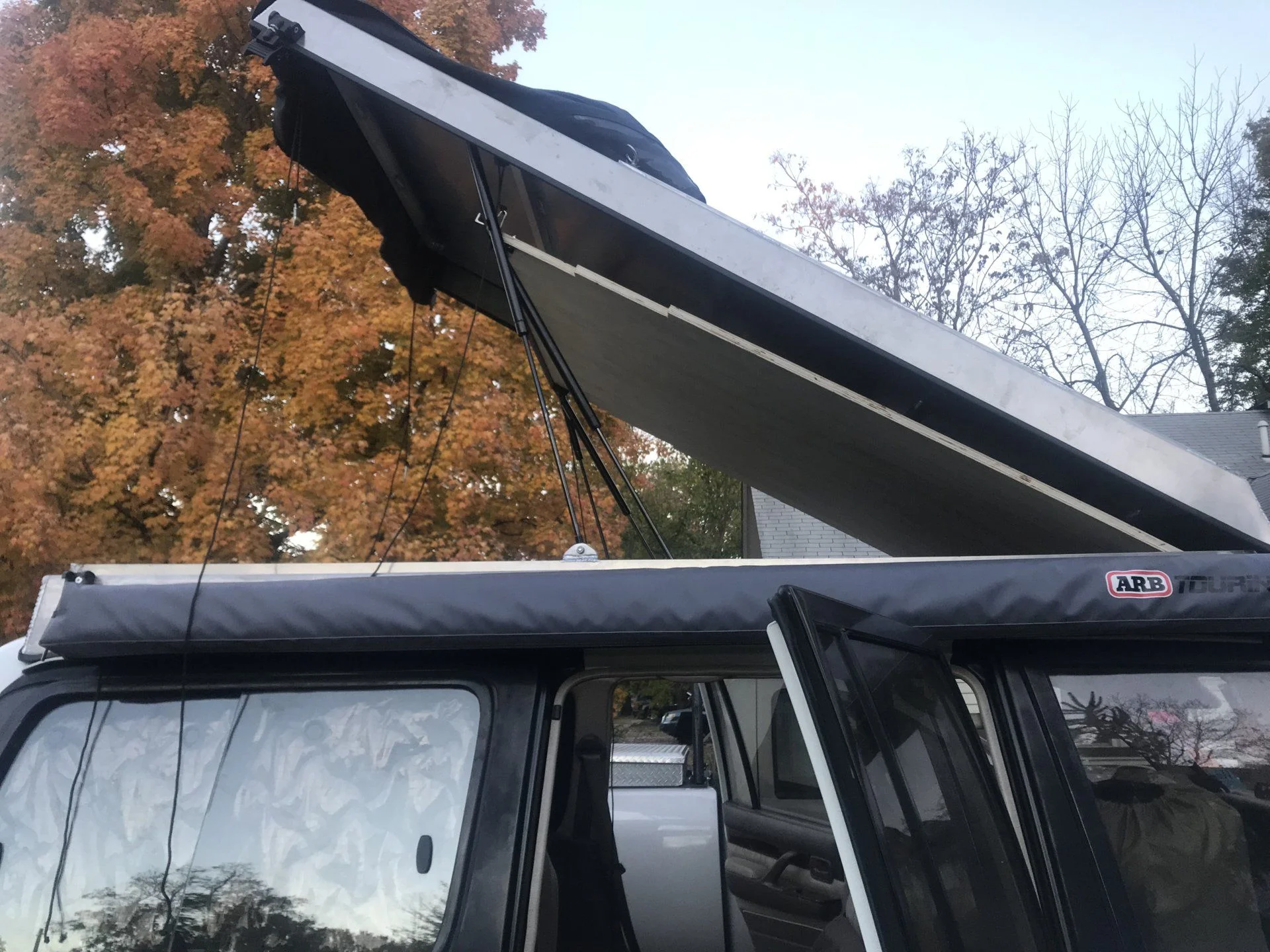

I cut my roof and at first I used two Exped inflatable mats. This past fall I switched to a 3in foam with a bed platform that raises up out of the way on gas struts. The platform is cut in two, the front part is 60in in length and the back is 20in. I cut the foam into two separate pieces as well(main reason I switched to foam from the Exped mats). I can raise the back platform and crawl in bed and shut it behind me. I can raise the bed with the foam, bedding, and pillows no problem and stand up inside. However, I have to remove the pillows to latch the top down. It’s possible to keep the pillows up there, but I think you would have to go down to a 2in foam if you wanted to leave pillows up there. Here is a picture as I was building the front platform.

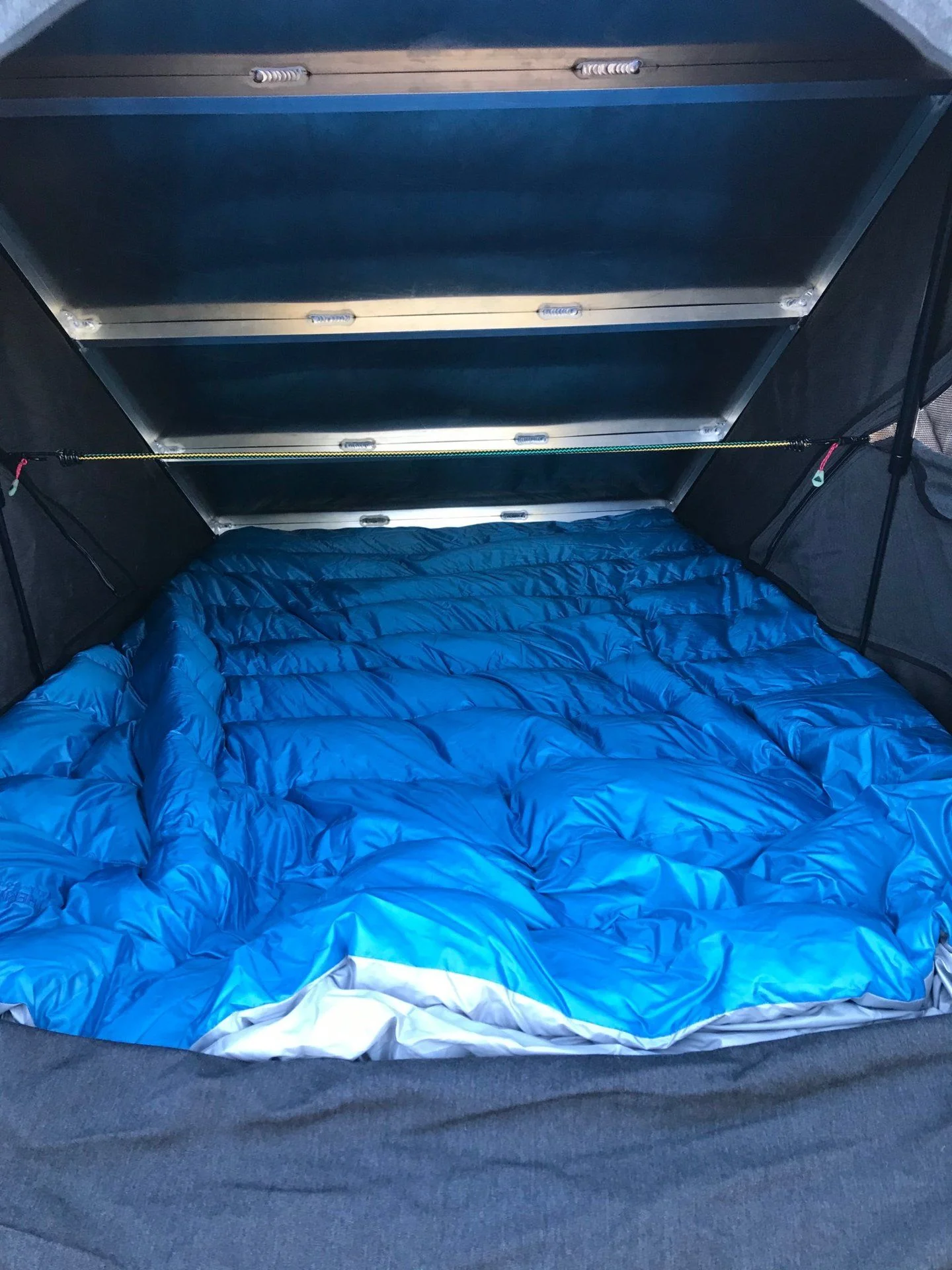

Sleeping system update:
I've been using a Thermarest Vela Double down quilt with the Minnesund Mattress. It's warm down to about 40 F, perhaps a bit lower; it hugs the mattress with a foot-box sleeve, and thus stays in place. I can close the Campteq onto it, leaving it in place between stops.
Very functional and convenient. In colder conditions I throw a second down bag, unzipped, atop like a blanket.
