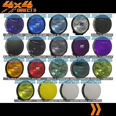

Thanks! The fog lights are called IPF Super Rally Type M. I don’t think they are JDM. One of them cracked and doesn’t light up anymore. I’m going to replace them with some small ditch lights to get better airflow through my radiator.
I have the same ( or very similar) IPF Super Rally lights, and I think they're fantastic. They are actually a competition spec light, and with the IPF upgraded wiring loom are rated for 170W halogen bulbs. I have 55W/100W bulbs in mine, and they make a huge difference at night by lighting up the ditches and revealing the deer and other animals lurking there :)
They are still available new from ARB, but cost something like $700 for a pair. I am on the lookout for some covers for mine to prevent the lenses getting chipped or cracked like what happened to yours.

Yeah I really like the look of them. It got chipped on the drive home after I got it. I’m going to see if I can repair it.
I came across these, I think they should fit. Need to confirm model number on my lights first.
Edit: I just realized you have the Type M 940 which is a 195mm light. Mine are the 930 220mm lights, as are the covers in the link. It looks like that seller also has covers for the 940’s.
