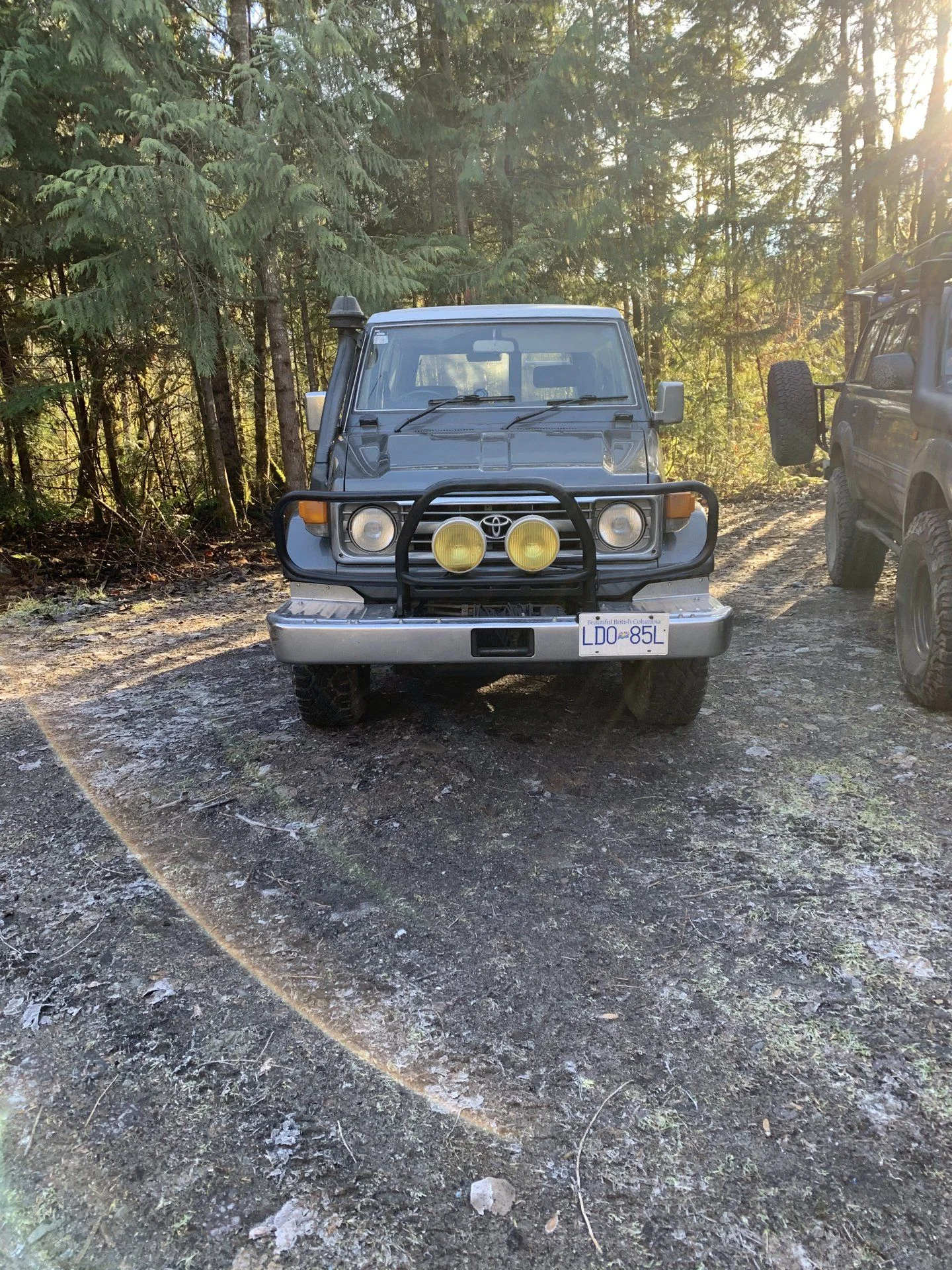

Put in some OT at the shop today, But here are the pics. My friends 80 series on the right in the last pic.

That is a very good looking 74.
Are the fog lights JDM?
Juan
Thanks! The fog lights are called IPF Super Rally Type M. I don’t think they are JDM. One of them cracked and doesn’t light up anymore. I’m going to replace them with some small ditch lights to get better airflow through my radiator.

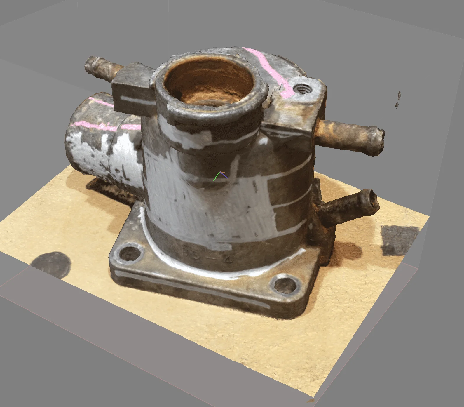

Start looking for the elusive thermostat housing.
Okay, I'm searching far and wide but I don't think I will find one for a while. Mine isn't showing a lot of rust but what can I do to keep it from rusting out? Are there no other housings from other models that can fit or are there any upgrades I can do to not have to worry about it?
Its possible there are, but I thought others would have been there for a look already. They use B engines in buses and small trucks as well.
