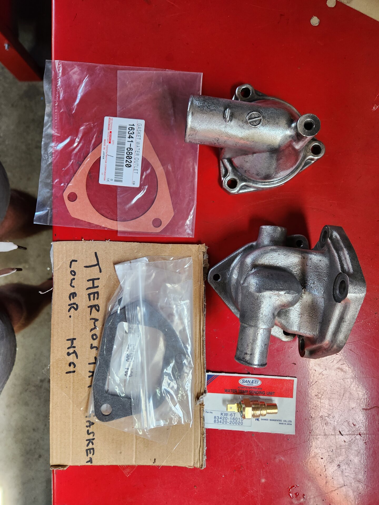

Cleaning up the thermostat housings. Pretty satisfying, super easy with a few different sized wire wheels.
They came up really good, looks a bit better in real life. Replaced with genuine gaskets and replaced the temperature gauge sender which was also rooted.
