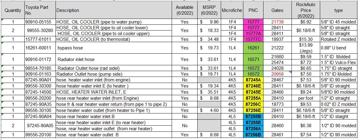

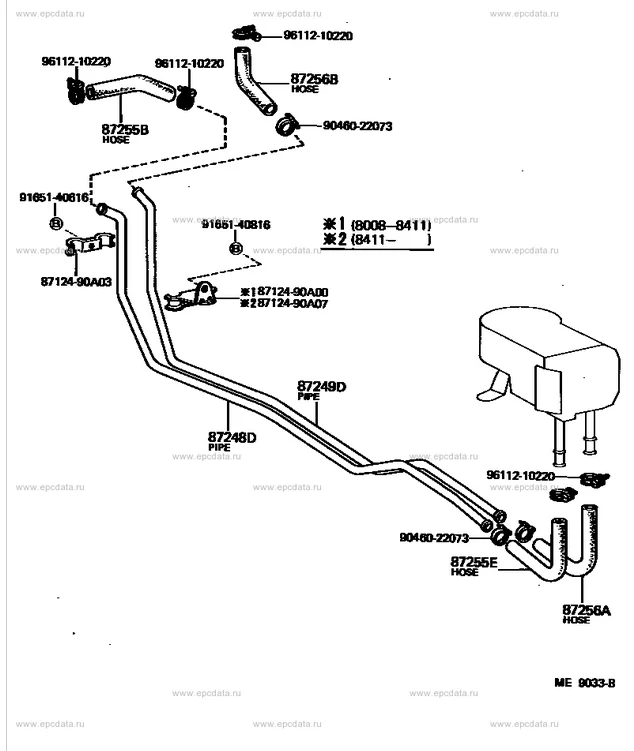

Hi, Many threads, I know ,read most . What’s the best hose for this 5/8 is to big. Thanks, Mike
Good catch. I assumed it was a 60 due to year for the US market.Those are 1/2" molded 90degree bends. Gates 28460 is a substitute (for the FJ60). Is this for a 60 or 62?

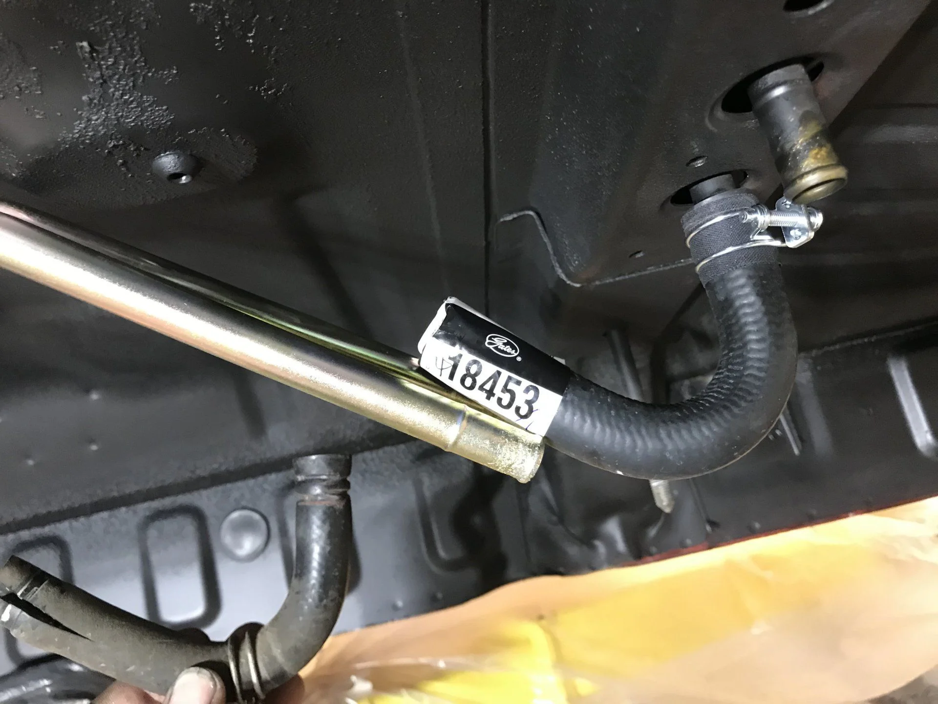

I found a good replacement heater hose for the external heater—the ones under the truck
gates # 18453View attachment 2247939
