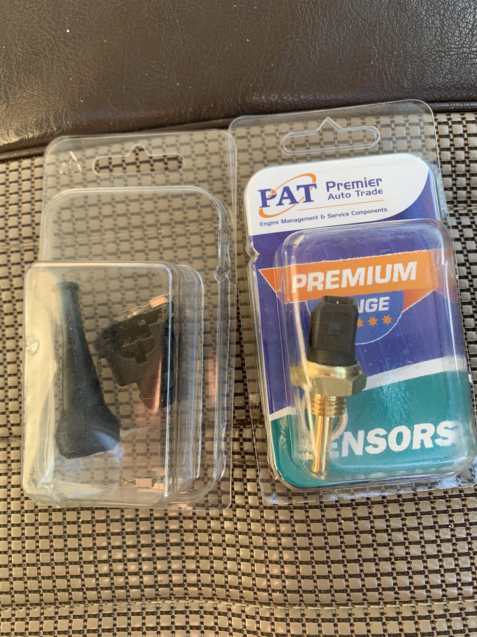

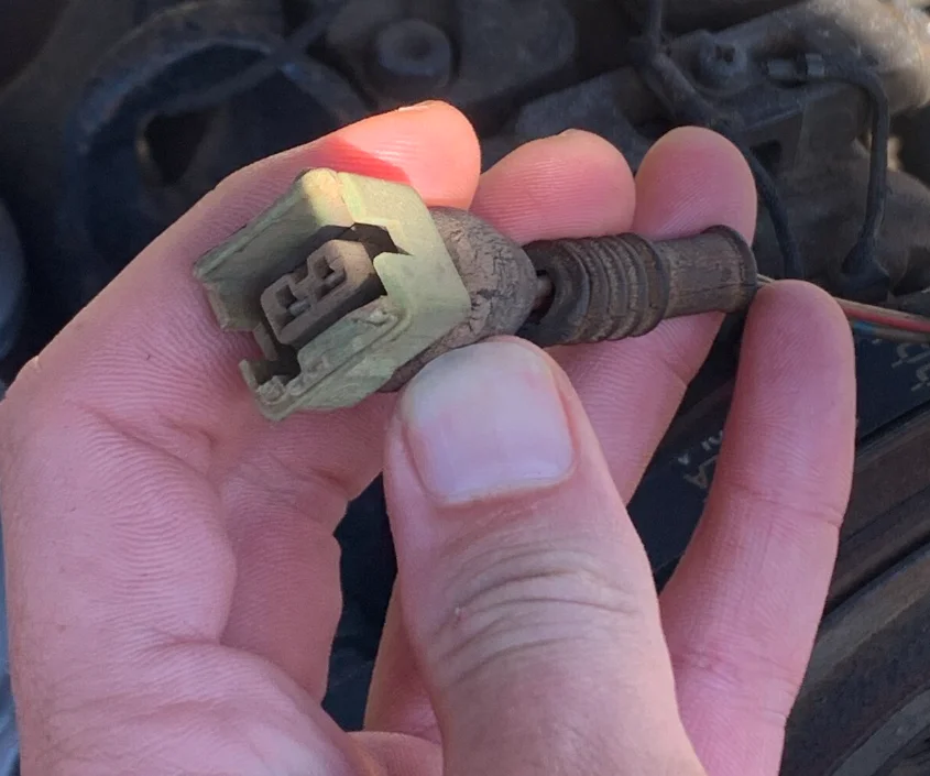

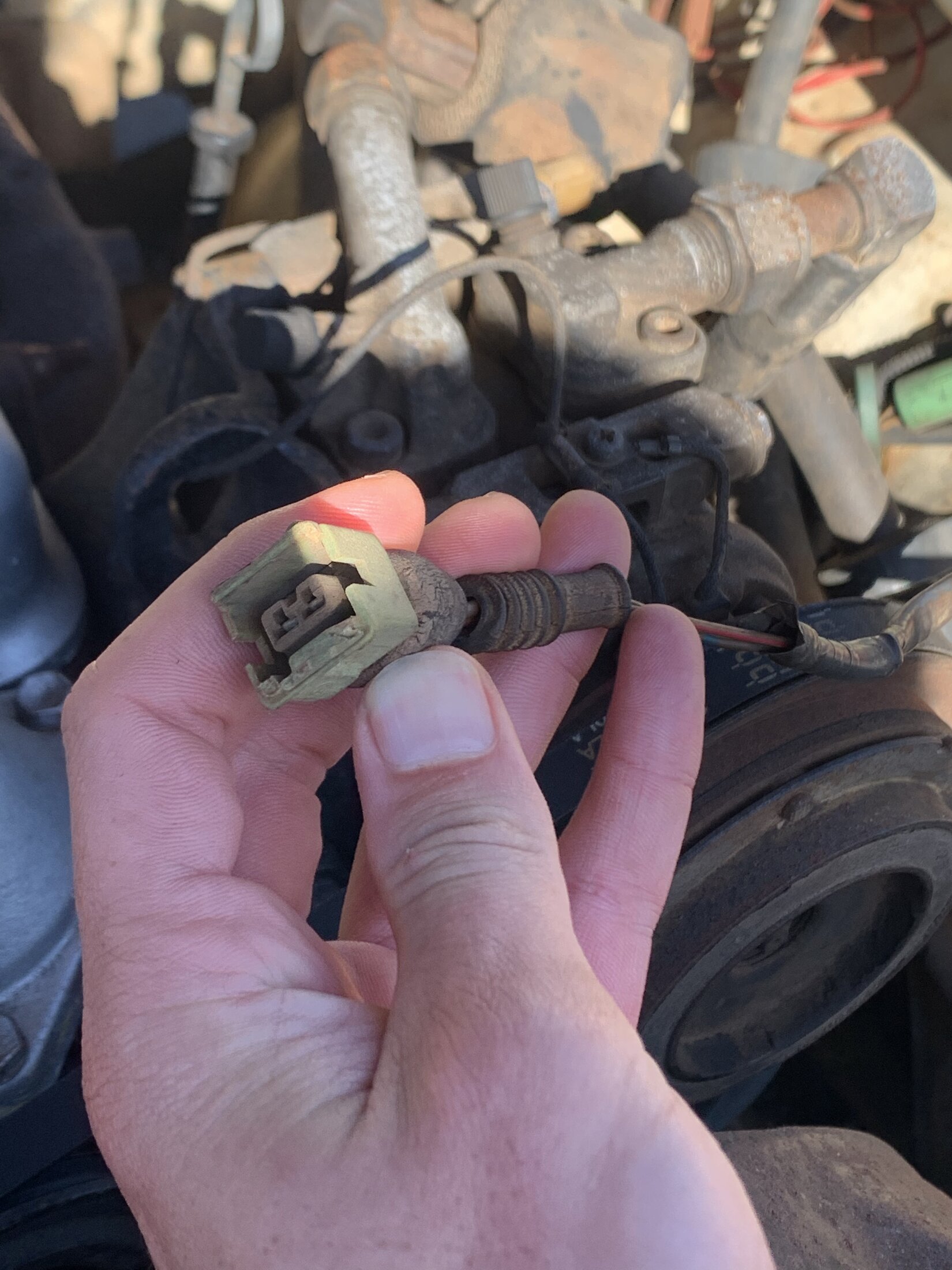

Hey all,
Been searching for some answer on getting my glow system working again.
Car runs great but as the cold mornings start creeping in it’s getting longer and rougher on start up.
After replacing the old corroded fuel relay/preheating timer set up with new boards from reviveyourig.com
I’ve come into the error code;
‘Temp sensor open’ faulty or loose temp sensor.
When I turn the ignition to glow the light comes on and ticks off immediately. Boycotting any glowing.

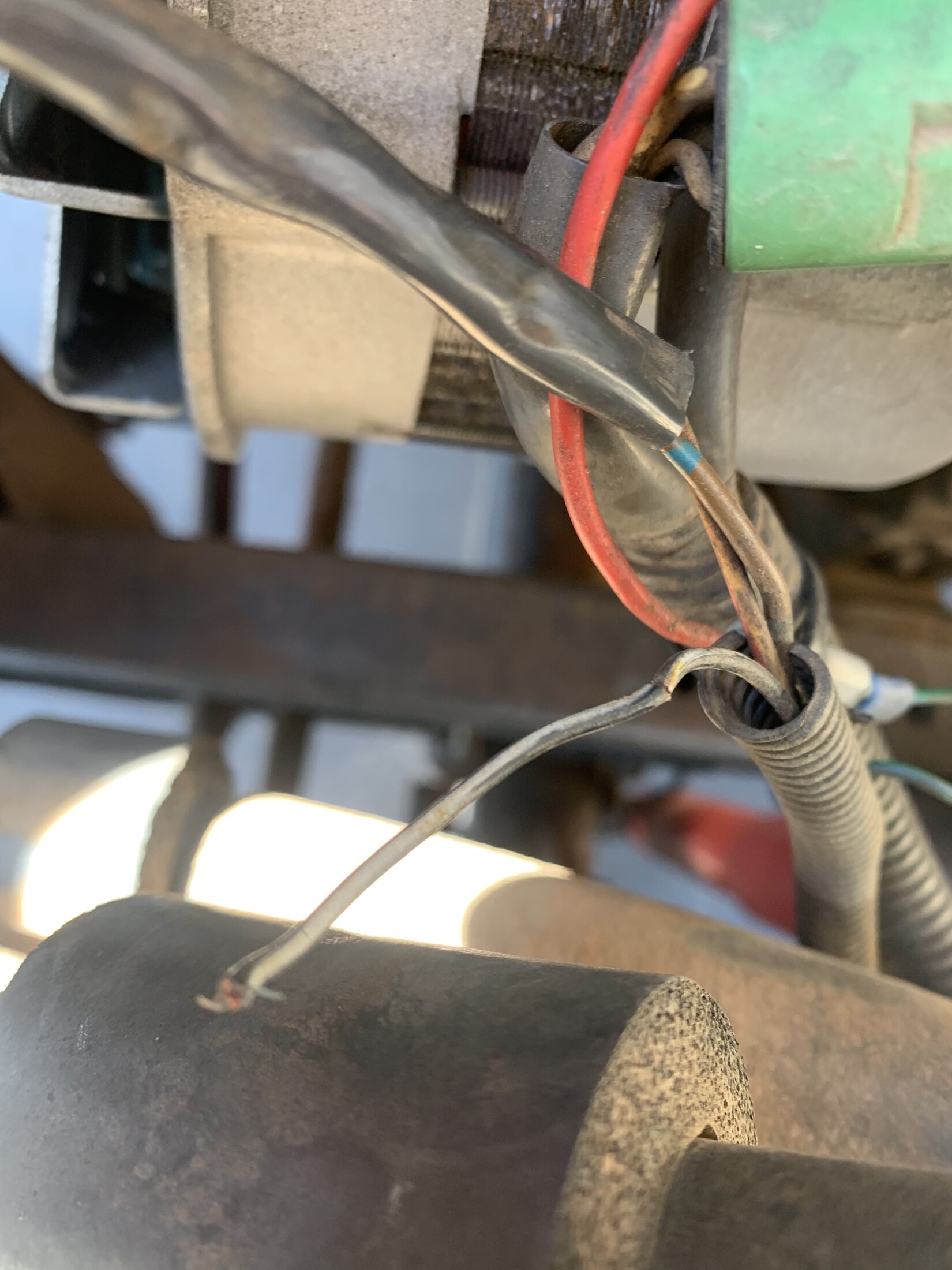

There’s an aftermarket temp sensor installed, I’ve been advised by an auto electrician to to put in a new coolant sensor and to go from there.
Not sure where im supposed to install the new two pin plug. Looks like the wiring has been spliced to install the aftermarket sensor.
Any wisdom is greatly appreciated.
Can supply more pics if needed.
Here is the sensor I was advised to get fitted, ive talked to 4 different mechanics and auto elecs atm and no one’s been able to help me get it installed.. time to diy

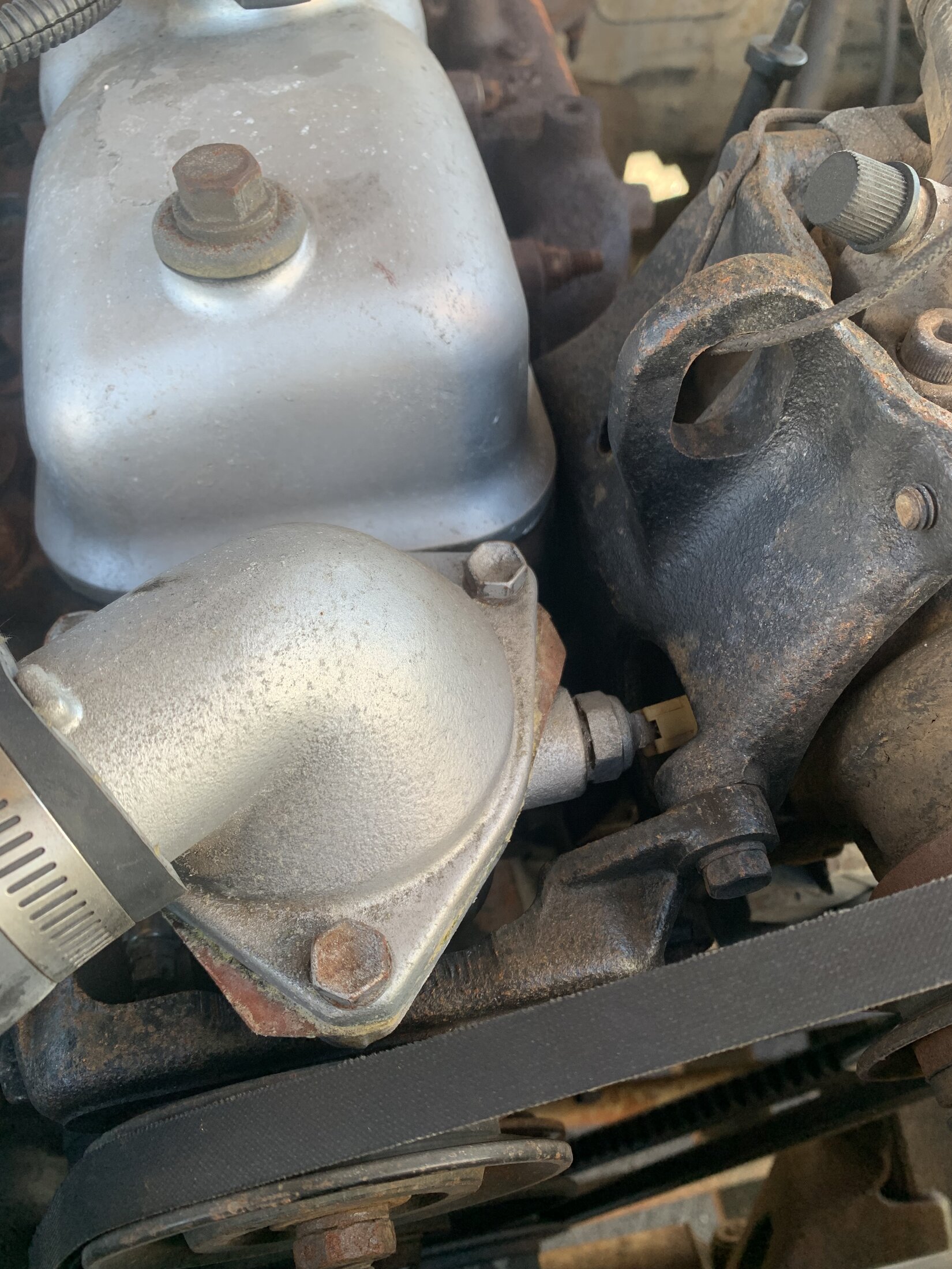

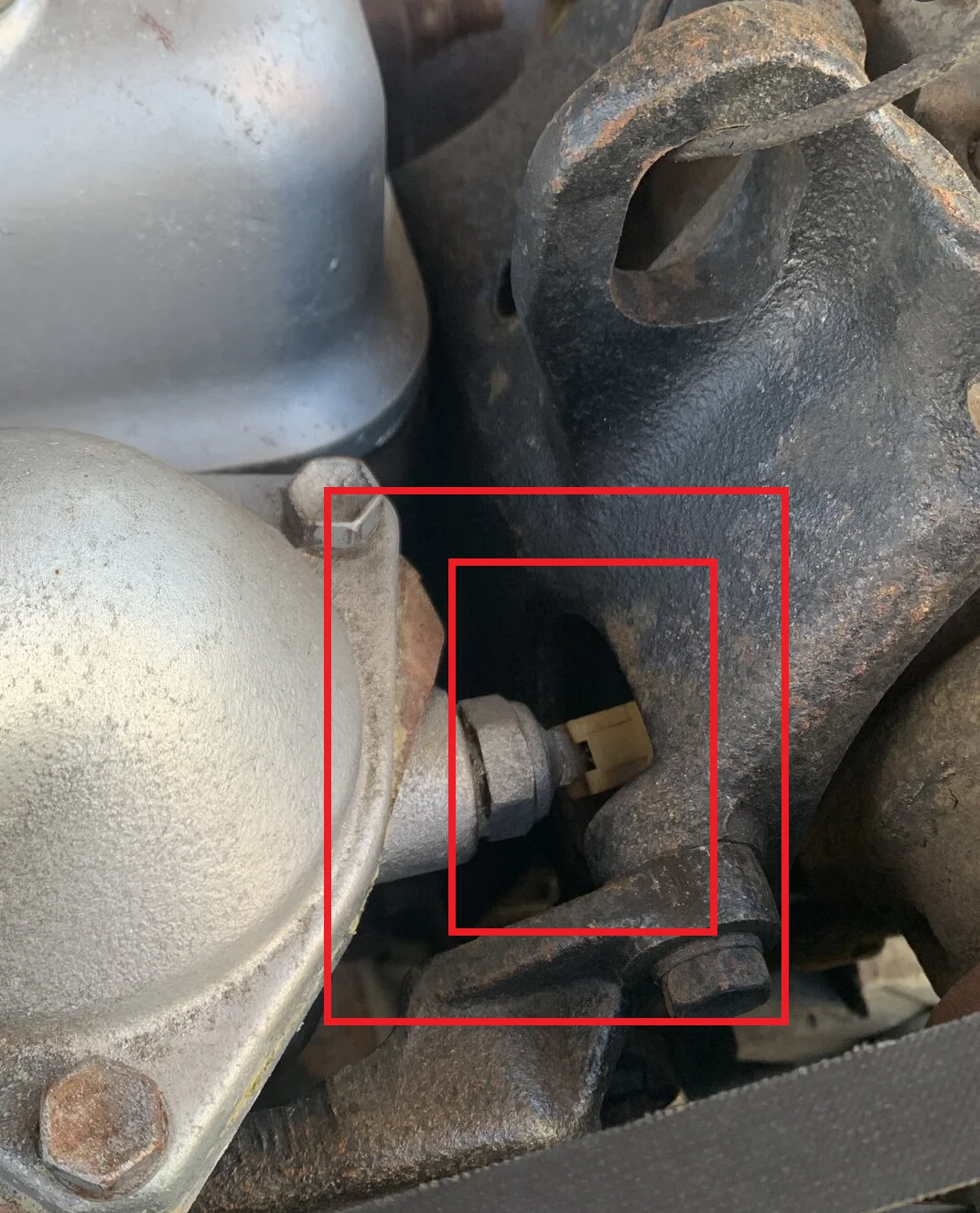

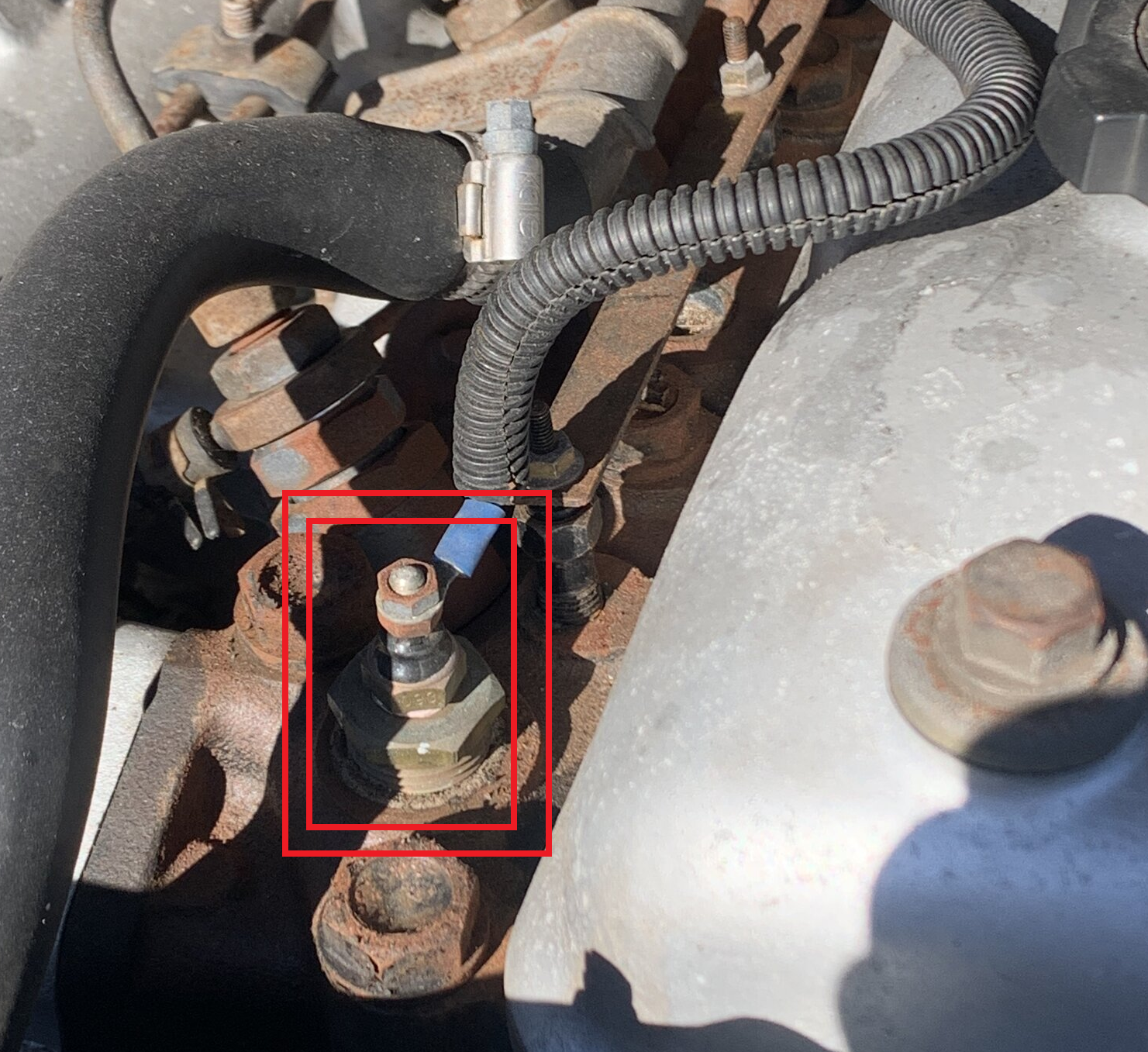

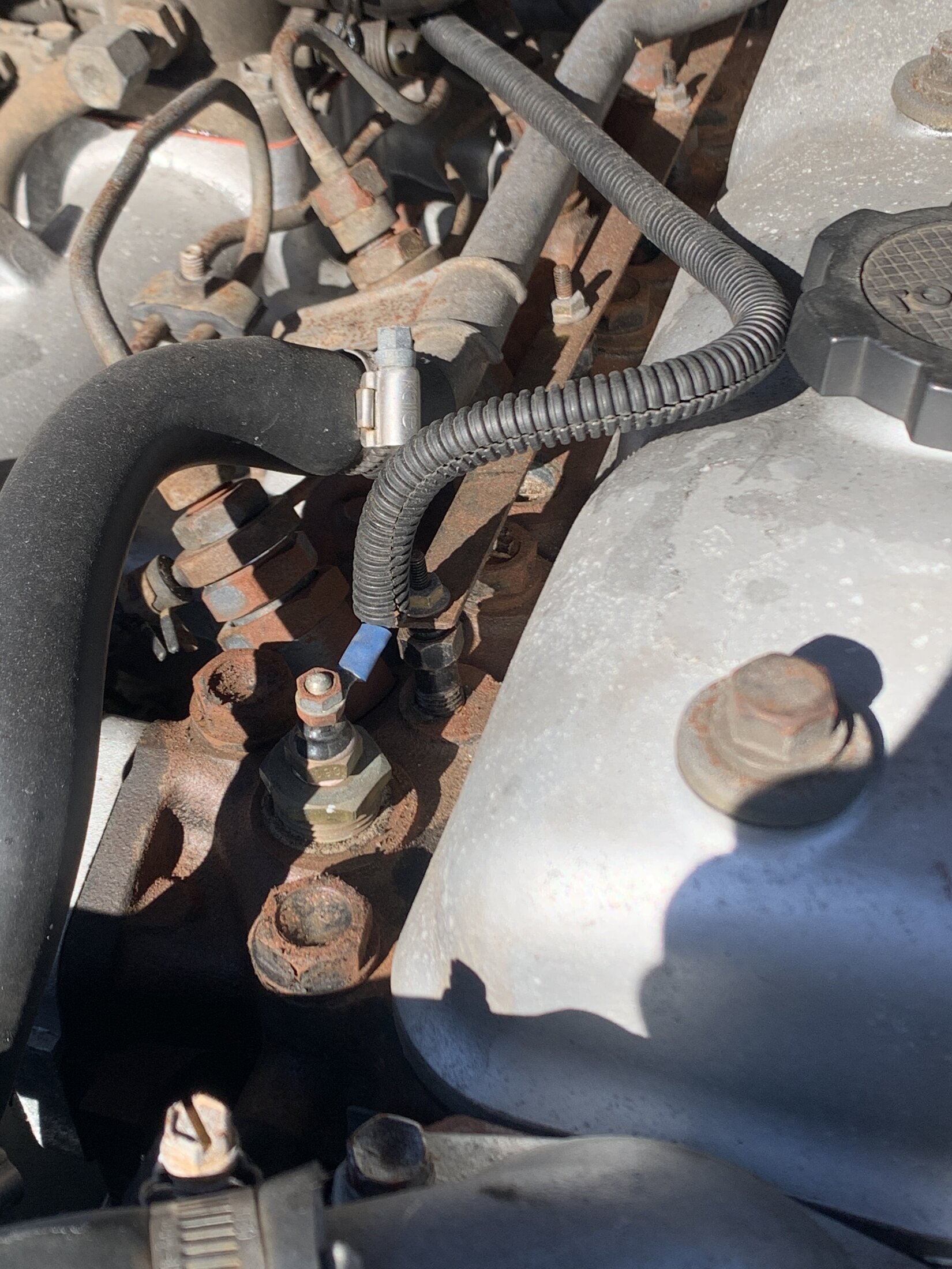

This is where the sensor for the superglow controller is meant to be.. yours has been replaced with something else..

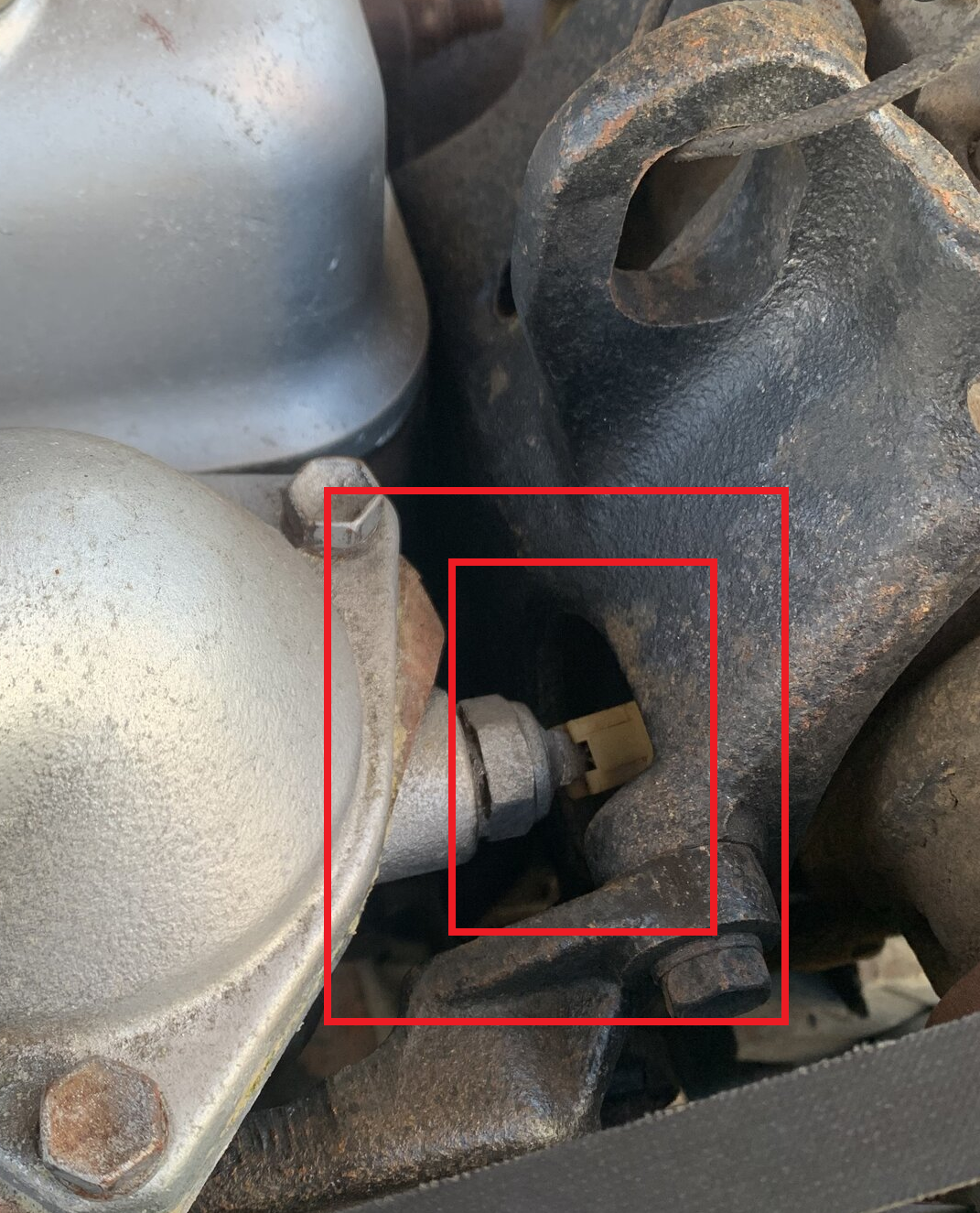

This is the sender for the factory temp gauge..

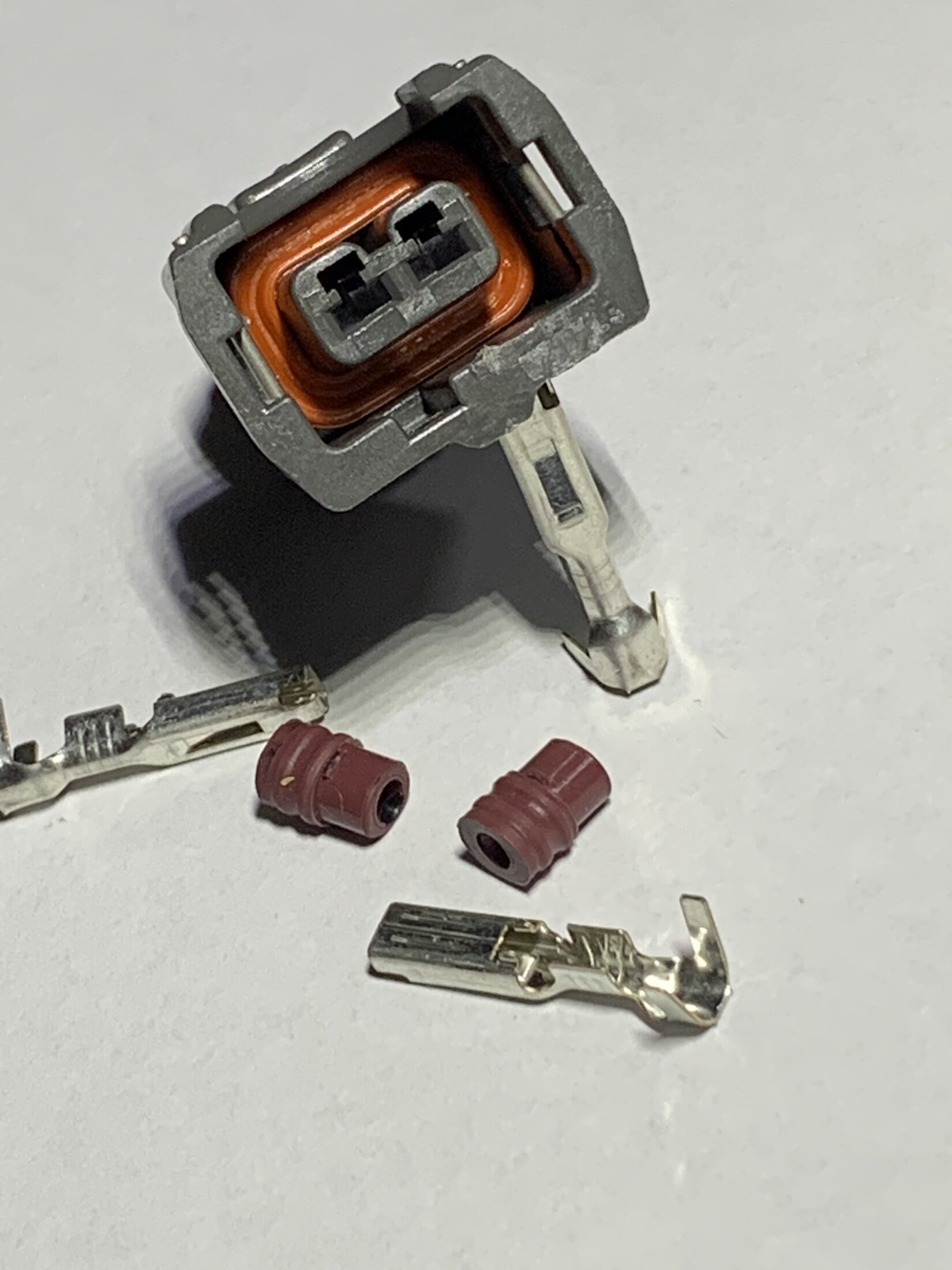

This is the plug for the Superglow Sender..

hi ,
how come removing the aftermarket mystery sensor , then installing a new OEM Toyota sensor that is the correct part needed here , that then will plug into
the original OEM Toyota connector plug your holding in your hand above is not the plan here / has not already been done yet ?
you are a bit more then
Lucky Lucky here about what you can and do hold in your hand above ......
this is usually Not the case in every case i have ever seen where a mystery sensor has been installed in place of a OEM Toyota sensor in a Land Cruiser engine & also there is a related or possibly related Engine running property and normal as is should normally

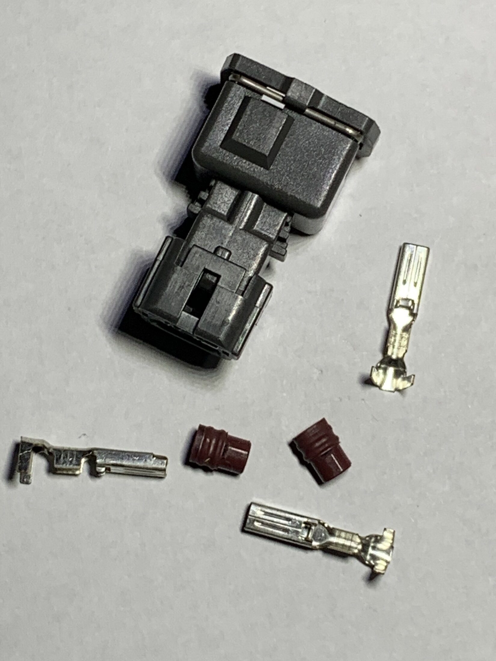

i am not so familiar yet mr clayton to completely understand why the words : SUPER
& GLOW , are all one word ?
however , i am more then a bit more likely sure , that the parts topic in my below pics is the updated last revised oem made in japan spec. part
# , in relationship to the one your holding in your hand above ....
do not use the one on the clear blister pack in the photo above .....fyi
