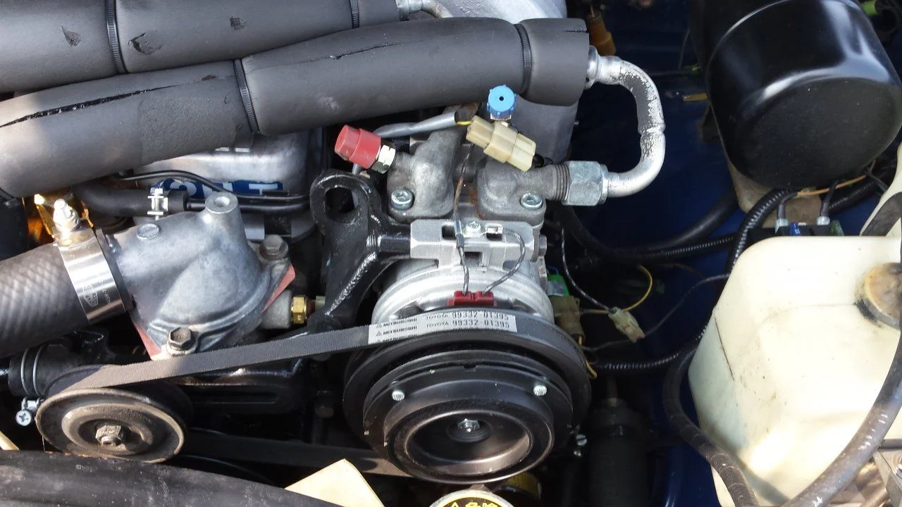

Filled up again in Iowa 20.4 mpg on that tank running a bit higher speed. I checked everything under the hood and noticed some black rubber residue on the ac hose. Apparently all the belts were loose again. odd because I retightened them Thursday night. Looks like maybe powder coating the brackets made it look great but also gave it a nice smooth surface to slip on. I retightened them again and will keep a closer eye on them. Fortunately I have used spares for all three.
I think I may add a tensioner on top of the alternator for the top pinch bolt. I have a couple of spare ones at home I pulled from my last junk yard run.

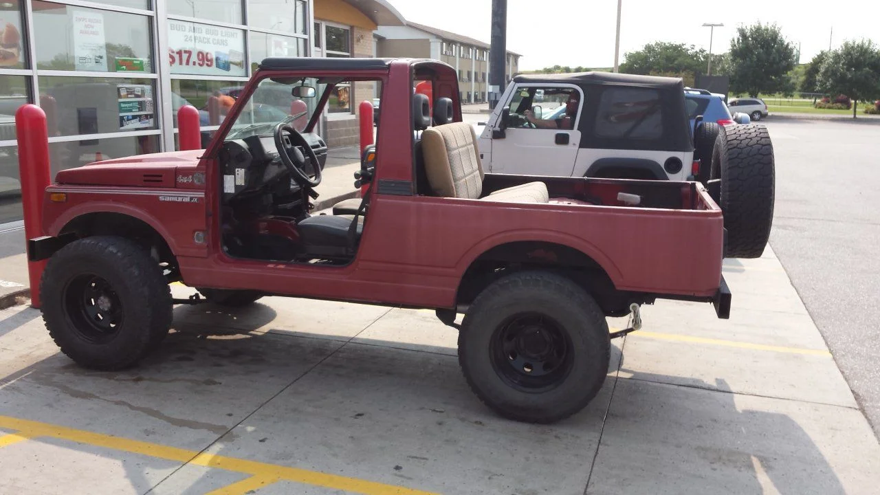

Also saw this cool samurai in Iowa.

That rubber residue on the AC house is the belt material? And it loosened up? Really weird.
Which brackets are powdercoated and what friction does it affect?

Yes the belts wear prematurely if they are loose. I powder coated all of the brackets so unless I'm over looking something obvious that's the only conclusion I can come to.
