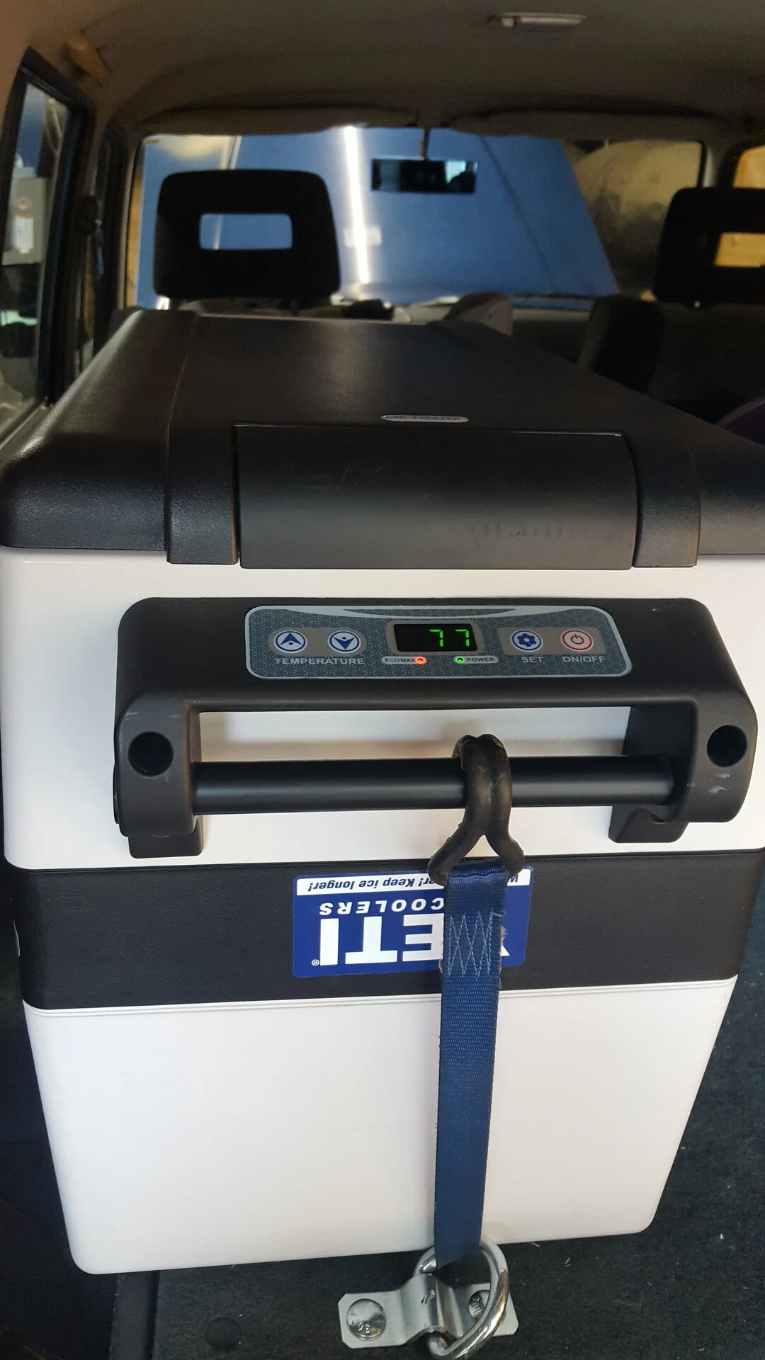

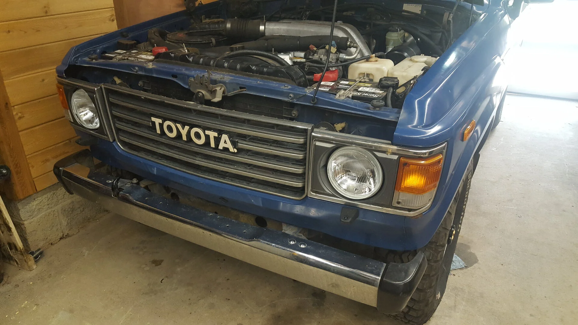

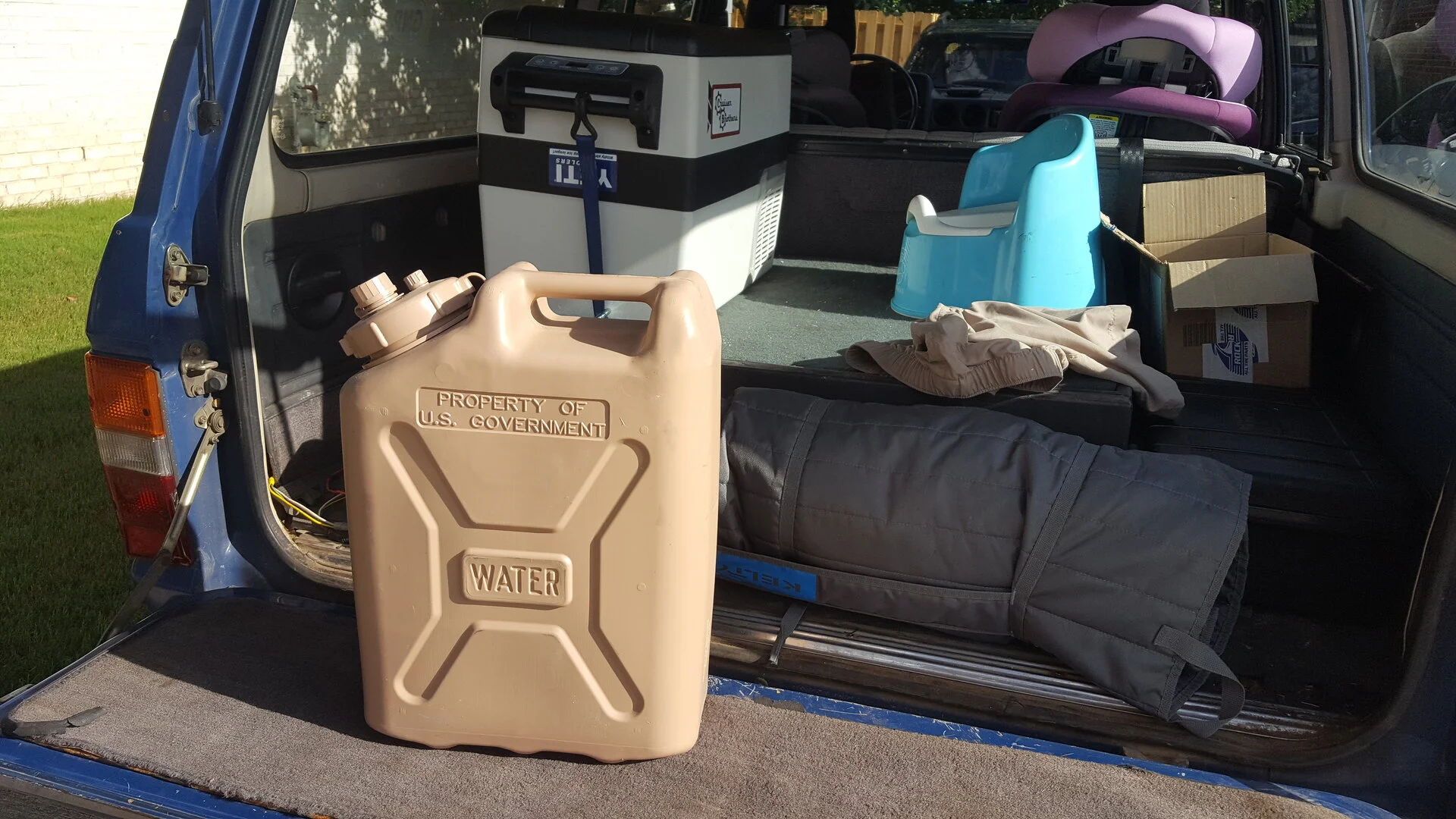

Can't seem to stop prepping this thing for the big trip next week. I threw my drawer in the back and made a mount for the fridge. I had tested it the other day and discovered the fridge would power off when it was strapped down or any downward pressure was placed on it. Took it apart last night and found a loose connection so that should be rectified. I have the socket for the switch powered by a lighted switch on the dash so I have full control of when it's on or off instead of just with the key in the on position. This way I can keep the fridge on if I need to run into a store without leaving the key in the cruiser. The illuminated switch is also quiet bright so chances of leaving it on by accident are low.
I have one of those IndelB fridges as well. I had issues with it powering off on road trips but I think it might have been line loss from front to back. It always works great on 110 power. I need to dig into it more. Love those headlamp conversions. Have done a few.
How is the Gturbo?
I actually have two of these. Bought this one for $100 and liked it so much I got a second to keep in Arizona. I had it power cycle a few times in my 100. I actually ended up removing the little red cap on the end of the outlet plug and that solved the issue. Honestly the turbo feels no different than the one it replaced. I should probably install a gauge to at least see what kind of boost it builds and how quickly it gets there.

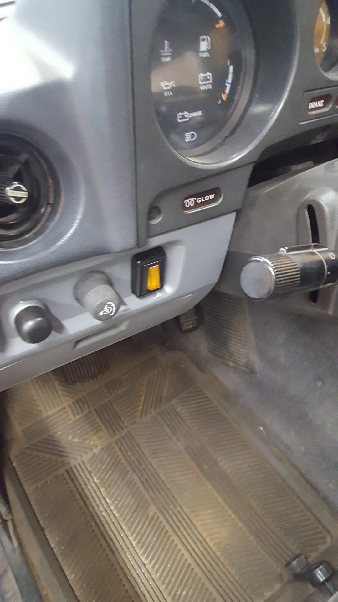

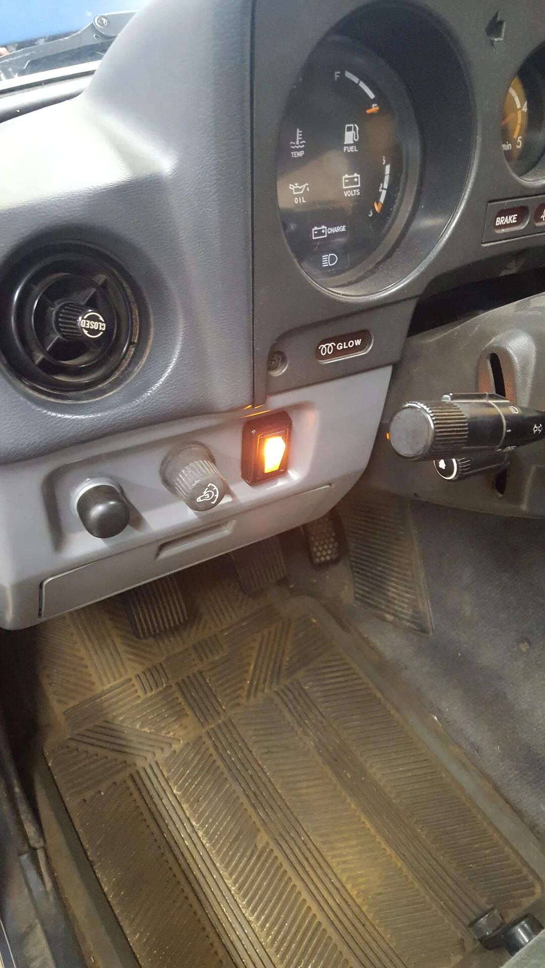

I probably missed it in the thread, but is that little button on the left of the dash for the glow screen? I need to make mine function. I don't have the wiring or relay so probably will just home make it. Curious what you did, or if you use it much. Spring and fall here it it pretty tough getting my 12ht started.
Yeah it’s a 50amp momentary switch. I don’t even have it on a relay it’s a straight connection between battery and screen. (I wouldn’t try it with a low amp rated switch)

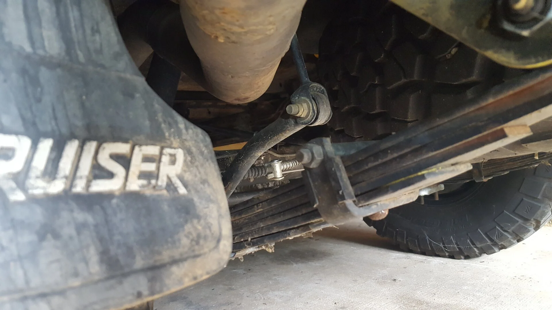

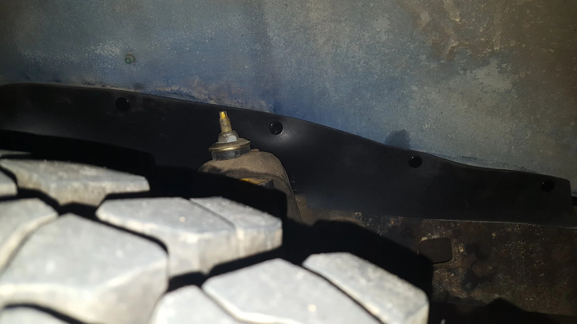

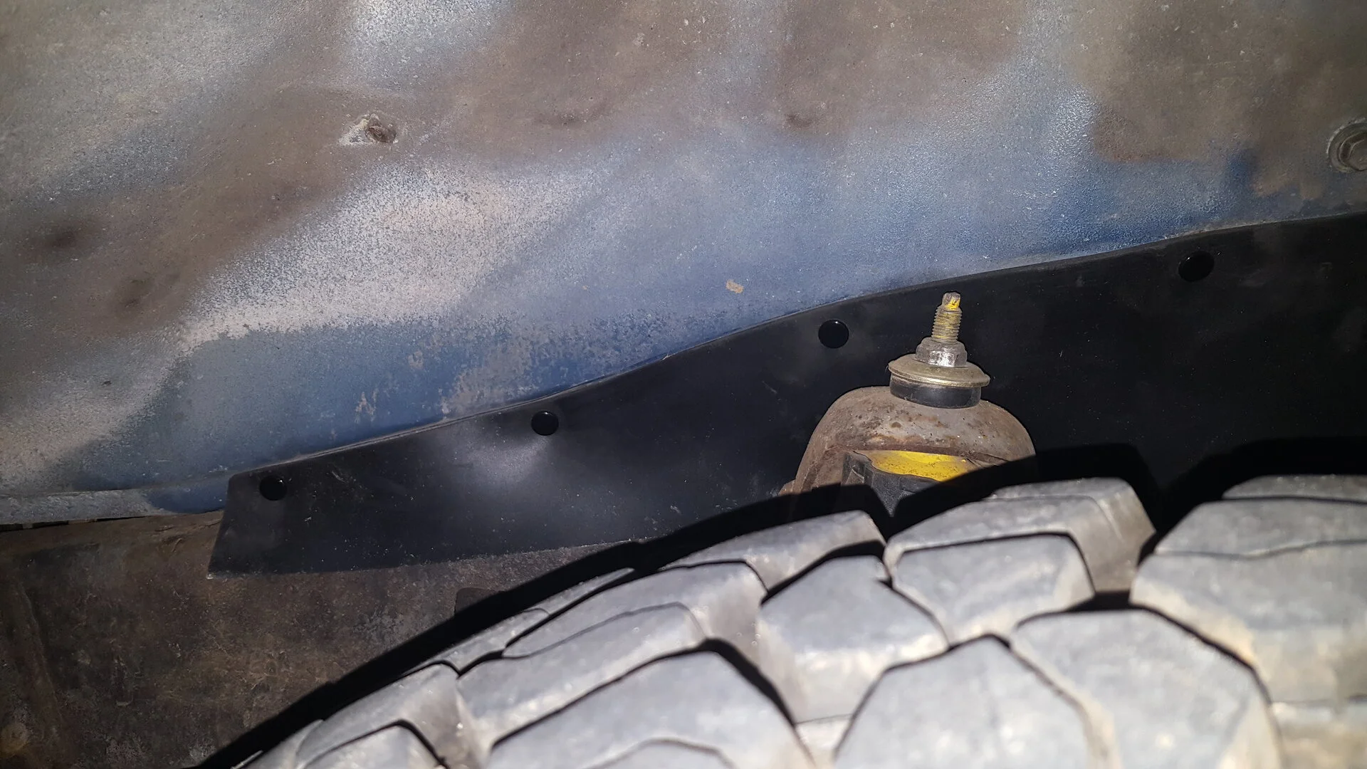

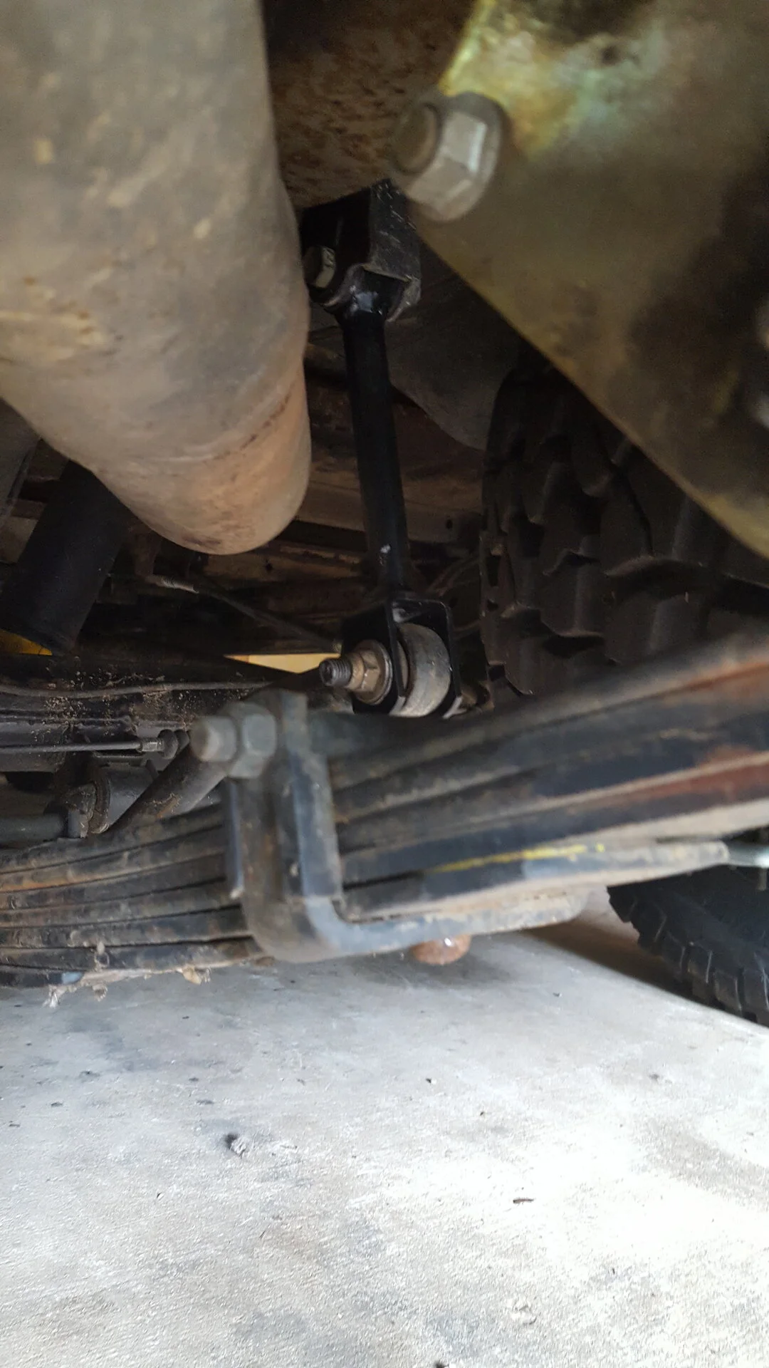

Fun fact about that offset spring plate - @CenTXFJ60 has at least one floating around in his box if I remember correctly.
Now I see why it is offset.
Jimmy informed me the 62 has an offset upper shock mount to help the bushing angle with this plate, interesting info. I don’t think I’ll switch it out but I’ll keep an eye on the bushings for premature wear.

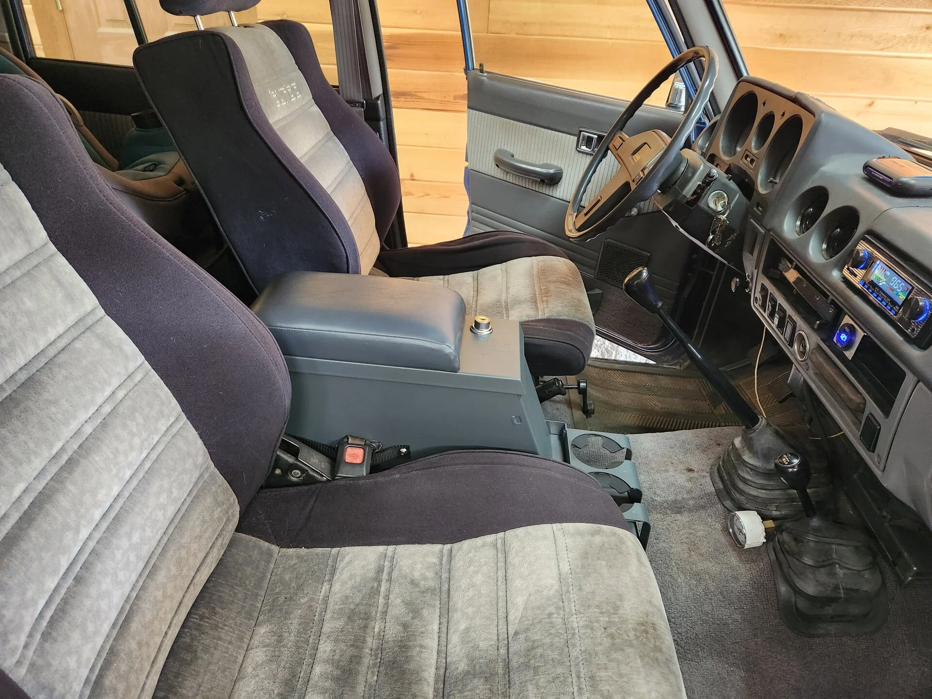

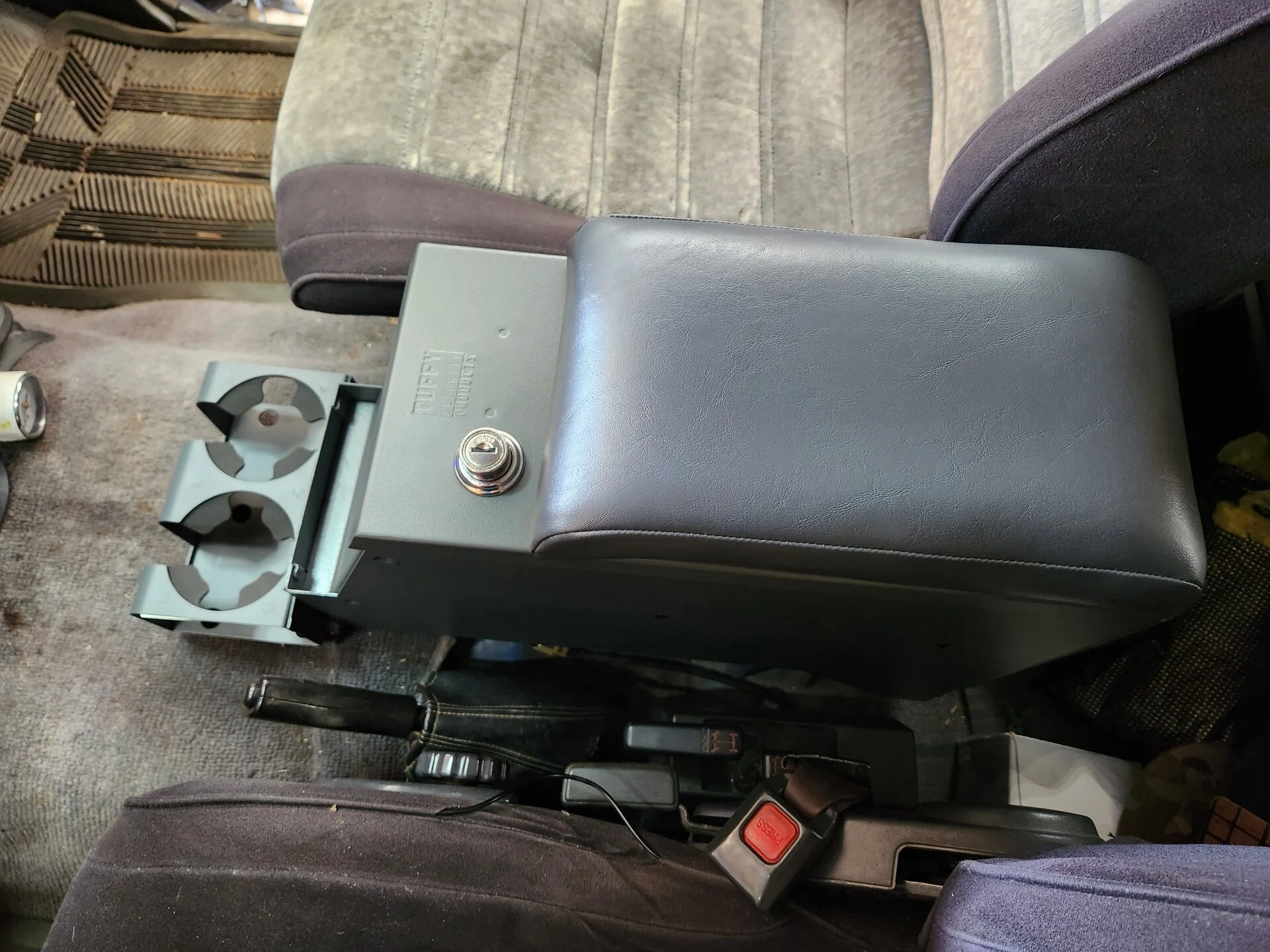

Got a Tuffy console delivered this morning. I got the 6.5" model knowing I would need some extra space for my cable lockers. It fit really well and install was easier than expected.
I utilized the two rear M5 bolts from the 60 and they fit the existing holes in the Tuffy box with a very slight amount of filing of the hole.

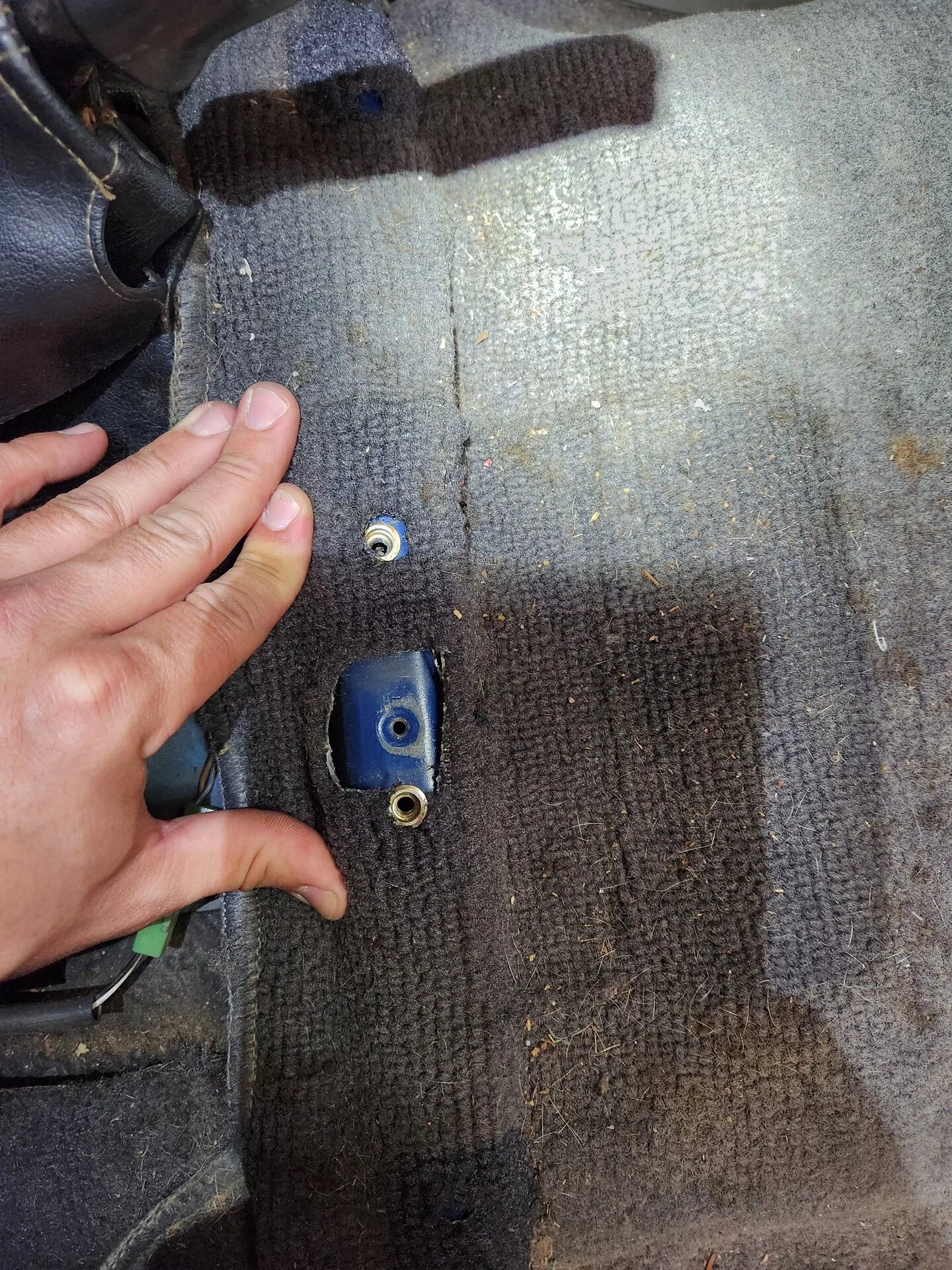

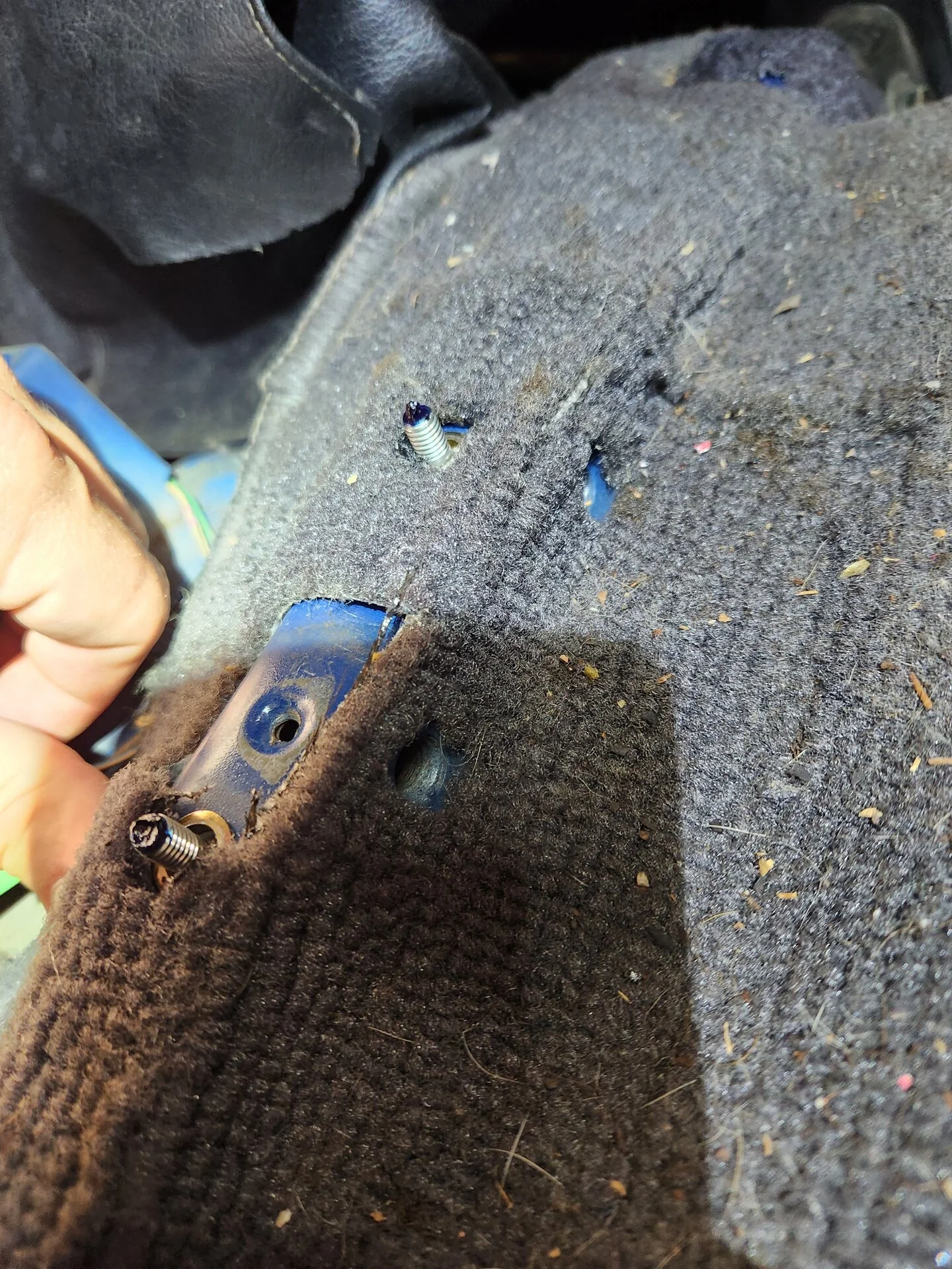

I drilled two holes in the Tuffy to secure it on the front with M6 bolts and some rivnuts I installed.

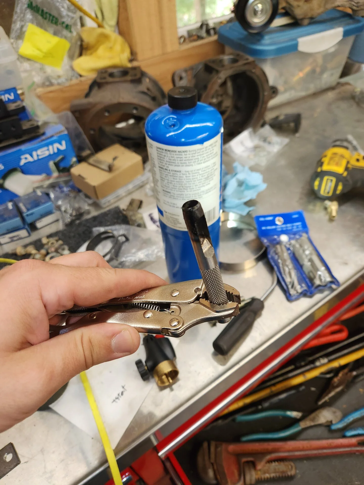

I heated up a punch to open up the carpet for the rivnuts.
I temporarily installed some studs in the rivnuts and coated them with Prussian blue to transfer onto the Tuffy where I needed to drill the holes.
