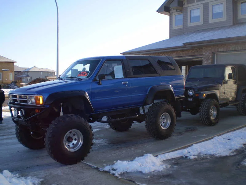

I bought a 1987 4Runner and my head gasket blew on the drive after buying it(which was 4500km) the engine was "rebuilt" 40,000kms ago.
During this drive i realized that my engine isn’t giving the power that i want it to. The truck is lifted by 10 inches with 38inch swampers (35 BFG mud terrains for the drive). I think its a 4 inch body lift with a 6 inch suspension lift.
This is a toy and will only be used for slow speed driving and off roading. I live in the Canadian Arctic with speed limits of 40km/h max and no highways so speed is not my goal at all.
Basically i knew that if this engine was rebuilt because the owner wanted to rebuild it then i shouldn’t see aged parts under the hood. but the aged parts, ie old hoses, rusted master cylinder, etc, where there. my first thought was the head gasket went. i know from past experiences with the 22RE engine that once the head gasket goes it keeps going. This theory seems to be proving its self again.
my question or discussion starter is this. what can I upgrade to with the least amount of work? is there a bigger engine that will fit? my tranny is still great, so can it work on a different engine?
I don’t want to spend the money to get the head gasket fixed when a new or almost new engine will cost only a little more.
next question - gearing and locking axels. I could get a new 22RE for pretty cheap. how expensive is it to customize or change my gearing to make this engine give the results i want, which is all power no speed... like a tractor pretty much. then there’s the axel lock. Any suggestions there?
