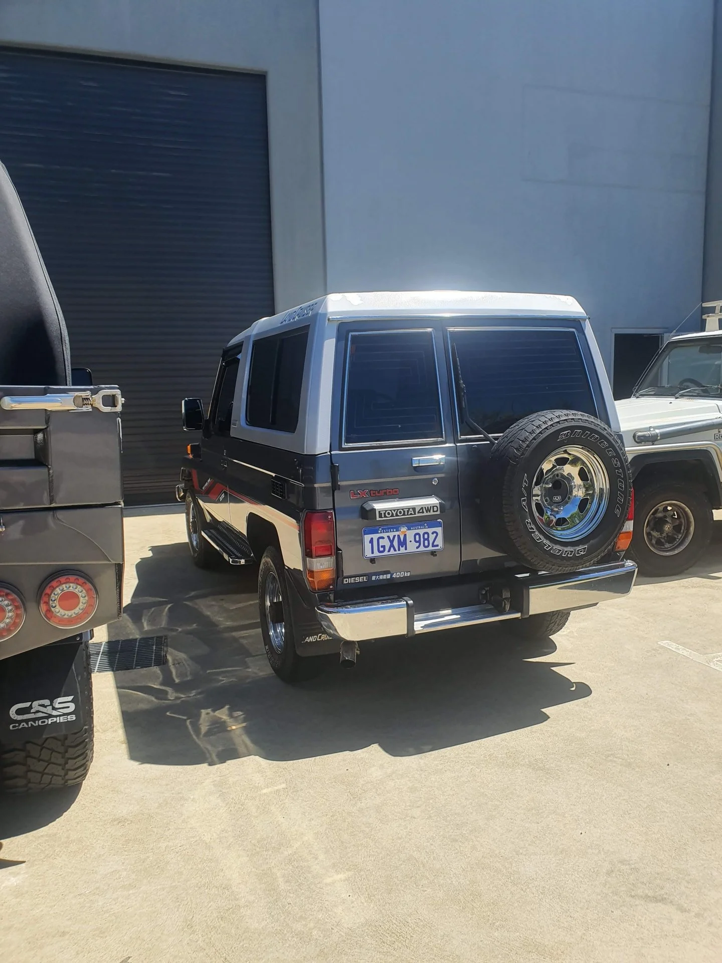

So what exactly did I get? I picked up a Jap import 1986 BJ74. This thing was immaculate, with only 165 000 KM on the odometer it was just past the break in period hahah(from what I hear the 13BT is a beast). It really was in prime condition, what do I mean by that? it still has the factory plastic wrapping on the door panels. I mean they're a bit torn but its a good story to tell. Everything looked amazing inside and most of the exterior as well. With so much good there is always some bad right? Land cruiser = Rust... am I right? The driver door suffers from the red cancer but I could ask for it to me in a better place for repairs to be made so im not to upset.. for now anyways. I was pretty excited to finally have a vehicle running on 24 volts, being a heavy diesel mechanic this was right up my alley. I love how fast it cranks over with so much life!. The PTO winch is cool as I have never seen this used before but I think the cool factor will wear off and I will be left wanting an electric winch for a few reasons but non the less I'm still excited to try it out, maybe I'll change my mind. I'm really not sure how I feel about the FRP top at the moment I think i sit pretty neutral I don't hate it but I dont love it either. After all that is what makes the 74 iconic and recognizable. I have to say I absolutely love the 13BT it has the right amount of power and probably a bit of room to grow with some tuning and upgrades. I drove the early 2000's era Hilux for a few months with the 3.0L diesel and it was and absolute slug even going down hill hahah. I was kind of expecting this from the 13BT but that turbo works a treat and really gives it what it needs to keep up in traffic and is not too bad on the hills/highway as well. The H55F is great, I dont have much to say here. it goes 1-5 and back again with no issues but a 6th gear on the highway would be nice but I'm probably dreaming here.

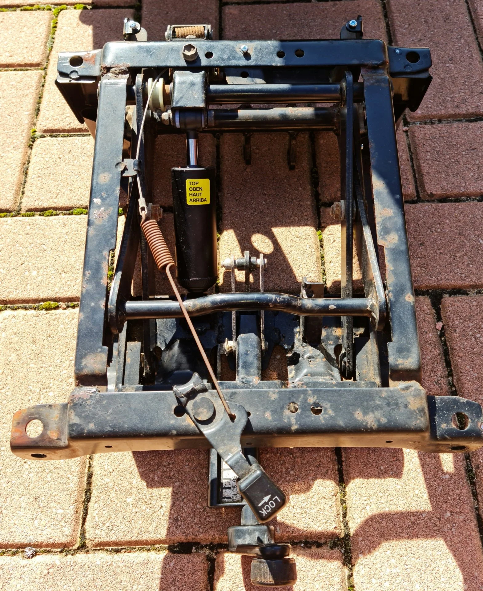

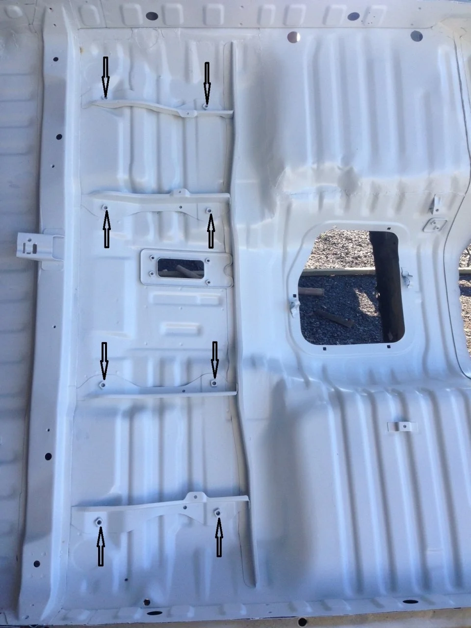

This week's project was tackling the install/set up of suspension seat bases. My model is not originally a suspension seat model but after lots of reading online I found out the nuts for the suspension bases are already installed from factory, this meant all I needed to do was drill holes and cut out the existing seat base mounts.

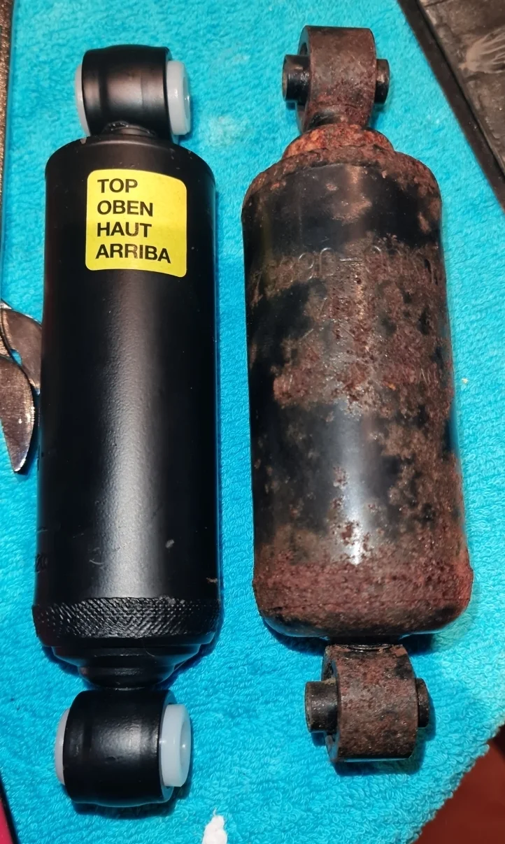

I was lucky enough to find suspension bases at the first auto wreckers I went to so pretty thrilled about that. They did need a bit of work to be operational and up to my standards. They needed new gas shocks so I hit up a local seat repair shop for road trains and they had almost a perfect match. Monroe makes a shock that's about 10mm longer which was no big deal it allowed full travel up and down with no issues. I also needed to find new springs. I didn't have any luck sourcing OEM springs so I went to a local manufacturer and they are now in the process of being built. This wasn't a huge cost but I'd definitely use it as a last resort if your not in a hurry. While I wait for those I'm just picking away at stripping the paint off.
As for the seats I picked up a set of 60 series sahara seats. They'll need a bit of fixing and recovering but I like that they are from the same era and will kind of keep that factor look to the vehicle.
Here's a few snaps of the bases and where the nuts are on the bottom side of the vehicle.
I'll post part numbers for the shocks in the next post when the install is complete.
