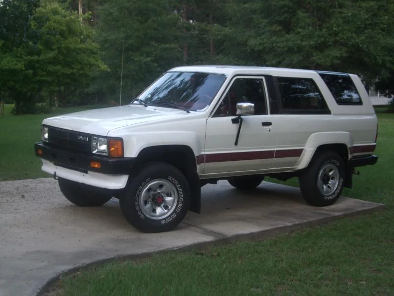

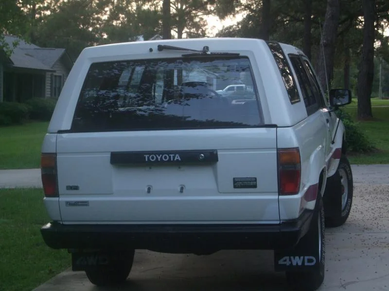

1985 HJ75 Pickup
This is where the HJ75 turbo money went.......
I know it is not as "cool" as a Cruiser but at least it is a Toyota.:D
i like them old 4plays, nice find.
They seem to hold their new looks well. There is a few around my area with their 80s paint schemes and they look like they just left the factory
Not everything Toyota did in the '80's was good. They installed "faux leather" interiors in many of their trucks ( They really seemed to like RED....red seats, red carpet, red dashes, red door panels....well you get the idea.) RED is not a color that holds up well in years of sunlight ( has a tendency to fade to pink ):)
It must have been an American thing,all the Toyotas of those years here have brown or blue interiors. My ex had a 4runner,85 model and it was blue and seemed to handle its age quite well. Admittedly she was very fussy and had dark tint all round
As long as you wear good quality sun glasses ( or a welders mask ) the red interior is really not that noticeable. :D
