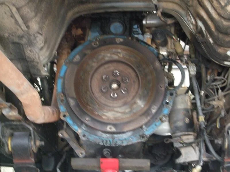

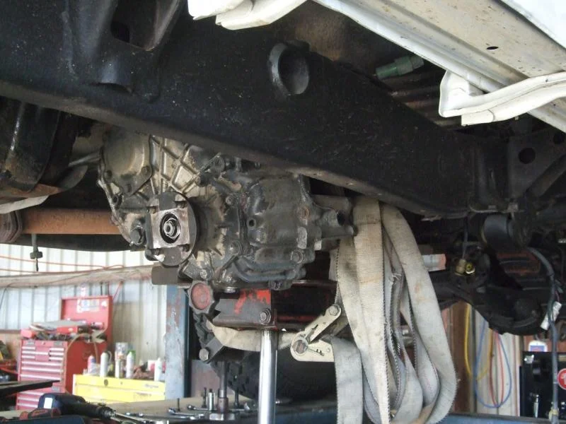

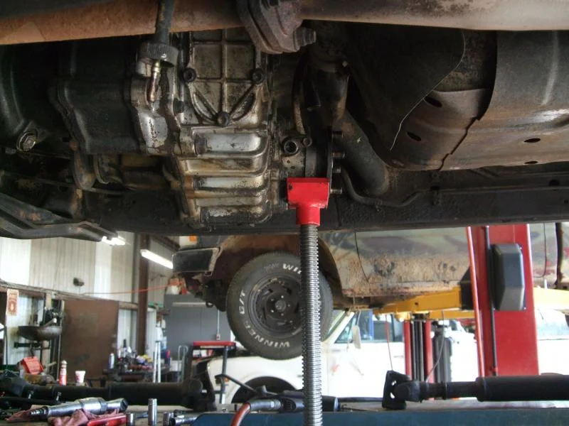

Parts coming off and transmission coming out.:)

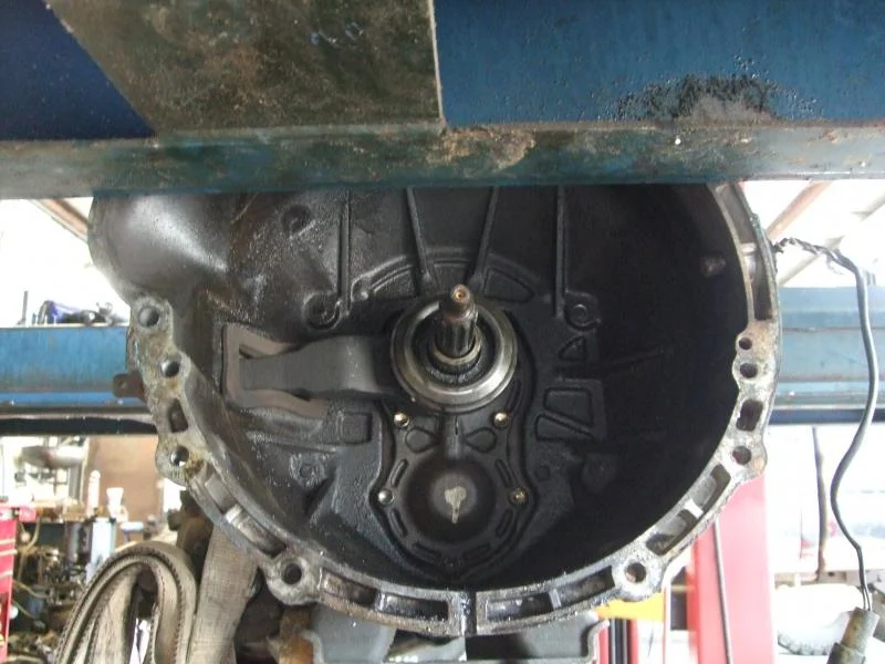

As it turns out the problem was not with the throw out bearing but was an issue with the improper installation of the pilot bearing. ( I will go into details however there was evidence of silicone which speaks volumes of the quality of the previous clutch work.:bang:)
Top photos is of the missing pilot bearing and resulting damage.
Middle photo is of the "properly" installed pilot bearing and corrected damage.
Bottom photo....old throw out bearing....replaced with a new one
Although it is not visible in the top photo there was significant damage to the shaft as a result of the improperly installed pilot bearing which was fortunately corrected by a very talented machinist.

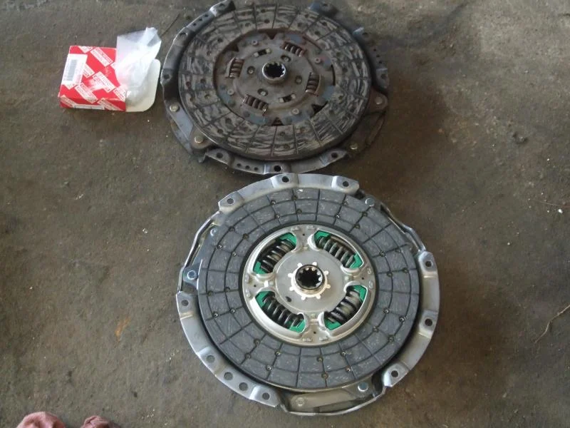

The old clutch was actually in fairly good shape but was replaced anyway.

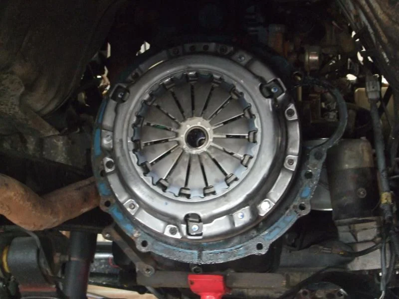

you are going to get that flywheel turned properly ... right?
Yes but I will not be there to photograph the finished result. The machine shop will be finished with it early tomorrow.
In the above photo the clutch is just setting there to verify proper fit.

Don't let that Southern drawl fool you.:D... Those guys are sharp. I am fairly sure the strap they used to secure the gearbox to the jack was securing a deer stand to a tree just a few months earlier.:)
