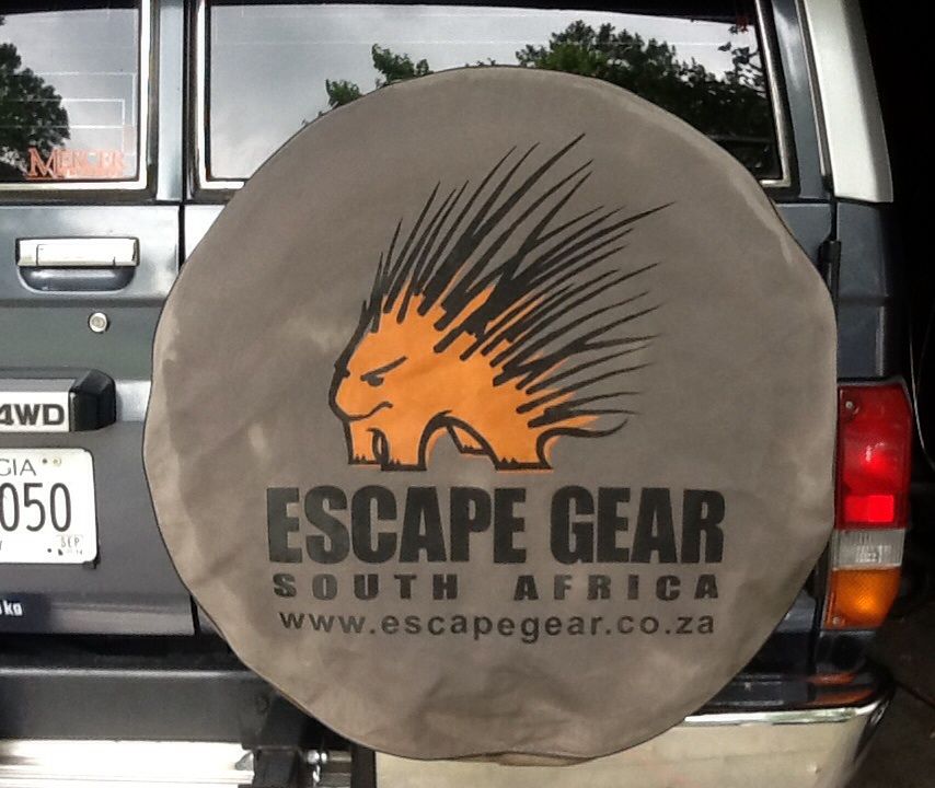

The tire cover lives again. ( slightly wet due to a rain shower ). :)
