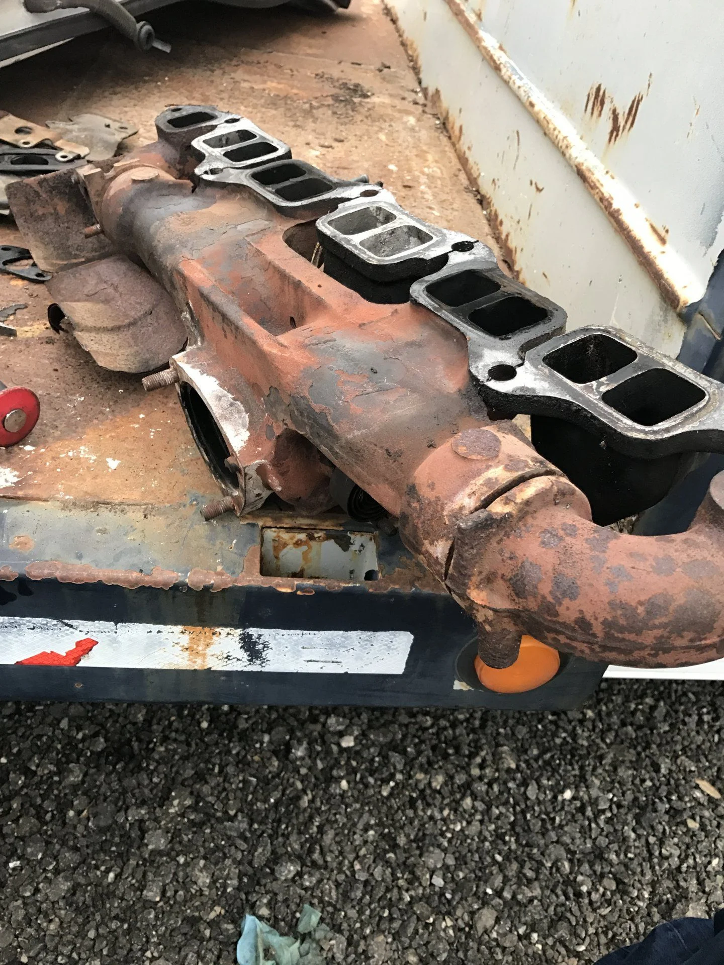

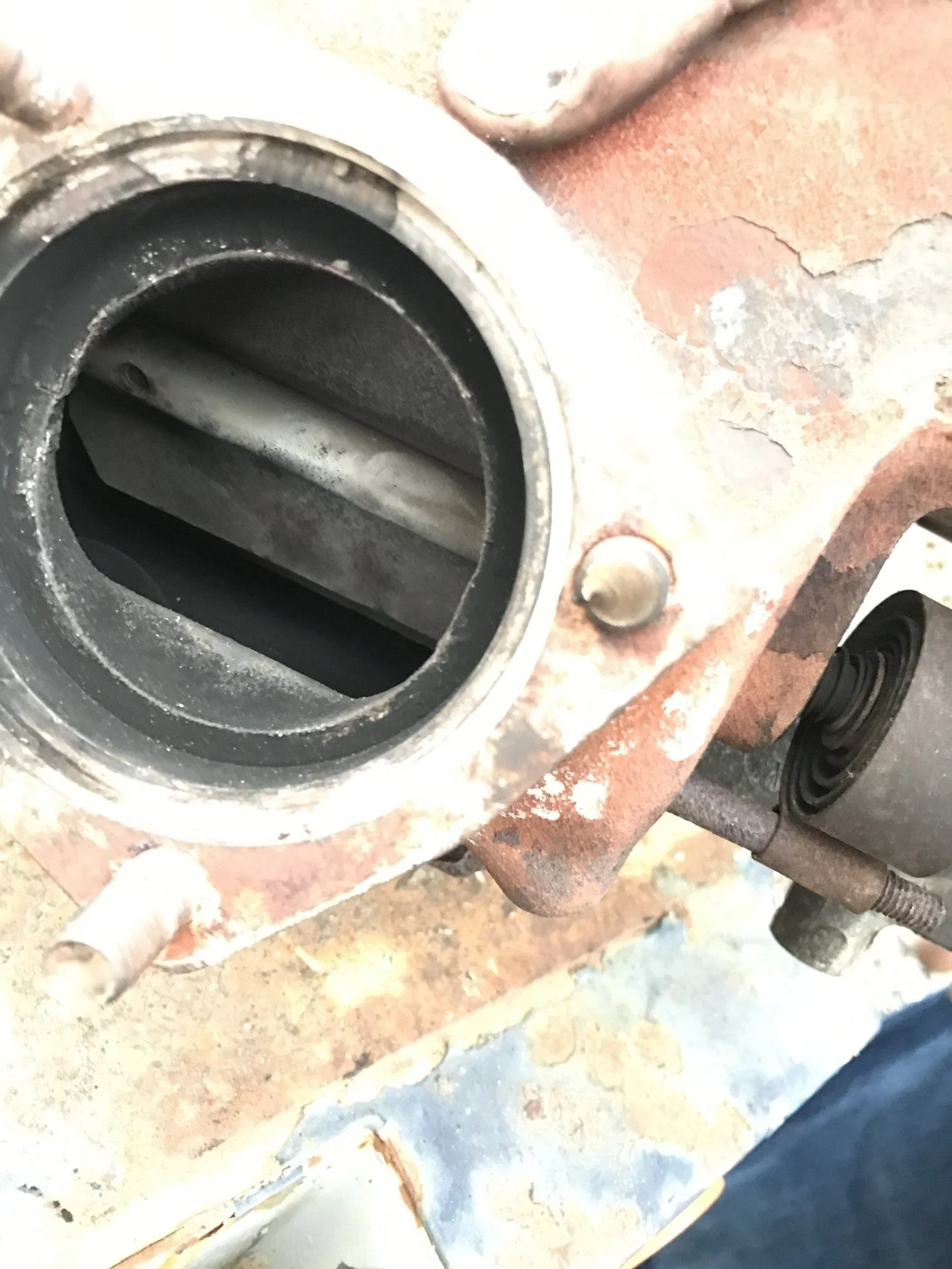

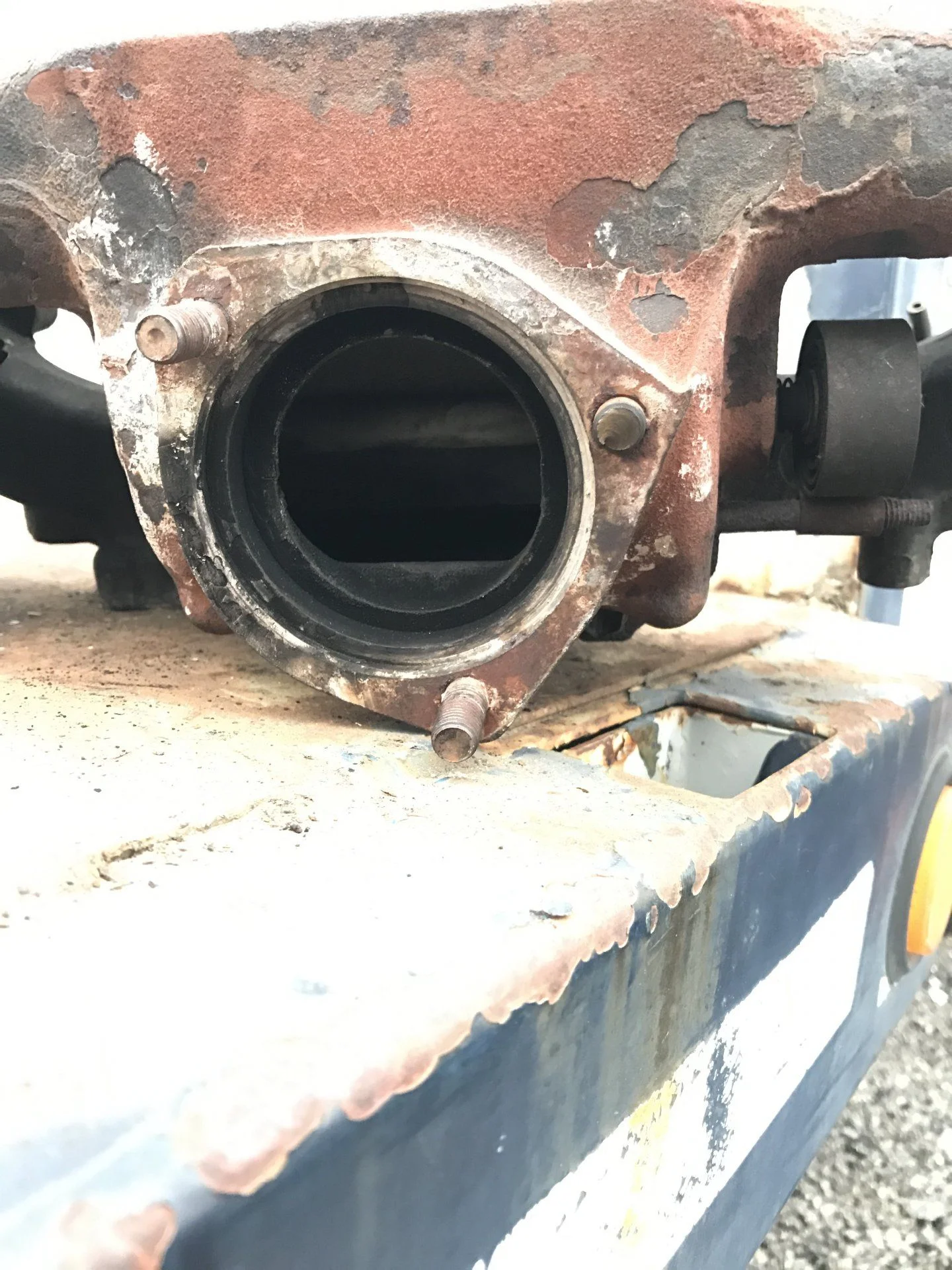

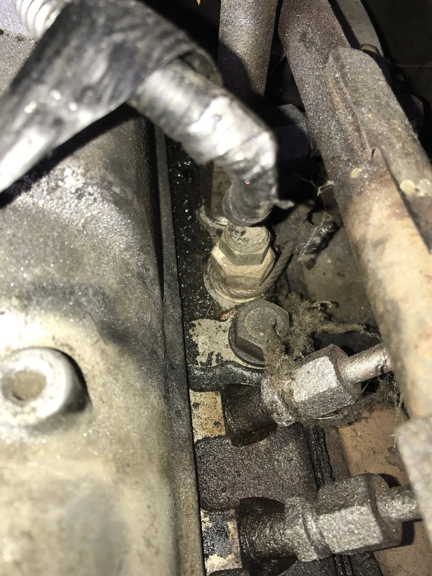

on deacceleration. I had parked on my property and it sat ever since. I started working on it October of 2016. Did all new fluids and serviced it new fuel lines and actually had bought a new tank for it years back that I finally installed as well. Did Spark plugs, carb etc. Took it to a mechanic to get the timing done and to put on new vacuum lines and emission modularator. He bought a new distributor cap and New rotor for the distributor. But I feel like he didnt know what the real issue was on the back fire. I took back home after he told it was the timing gears. Then when I went to pick it up he told me oh ya it's the exhaust manifold And taken it off! But he showed me there was a cable holding part of it on that's been there for quite some time from some one previously breaking a bolt off in the side of the block closest to the firewall. :bang: Then another two one on where the exhaust meets manifold and one where the egr cooler hooks up to on manifold.
I still doubted him and had taken it home on a tow truck. But now left with what what he did, should I re use this manifold and fix the ones on it or buy a new one and just figure out how to tap that bolt out.

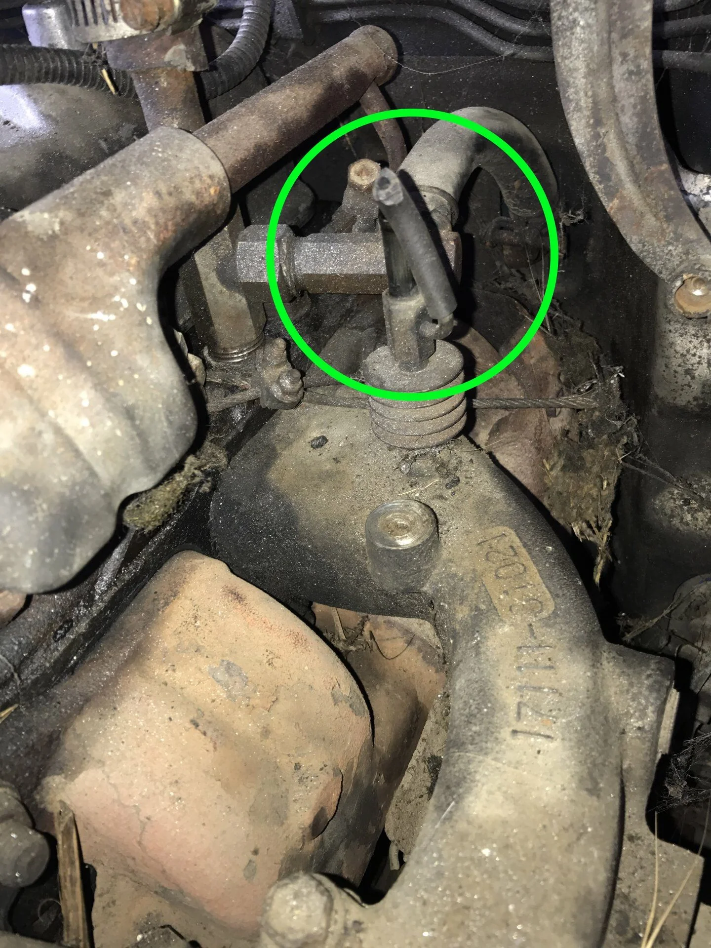

What's going on with the brake booster vacuum fitting? Is that thing entire thing plugged? Do you have power brakes? Cant tell by the picture.
There's no way a a cable tie can hold the manifold securely enough to ensure a leak free mating to the head.
The vacuum line Looks melted off yet to be replaced. The hose behind it is just disconnected from it though. I don't have power brakes that I'm aware of. Unless you are referring to hydraulics then yes. As far as the manifold do you think that cable wasn't even holding it on right causing this to leak and back fire or even the egr cooler with a broken stud on the manifold? I need to figure out how to get that bolt out of the head as well. I appreciate the responses! I'll work on taking these studs out and replacing them.
Clearly the manifolds were not sealed against the head. Fix that first!
The broken off manifold studs are no big deal, happens all the time. Take manifolds to competent machine shop to be cleaned, burn out & replace studs, mill straight & spotface.
The broken off bolt in the head is because the manifolds were leaking and the bolt(s) were overtorked in an attempt to get them to seal. The broken off bolt is probably not terribly stuck. Soak w/ penetrant, tap backwards w/ sharp punch, slot end w/ cutoff wheel & turn w/ impact screwdriver, etc.
Thanks for the replies! I'll take the manifold over to a shop to get it done and resurfaced. Now as far as it being overtorqued in attempt to seal it would that be because the manifold could be warped and they tried to just crank not down? Or just a incompetent mechanic not seating it right?
Probably due to the manifold being warped slightly. When Jim says take it to a competent shop he means it. There is a very certain way that these manifolds need to be machined to ensure a flat mounting surface due to the fact that the "ears" move/rotate. I was told my manifold shop was competent (by the shop that did my head) yet the did not end up remedying my issue. I believe the @FJ40Jim did a write-up on how the manifold should be done. One of these days I am going to have to get mine redone.
There is folklore occasionally promulgated on this forum (sadly) that to get the manifolds to seal, even when the ears are different thicknesses, it's only a matter of torking down the bolts hard enough.
The bolt breaks off in the head or sometimes pulls the threads outta the head before the manifold magically gets sealed, because physics.
