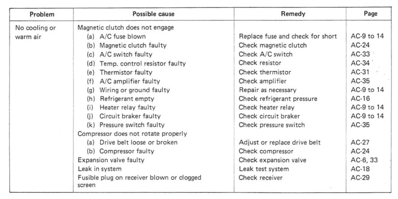

Coincidence, or not, but after the original trip where the first temperature spike occurred, the air conditioner stopped working. Blue light comes on, heater and blower still work, but compressor does not kick on with button press. When I researched this there was discussion about manifold pressure, and I was unsure if that is the same manifold pressure that the air pump maintains.

Regarding the AC system, the "manifold" is a manifold gauge which is used to check the hi-side and low-side pressures of the refrigerant. This is not related at all to the Air Injection system. There is a pressure switch that prevents the compressor clutch from engaging is the pressure is too low (too little refrigerant). Based on your explanation of what works and what doesn't, it could be low refrigerant, bad pressure switch, bad thermistor, compressor clutch not working or engine idle is too low. For the last one there is the AC amplifier under the dash that has a blue knob to adjust the cut off RPM. Or your AC idle up for the carburetor may not be working.
