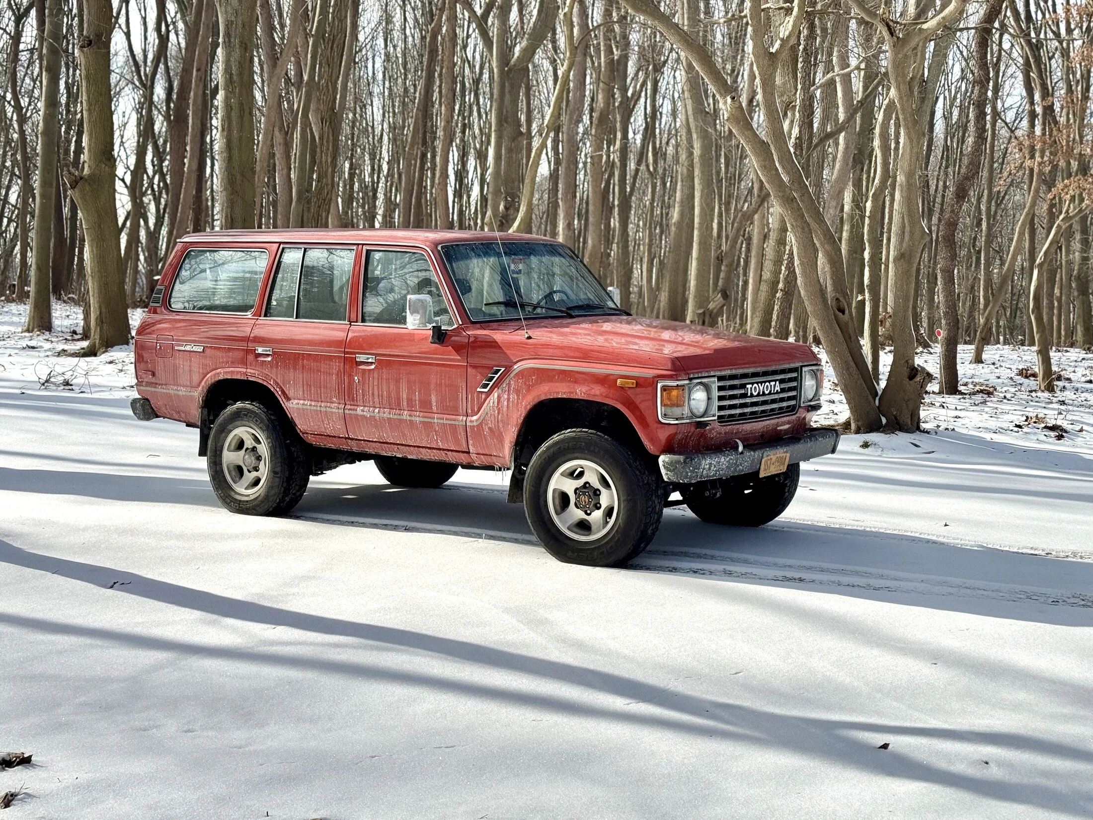

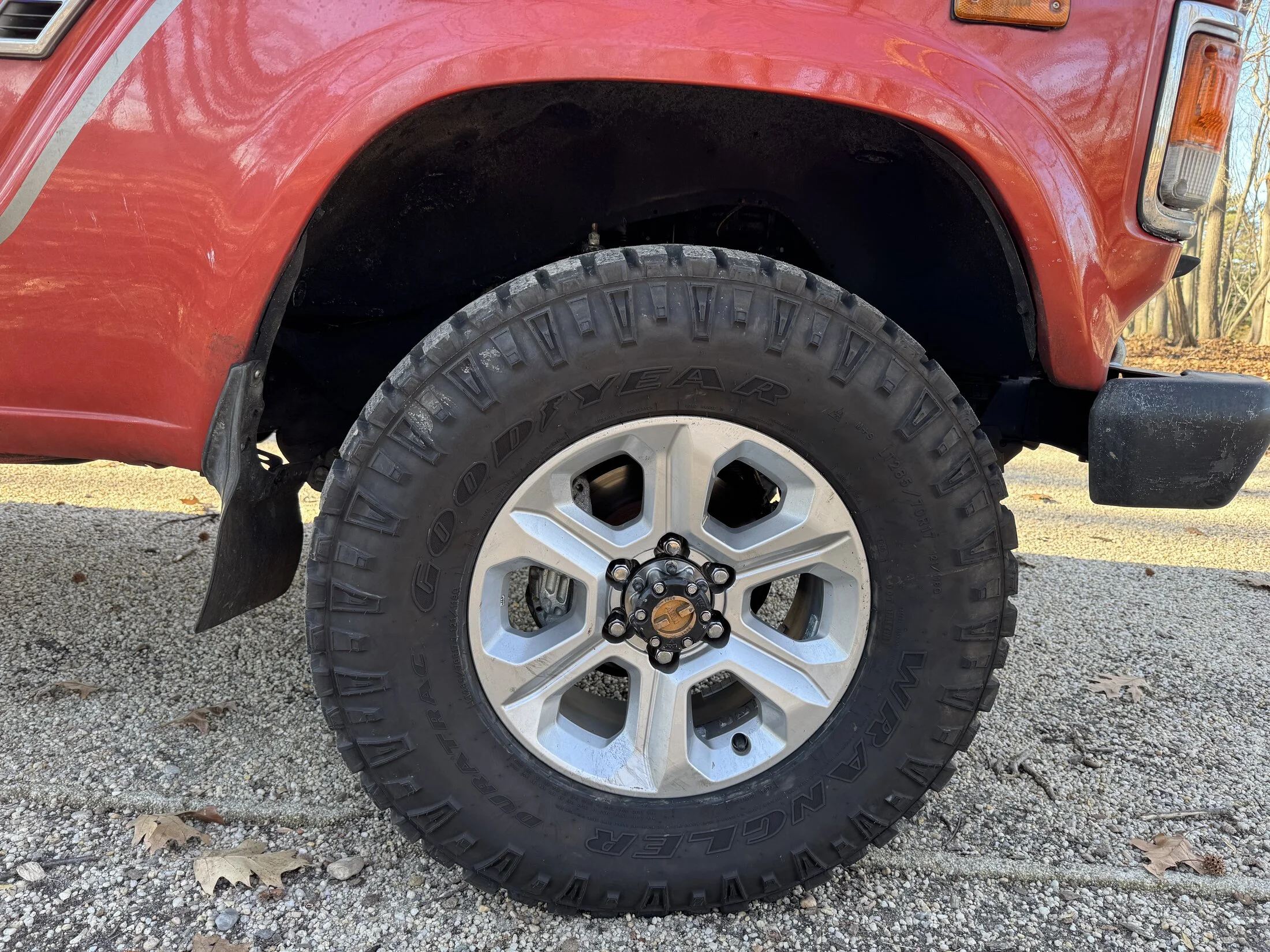

Long of a wait (4 months) for some new Toyo’s that still had no projected delivery date while finding a new set of 5 Goodyear wrangler duratrac my son found and installed for a great deal, order was canceled
Compound feels soft but they are rated E (285/70R17), which I am not of a fan for such a light truck. Let’s see how they do.
A before and after poser shots
i’ve run duratracs for years at about 34 psi and have found them to be great tires especially in the winter. too much air and they are harsh but lower pressure doesn’t seem to ruin fuel economy or sound too loud. i hope you like them! they look great
I had some on a 60 and had the same experience too. Fantastic on snow and ice.
Thank you both, good to know. They are currently filled at 35 psi.

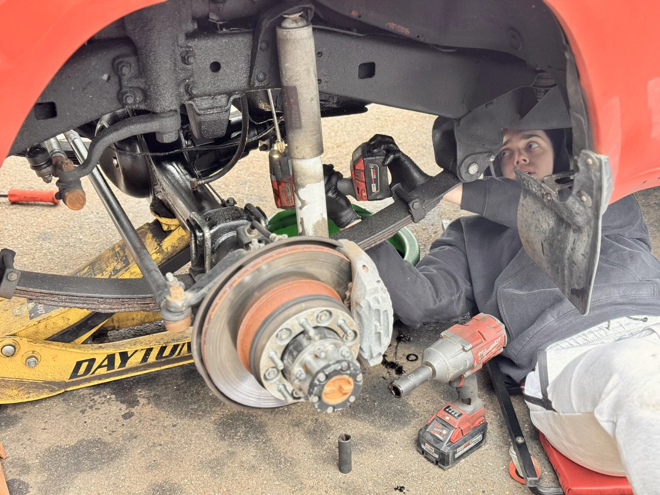

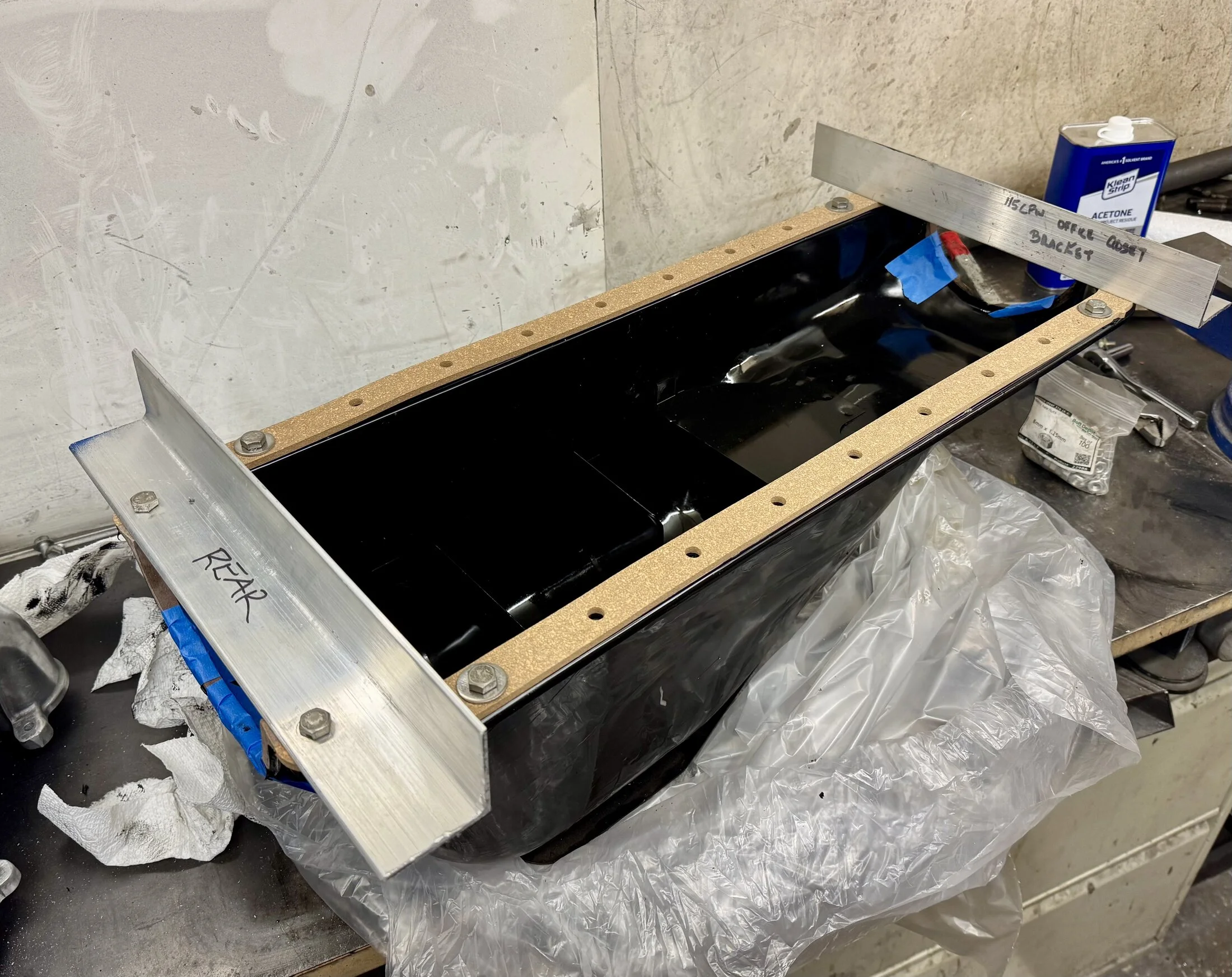

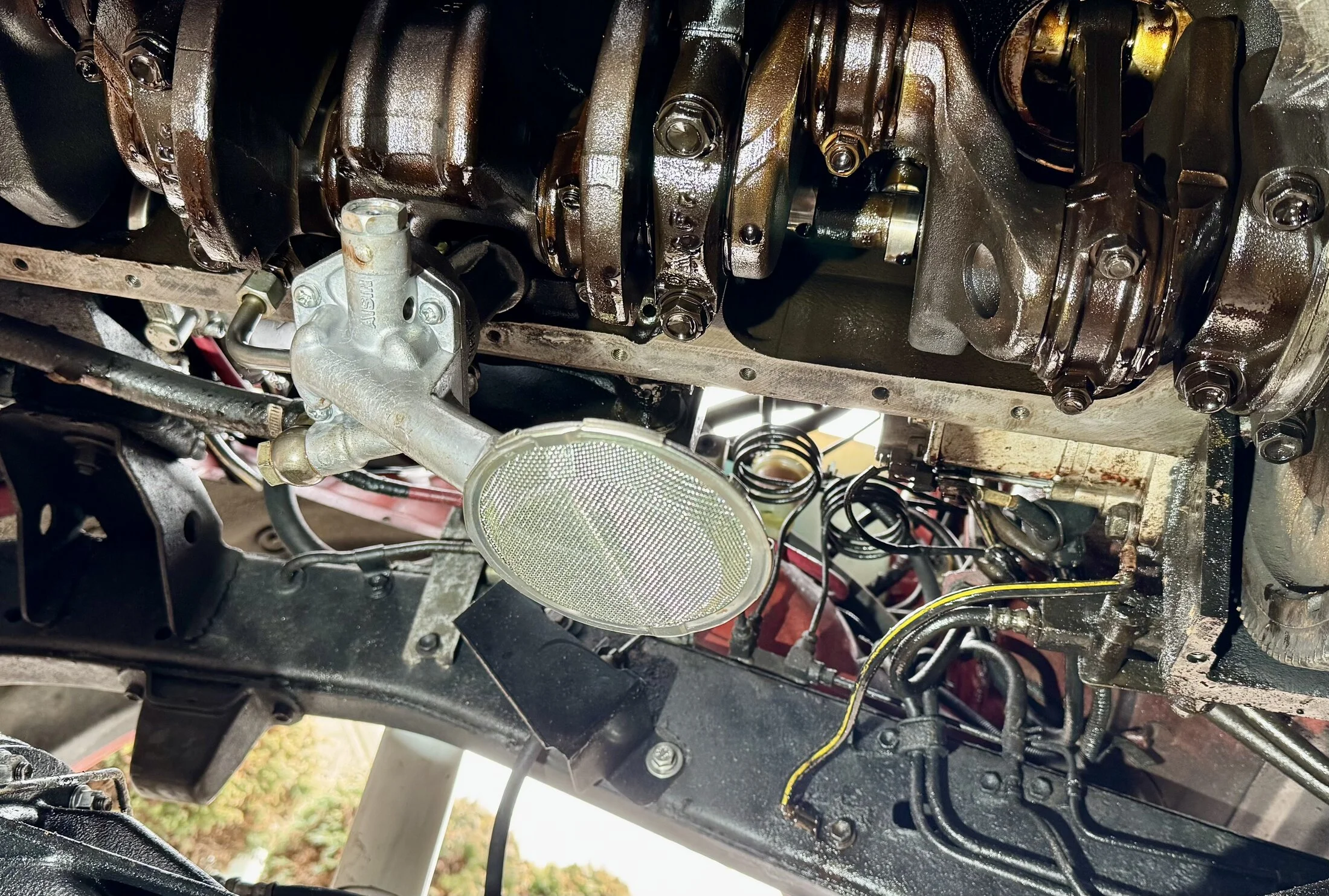

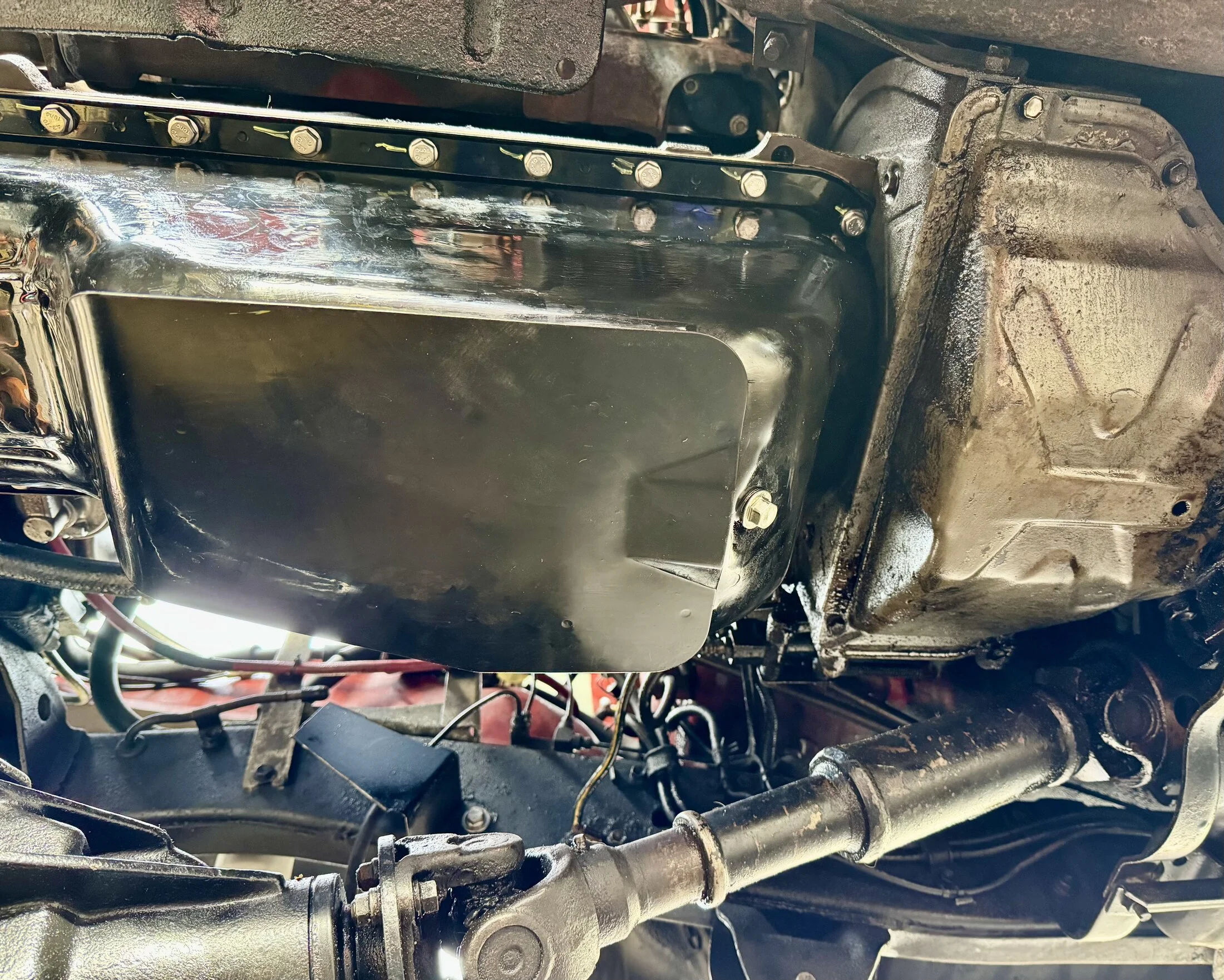

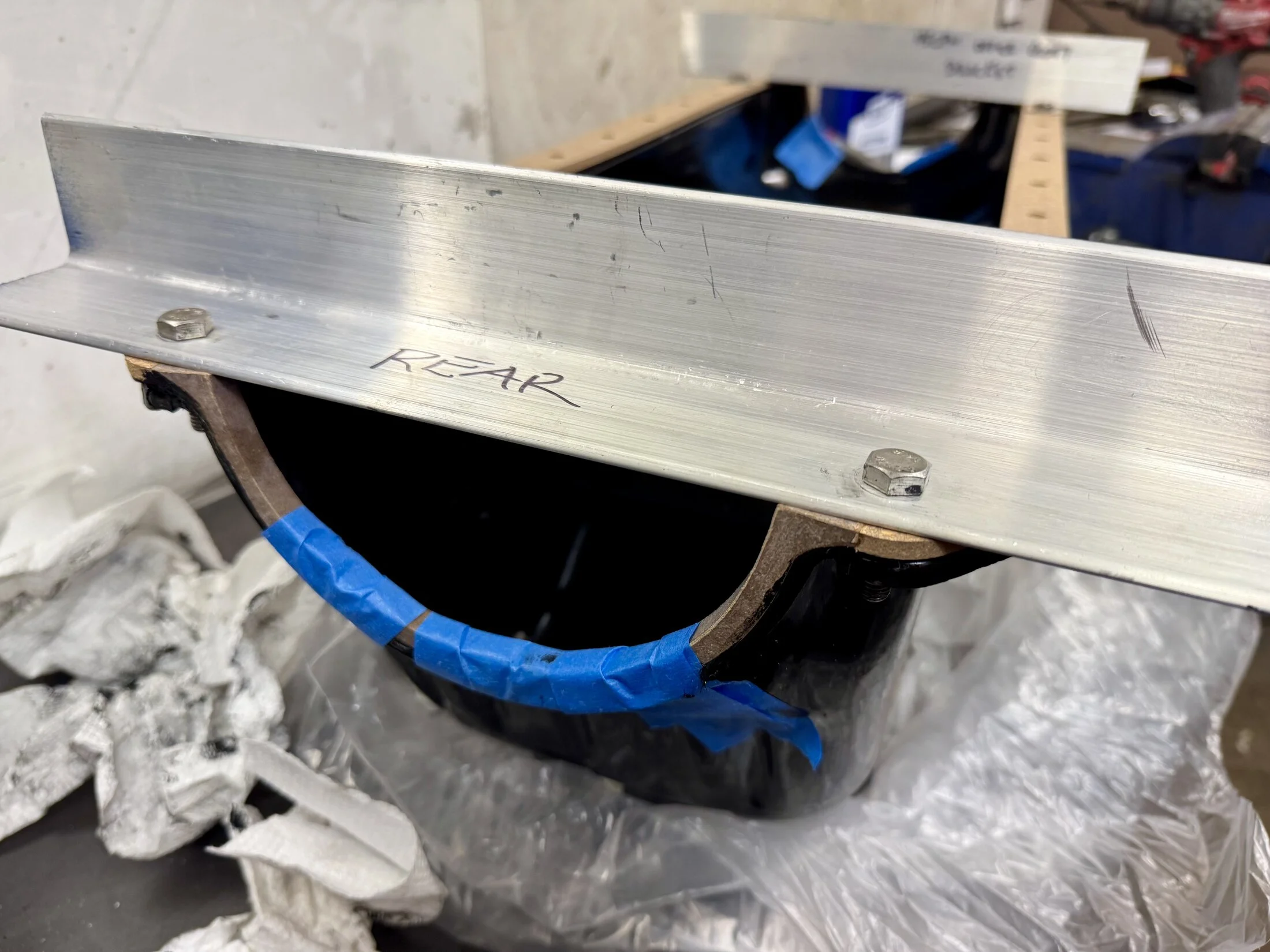

The 60 decided to piss oil trough the oil pan cork gasket. As a daily driver, we needed to fix this fast, luckily had a new oil pan, gasket and pump to replace it with.
Wish I had this done with the front axle out last year. What a pain was to remove this pan that looked to be stock !
- Hung the truck by the Frame, removed the shocks to let the axle hang low (for better clearance).
- Used scrapped aluminum to hold the gasket in place while applying FIPG at the corners of the gasket.
- Kid took the truck back to work !

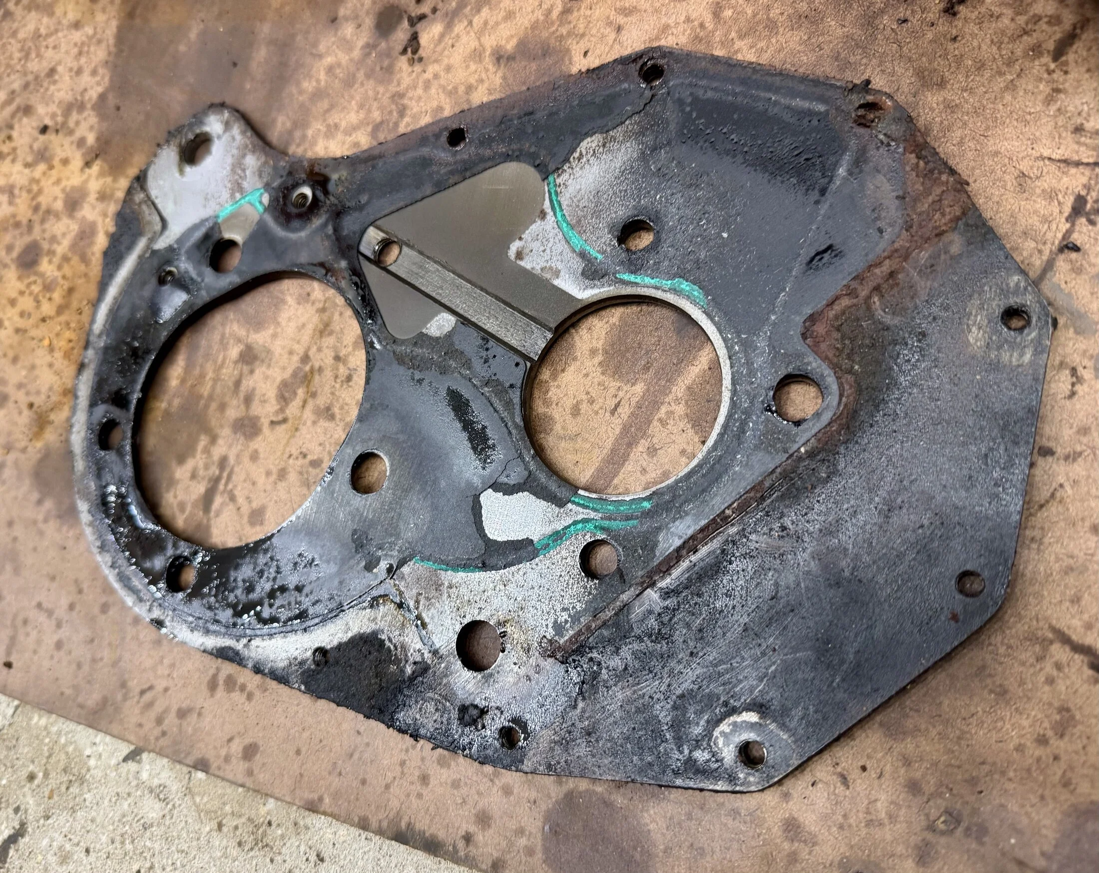

Oil pan gasket worked really well after 250 miles and now to have an Fing leak between the timing metal plate and block!!!!
Off course this is a real PITA to fix when it’s your DD that I want to sell this 60 of such frustration ….. threw some RTV (all clean surfaces off course) on the outside hoping it minimises the leak!

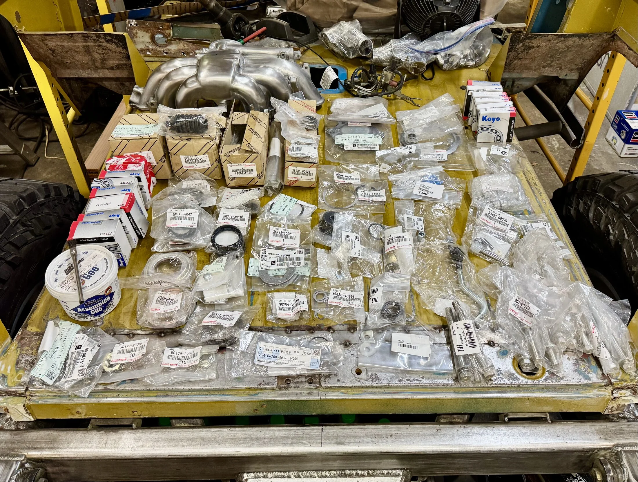

I sold a few great 2F’s and kept this 1985 that I had for sometime with low miles, not going to do a full rebuild but just re fresh it with bearings rings (found one broken) and all new seals. This gives me the opportunity to install a new h55f I have with a 4.1 split case that just needs assembly.
The idea is to swap when ready and sell the old drivetrain as is.
Sending the block to the machine shop (luckily they have been working on two late model 2F heads I dropped a few weeks ago)
Another 250 miles and timing cover exterior fix worked for now.

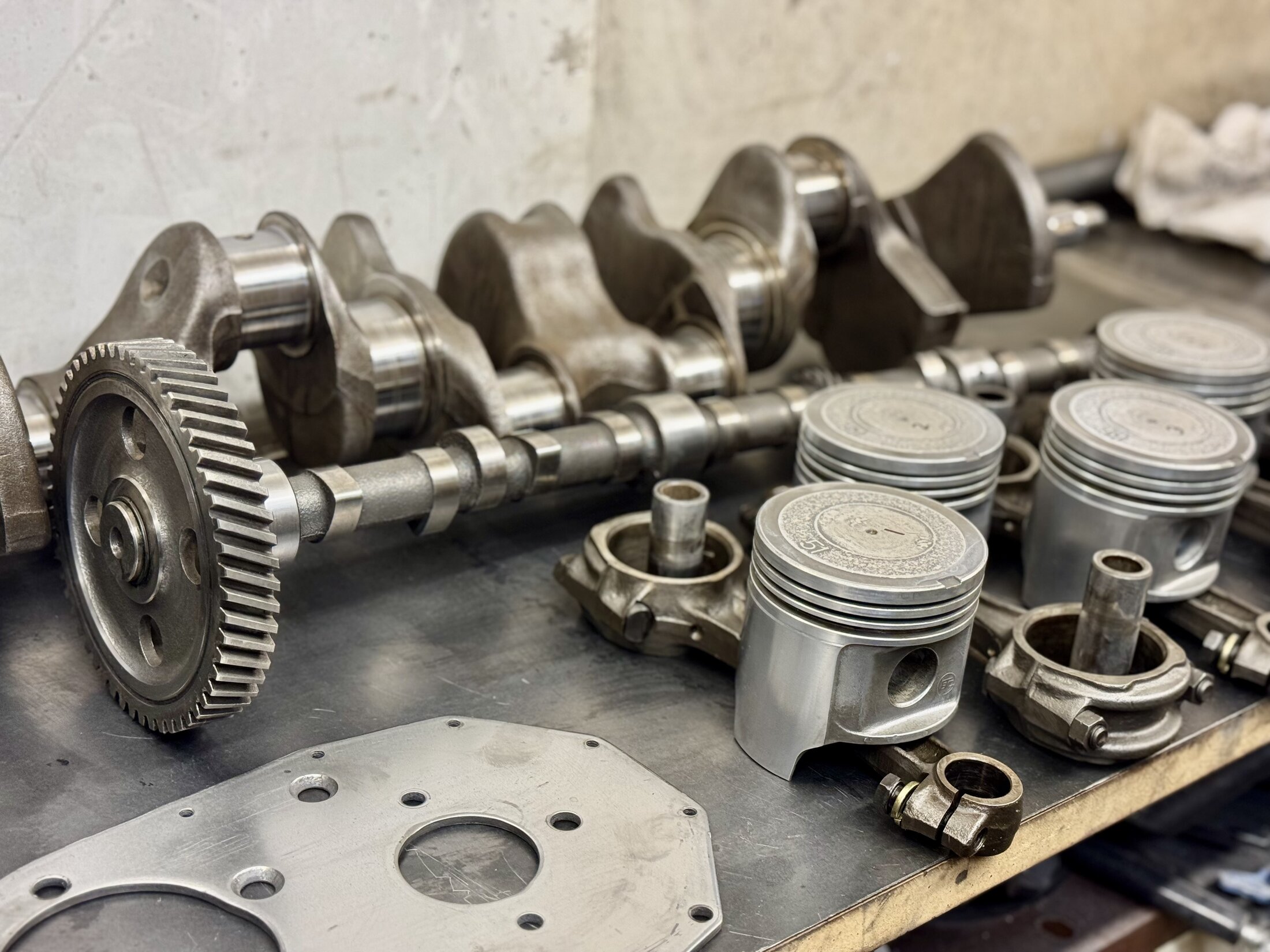

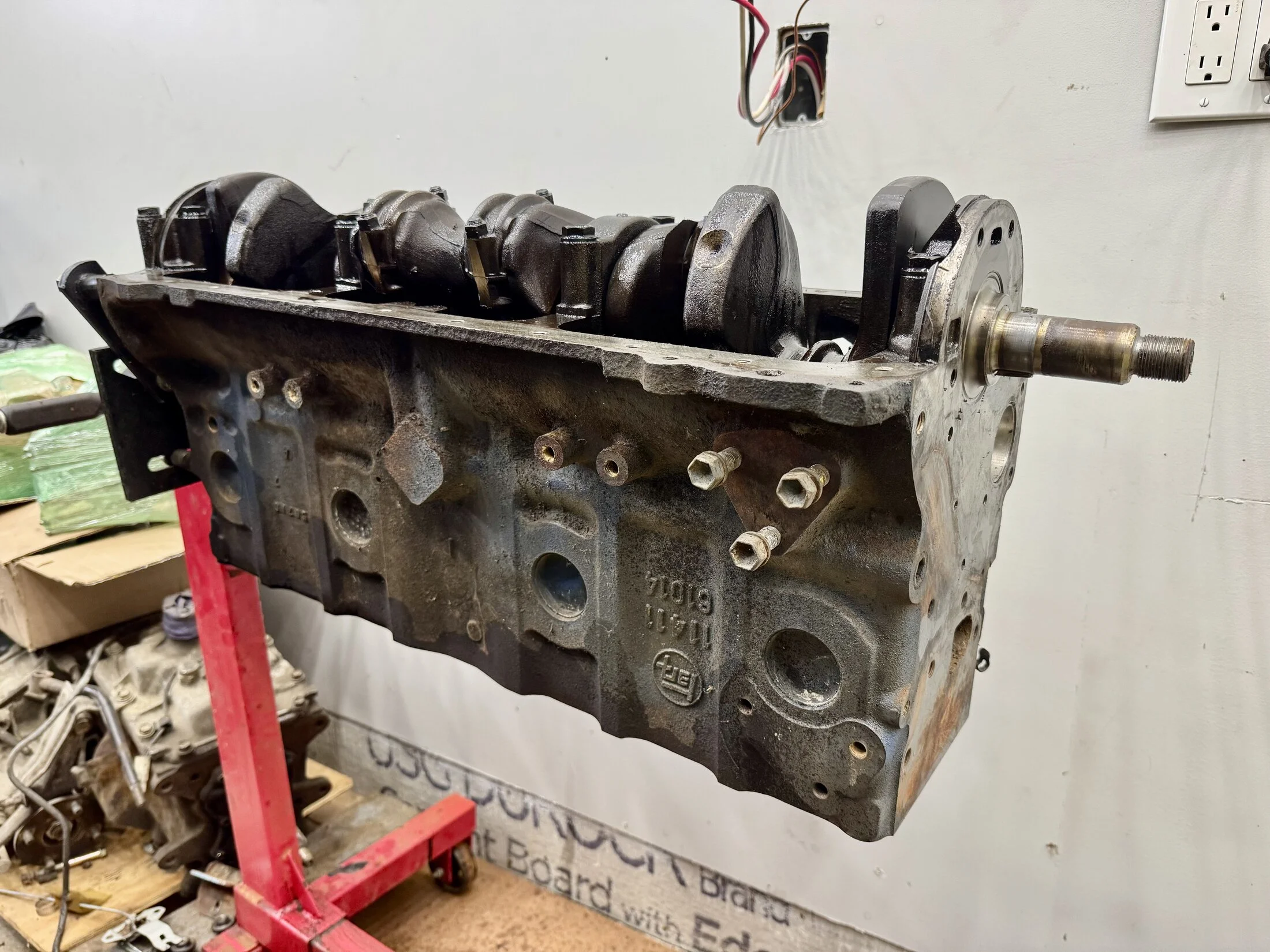

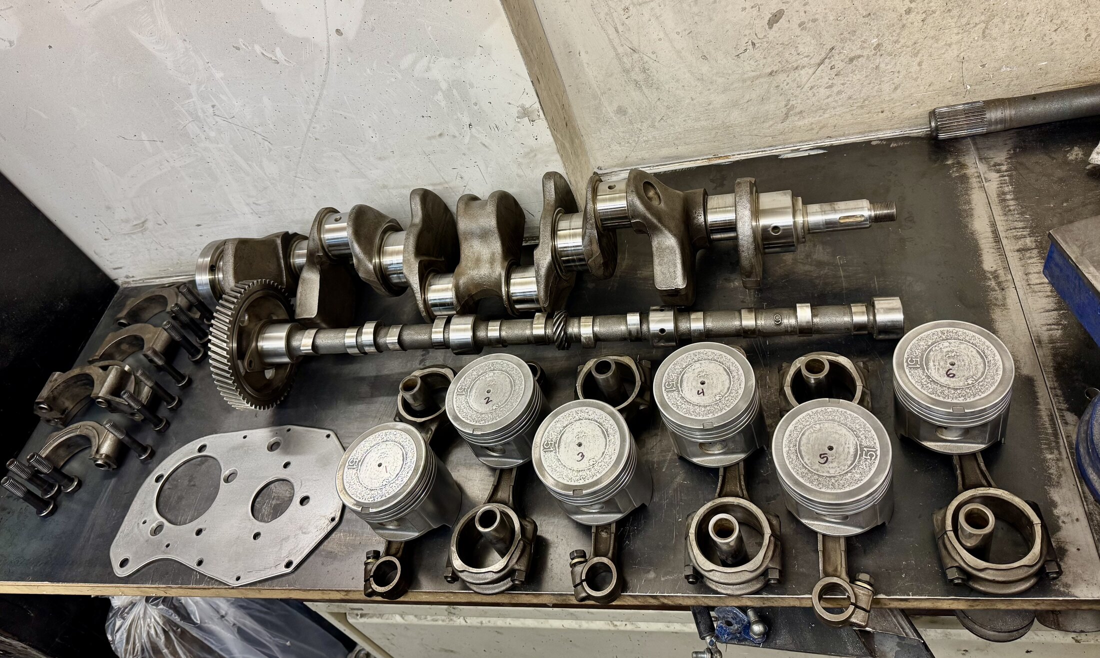

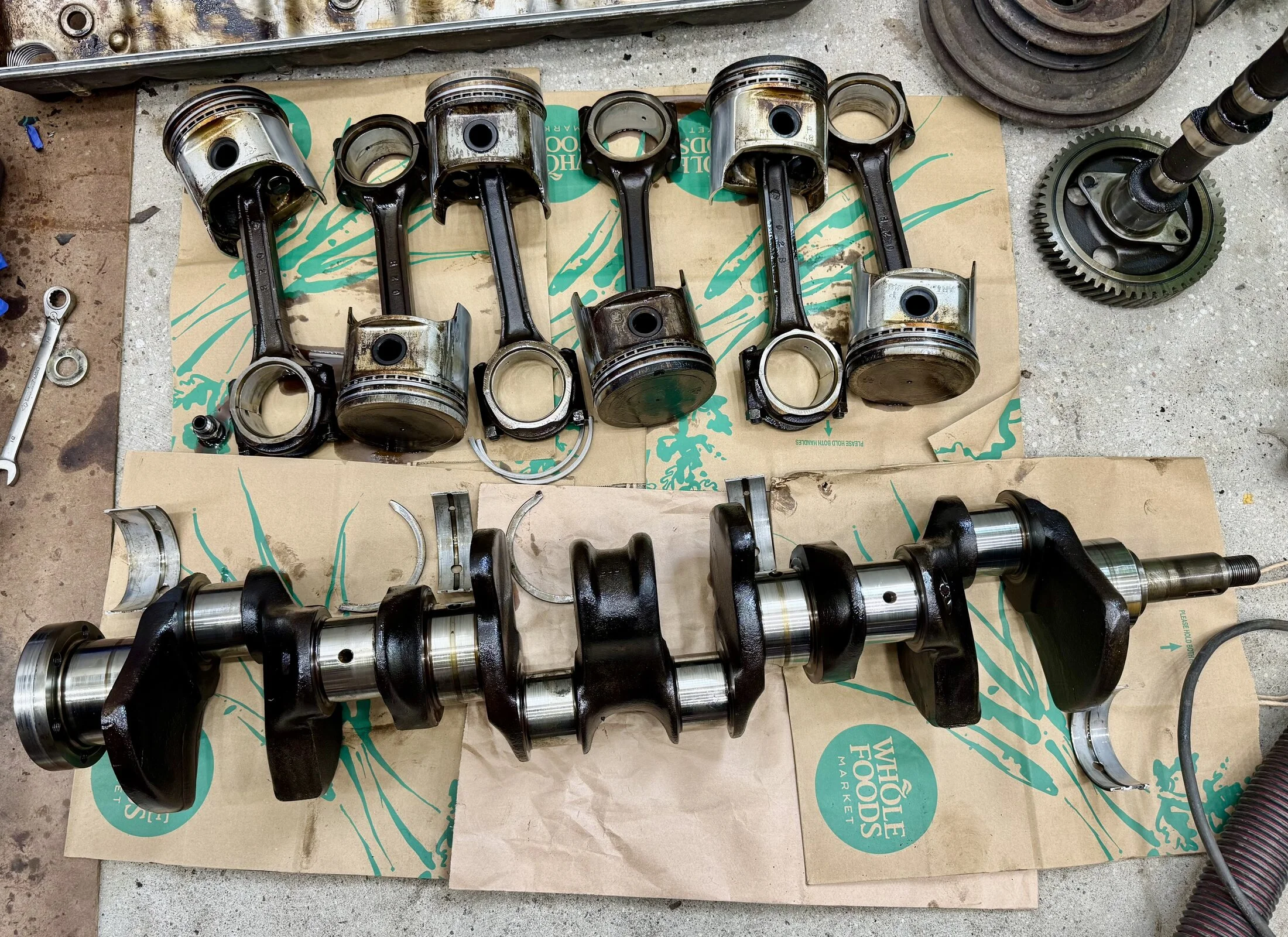

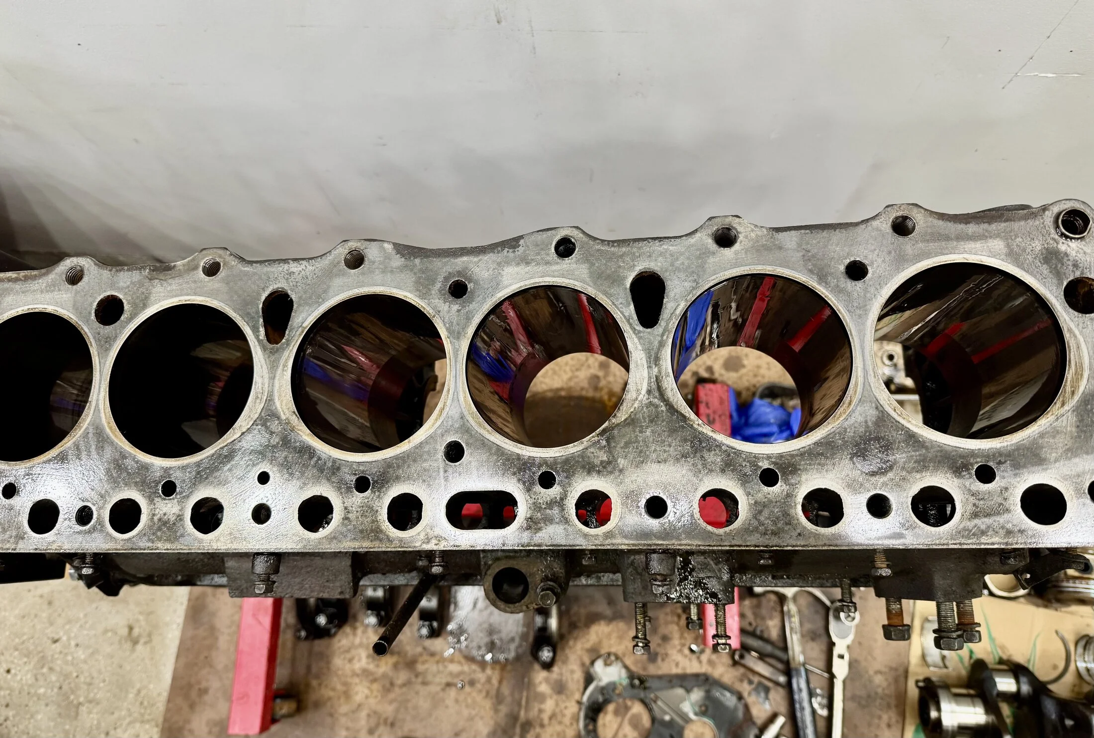

Dropped the long block to be cleaned, checked and honed.
Measured, cleaned and polished all internals. So far so good.

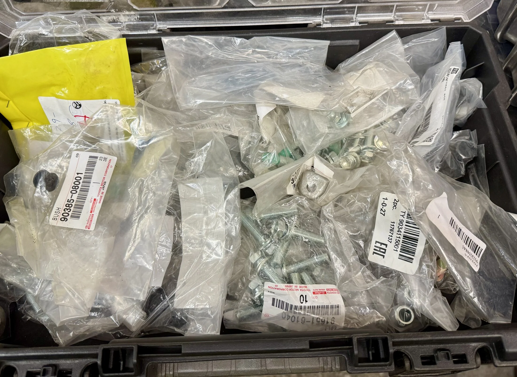

order a few more parts, just can’t find a good source of main bearings (std) and any recommendations for bearings cams ?

You can get cam bearings from Toyota for fairly cheap. Taiho is the OEM for the Toyota main & rod bearing and you can still find those - Taiho packaging, not Toyota. There are aftermarket choices, but I don’t know about those.
Thank you ! Saw the Taino brand out there but wasn’t sure…

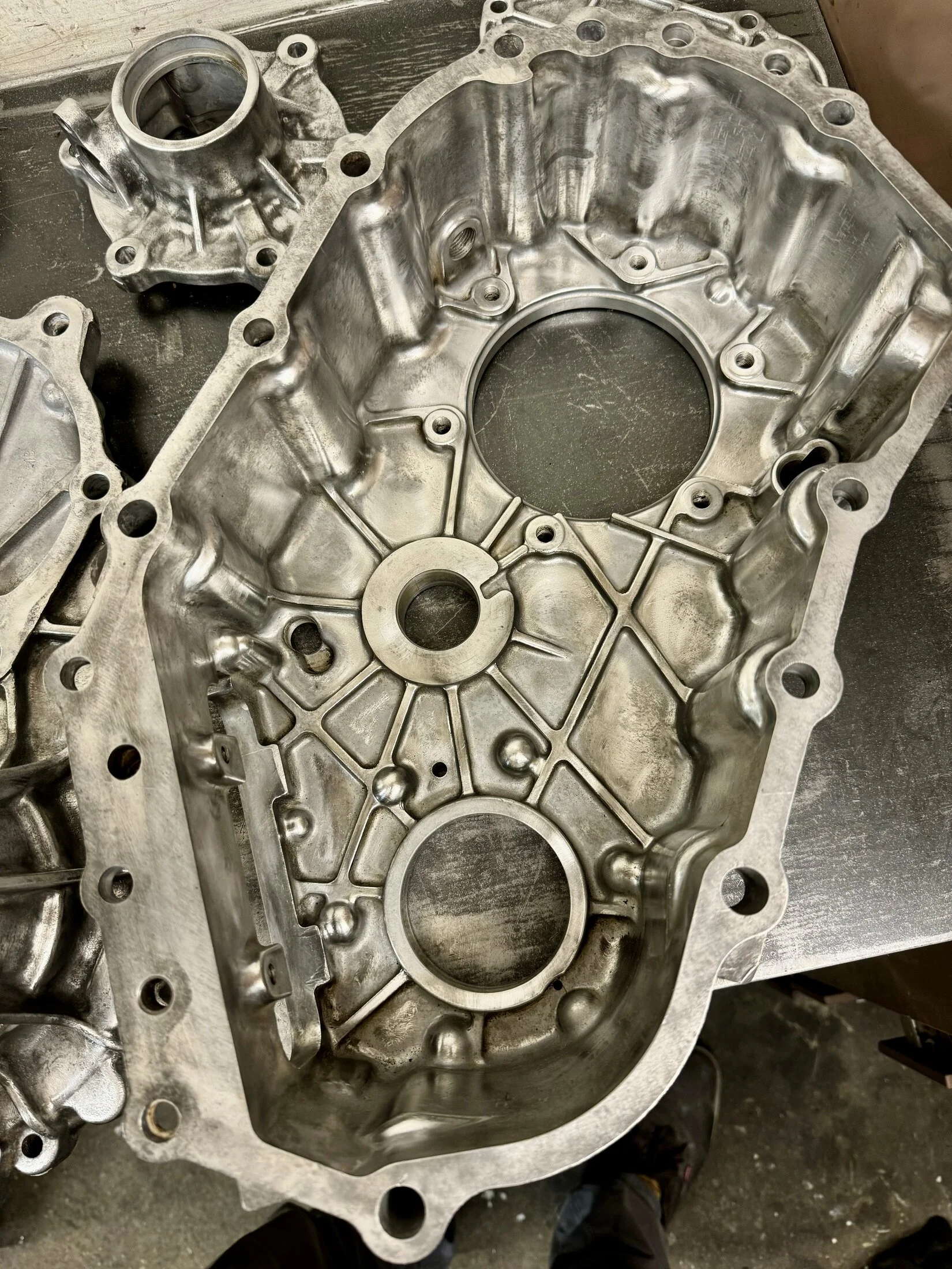

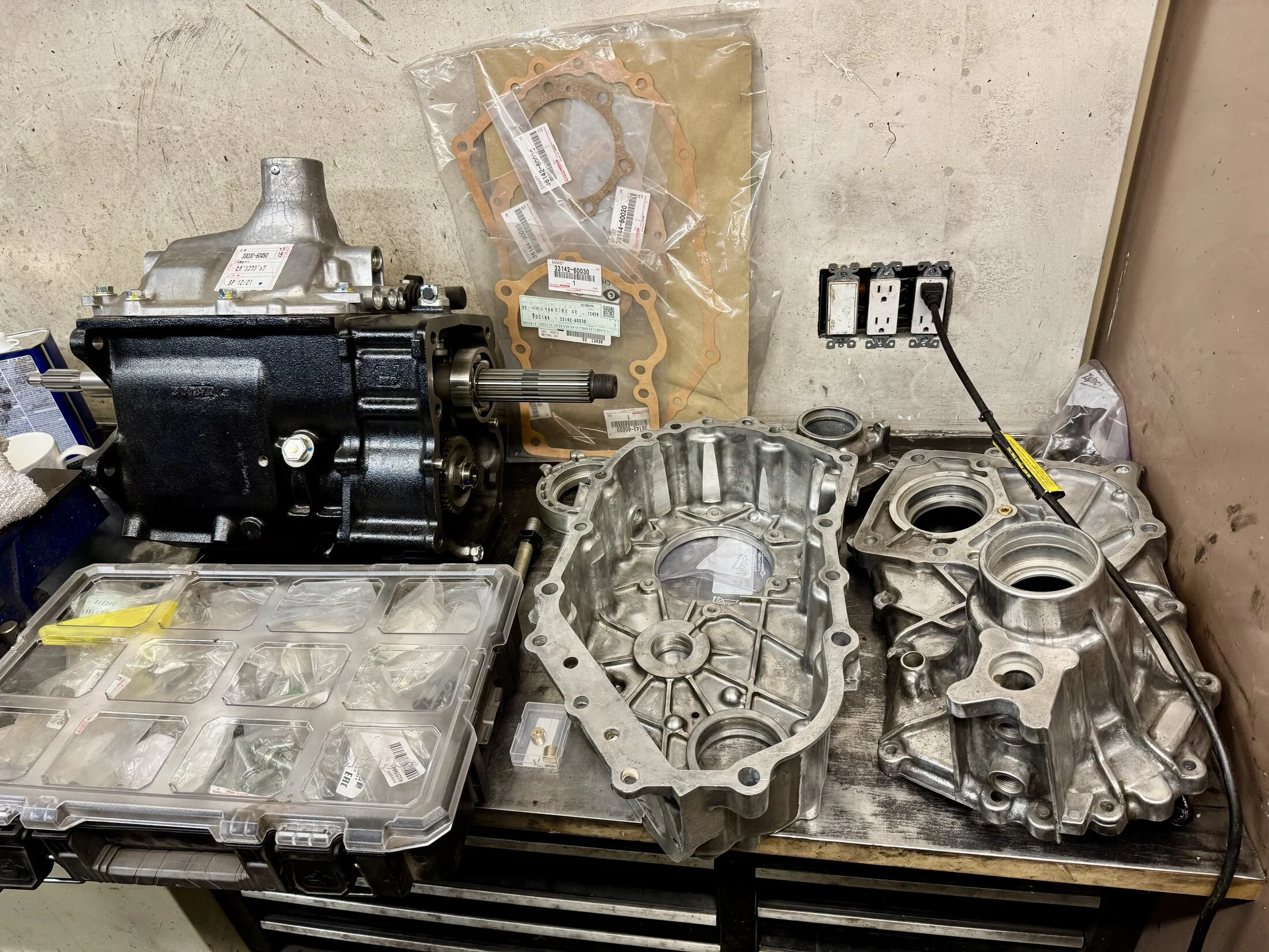

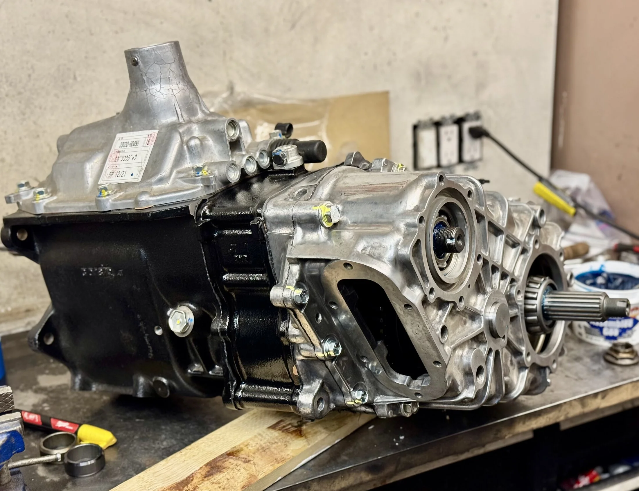

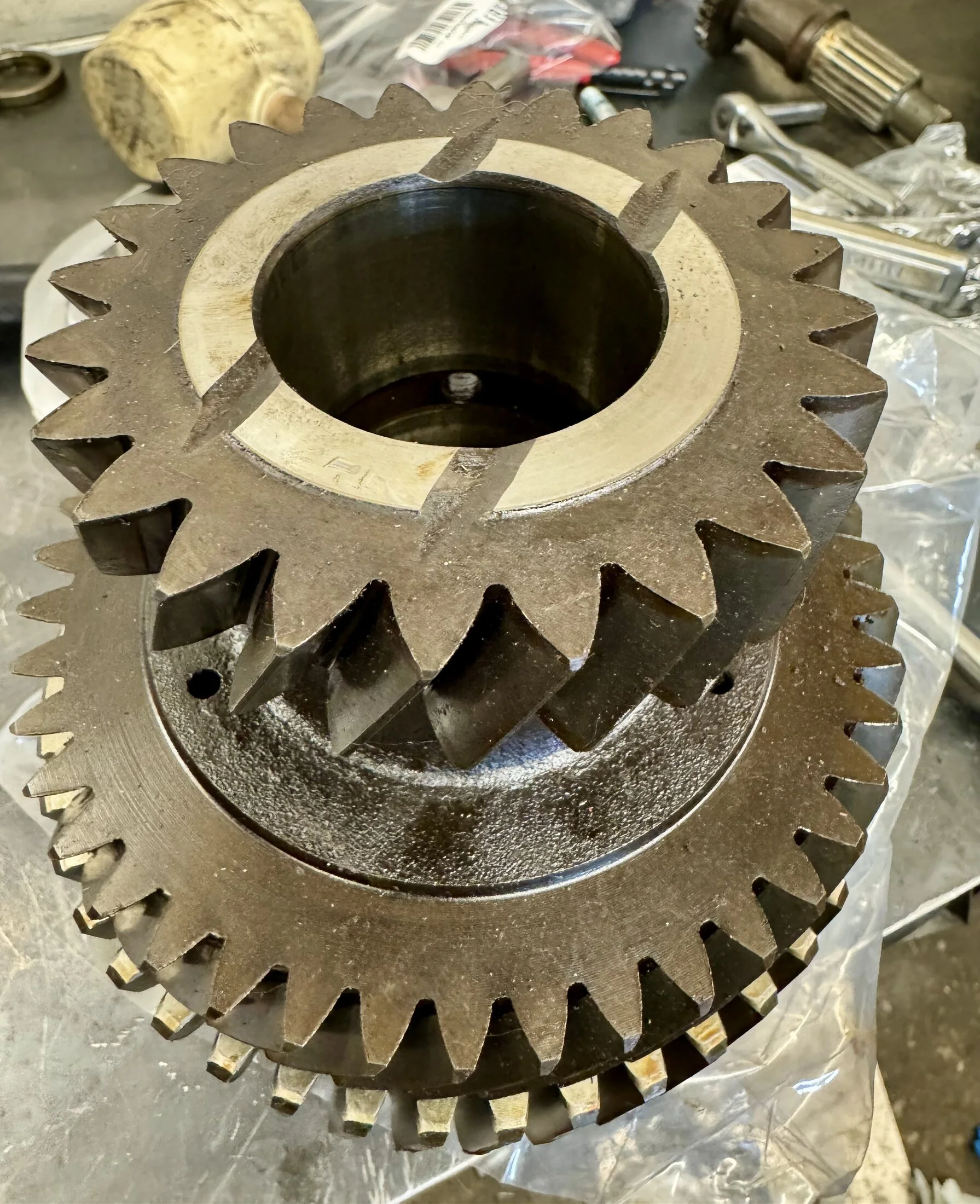

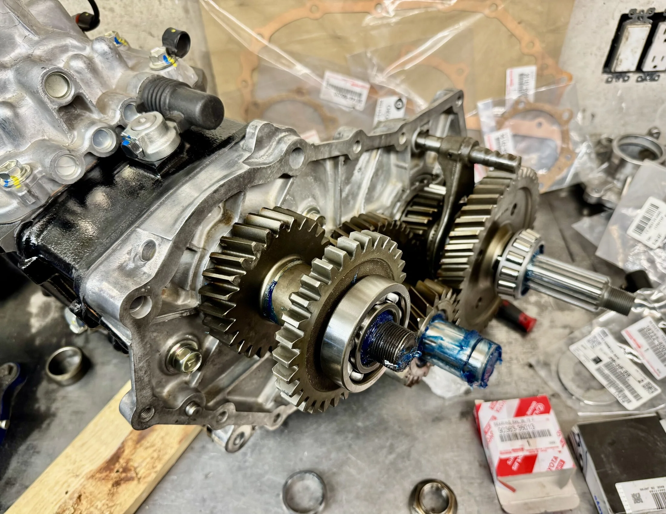

Pulled the H55F along with the 38mm split out of storage….. Sorting out parts to get this thing assembled soon

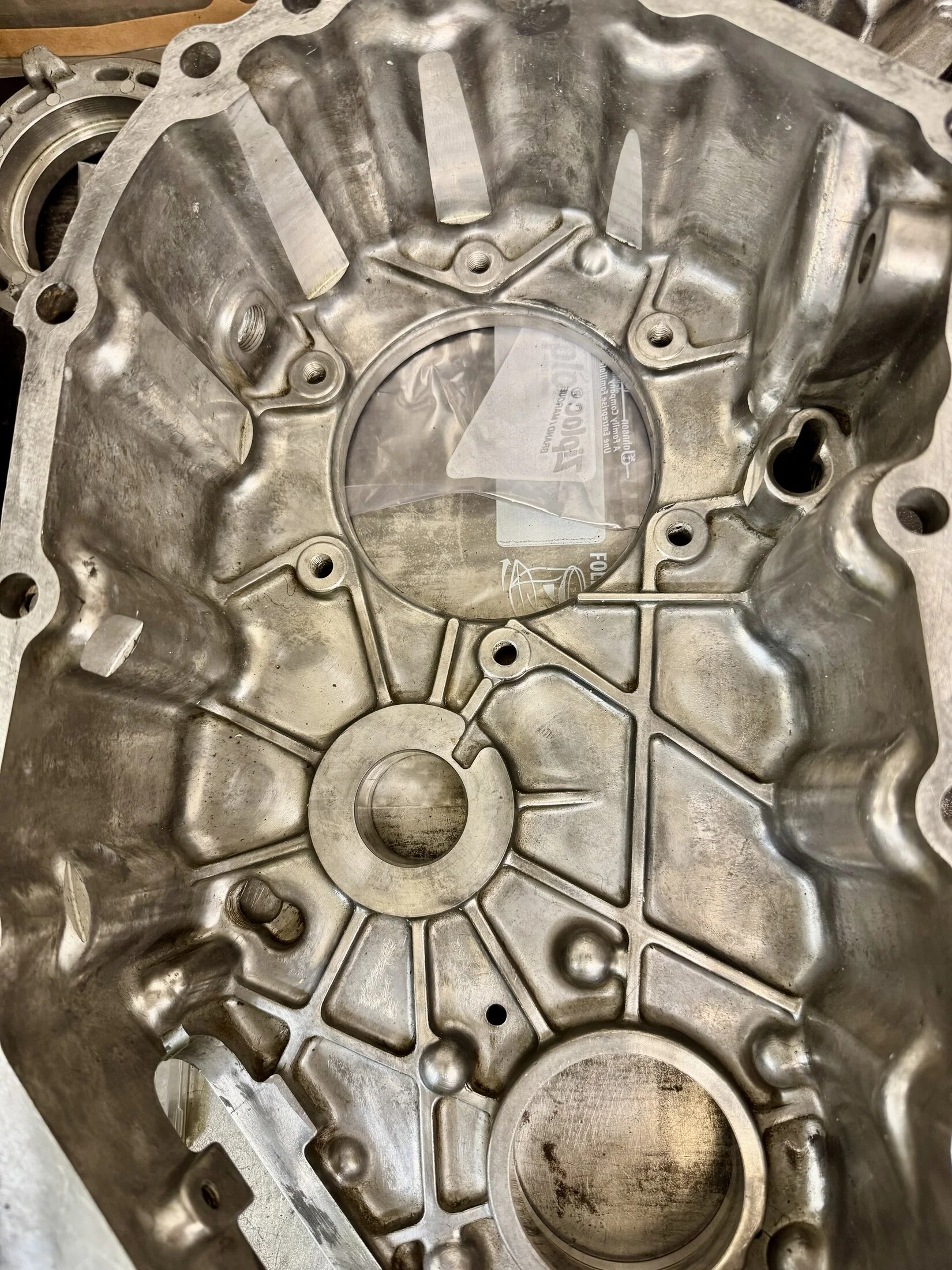

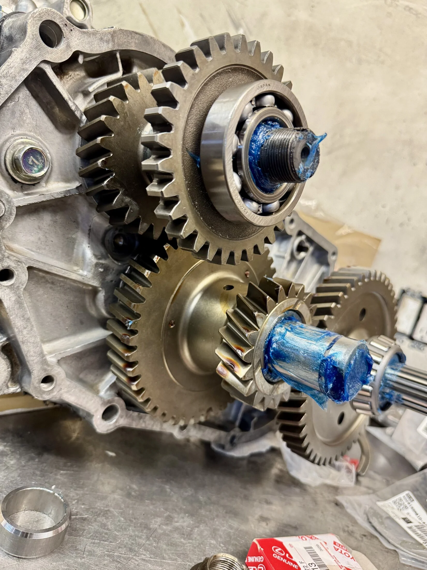

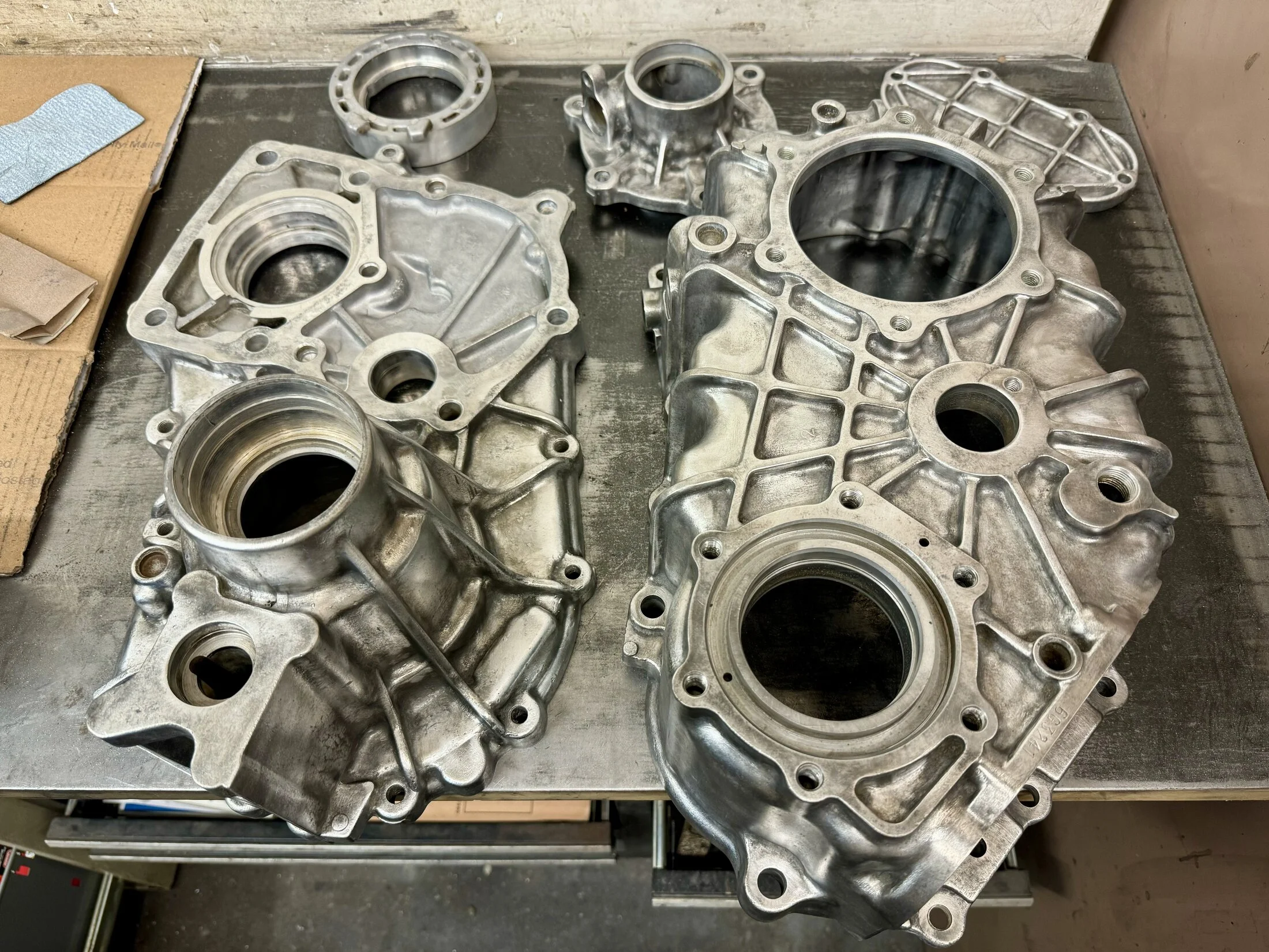

Kind of nice to have this all ready as it has been sometime since I sent the case to georg to be machined for the 4:1 gears to fit (before and after photos). This setup was originally going to my 40 but have changed directions with drivetrains.

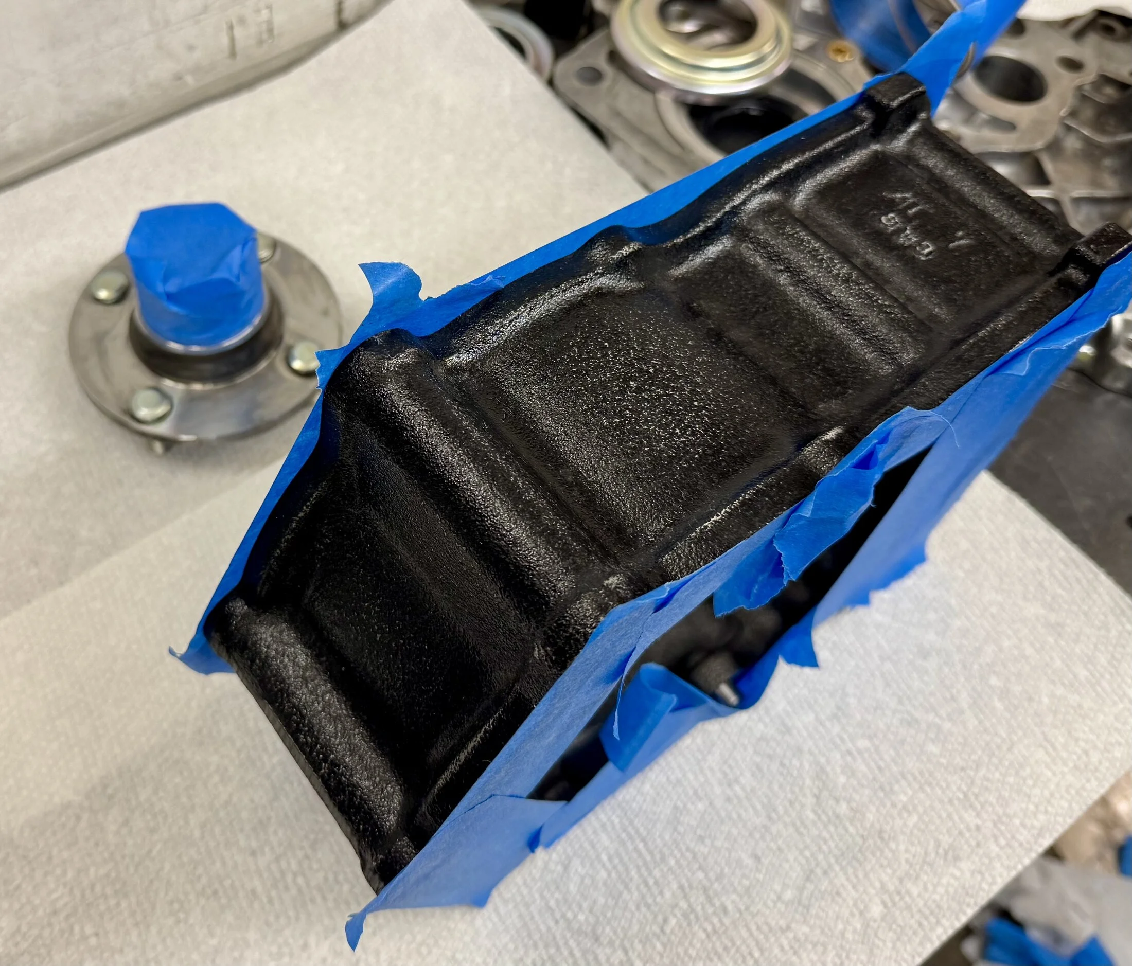

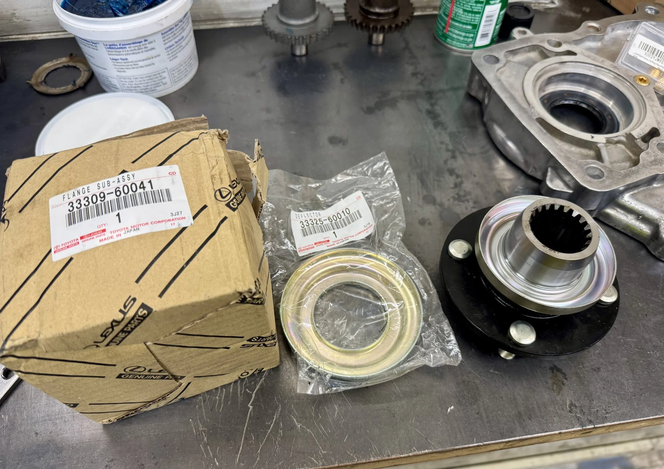

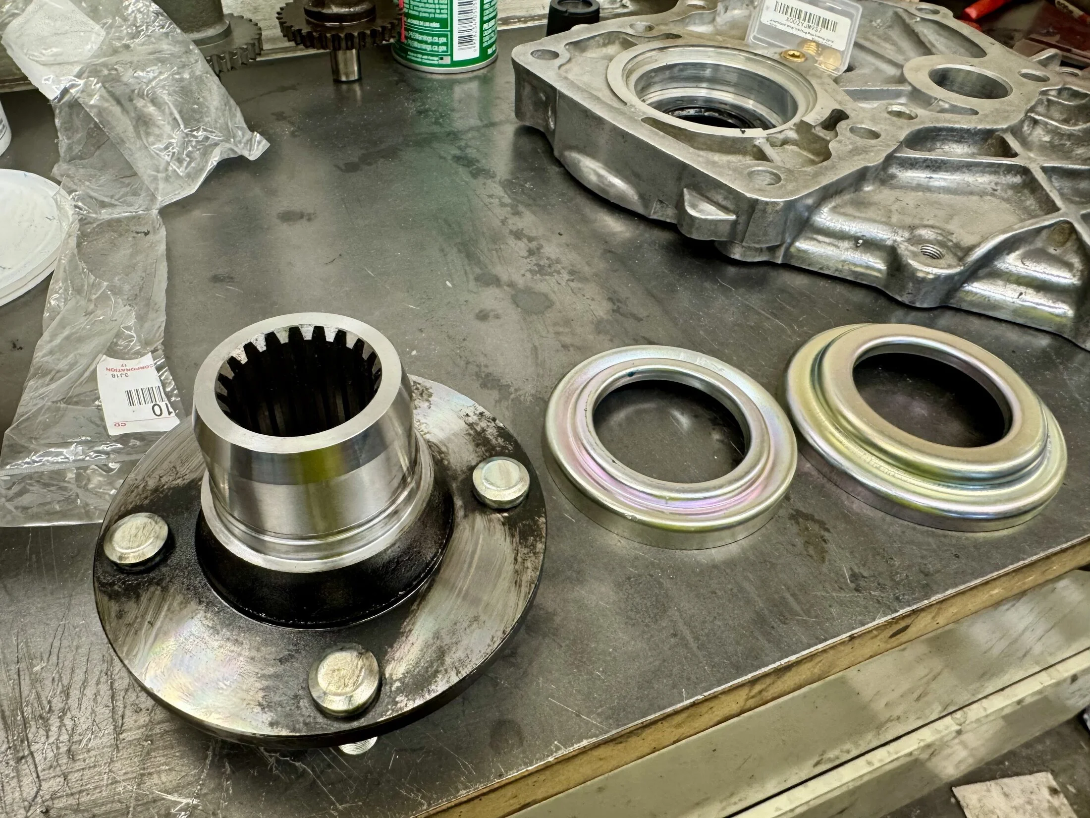

Next, needed to prepare a rear companion flange to be retrofitted into a front since this item is NLA.
Since the rear is available and almost identical to the front, the two differences in between them are longer studs and dust deflector.
Studs, who cares…. Deflector, easy swap !
Parts numbers for this job are
- 33309-60041 Flange
- 33325-60021 Deflector
Lastly, since Toyota never does a good job spraying their new parts, a simple pass of brake cleaning, took all the paint away (smooth surfaces mostly).
Obviously sanded, cleaned and masked for a better quality paint job
This thing will go slow for sure 😞

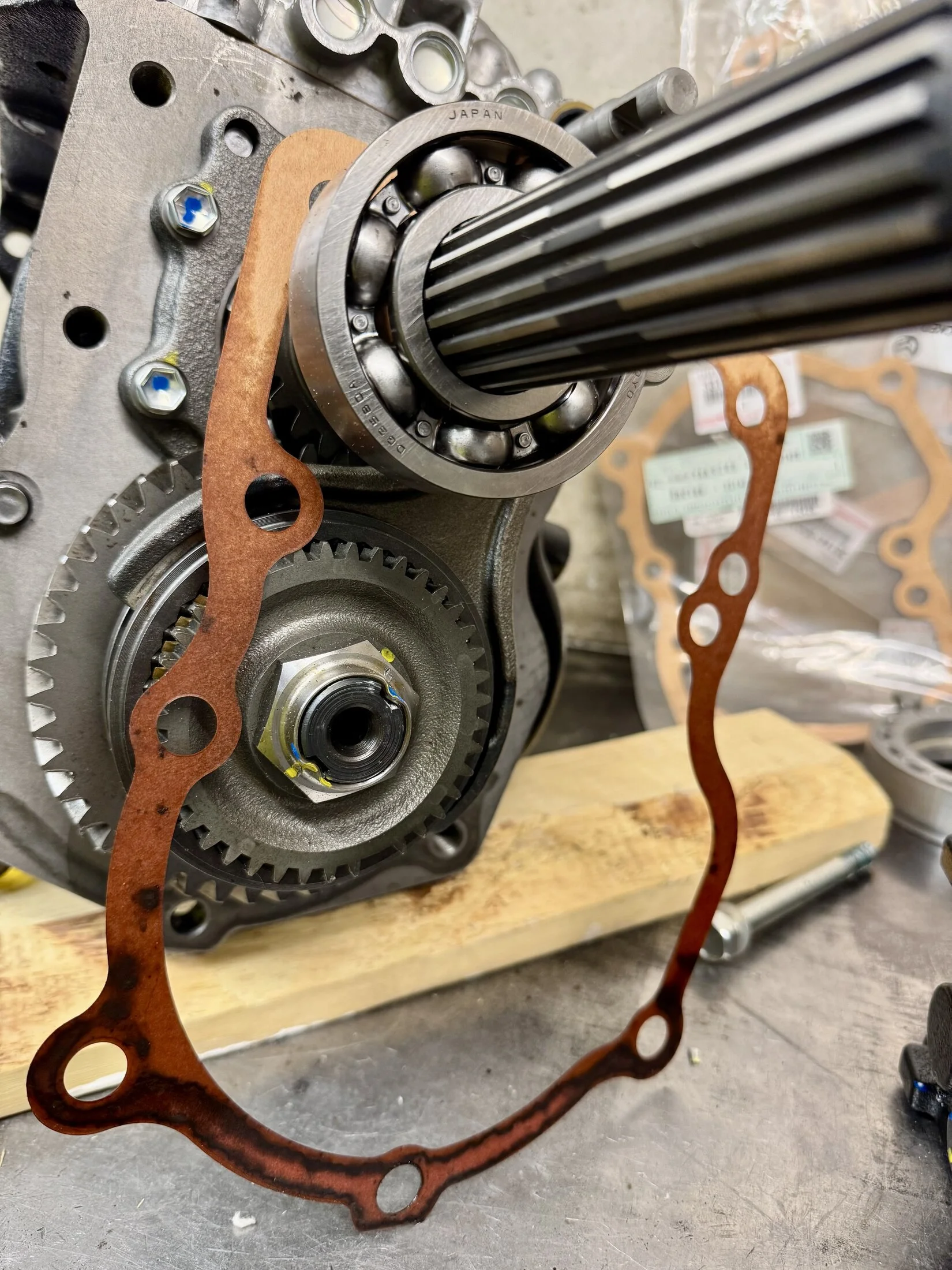

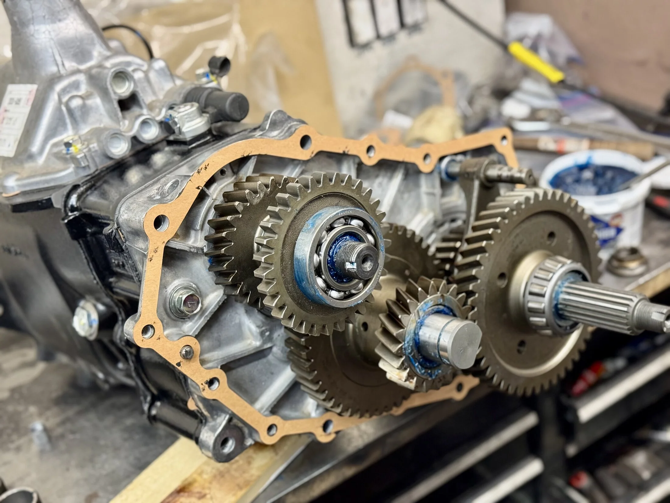

Haven’t done one of these in a long time, taking me more time than anticipated.
So far so good, the machining work on the half case seems to clear the larger gear (did a test before installing the gasket).
