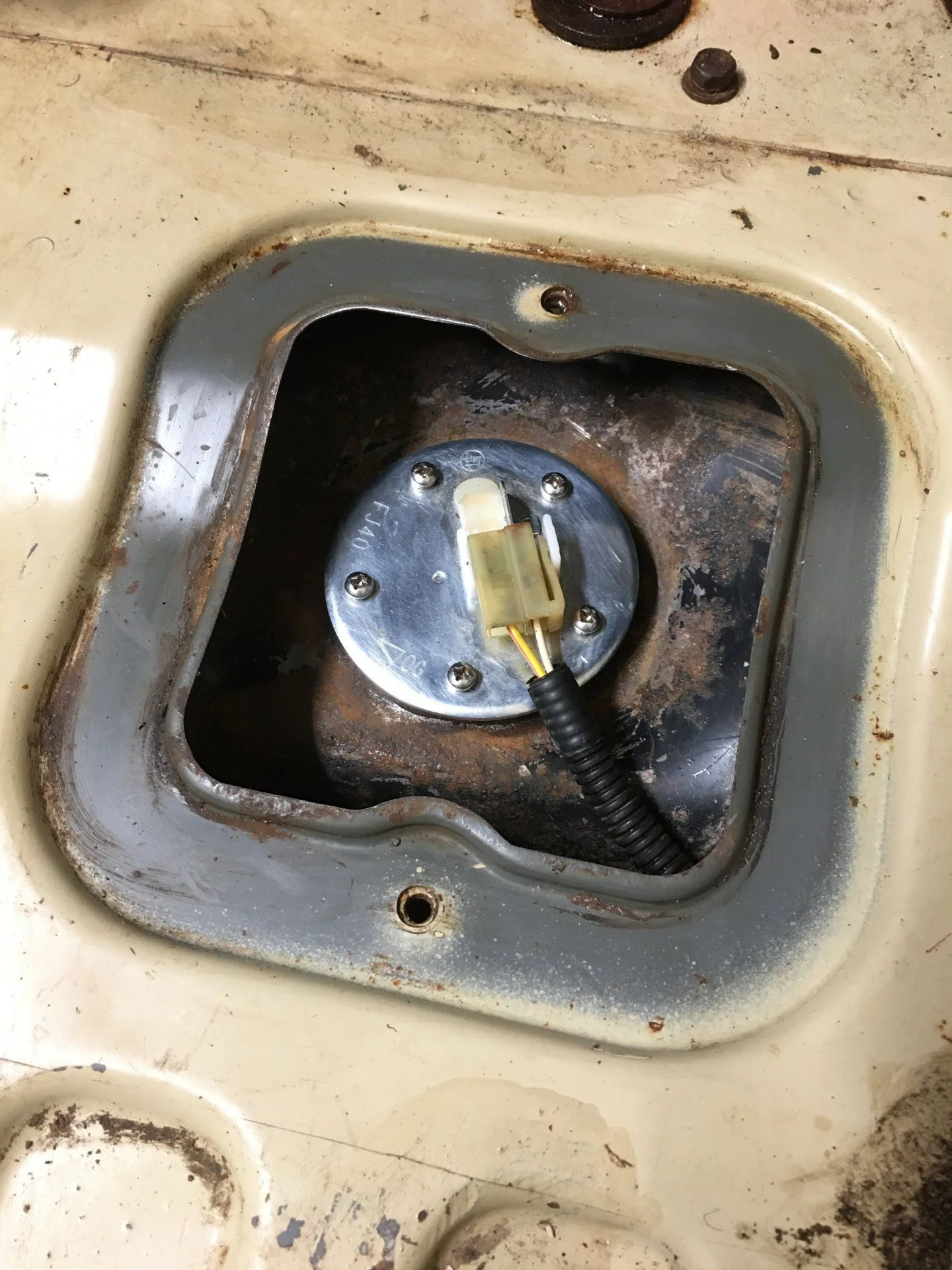

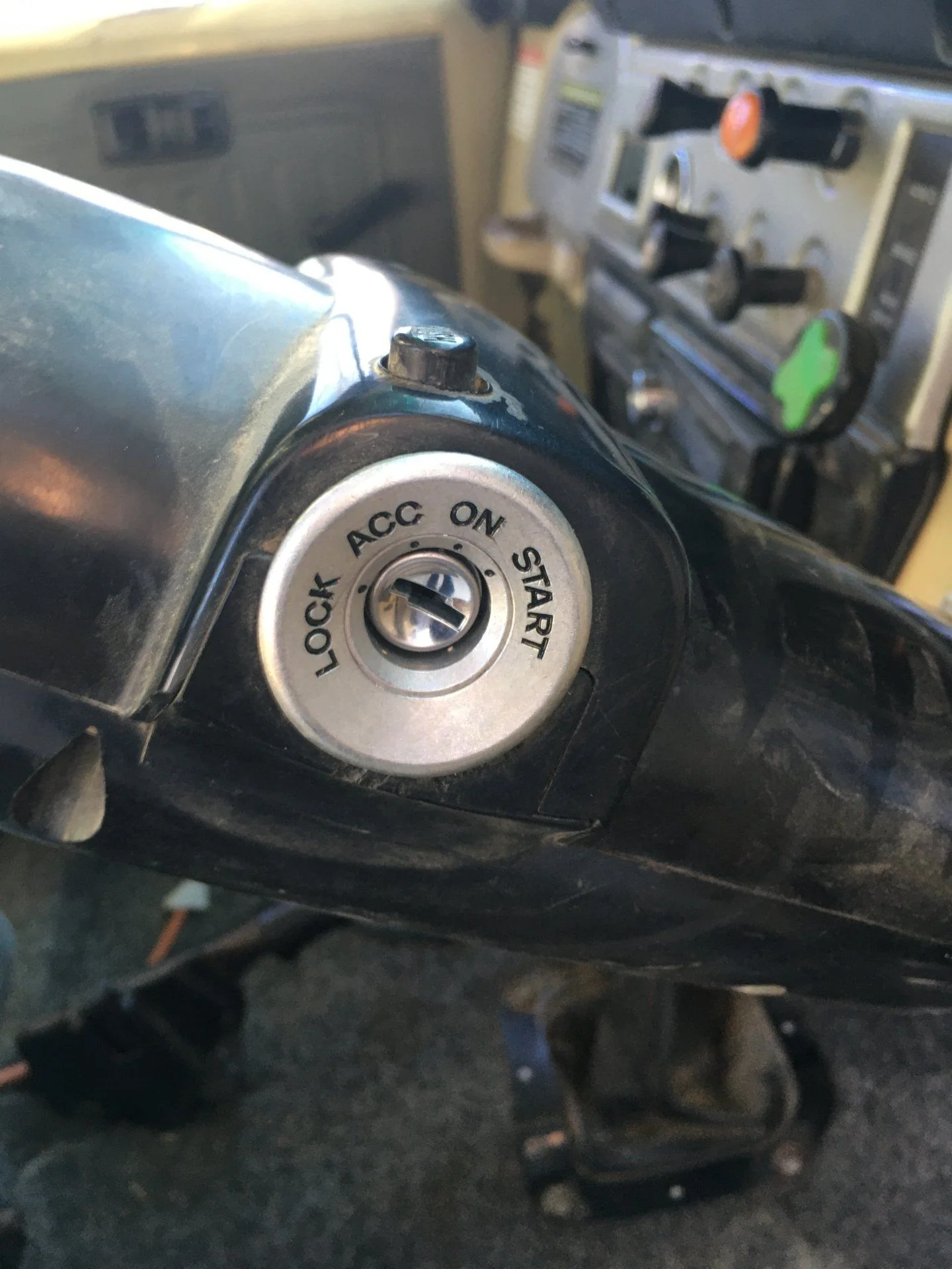

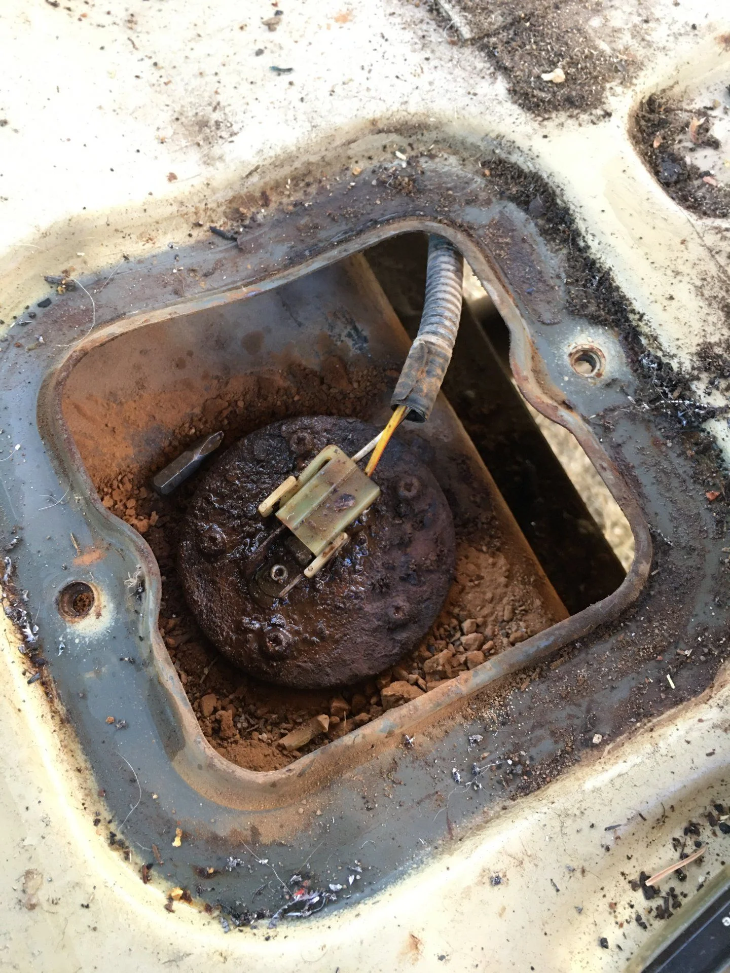

I’ll start with some recent work over this last weekend after I lost my ignition key for the last three months in my storage unit! I thought it would turn up but never did. Someone tried to steal the truck in Seattle when I was there working, so the ignition was messed up for years now.
The fuel gauge read 2/3 when full and just under half tank when empty since I’ve had the truck as well. After pulling the old sender out I’m sure I could have just cleaned up the electrical connection and it would have worked again. But new screws, gasket and sender was about $70 is all. I had to drill both heads on the cover plate and one of them on the sender. Which came out with a left hand drill bit.
I’m horrible about working on stuff when it needs it but the truck still drives!

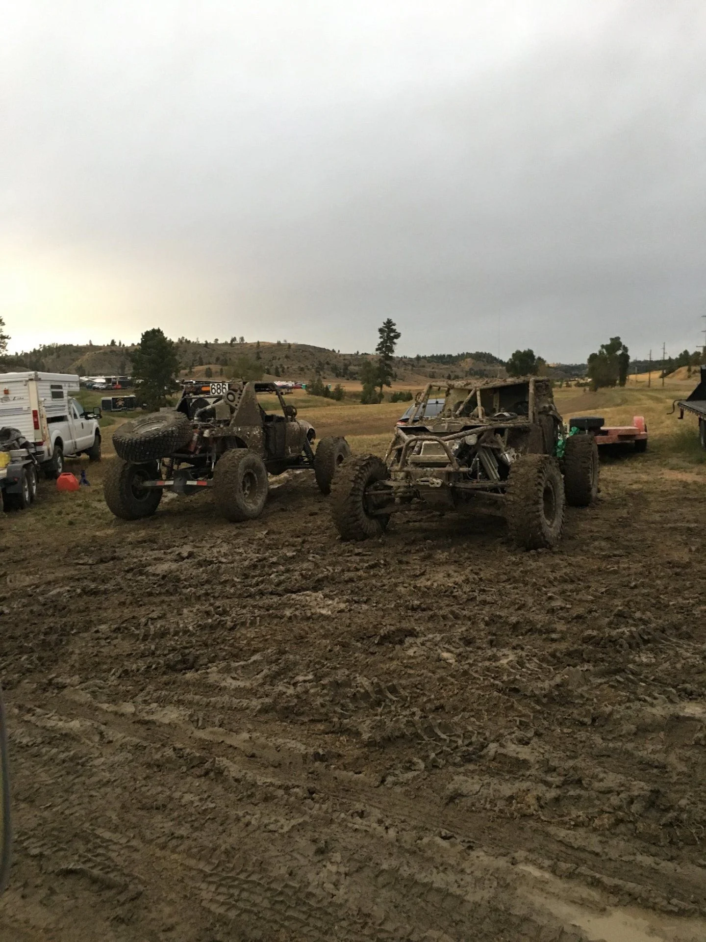

Drove it to the Buffalo Chip in Sturgis South Dakota last August. Which isn’t far from my house with my dad to go do safety and recovery for another race series a few of my friends race in. That orange 40 has race history dating back to the 70s here locally. We used to have off-road races out north of Badlands national Park. It’s got a complete custom 2 x 4 box metal frame. Pretty cool old tech that still works!

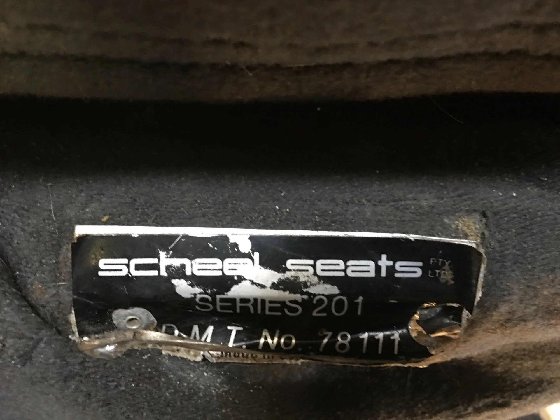

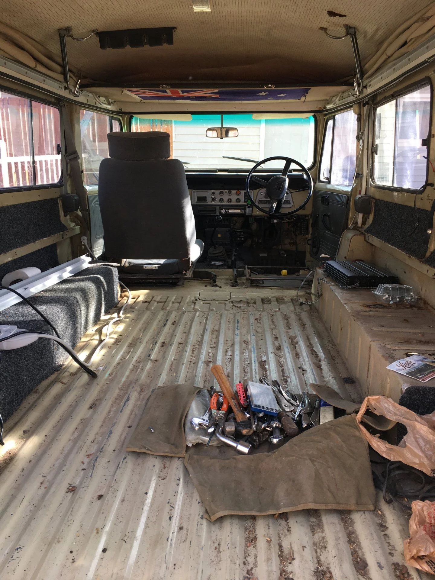

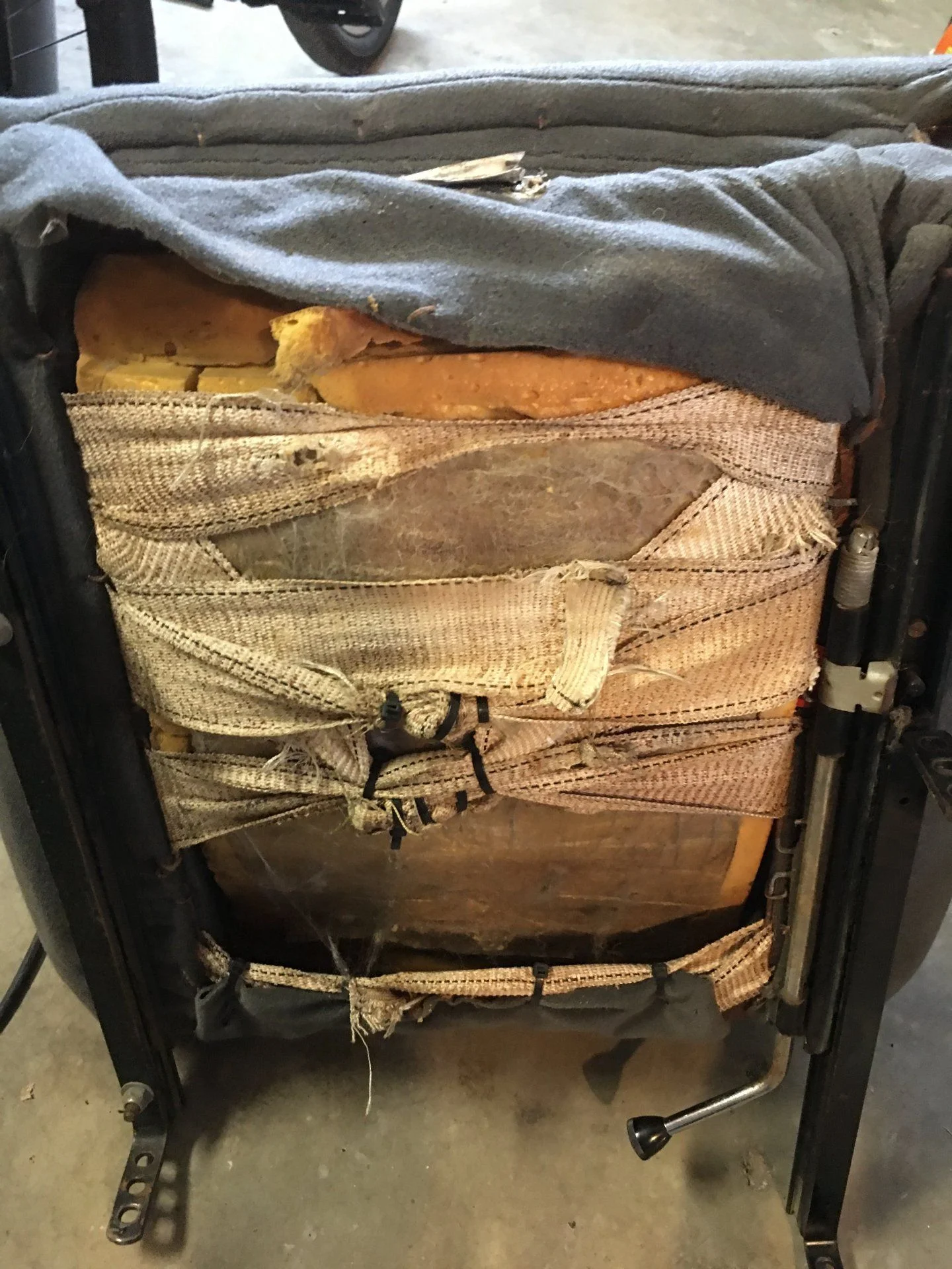

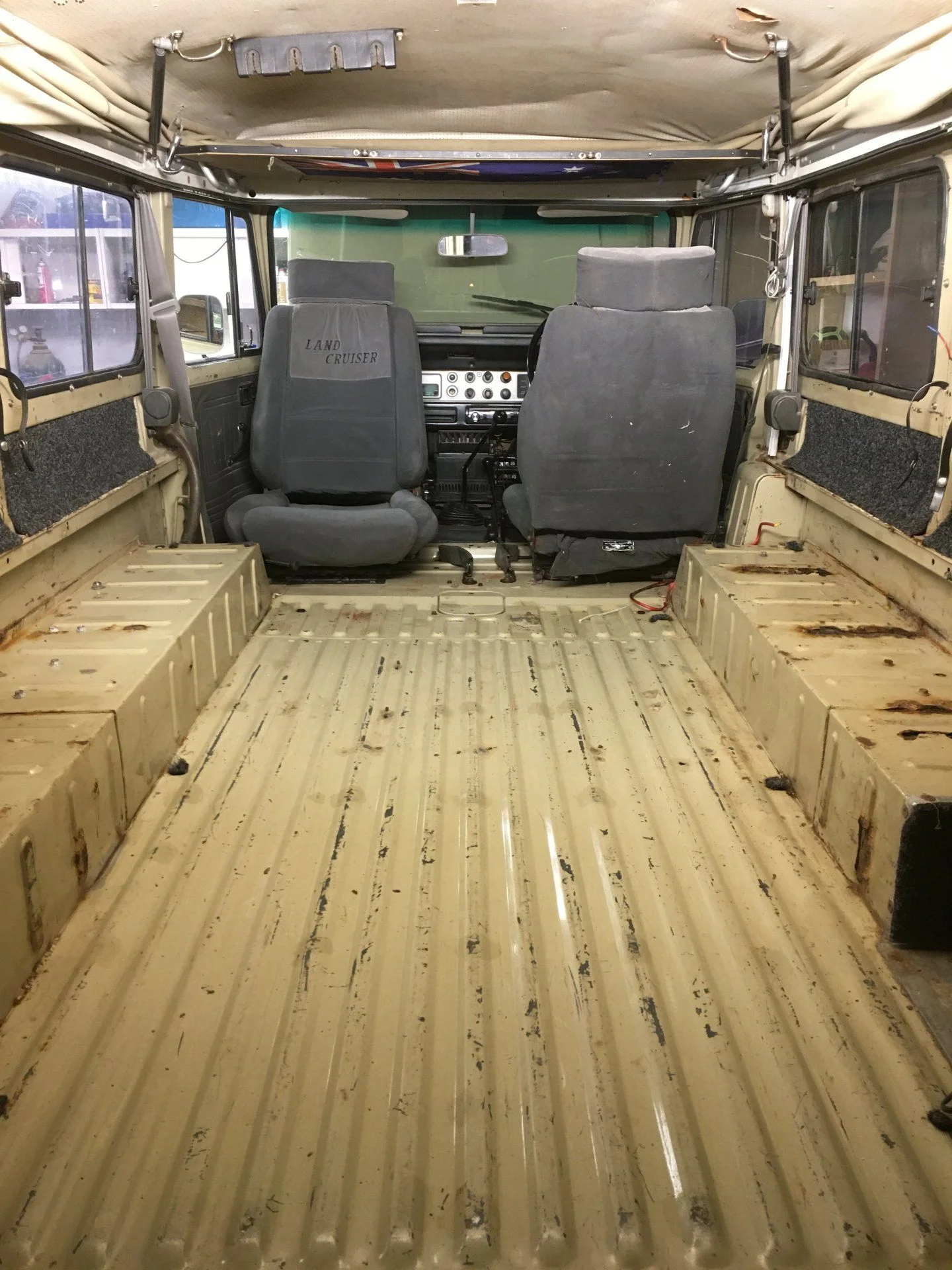

Here’s the current project this week after work to clean out years of dust under the carpet and see how much rust is in the tub. I always knew these seats were pretty decent they fit super low to the floor and being 6’2” they are very comfortable compared to other 40s I’ve sat in with aftermarket seats.

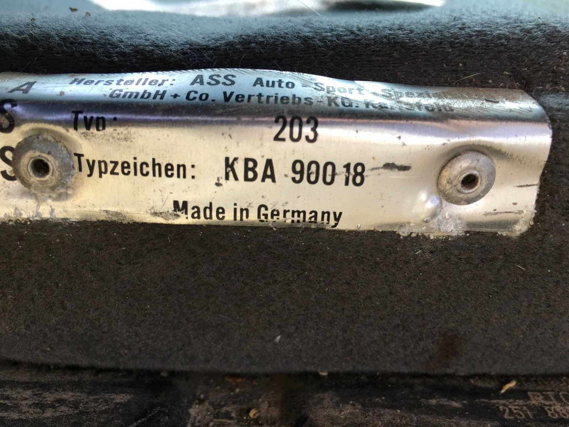

German seat company named Scheel? I assume the company is called Scheel-Mann? Anybody know any history on these?

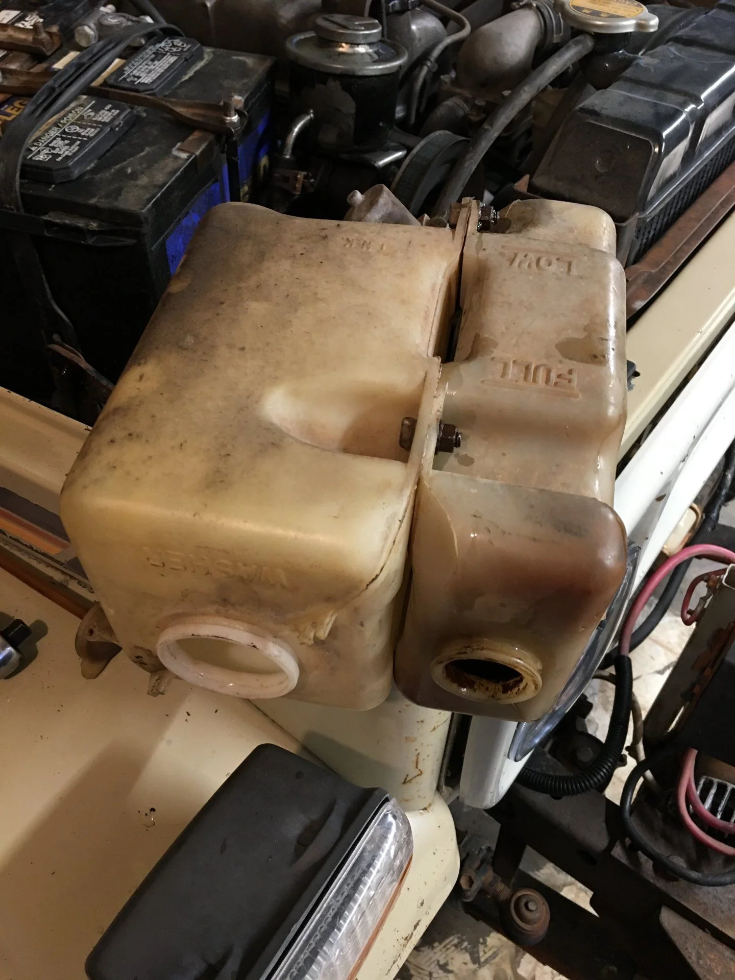

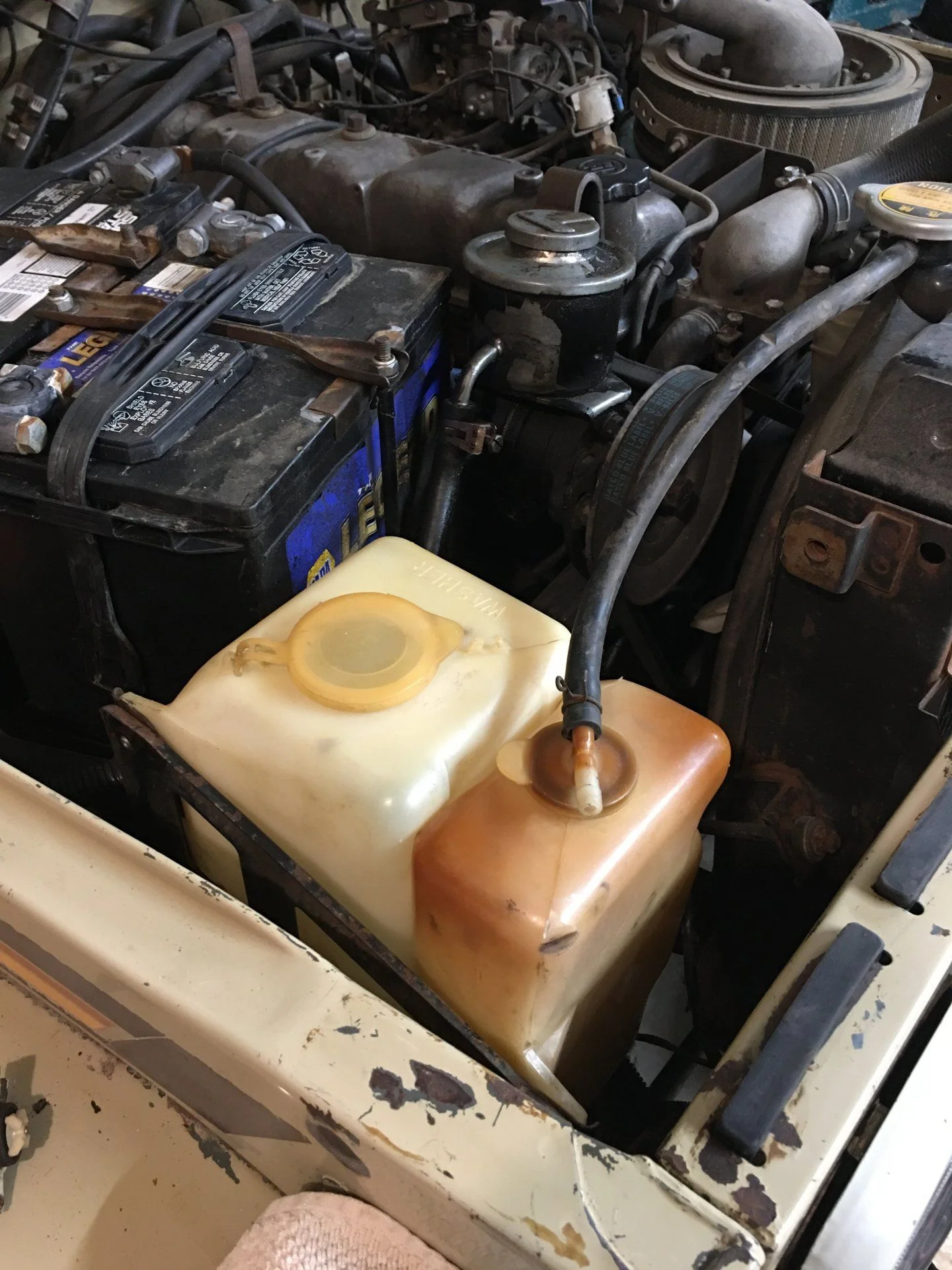

A few things I’ve done to this truck over the past few years was a total cooling system replacement. It never got hot just a seeping leak from the top tank on the radiator and it snowballed into all new hoses, radiator, water pump, thermostat and the drain below the header on the engine block.
The wider air conditioning radiator was original to this truck so I swapped in a mid 70s radiator cradle until I can can get the original re-cored. I have the original cradle blasted and repainted but haven’t found anyone locally that will re-core reasonably...got quoted like $600! Maybe that’s just what it cost..

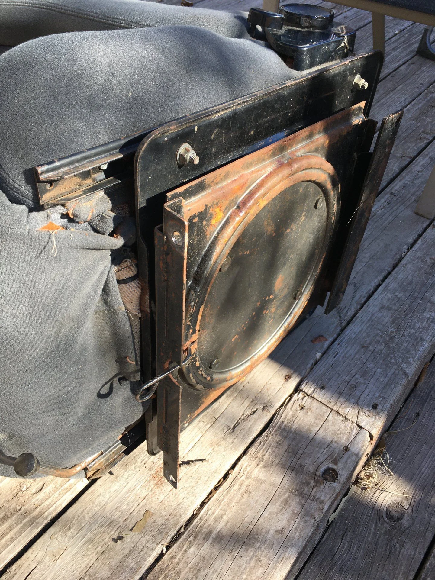

Well I guess the passenger seat has a swivel seat base like the old camper vans! It’s kinda funny to find this out after all these years owning this truck! It always had a divider behind the seats to the cargo area so I couldn’t have used it anyways but I’ll have to build this into the camp setup now!

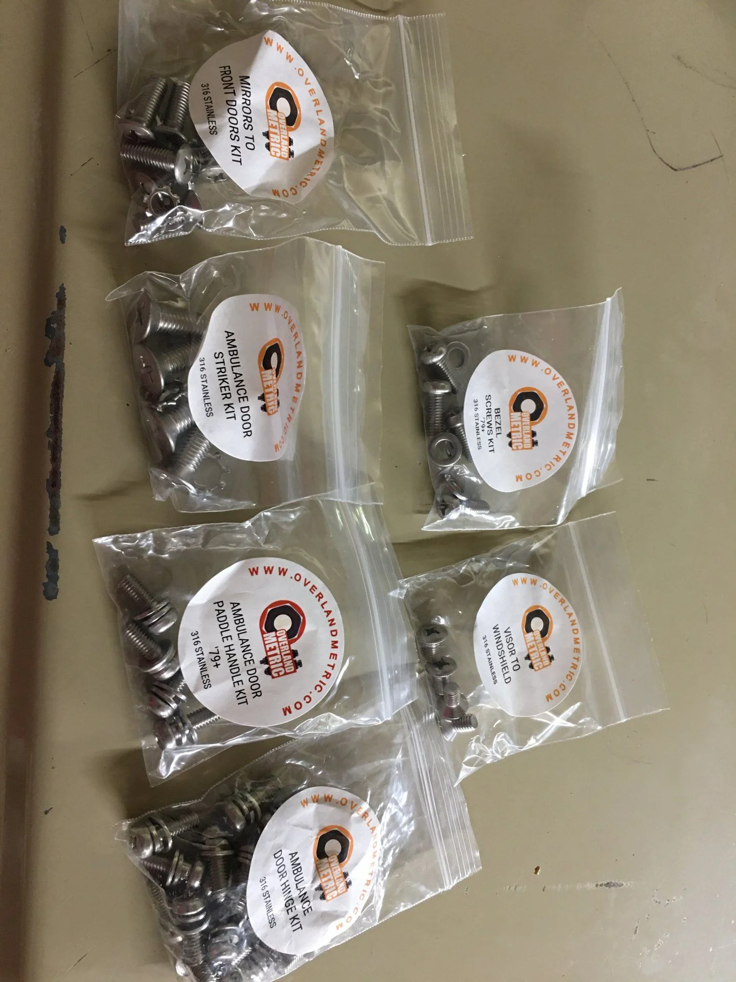

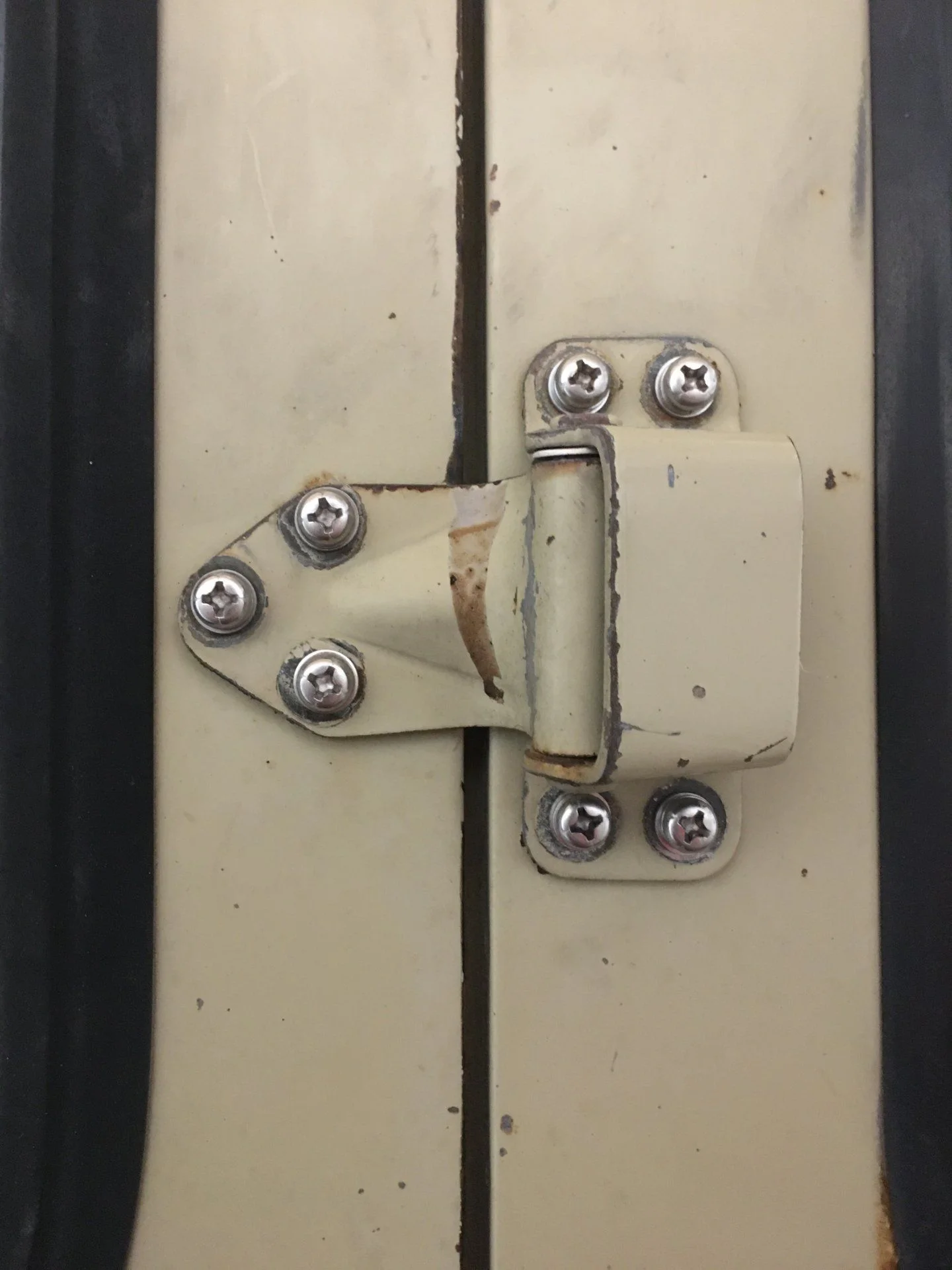

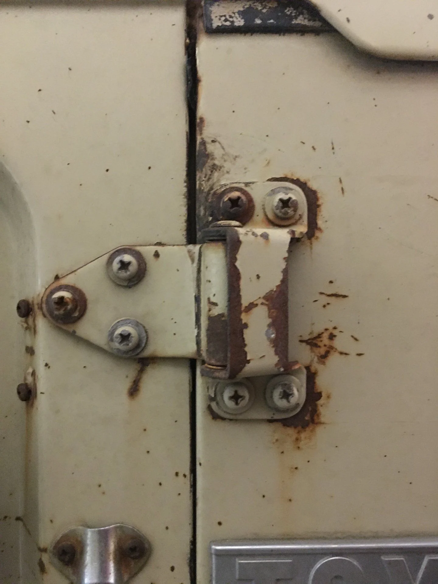

Few small things done the last night. My ambulance doors were way out of adjustment from the bad tire carrier design I took off months ago. It mounted to the body and rested on the left back door.
Screws were all in bad shape so I ordered new ones from Overland metric. While I was on his site I picked up a few more stainless hardware sets for down the road. I’m still not totally happy with how the doors close. I think my lower right hinge maybe bent as it binds on the body a little bit acting like it’s “sprung”
I also dug into my front doors as well. Replaced the door locks to match the ignition. I’m gonna go thru the front doors and try to get them to seal up better so I ordered a few things from Roger last night at city racer. I’ve been waiting for him to restock the vent window weatherstripping and I ordered window runs as well.
I want to treat the rust on the inside bottom edge of the doors to slow down the rust. Anyone have any suggestions?
