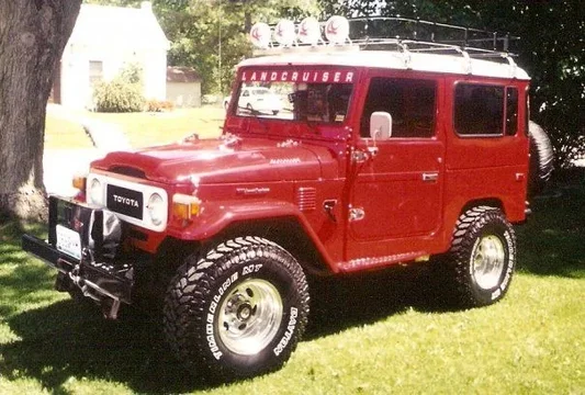

fj40.webp Here is my fj40 right after we painted when i was 15 and a pic of the motor from a few weeks ago one of the 3 test fits lol
