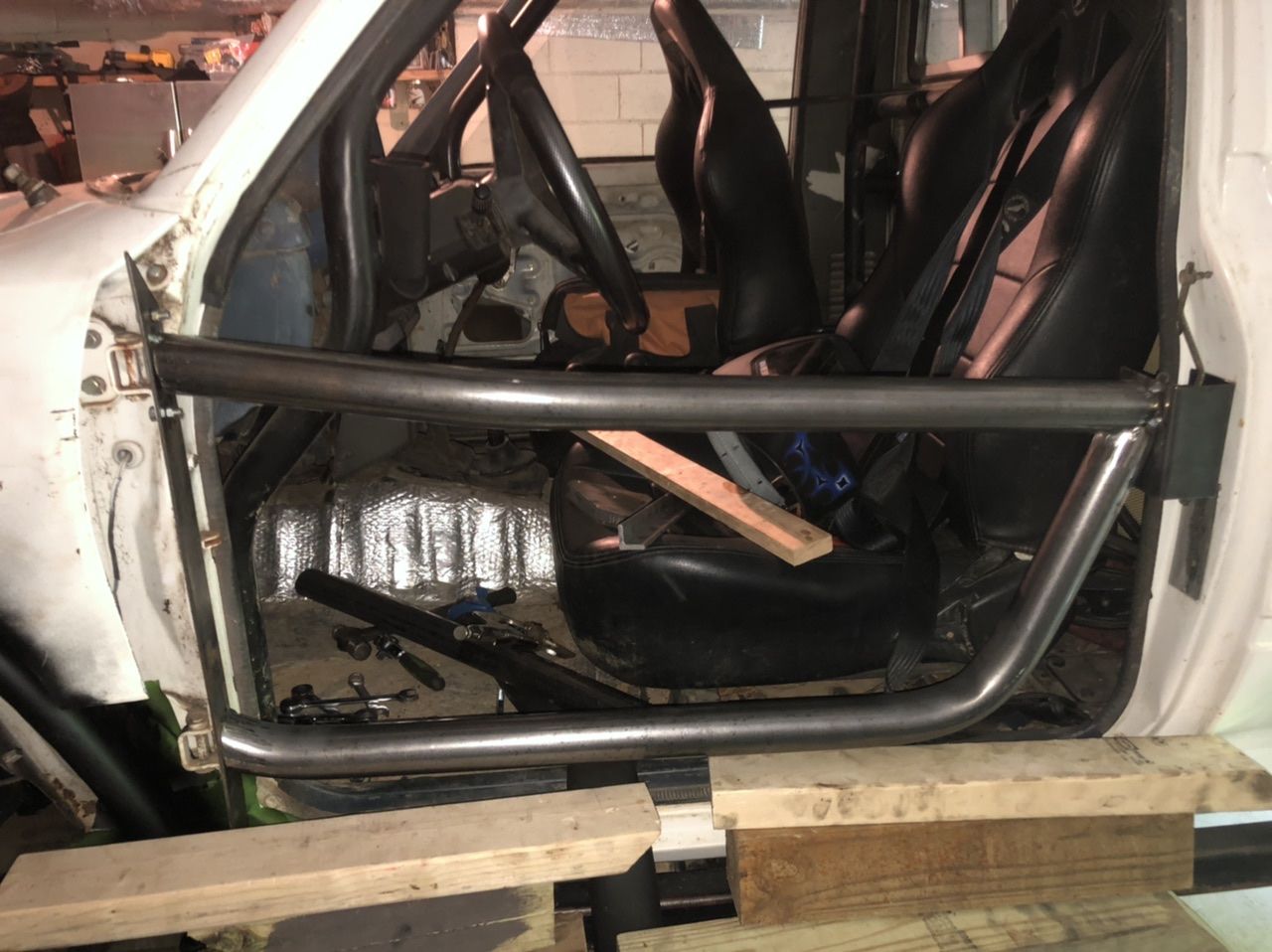

Can’t keep motivated to stay in front of the computer with this nice weather. Main pieces done. Thanks for the nudge @FJCRAWLER

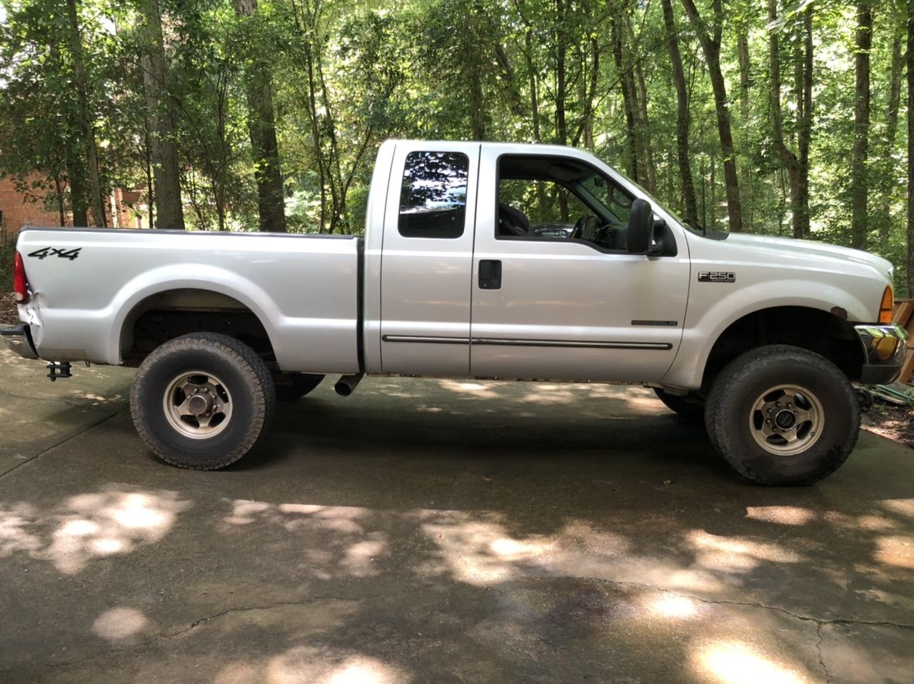

Finally got the tow rig serviced and now she’s rolling coal again. For those considering doing injectors, it was really pretty easy but just time consuming. The valve cover bolts and getting the glow plug connectors on were the hardest part. Definitely worth taking it on as it’ll save you $1,000-1,500 in labor.
This was a great go-by
geez, everyone goin coal but me. good job. gots me a plan workin though.
Excited to see what you end up with. I really liked towing with the tundra but couldn’t keep taking the work truck and the gas mileage sucked. Figured I’d be half way to a set of one tons when the diesel blows up.

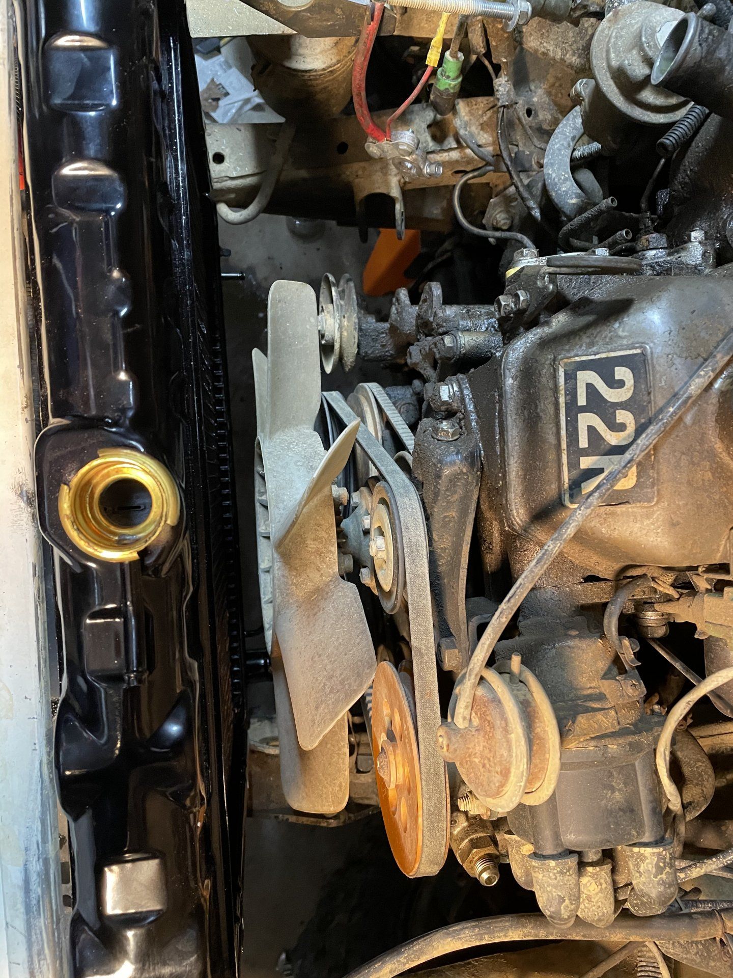

For all you 1st gen owners, I wanted to replace my radiator and was having trouble finding one that indicated it was a direct fit. Ended up going with a CSF all metal copper-brass 3 row. I went with model CSF-2314 which is spec’d for later model 22r and 22res. Ordered it from Summit
Bolted right up, fits in the frame rails, and doesn’t interfere with the hood which are issues listed on the web. Only thing that didn’t fit was stock radiator cap.

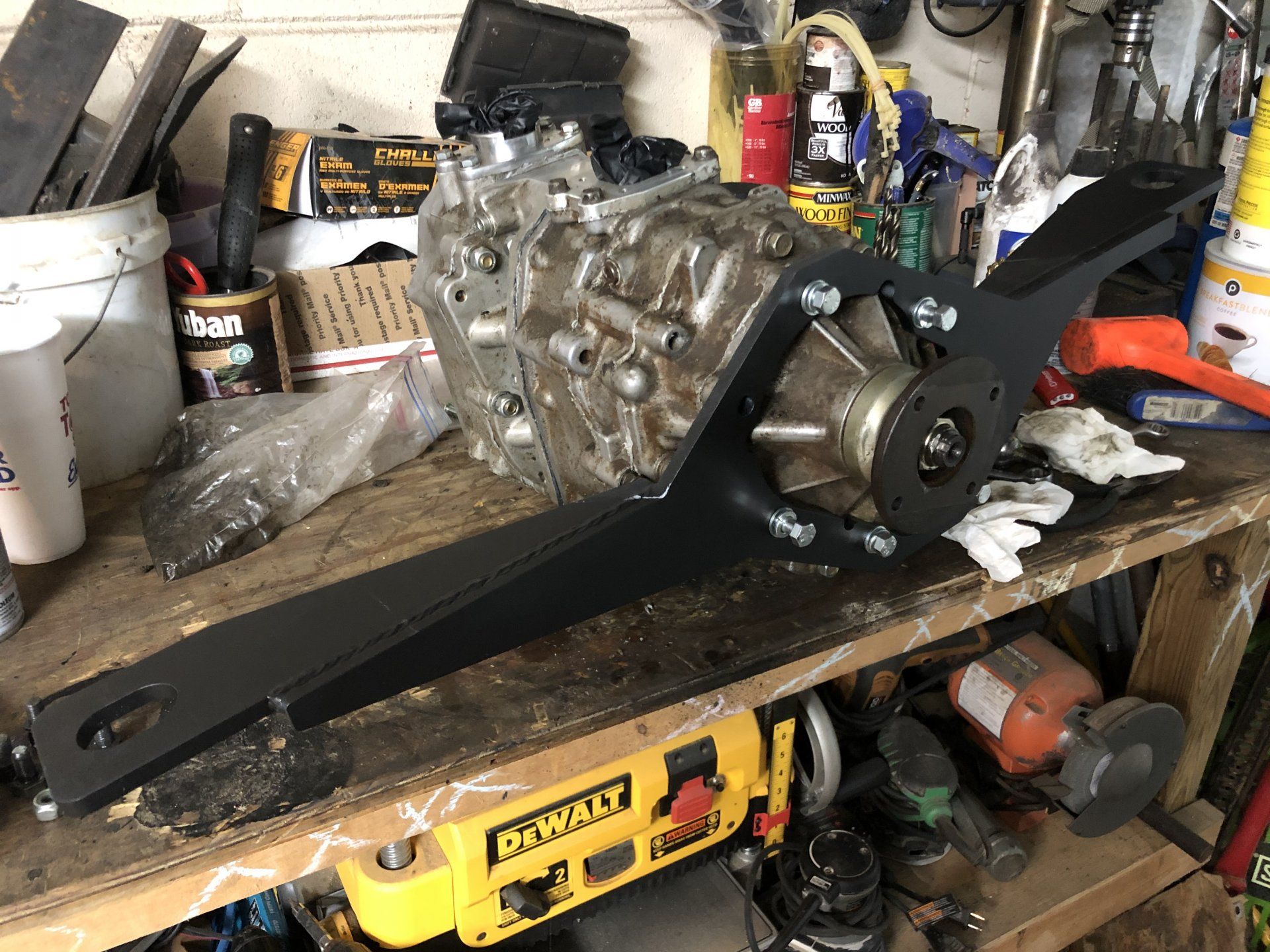

Details on this crossmember, and your rollover?
As @TeddyBoy alluded too, that may or may not have been associated with over consumption of cold beverages coupled with poor driving skills. We flipped it back over and kept wheeling though.
Went with a Front Range crossmember that mounts to the back of the tcase. I think there are some previous posts with pics. @FJCRAWLER just like to talk trash.
