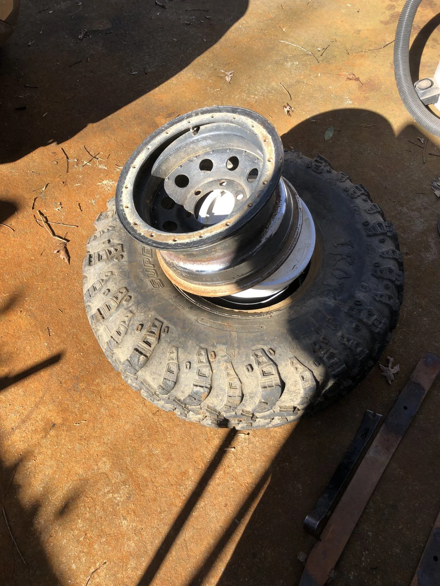

That pic was the old tire coming off. Gonna swap those TSLs to the bead locks and ditch the iroks. With that said, I have no doubt I’ll screw at least one up.

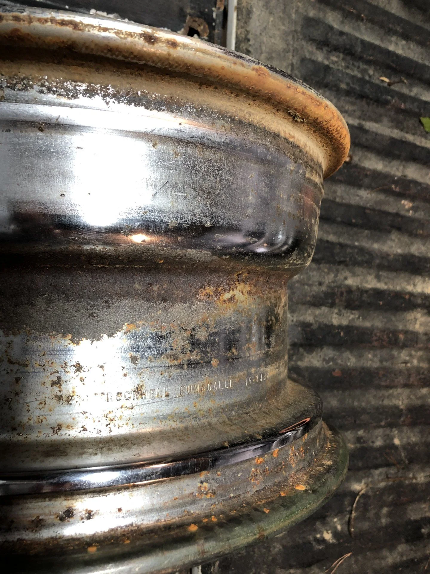

Pretty decent bit of rust on the inside of these wheels and especially along the inner bead. Should I try and get rid of most of this or do I risk damaging the inner bead contact area? I’ve got a s***ty HF soda blaster that would knock it off and shouldn’t gouge the wheel. Once done should I paint or just let it ride?
