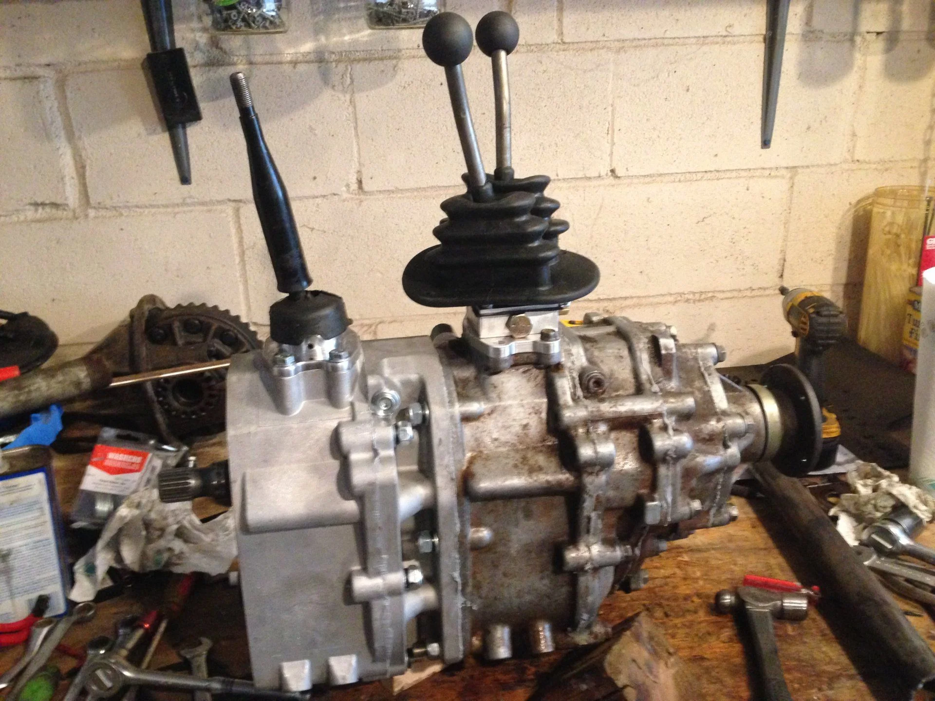

Santa put a few $ in my stocking this year and looking at starting to compile parts for duals. My main question is regarding shifter options. I like the triple stick options but have heard of problems with fitment. Looks like RAD Design and Davez have good products. Has anybody ran either unit with feedback? It looks like the Davez unit will work without a body lift but I've read the RAD Design unit doesn't - truth? Should I just go twin stick?
I'm running the RA Design unit and like it a lot, daves look nice too but always seems to be out of stock. FWIW, the only reason im running it is for my 3rd case, the shifters would be way to far back without it.
For dual cases just twin stick it, not worth the $$ and better off putting toward otjer things.

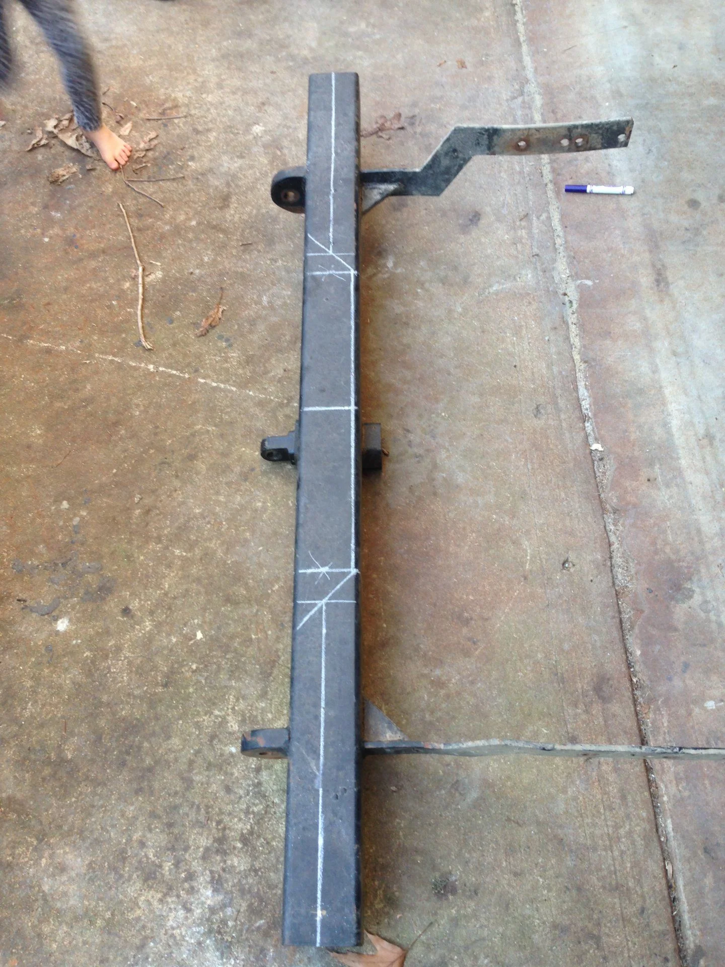

Well, it was a great day to be out under the truck doing some pre-wheeling trip looking around. While I knew it was probably time, I've created a project with too little time to complete.
So this is what I noticed:
So I got to drawing
And damn, plasma cutters kick ass
And stopped here. Trying to decide if I should wrap it around the sides. The end result should gain me at least a few inches more than how it was mounted before.

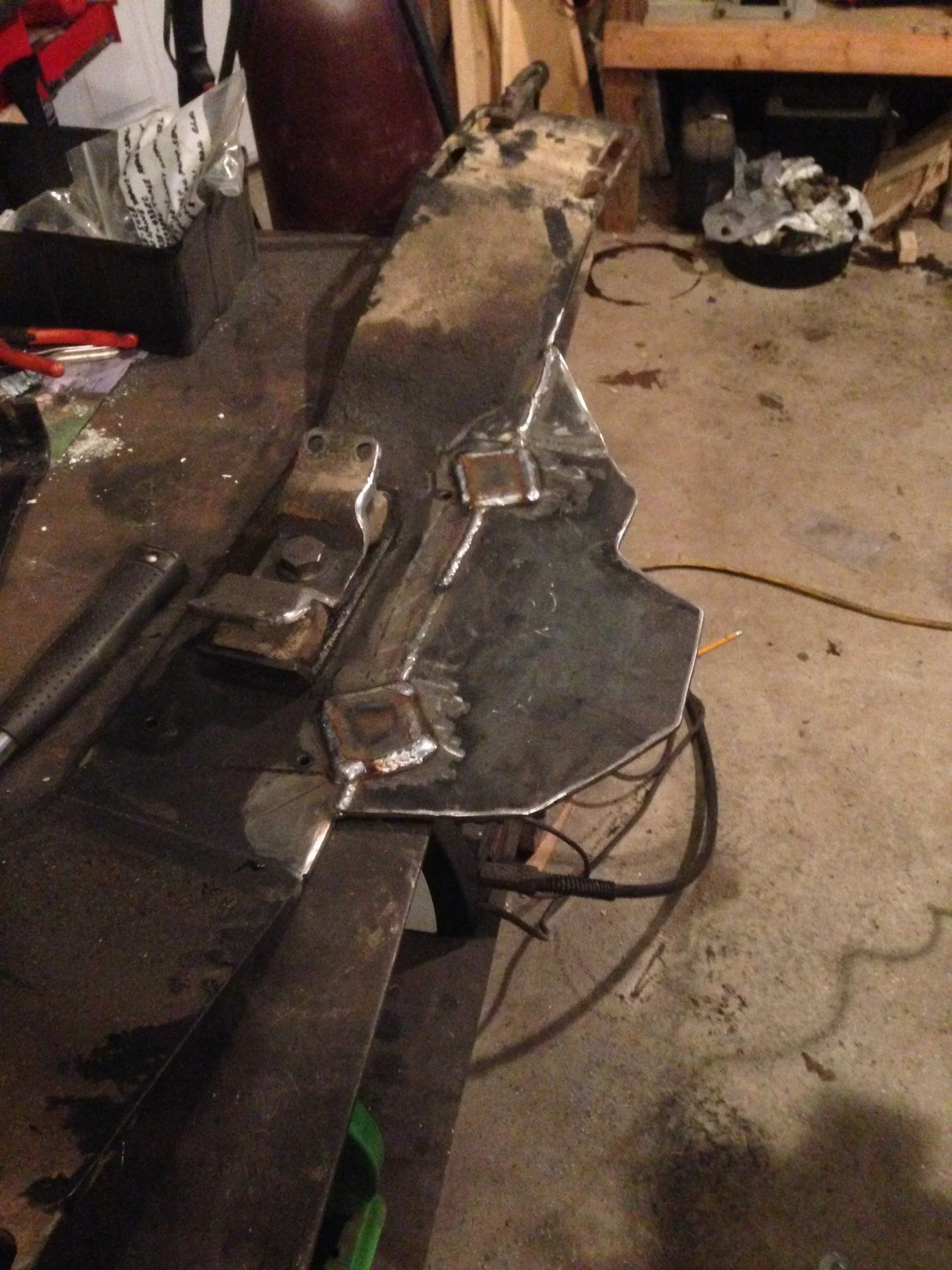

Made a little progress today. Just got to figure out how to mark and drill the holes for the rear tcase mount.
Hoping that my addition to the crossmember holds up. It's 1/4 inch but there's not a great way to reinforce the butt weld without hanging a bunch of metal off the bottom which I don't want to do. I tried to add a couple of metal coupons across the joint to help - we'll see.
Could you add a 1" +/- vertical rib along each side, basically under the tall part of the mounts? Welded perpendicular to the flat plate. Did you bevel both sides to get a good penetration weld on it. I mean typically the weld is stronger than the base material, but having that extra weight hanging off could bend even a solid piece of plate. Adding even a single rib will dramatically increase the overall strength of the crewmember.
That's a good idea. I beveled the joint but I'm also worried about the weight. I'll get the tcases mocked up and see where I can add some bracing.

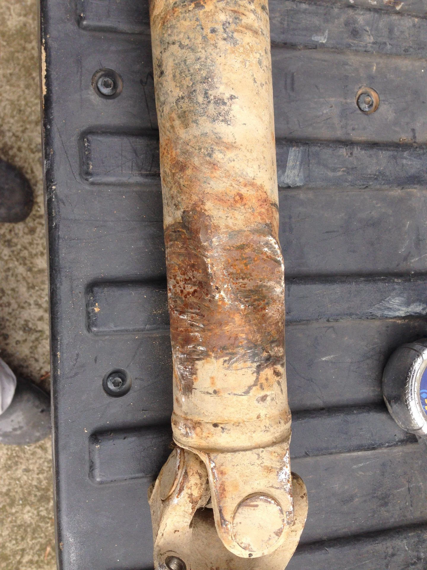

Well this is probably why I had vibrations at ~ 40 mph.

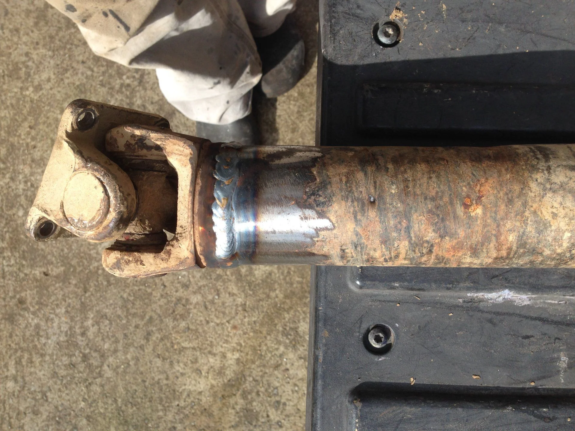

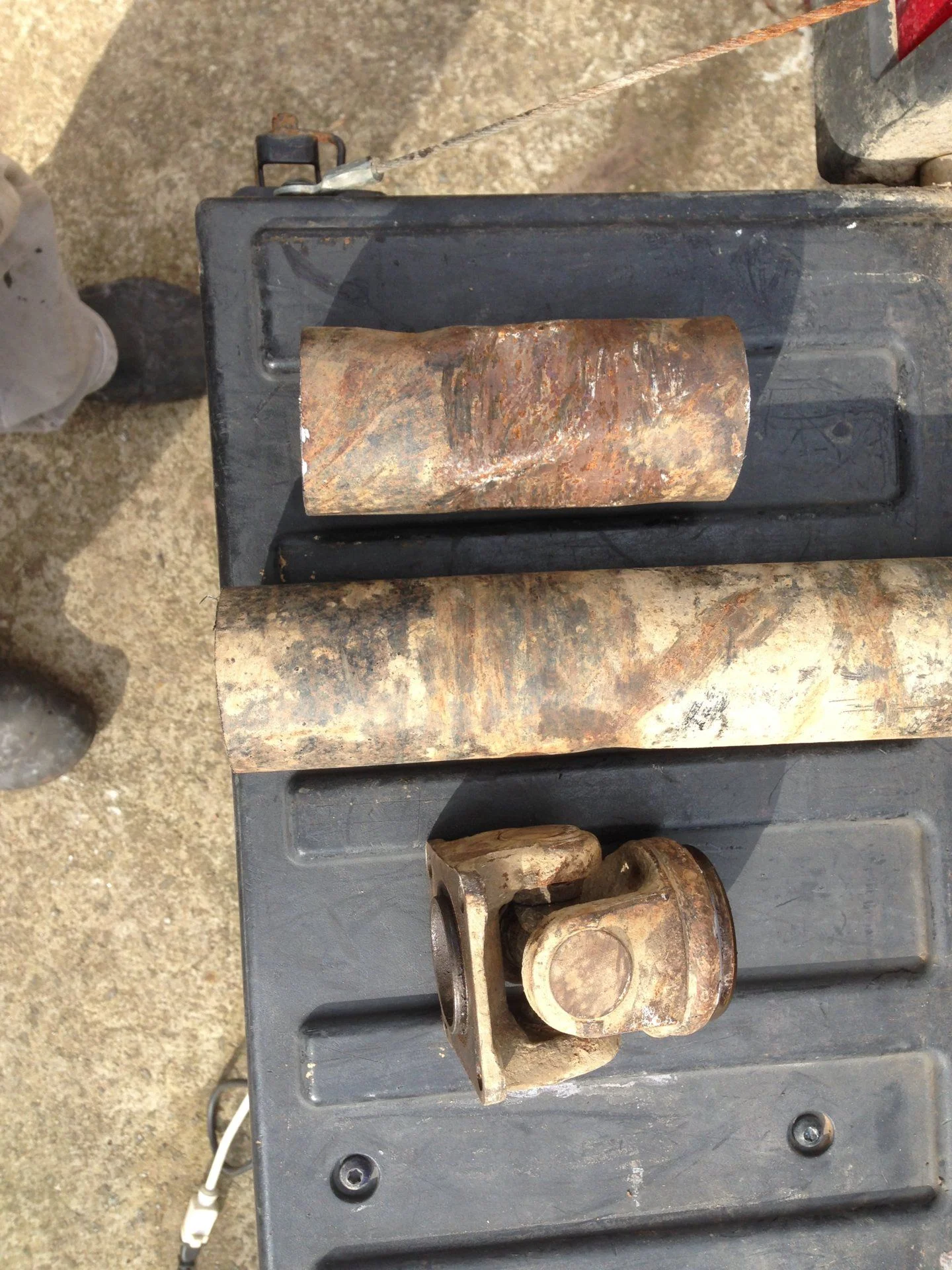

So I cut the yoke at the weld and then 6" out of the driveshaft to fit with the duals.
It was a good tight fit back in the tube and then welded. Do you think it'll hold up? It won't see speeds > 40 mph and primarily trails.
If you were looking for road gear I would probably see about having it balanced and make sure the joints were in phase, but just for bumming around from trail to trail, I'd say you will be fine.
